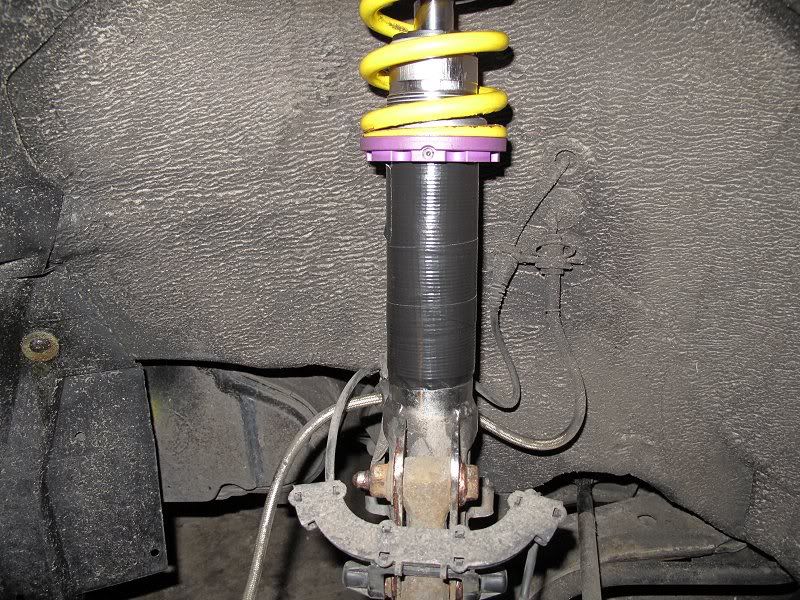

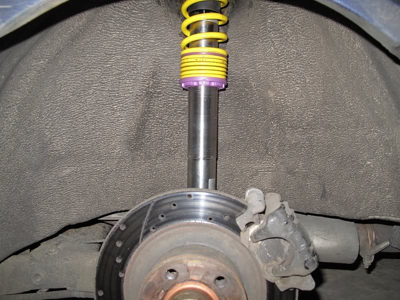

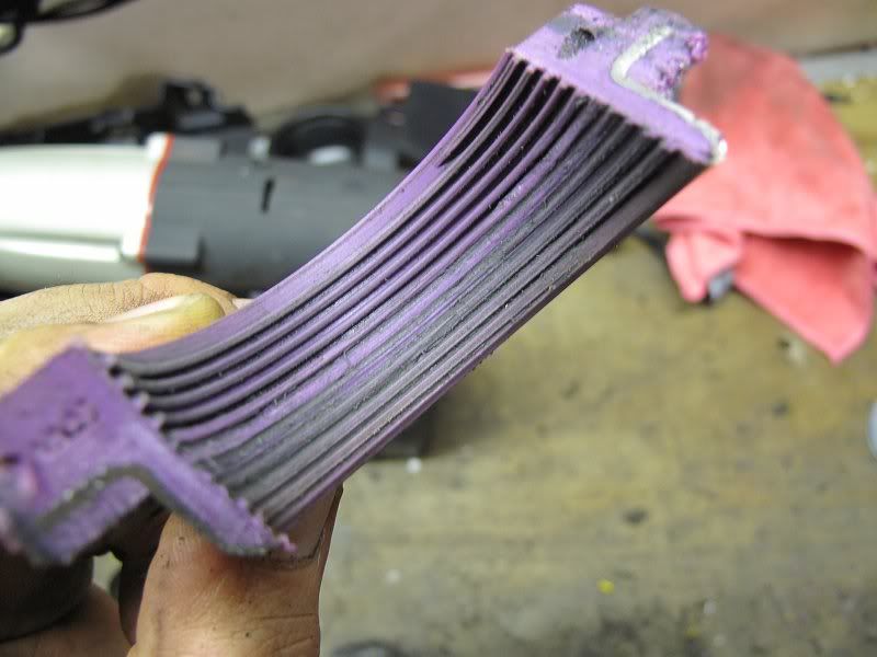

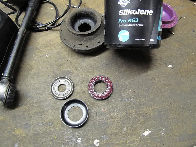

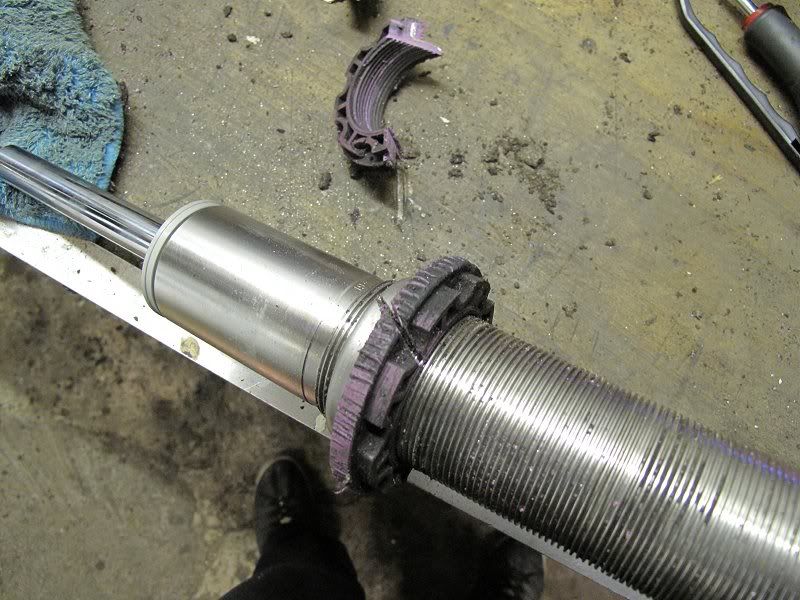

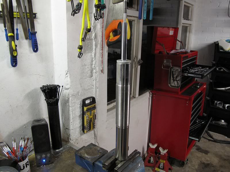

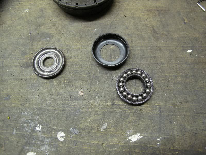

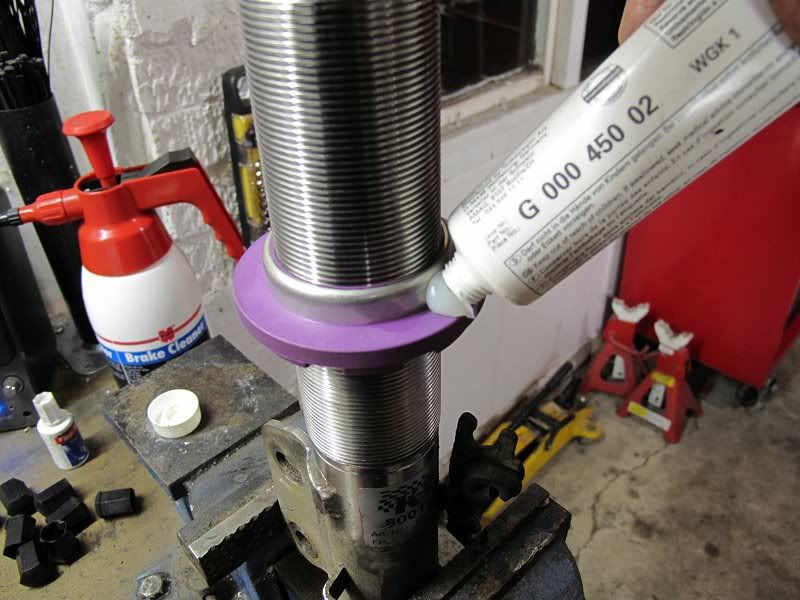

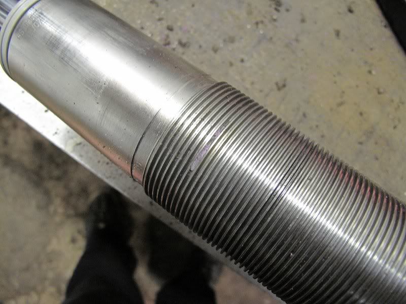

Kevin Bacon 5 Posted February 17, 2011 (edited) How to replace a KW spring perch. KW Replacement parts details - http://the-corrado.net/showthread.php?52987-KW-Suspension-parts-contact-details-etc I wanted to adjust the height of my V3s recently, but couldn't, because of this usual problem. Crud build ups jamming the perches! All 4 of mine were seized, which was unusual as I've only had to replace one in the past. Anyway, you need to strip down the strut in order to cut off the seized perch. obviously :). Bear in mind if you can't wind the perch down to relieve the spring tension (why you're taking them off in the first place!), make sure you cover your face in case springs 'n' things twang off suddenly. Once you have a naked strut, get your hacksaw out and carefully slice through the perch and *not* the threads! :lol: Turn over and repeat, then pull the 2 halves off the strut. Here's why they seize. Bits of grit and the heat from the friction of forcing the perch round deposits chunks of plastic into the threads, jamming the perch solid. It's easy to pick out of the threads though and I think that's probably better for strut preservation than metal perches siezing! Run a wire brush through the threads and you have a beautifully clean strut again :) These are 3.5 years old and have done nearly 60K. This is why you need inox in your life :) I reckon these V3s will be going strong way past 100K before needing a rebuild. During assembly, I like to use a sliding mechanism grease on the perches to ease the friction when winding the coils up. It really helps. In the perch threads, this stuff works really well. When you do the fronts, strip the top mount bearings and inspect for wear. Saves you a few bob if you don't have to replace them! They come apart very easily. Mine were mint so I repacked them with some more Silkolene synthetic grease. Could that be why these are lasting so well? VAG put a very small amount of naff looking grease in the new ones, but I like to get that out and put some proper stuff in :) And finally, some duct tape is the best thing bar none for protecting the unused threads :) So there you go. Don't panic if your coilovers won't turn. An hour and £15 a corner and you're good to go again! Edited February 17, 2011 by Kevin Bacon Quote Share this post Link to post Share on other sites
