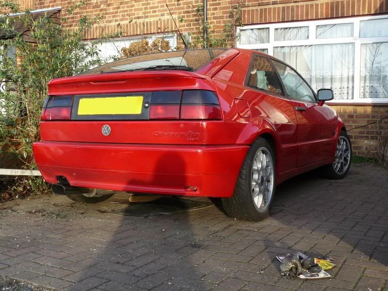

They aren't actually BBS wheels. They were a limited edition wheel called A-rays from a company called P-A racing. I re-badged them with vw badges though. Got them as they clear the Brembos and are reasonably light.
I have the same wheels on my C and have been meaning to get VW badges for the centres, they look so much better in your pics.

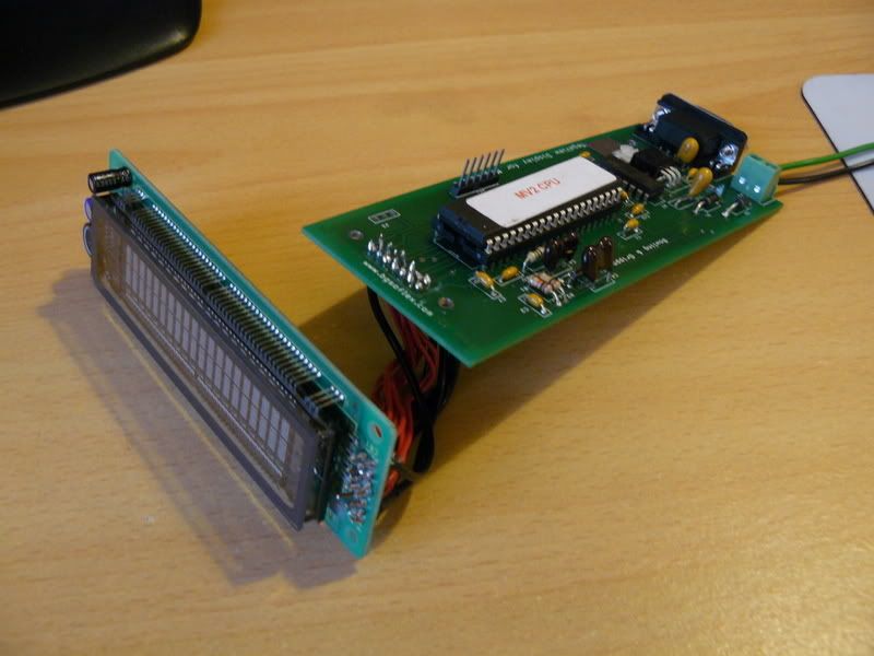

Went for the Innovate LC-1 wideband in the end. Ordered it from the US, as the exchange rate makes things nice and cheap there at the moment! Was Very tempted to splash out on this! LCDash Digital Touchscreen dash...it's 8) 8) 8)

Yeah the Megaview will show the AFR when used with a MSII apparently!

Apparently the Megaview will only show AFR when used with MSII aswell! I got my Megaview II kit for $135 (£65) from diyautotune, while ordering the lambda!

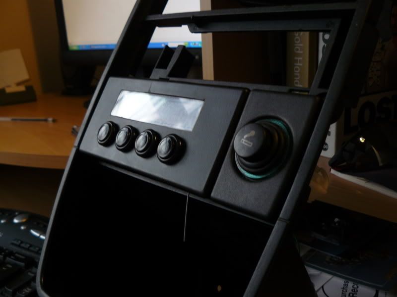

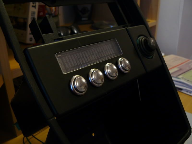

With the short evenings now, I get even less chance to get down to the garage to do much meaningful work on the car. So I gave myself a little indoor project to do to keep me busy.

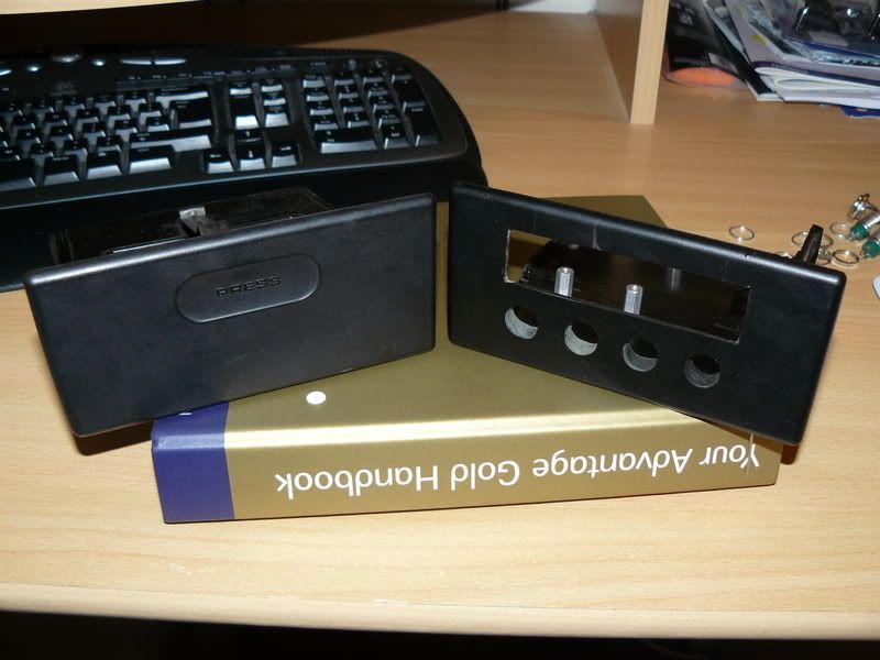

Decided to mount the Megaview II kit into the old ashtray!

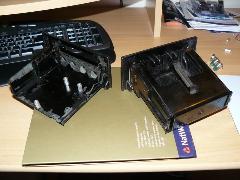

Megaview kit, I assembled it slightly differently, so the screen could be moved off the main pcb.
"Slightly" modified ashtray to house the unit and screen, compared to an orig ashtray.
Unit test fitted in the centre console.

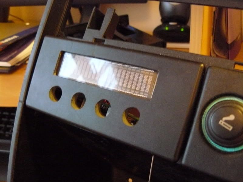

I cut a clear plastic 'window' (made out of an old clear plastic Christmas tree) to fit the rectangular hole, and mounted 4 buttons to control the display and for tinkering with the engine parameters in real-time
Buttons de-blinged with a few coats of primer and some black spray paint.

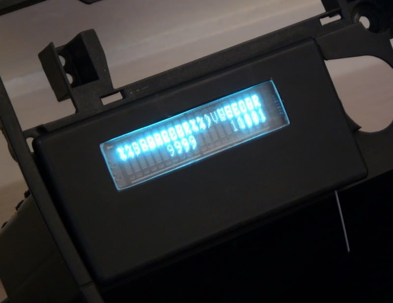

I need to take it down to the car to hook it up to 12v and into the ECu to get it to function. But here's basically what the 'prototype' version looked like. This was with my first test cut of the plastic screen, and without the buttons mounted though.
Not a great photo, but you get the idea. Should be reasonably subtle in the dash. :)
Good work dude! I'm liking that a lot 8)
What are the buttons for? Are just they to control the MegaView?
One button pauses the dispay as it scrolls through all the engine parameters.
It can be switched to a configuration mode which allows you to modify any of the ecu configuration variables, bar actually changing the spark / fuel tables themselves.

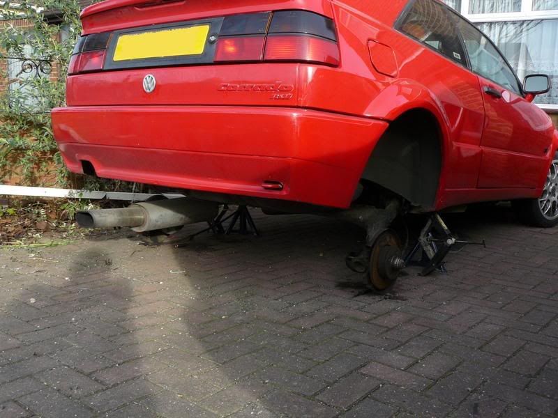

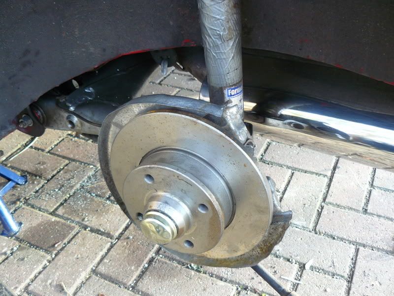

With bad weather, Christmas and holidays etc it's nearly three months since I last did any work at all on the car! :shock: Figured it was nice weather this weekend to I got stuck into getting a bit of work on the back of the car done!

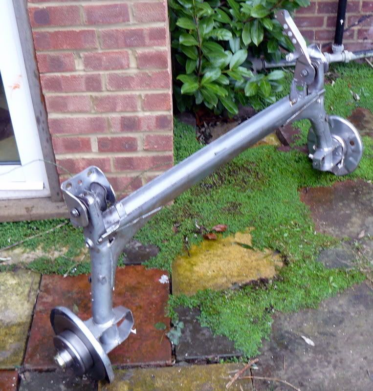

Replacement rear beam, with new axle bushings Prothane polyurethane inserts, new disks and bearings fitted.

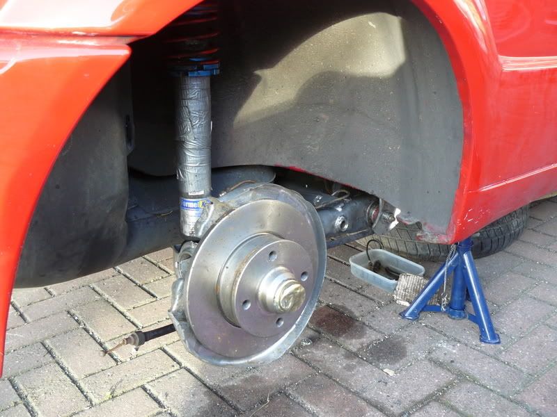

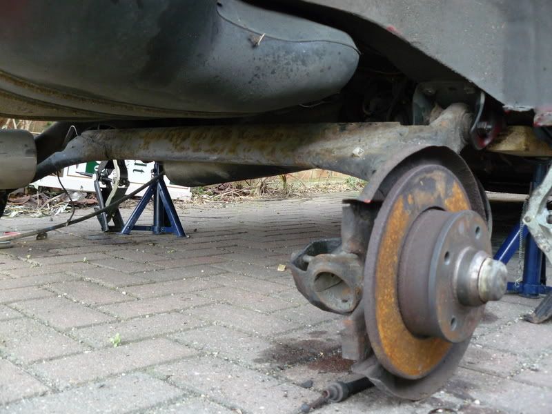

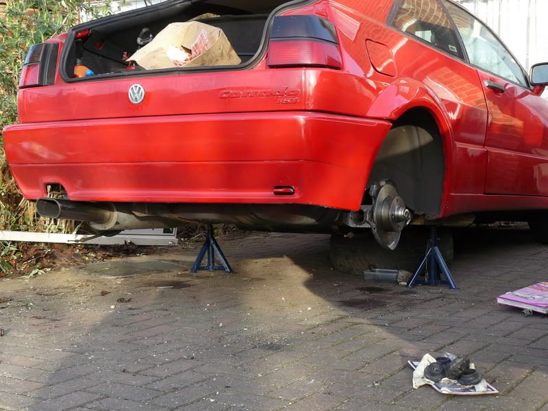

Suspension and brakes removed
Dusty old beam
Dusty old beam removed

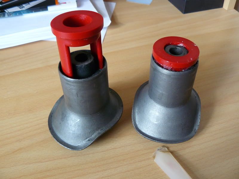

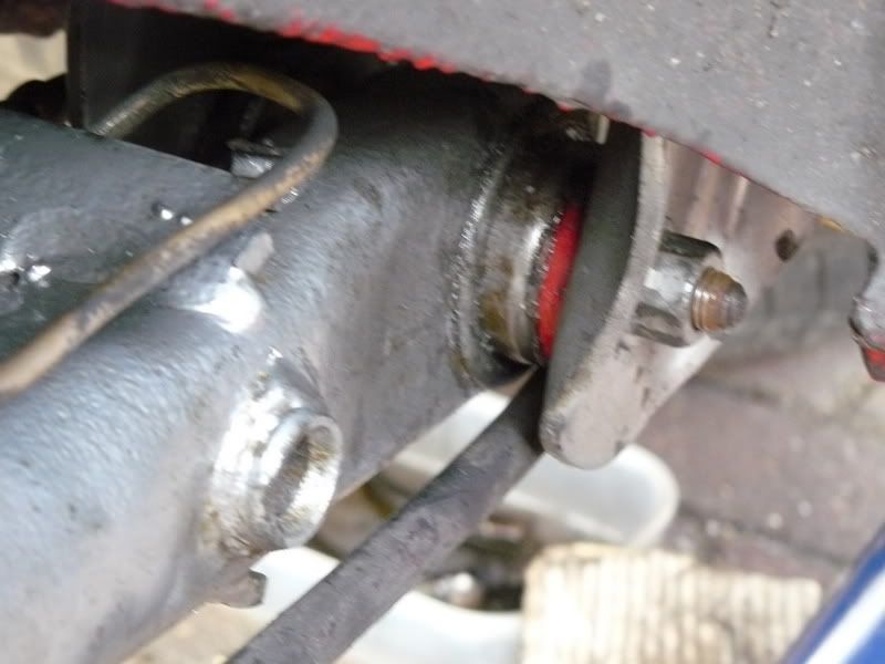

Fitting the poly inserts into the standard axle bushings
Shiny new beam fitted along with a set of 4 new flexi brake lines.
I am NEVER going to fit another set of these bushings, EVER! :mad:

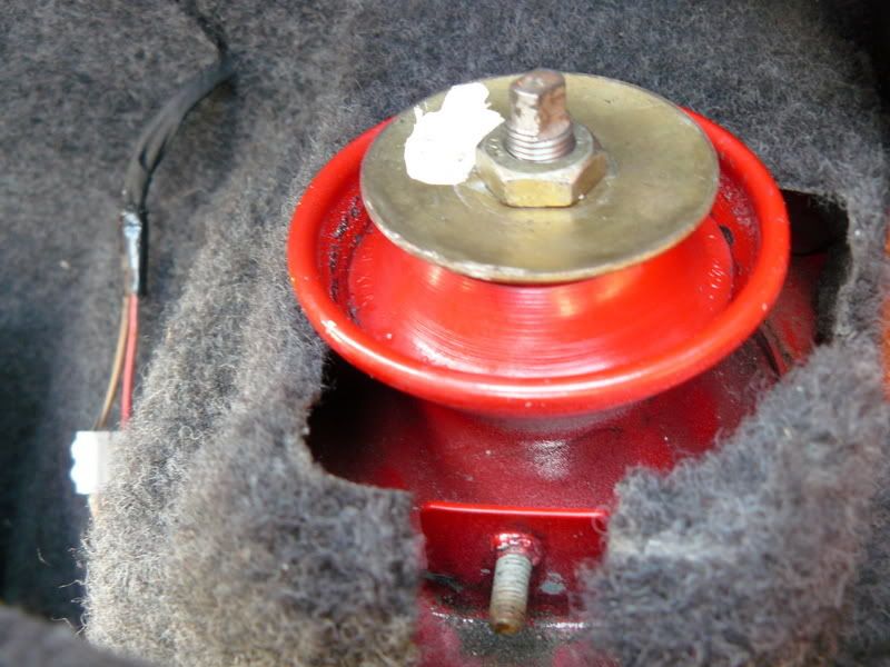

New Prothane polyurethane upper and lower top-mounts fitted to the rear shocks while I was at it

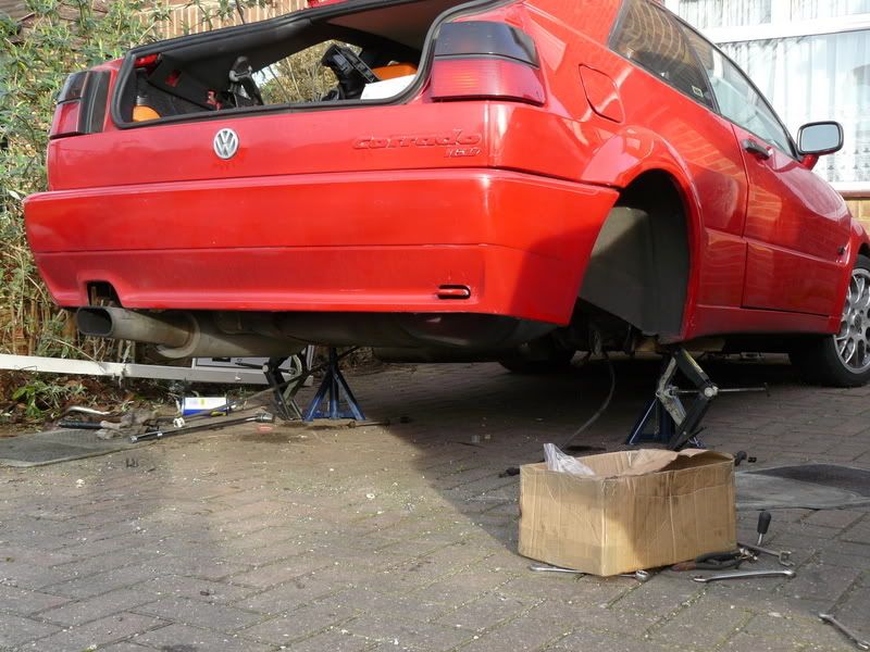

And back on four wheels
Had to destroy one of the metal brake lines to remove it. So need to get another one of them made up. I'm going to give the calipers a quick clean-up before I fit them too.
Also need buy a caliper windback tool to get the new pads fitted. :roll:
