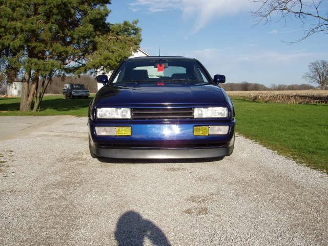

herisites 0 Posted June 26, 2006 Here's a pic with a smoothed from bumper. I think this one looks good, but wont you get pulled for not having a front number plate? Quote Share this post Link to post Share on other sites

Bendy 0 Posted June 27, 2006 Mine hasn't cracked yet and its been done for about 18 months that was plastic welded and a skim of filler over the top, tis the blue 1 that herisites posted. and i've had no prob from the :lcop: or the mot man with regard to no front plate!!!! :lol: Cheers Ben Quote Share this post Link to post Share on other sites
