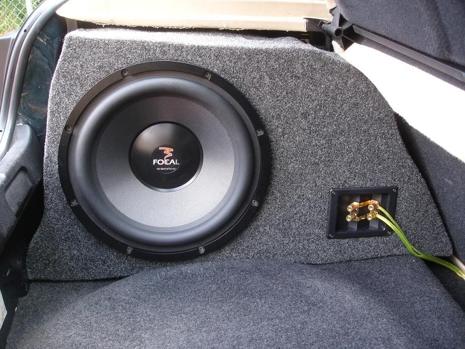

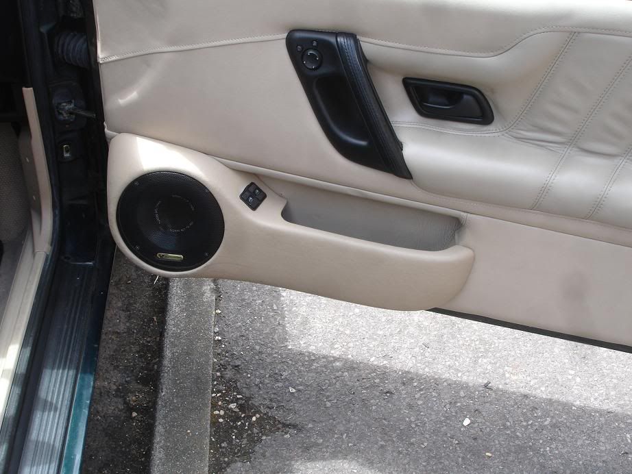

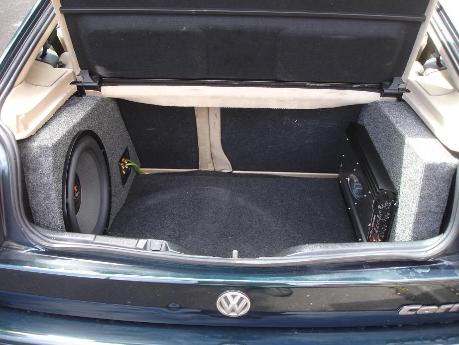

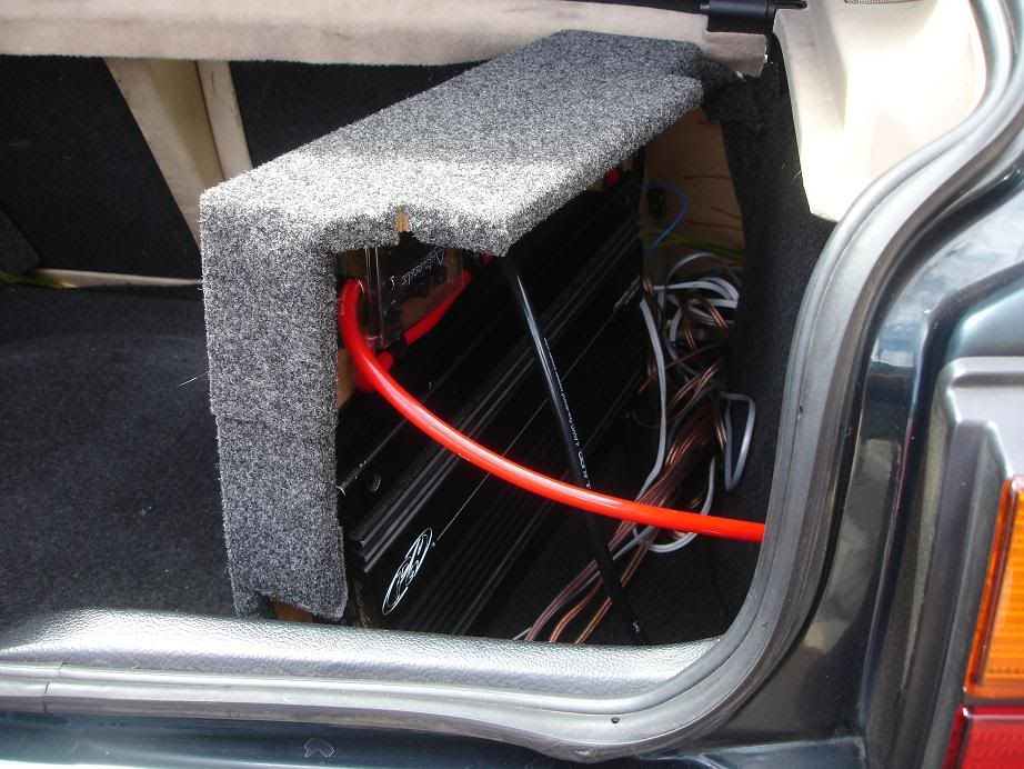

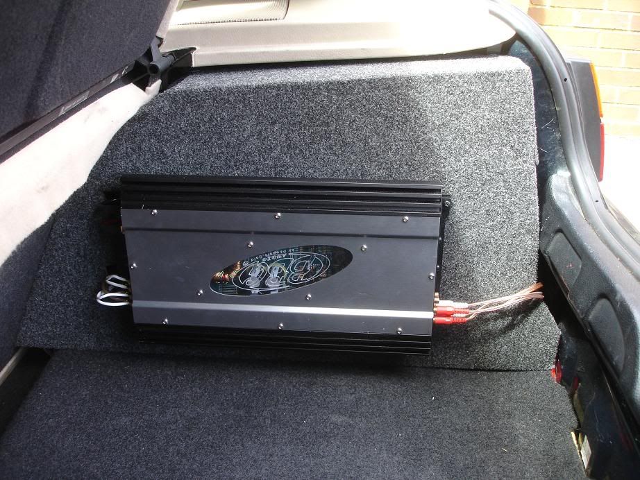

slats 0 Posted June 27, 2006 Well here is my first attempt at a full install on my VR and I am very happy. The sub box needs a little more work to get the seal tighter but I know the problem and a bit of sealent will do the trick :) Pic one and two - The outside of my VR (sexy) Pic three, four and five show the inside and my lovely Audioscape pods (tweets in the standard dash mounts) Pic six, seven, and eight are the boot install And last pic nine is of the rear of the amp rack which has the sub amp and all the wires!! It took 3 weekends to finish the sub box and in making it I managed to cut my thumb and get 5 stitches in it as fiberglass is not easy to cut with a stanley blade!!!!!!!!! :roll: Quote Share this post Link to post Share on other sites

slats 0 Posted June 27, 2006 MDF and fiberglass!! Was a lot of work on the box and next time I may just buy one but it was fun building it. I got help on the box from a friend who does it a lot. As for the shapes of the front and the amp rack I have lots of bits of MDF now that nearly fit!! Quote Share this post Link to post Share on other sites
Phil K 0 Posted June 27, 2006 Looks good and like it's been a lot of hard work! Looks like the amp is mounted upside down though :? Quote Share this post Link to post Share on other sites
slats 0 Posted June 27, 2006 It is!! I was going to turn the cover over but I just havent had time :( Quote Share this post Link to post Share on other sites

billinjah 0 Posted August 7, 2006 did audioscape trim your pods? Quote Share this post Link to post Share on other sites

Foggystorm 0 Posted August 7, 2006 did audioscape do the trim for ther pods as your car's interior is the same colour as mine and I want some of those for mine. I am also after a stealth shelf coloured to match the interior, if I find one I will let you know Quote Share this post Link to post Share on other sites

Dennis.be 0 Posted August 9, 2006 The amplifier that was used in this install looks al lot on the one that I've got. The amplifier is a Phoenix Gold Ryval Designs, the plexy window lights blue when playing. Wy don't you turn the cover around? The only thing you'll have to do is make the cable of the LED a little bit longer. I finished my install today, it's the one on the picture. Quote Share this post Link to post Share on other sites
slats 0 Posted August 10, 2006 Have been away so long time no reply!! Pods. These were done and trimmed by audioscape. The colour match is good but in real life just a little darker then the rest of the door card but when it is in its not noticeable really. Front panel for sub box. I think I did about 5/6 layers of F/G in the end (more on the corners) and about 10 litres of resin!! For the front of the box I cut a shape of ply to fit inside the box with no gaps (use card to make the template) and make it about 2 inches wide all round. Fibreglass the ply from the inside of the box with a few layers so that you now have a box with a lip on the front. Now trim any part of the FG that sticks out proud of your lip as you now need to cut some MDF to cover the whole front. To attach the MDF I used a glue and silicone seal in which you do a bead of sealant then a bead of glue and then a bead of sealant around the ply. I then also screwed the MDF on to make a tighter seal (as you screw it on the glue and silicone spreads to make a really good seal, oh and make sure you cut the speaker and terminal hole before gluing!! Hope that makes sense!! My Amp. Mine is a BBG Ryval and it is a Pheonix Gold design which BBG use. It is the same unit I think but it has a bigger power block in it (oh and it was cheaper!!) Quote Share this post Link to post Share on other sites
