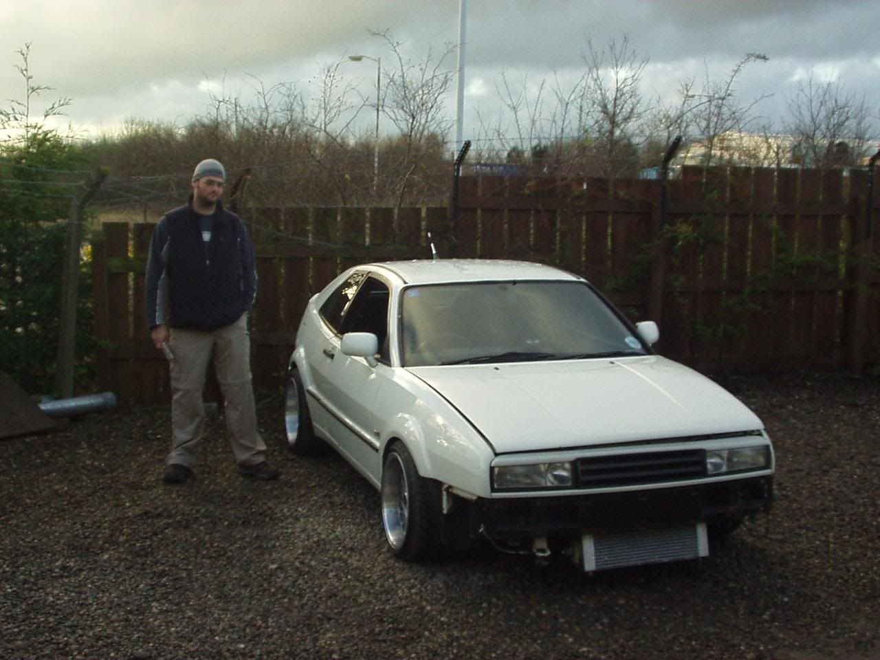

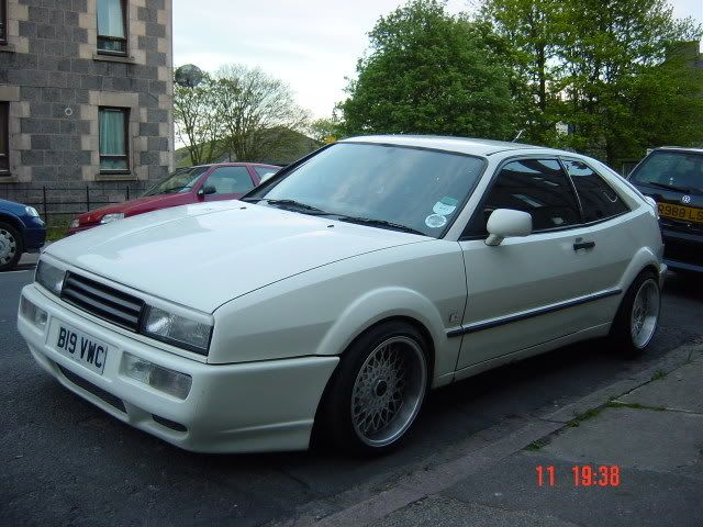

BigTartanJudge 0 Posted August 6, 2006 Bet they are AMG splits ? ;-) Anyways, yeah, I was running 205 40 R16 toyo Proxes T1-S on my Borbet B's on my white G60, albeit with no adapters, but offset was still et15 (well et14) as it would be if you used 20 mm adapters on et34 Merc wheels. You WILL need to get the arches rolled though to avoid tyres catching, only about £100-£150 for all 4 arches tho pal. 35 profile better as allows you to go lower on coilovers or lowered suspension. Have got a few pics somewhere, ah here's a few ! Had Koni adjustables fitted. Quote Share this post Link to post Share on other sites
