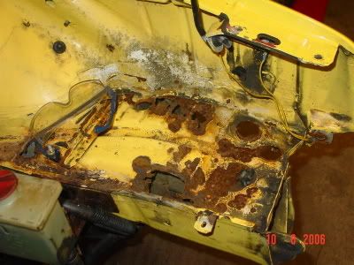

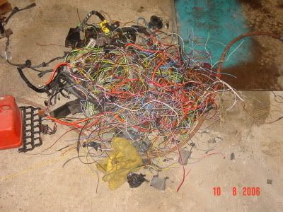

rado-steve 0 Posted August 10, 2006 A Few more pics! Rusty Battery Tray! Mmmmm Not Good!!! Delete option on the wiring! Thats the stuff thats being skipped :eek: Gotta Order a new Battery Tray from the stealers (Frickin' £65 +Vat) then relocate the water reservoir brackets and PAS brackertry then get the engine bay painted before the motor can go in!! Quote Share this post Link to post Share on other sites
