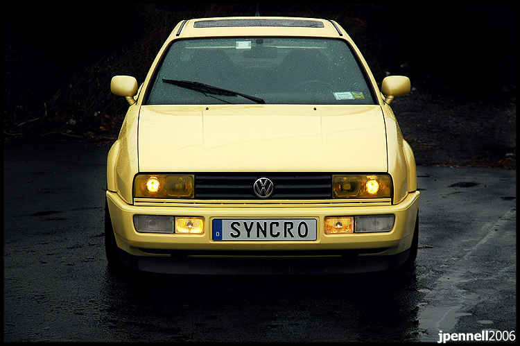

Goldie 2 Posted December 28, 2006 You could always try these.... Quote Share this post Link to post Share on other sites

vwdeviant 0 Posted December 28, 2006 You could always try these.... What use a tea tray to block out the light on the road?? :pukeright::pukeleft: I'd have to drive with a paper bag over my head (my own opinion, obviously. I'm sure the owner loves it!) Quote Share this post Link to post Share on other sites
Bendy 0 Posted December 28, 2006 that colf looks wrong!!! :lol: i remember seeing a rado with rallye lights once, didnt fit well on the wing side of the light, to big a gap and looked a bit silly Quote Share this post Link to post Share on other sites
