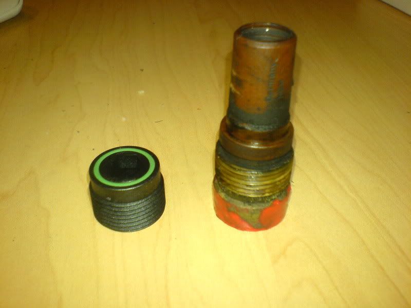

heres the heated lambda probe i bought to run my air/fuel ratio gauge. next to it is a boss and bung. the boss needs to be welded into the exhaust to allow the lambda to be screwed in. the bung is not required.

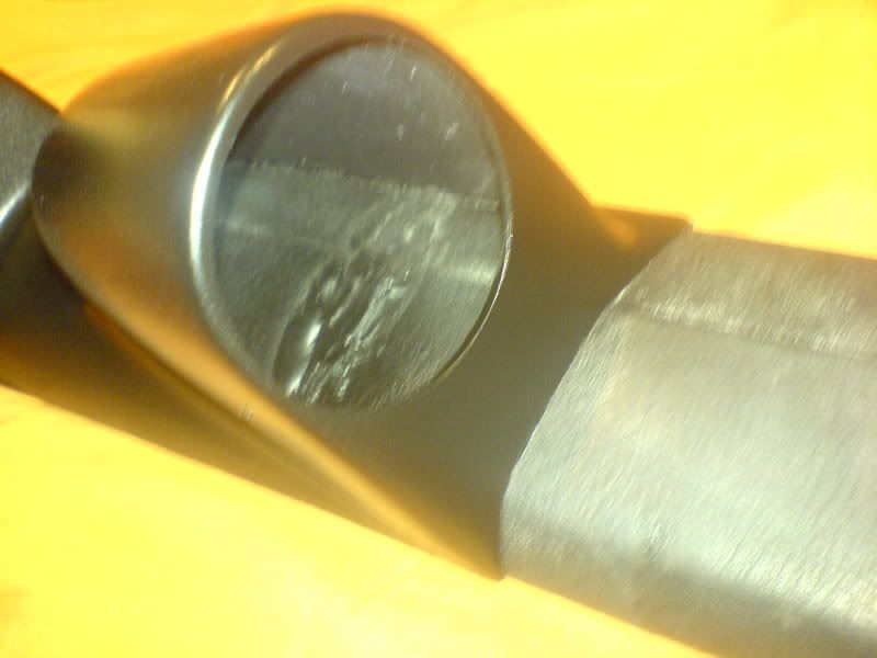

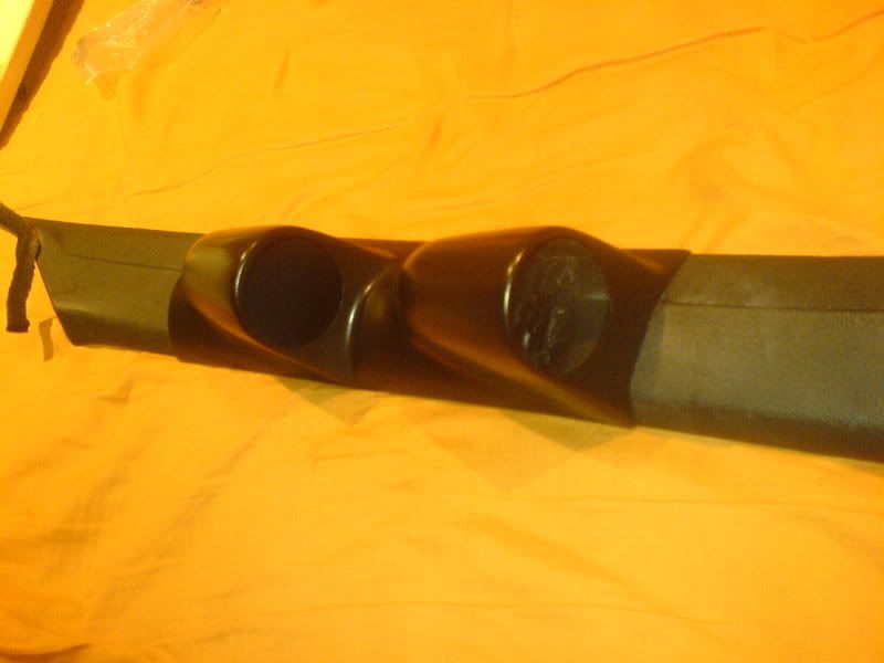

and finally the gauge pod i mounted to the front pillar. it was a universal gauge pod that was thrown in when i got the engine.it didnt fit the pillar at all so i had to fibreglass certain bits and chop out others. once that was all done and filled i sprayed it black.here it is

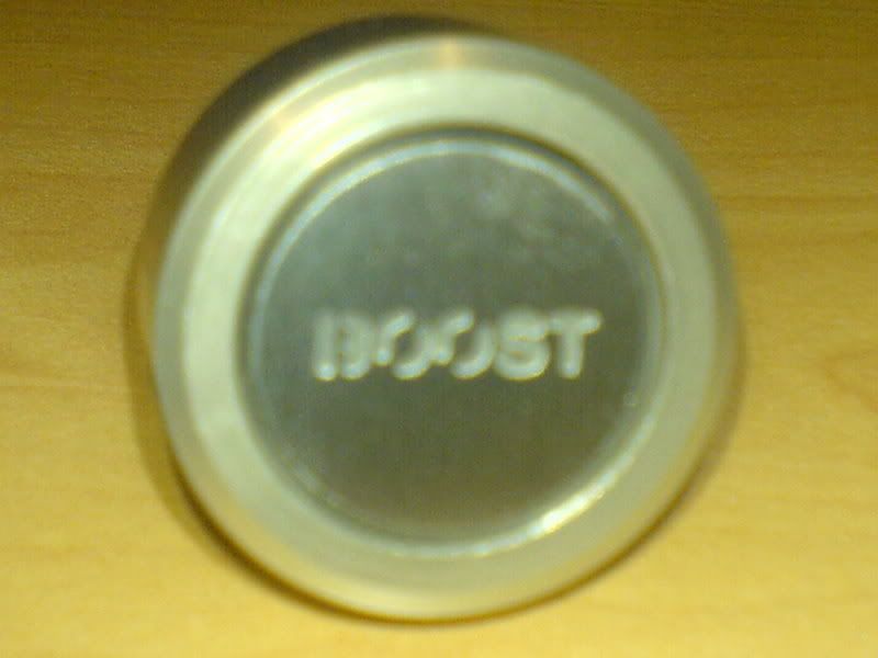

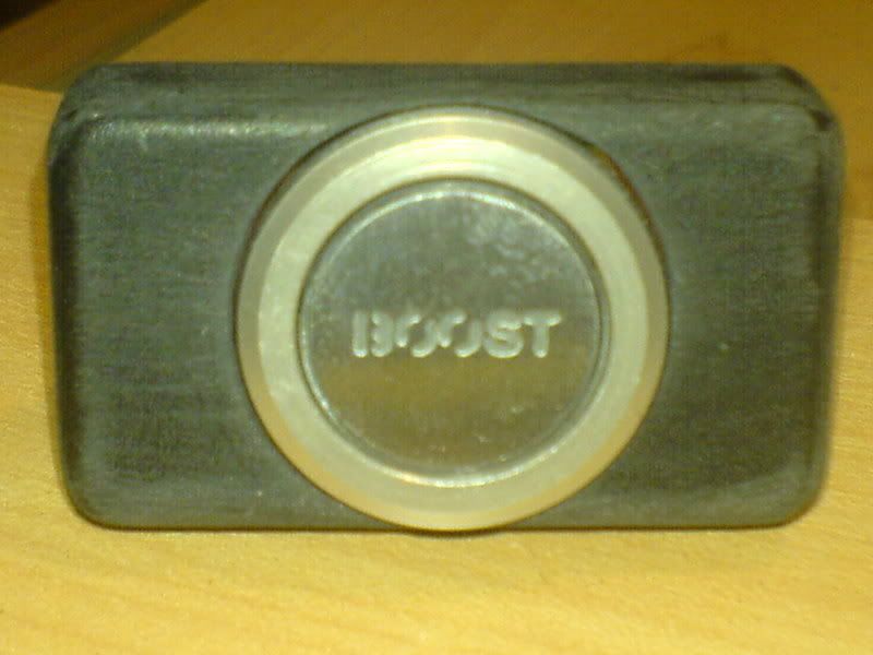

the boost button - the letters boost light up when its on!
i have the perfect place to mount it, next to the headlight switch.here is the switch blank next to it.
using a dremel i cut out a hole to fit the switch - here it is fitted to the blank

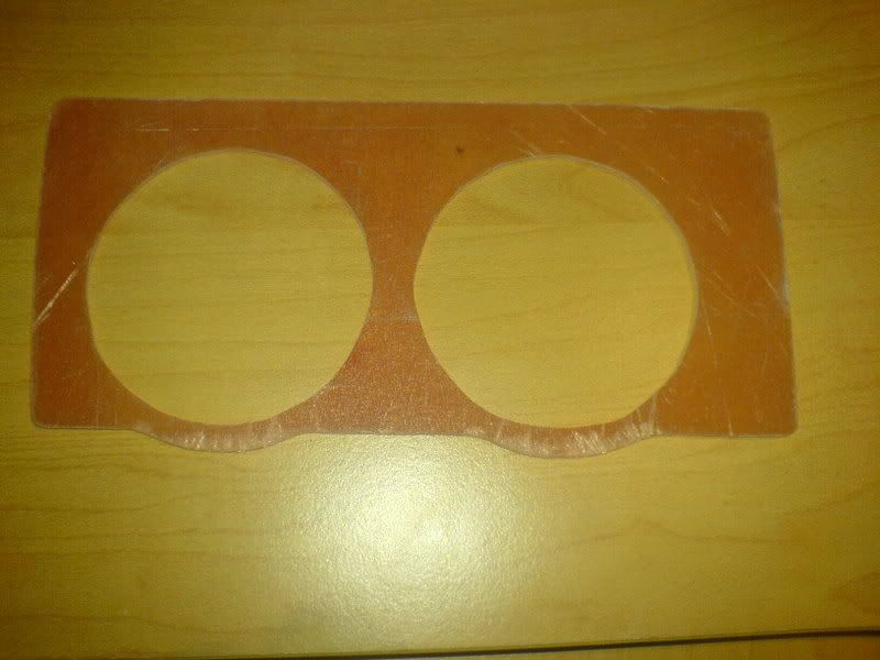

i the knocked up a flat piece of fibreglass and copied the tmeplate onto that
heres the fibreglass all cut out

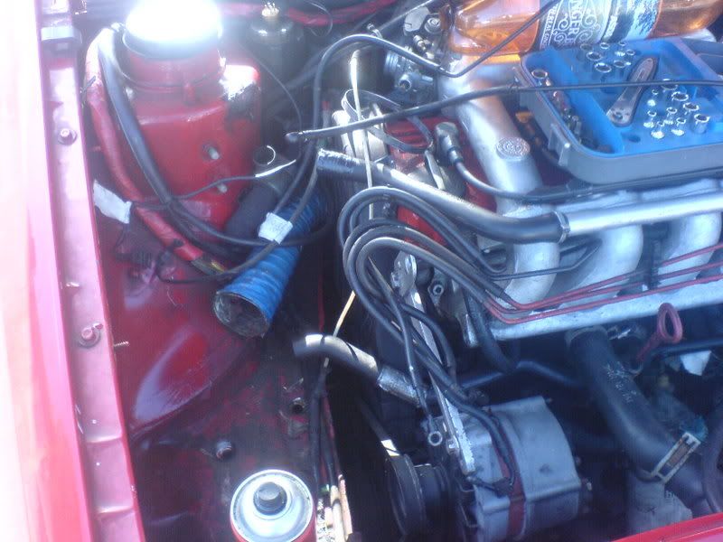

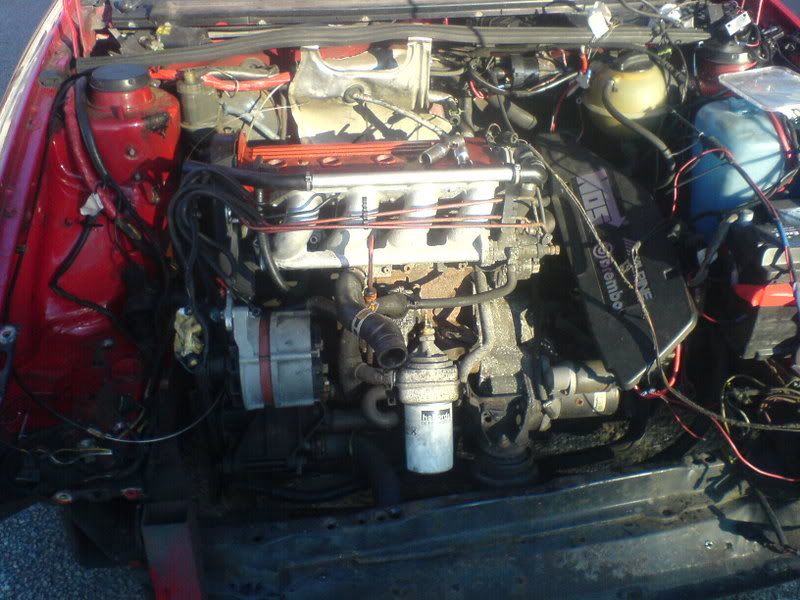

started striping out the bay,starting with the fuel metering head and airbox
forgot to take some other photos but i took the front f the car off, disconnected all pipes and wires etc.here is the engine waiting to come out.

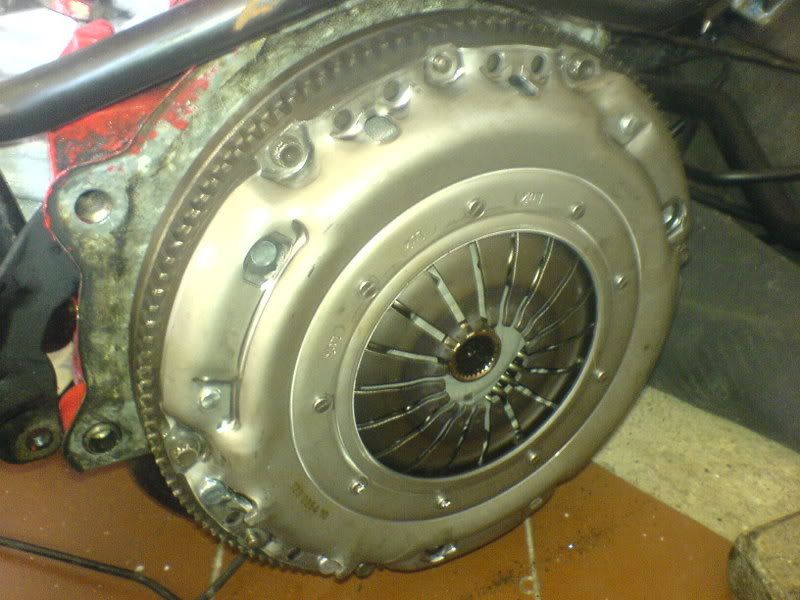

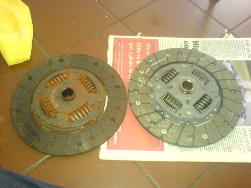

as the engine was out i thought it would be best to change the clutch.heres old and new side by side
new clutch and pressure plate fitted to the engine

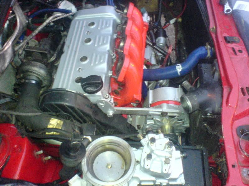

heres the new engine dropped in (praise the lord! )

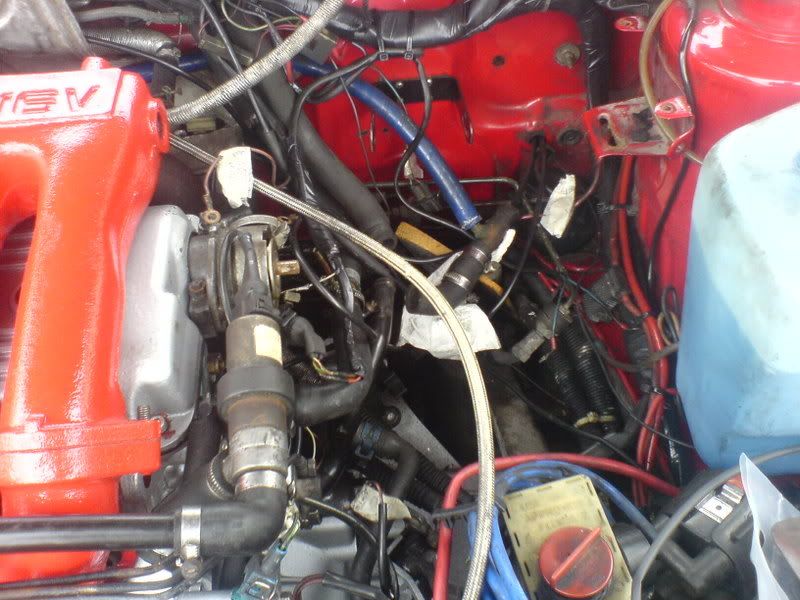

wires loook a mess but i have wrapped them up and tied them properly
today when i got in from work i stuck the new fuel metering head on, the intercooler (cant really see it) and some of the piping
pretty close pipework
turbo pics
and finally, inlet manifold and some of the turbo piping on

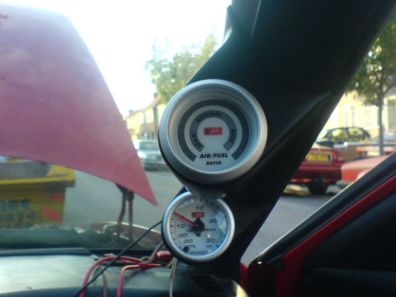

got the pillar guages in and all wired up, was a pain to get the thing back on! (all the wires are hidden now)

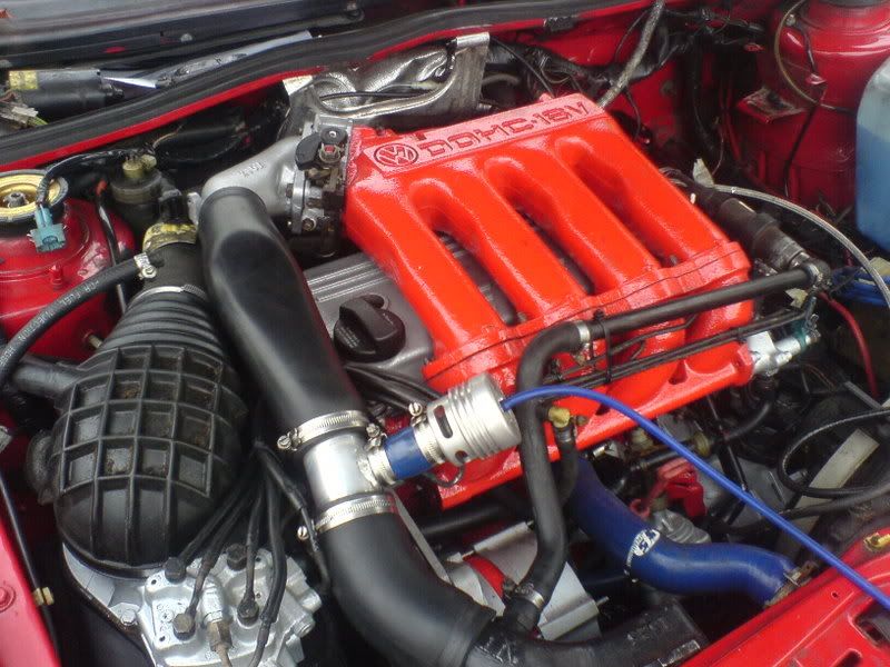

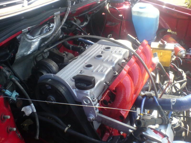

engine shots
yea its a turbo technics conversion.been bored out to 1900, ported n polished etc. 207 bhp on the rolling road printout ive got. just cant wait to drive the thing!

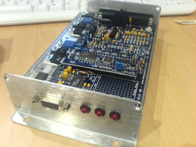

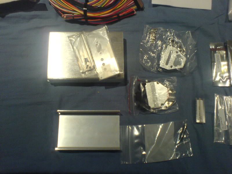

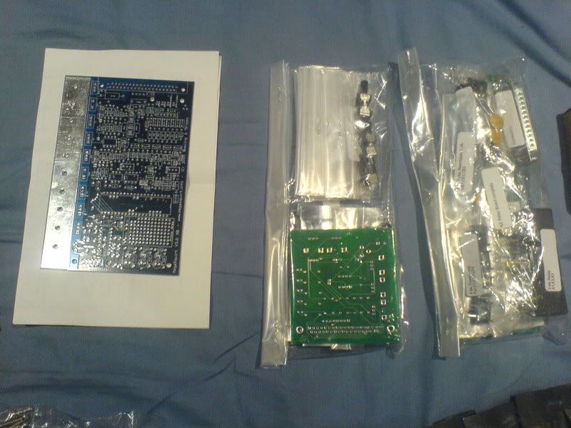

i eventually went for a megasquirt ecu kit. this has to be built from scratch (ie soldering every component on the board!)

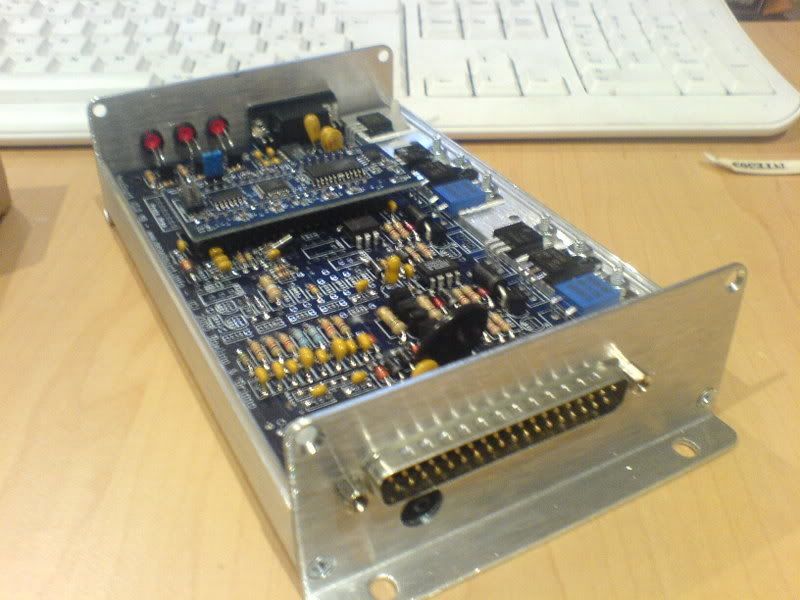

ive spent time after work doing the soldering and it is now finished, just waiting on a few other bits before i can fit it to the car.

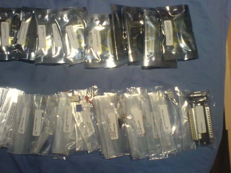

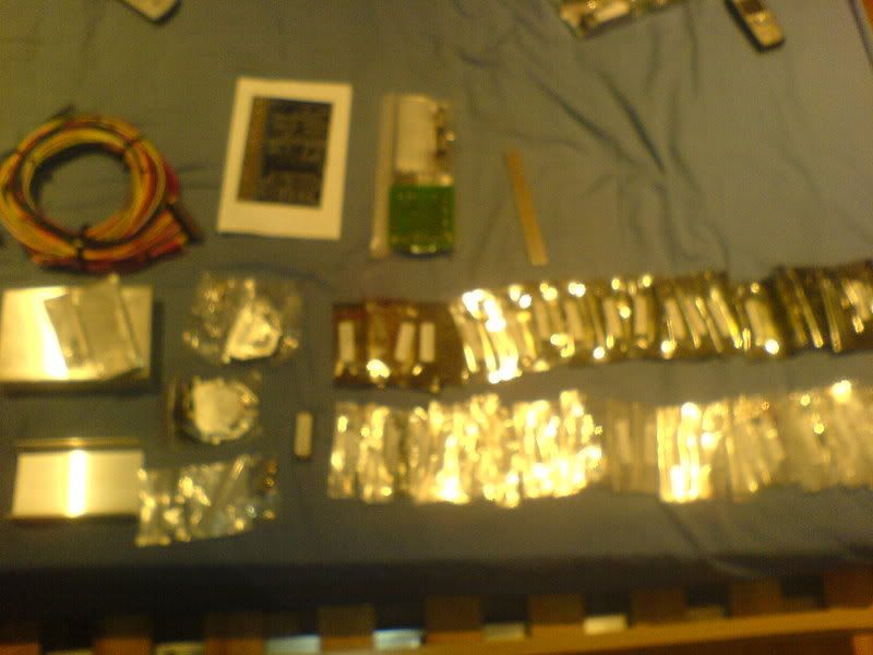

megasquirt in kit form (v3.0 board)
at the time of purchase i opted to get the stimulator - this is used to test your wiring as you build it and also to simulate engine ie revs, throttle position etc. I also bought a relay board to make the wiring neater and simpler

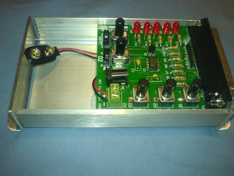

and here is the megasquirt assembled

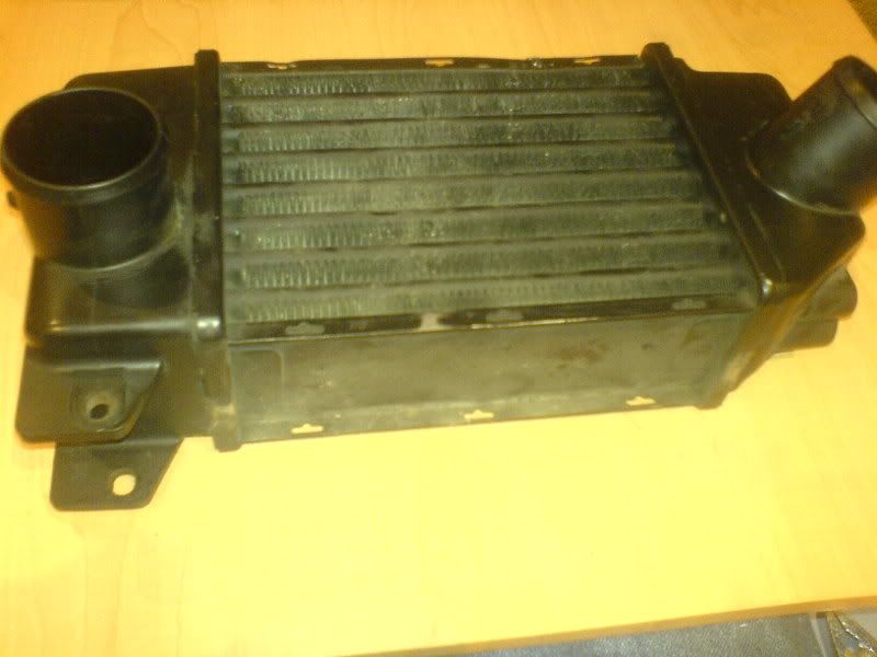

rs turbo intercooler - i will be going bigger at a later date, the turbo technics one i have is not in a very good state and this is almost a straight swap.

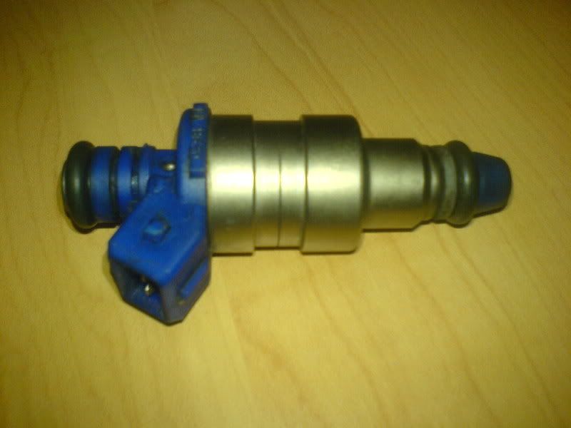

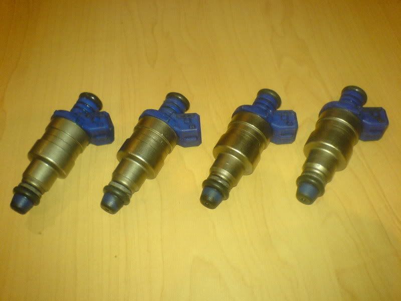

heres the injectors i bought, they are rs cosworth ones so i think they will flow enough for my engine!

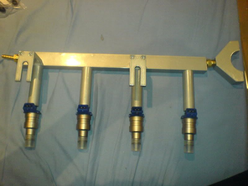

i had to buy a fuel rail to clear my inlet manifold so i got this one from america

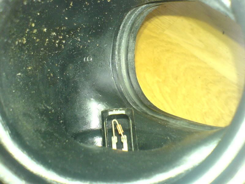

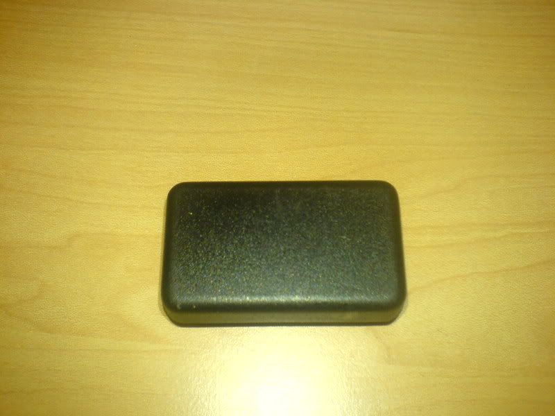

and finally heres the intake air temp sensor - needed for megasquirt to work

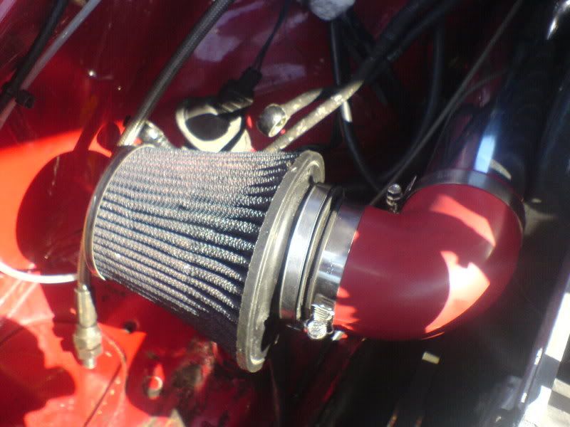

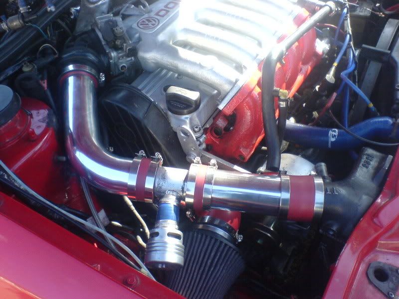

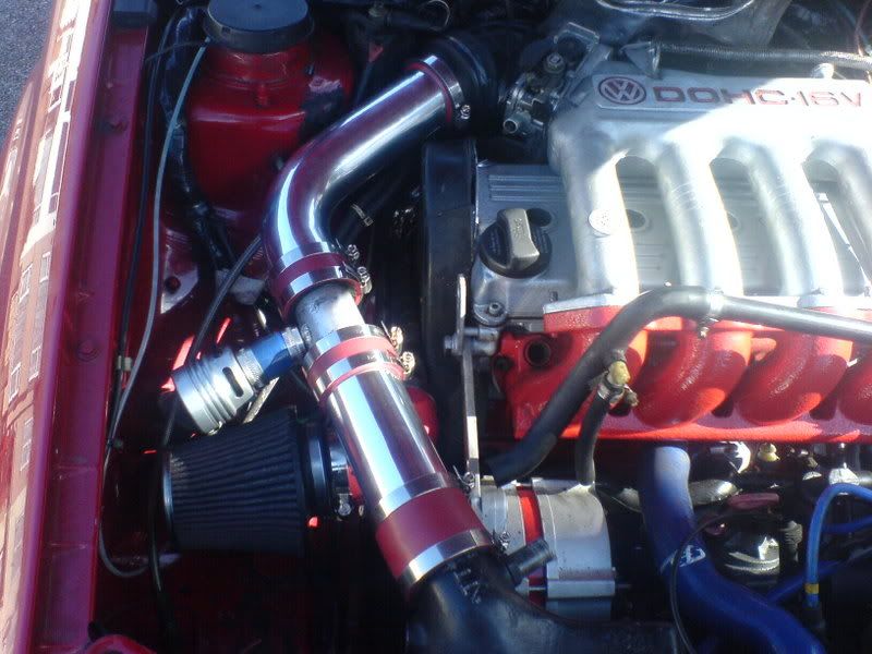

measured up and cut the turbo piping today

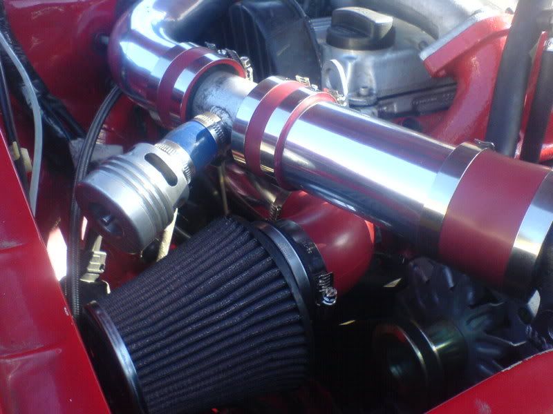

heres a few pics of air filter pipe
and these pics are of the intercooler to throttle body piping - if you are wondering why my inlet manifold is silver its cos ive put the old one on as the throttle body on it is the same shape as the one im expecting to recieve.

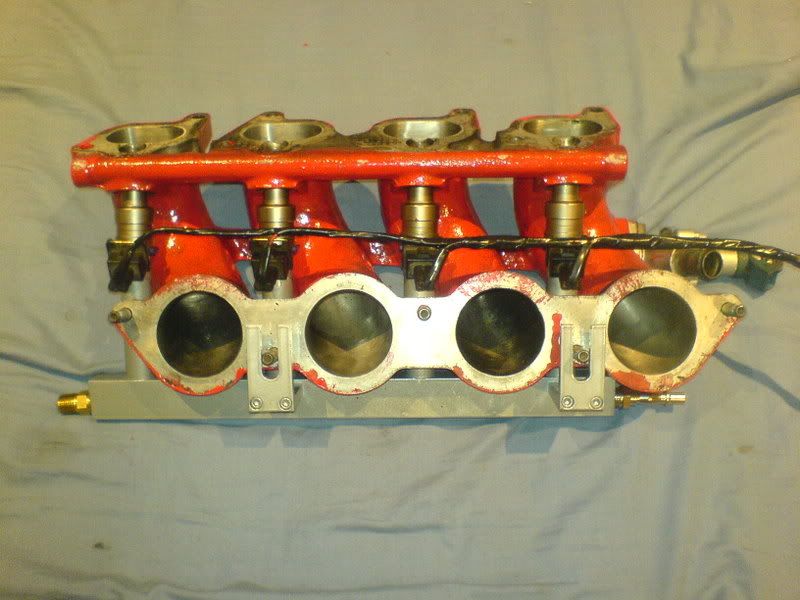

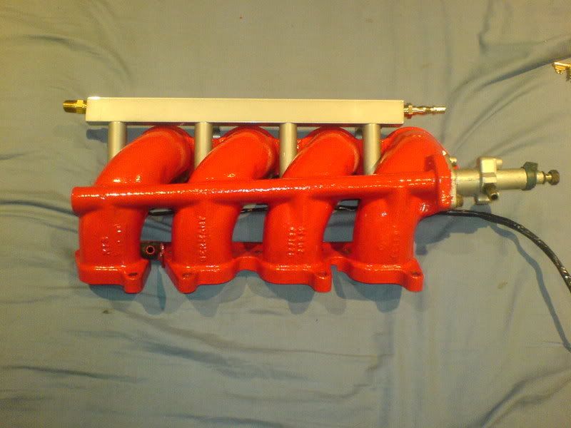

fuel rail fitted to the inlet manifold

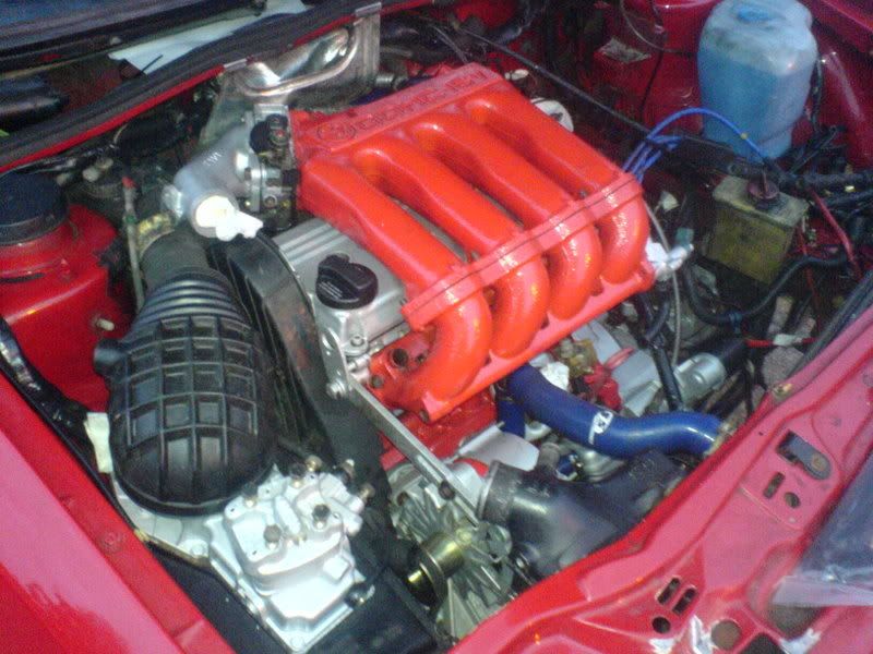

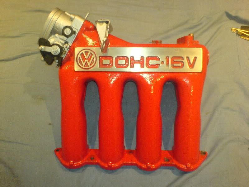

and heres a pic of the upper half of the inlet manifold with the audi throttle body screwed on ( it visually looks the same as the old one but has the throttle sensor on the bottom) i also decided to polish the are around the lettering to bring out the writing more.

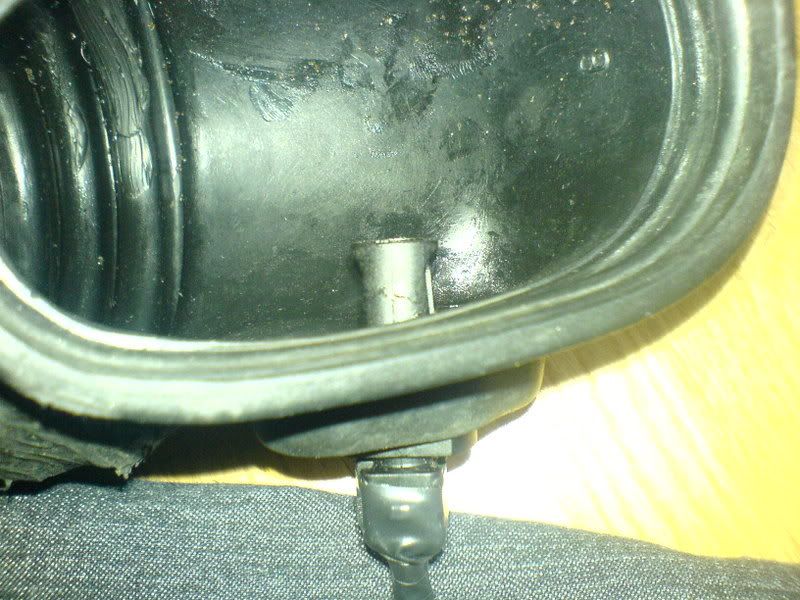

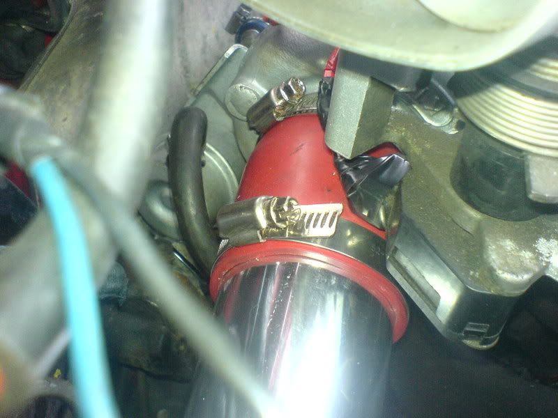

heres where i mounted the intake air temp sensor (its in the rubber part that connects to the throttlebody

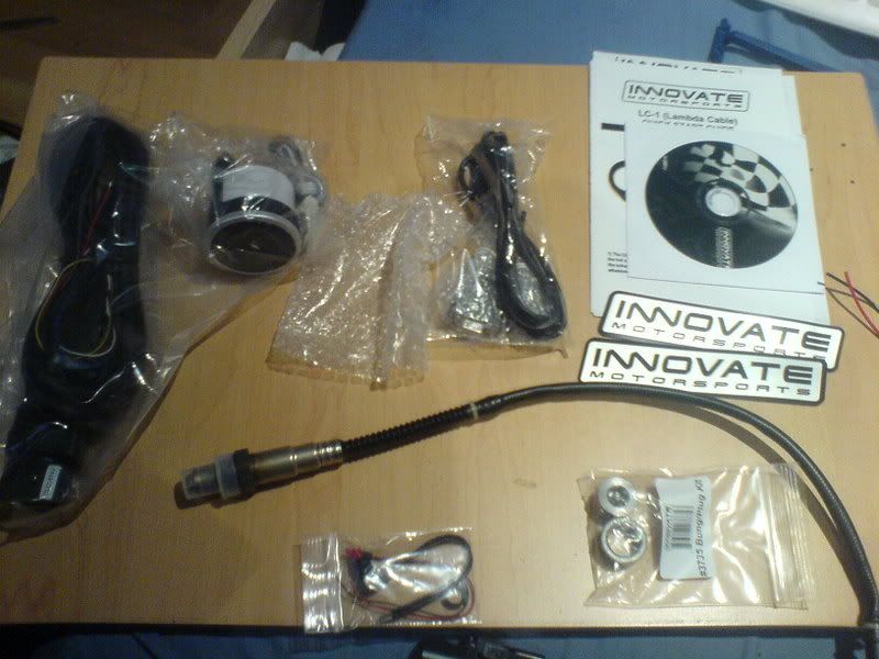

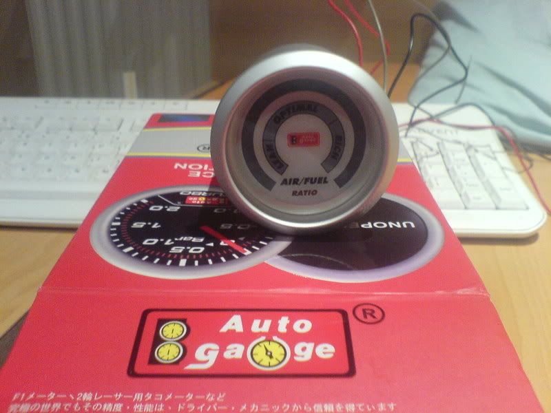

and my wideband kit turned up!

Good stuff! I see you went for the a/f gauge too!
I'm halfway through installing the same kit! It's not too bad a job, there is quiet a bit of wiring to route though.
yea i got the gauge with it,kinda pissed cos all the ones i got match n this doesnt lol. i did see quite a few wires but once everything is up and running i plan to get rid of the original vw loom and redo only the ones that are needed.

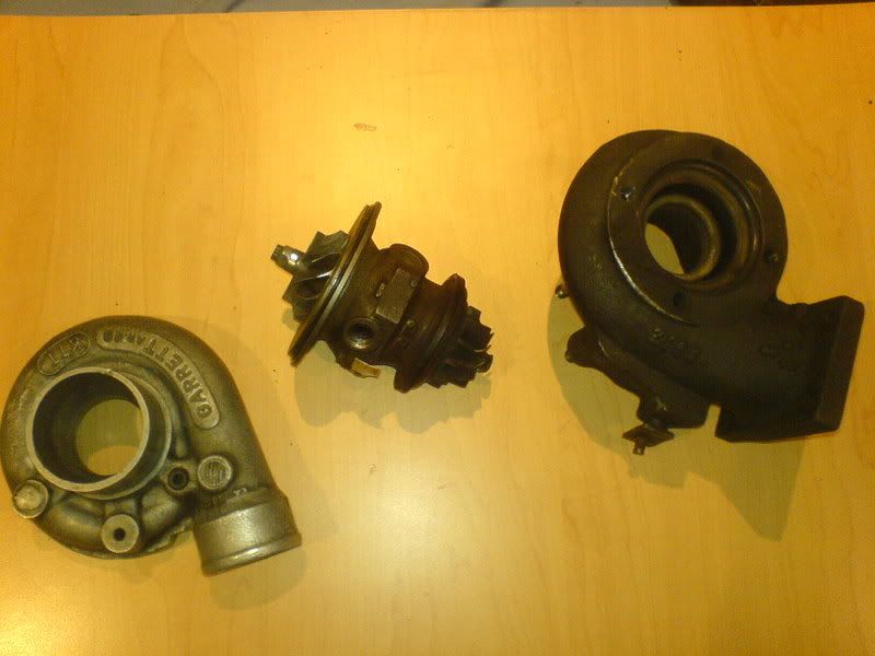

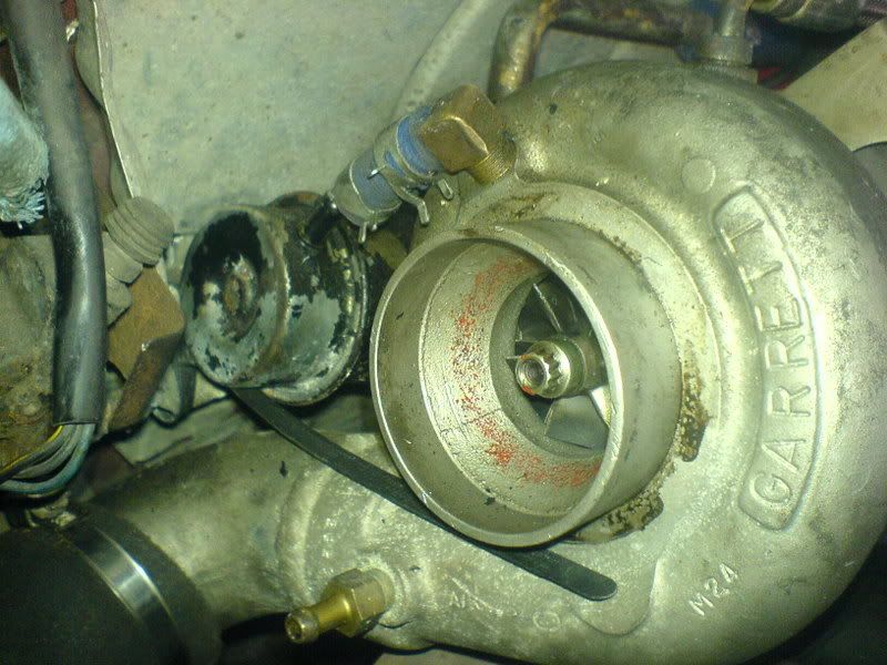

changed the t 25 turbo for a t 28 (direct swap) however the turbo had to be pretty much stripped so that the compressor outlet faced the correct way
turbo reassembled

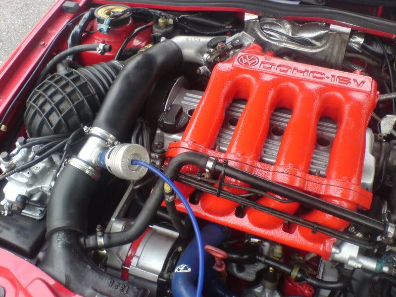

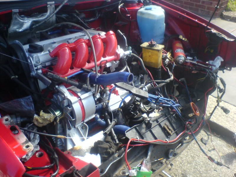

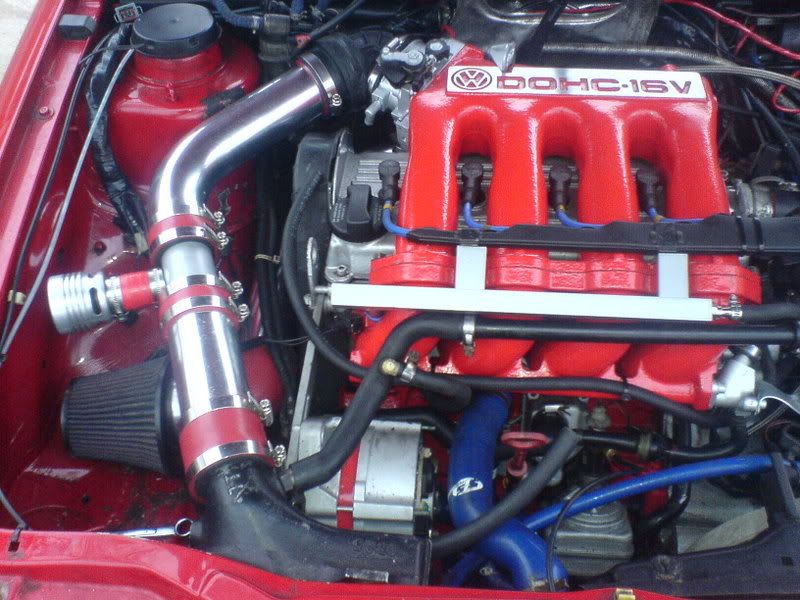

i put the exhaust manifold and the turbo back on and got most of the pipework back on
some close pipework!

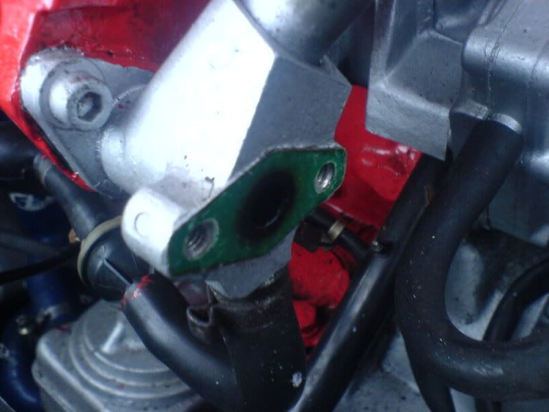

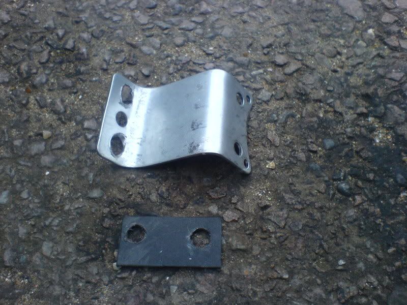

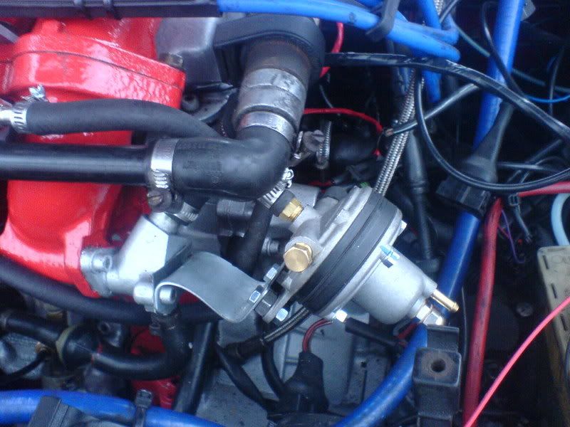

had to figure out where to mount the fuel pressure regulator. found the ideal spot. as the cold start injector wont be used i decided to make a plastic blanking plate and use the bracket for the fpr to hold it in place.
the cold start injector hole
heres the bracket and the plastick blank.
heres the finished article

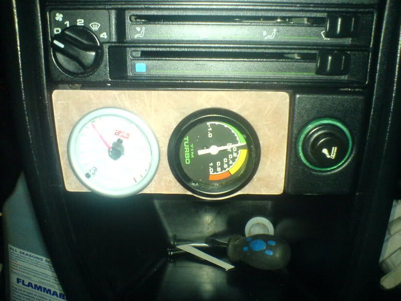

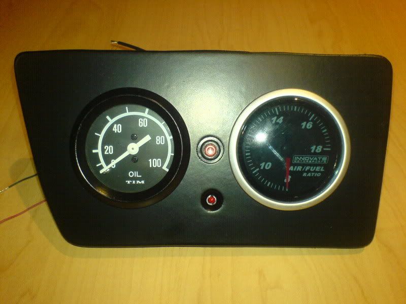

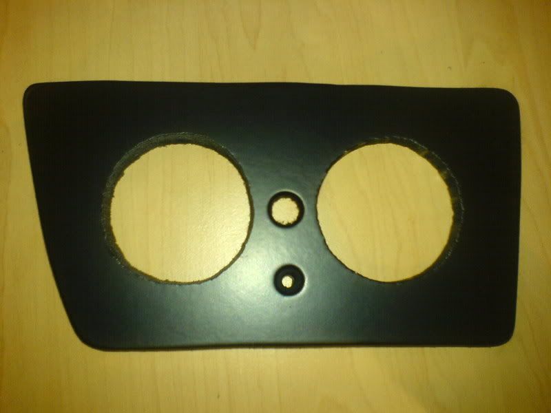

i wasnt really feeling the position i made for the gauges (in place of the ashtray) so i made up a panel out of wood to go below it. flattened it down with fine sand paper and gave it loads of coats of black flexable bumper paint. heres the results
with the oil pressure and air fuel gauges ( oil guage will be changed but i cudnt be arsed wasting more money just yet as this one came with the car and works fine)
