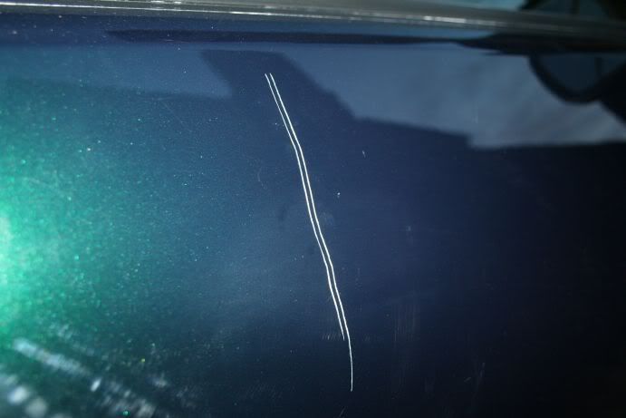

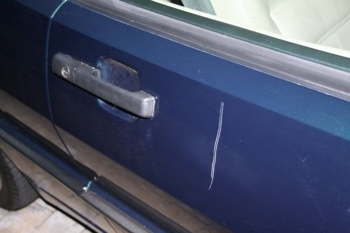

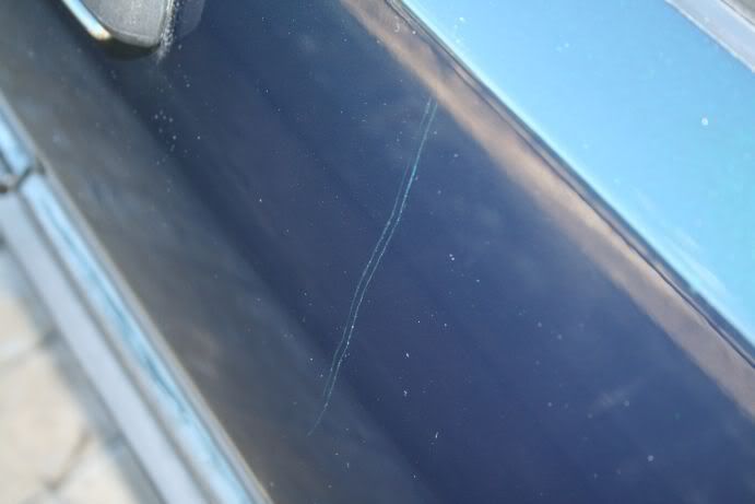

There are 2 other scratches on the driver's rear quarter panel but this is the deepest. I was wondering, instead of having to respray the whole door, would I be able to "fix it" using touch up paint etc etc? Has anyone tried this? Can anyone give me any tips or perhaps help me out in person?

If you want a very good finish then you would need to touch it up, wet sand it then polish it.
Basically what you do is touch it up with a paint/lacquer mix until the paint is raised above the original paint. Leave it over night to set. Then using about 2500-3000 grit wet sand paper (soaked for about an hour in soapy water) and a flat backing plate, gently sand it down flat. Then once you have a flat finish you need to machine polish the sanding scratches out using a compound polish on usually a wool pad or at least a cutting pad, followed by a finishing polish on a finishing/polishing pad and that will do it.

No worries mate. It might not turn out perfect but it will certainly improve and i have seen examples of touch up wet sanding that look as close to perfect as you could get, most commonly with stone chips but scratches have been done.
One advisory though is if you are not experienced with machine polishing with highly abrasive compounds etc then you may want to get someone else to do it as you could very easily burn through the paint and foobar it up. There are a few guys on edition 38 that can do it if you go on there much and you may get lucky and have someone near you who are willing to do it for a few pints or atleast fairly cheap. Also you may need to take into consideration that if you were to do that you may need to keep polishing as otherwise you will have a really shiny patch and the rest dull. Wet sanding actually flattens the orange peel effect in the paint from factory, so that area is always going to look better than the rest of the panel/car when done.

Definately cant do it by hand mate, you would need arms like Arnie just to make a slight difference, it needs to be done proeprly else the finish is left worse than before because you dont cut it back far enough.
It can even be done wrong by machine polishing, for example a Porter Cable (very popular with beginners as its an orbital/dual action polisher therefore doesnt generate as much heat as a rotary and so is safer to use, but takes longer than a rotary) isnt good enough to remove sanding marks fully so you need a rotary, and even then you still need to use a highly abrasive polish with a high cutting pad (wool pads are most cut without generating too much heat)
Here are some very good videos from the guy at Meguiars in America, there are 5 parts but these 3 show what i mean.
- This starts off showing basic tehcniques on how to use a rotary polisher and other basic stuff but towards the end he starts going into wet sanding, he explains how to do it and whats best to use.
- This one actually shows him wet sanding it and then start to machine polish it out, he explains the use of a wool pad and compound polish etc. Then he starts talking about moving on to polishing it to bring up the shine.
- In this one he actually starts polishing it to bring the finish up, but mainly in this one he shows that a PC is not up to the task of removing sanding scratches as it doesnt generate enough heat like a rotary does (about 7 minutes in). And thats using an abrasive polish (more abrasive than Scratch-X but not very abrasive in machine polishing standards) and by machine and it doesnt do enough so working by hand you will never get a good finish.
Like said really, by all means if you want to tackle it yourself and you have a polisher then go for it, but i would get a scrap panel and practice first before tackling your own car. Otherwise i would just get quotes to get it done properly. And like i said before, there are guys on Editon 38 who do this as part of their detailing business and travel all over the country so they might do you a good deal being fellow dubbers.

There are mixed views on whether lacquer is needed or not, on some of the stone chip repairs i have seen done the guys have just used single stage paint to fill it in, then wet sand and polish etc and you could really tell the difference. But i have also heard of guys putting lacquer on as well. I think for stone chips singe stage is good enough but i think with a scratch like that you might need to lacquer it as well. I will try and find you for you.
HERE is a good guide showing how to repair stone chips. The guy used paint AND lacquer for these and the results are superb, you woudlnt even know there were any stone chips there. So i would imagine you would do the same with your scratch, but he doesnt say how much paint followed by how much lacquer which is a bit disappointing but he says that it needs to be above the original paint lave so im guessing maybe fill the scratch level with the paint, then put lacquer on it so its raised above the original paint level perhaps??
He also reckons you can polish it out by hand using 3M compound which is very abrasive, but i reckon it would be hard work and dont think you would get the same finish you could get from a machine polisher personally.

This is what I've ended up with, I've used paint and laquer and then wet sanded it down and then buffed it quickly, but the touchup paint is nowhere near matching the original paint.
Anyone any ideas why this has happened? How can I fix this?
