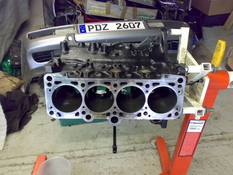

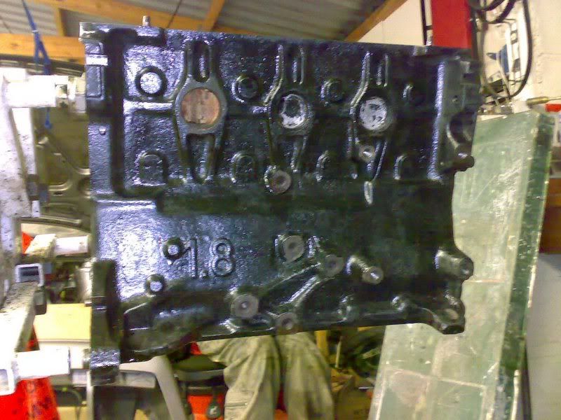

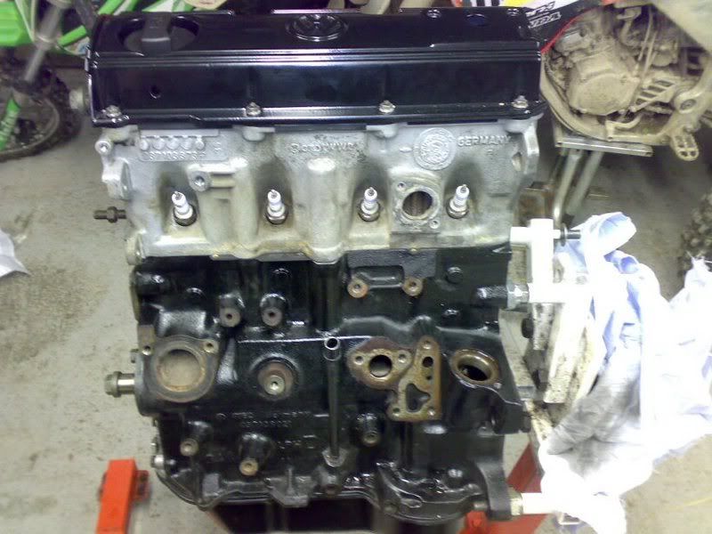

Started on some more bits on the rado last night, We and Oliver started cleaning the newly bored out block, and cleaning out the crap left in the rocker cover from the powdercoating :D
Heres some pics of the block :D all nice and clean now a 1.9 :D

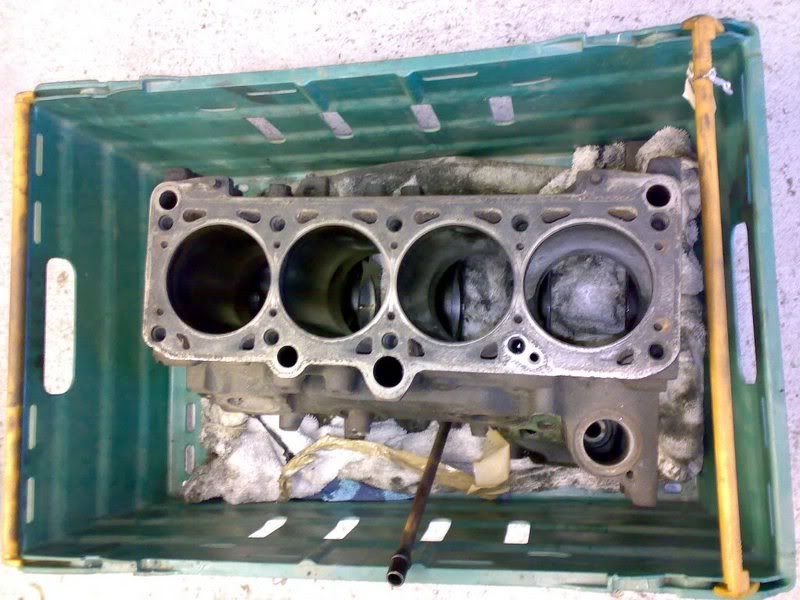

Heres the other block that we didn't use ing the end,

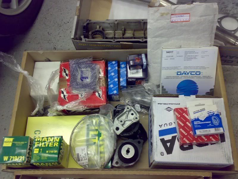

After all was clean and no machining dust and crap could get in the engine, we sorted out all the bits that i had been buying over the last month.
100's of pounds worth of stuff there, but its all needed :D

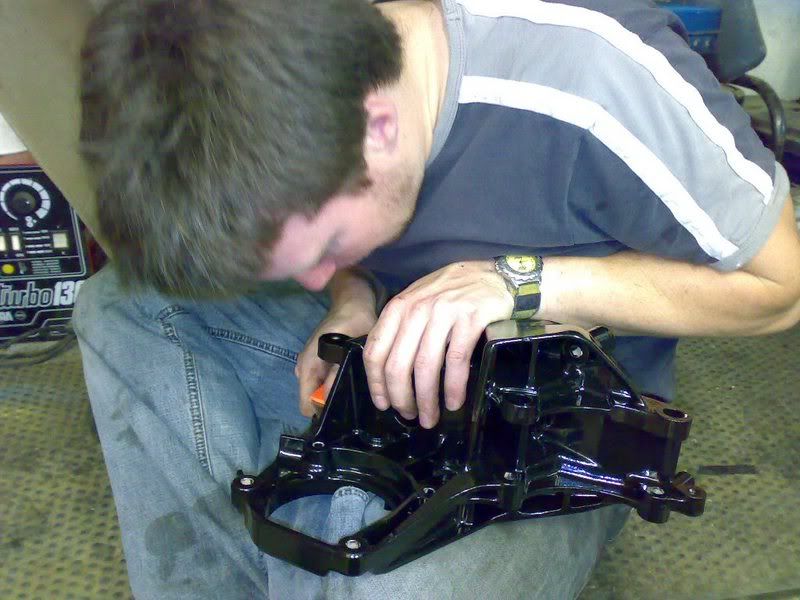

We then had a look at the bits i've had powdercoated and realise they didn't tape off all the bits that i wanted, oh well, me and Oliver use a stanley knife and cut off the powdercoating in the unwanted areas, and all id well again lol.
Oliver hard at work...

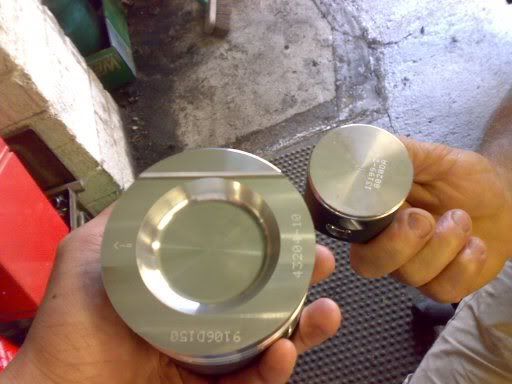

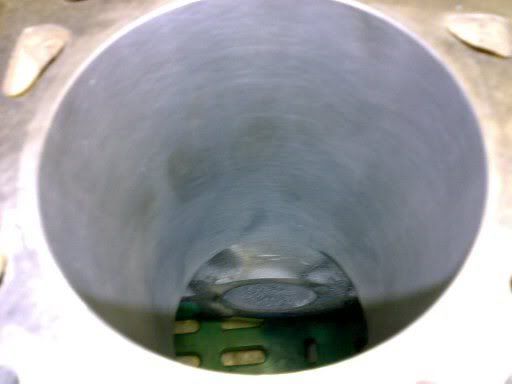

Got the pistons from Gwerks on wednesday (cheers Darren and Rob), and got the block bored yesterday, took it down to auto service and spares 7:30 in the morning and they had it done by 4 in the after noon :D
Heres some pics of the block and the new pistons :D
heres a comparison of my new wossner pistons against Joes motorcross bike piston :D

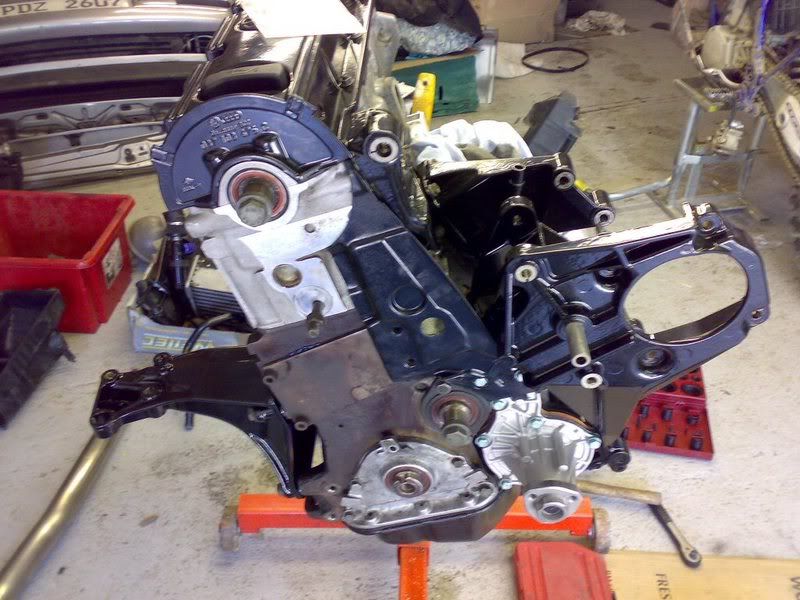

The bottom end was built up over the weekend, Sunday me and Oliver got up hungover and went out to start on the car.
We started by stripping the crank out of the old block and transfering it and the bearings etc over to the new one
With the crank in Oliver stared fitting the pistons to the rods,
after that he stipped the rings on and we fitted them into the ready and waiting block.
We then flipped it over and fitted the windage tray (cheers Jim) and VAG oil pump
Screwed the baffeled sump on (cheers again Jim) and it was finished :D
heres the money shot :D

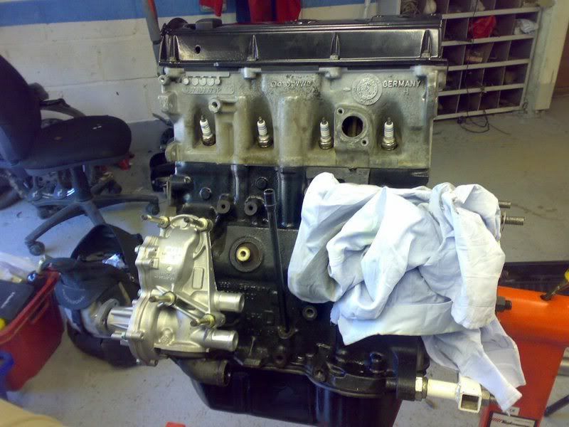

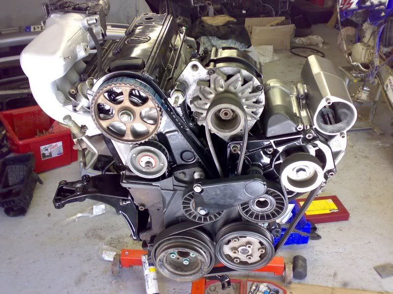

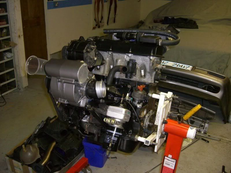

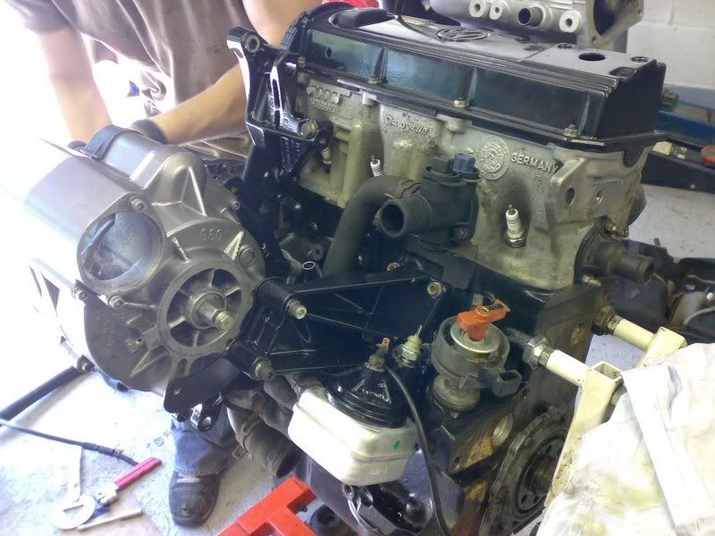

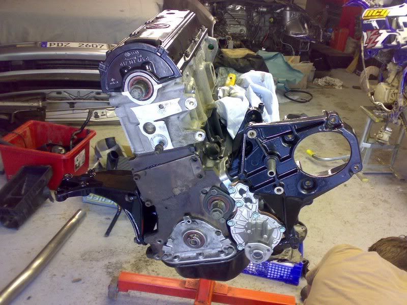

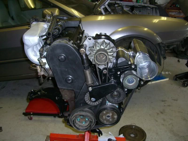

We strated off with bolting up the auxiliaries onto the lump,
Water pump
some brackets
pulleys
dizzy
cam belt

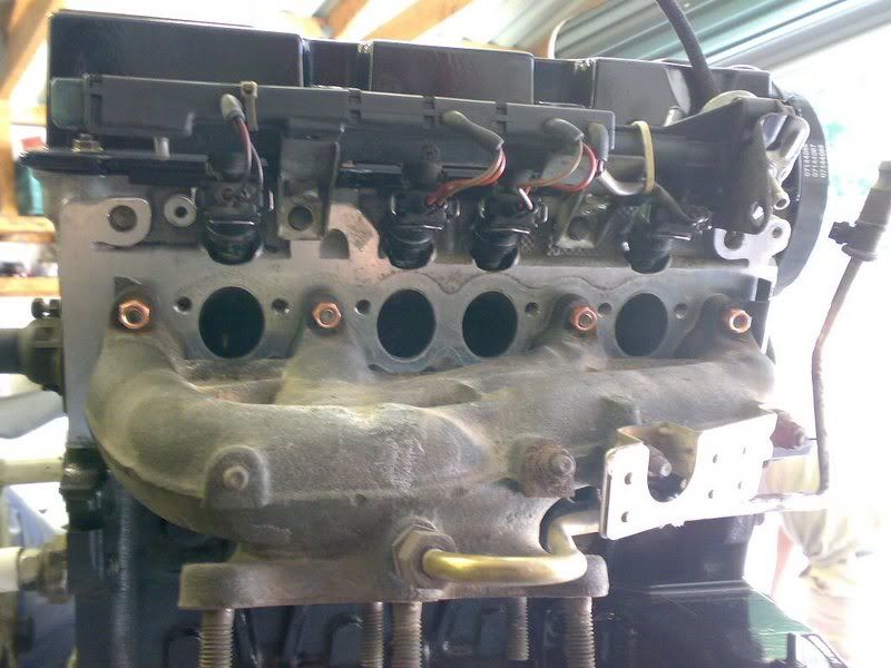

exhaust mani on with new studs and nuts
injectors

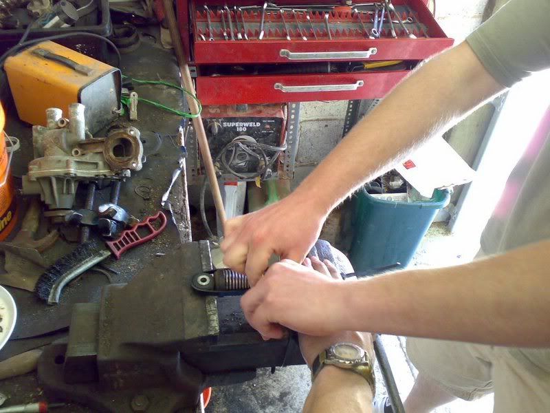

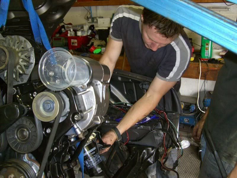

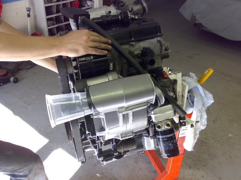

Changing the belt on the charger
Bolting up the charger

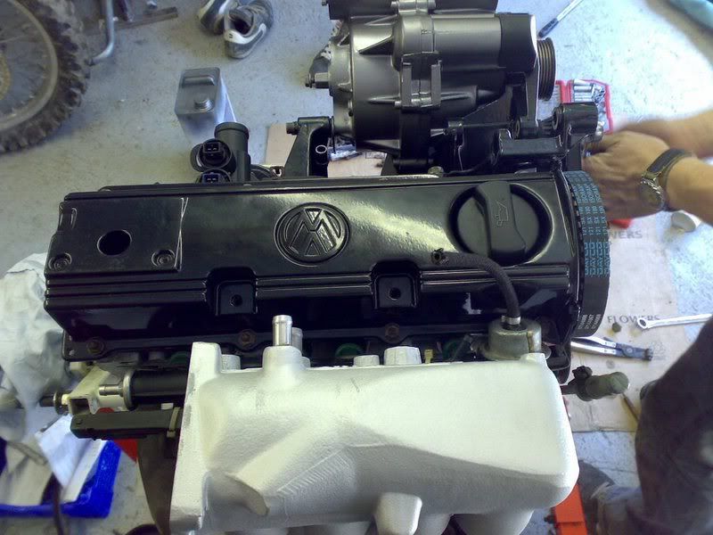

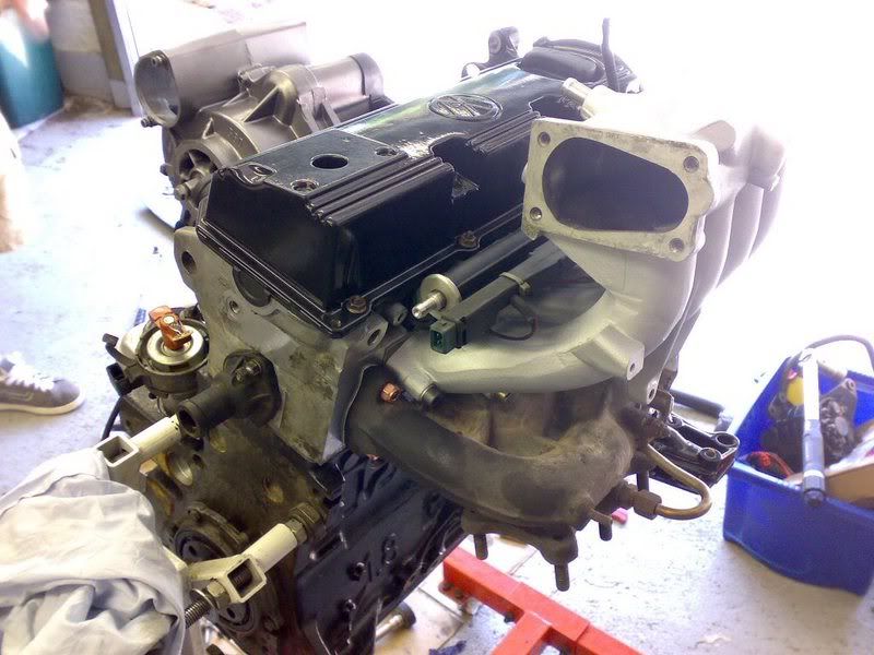

inlet mani on with all new bolts
Alt on and all the pulleys

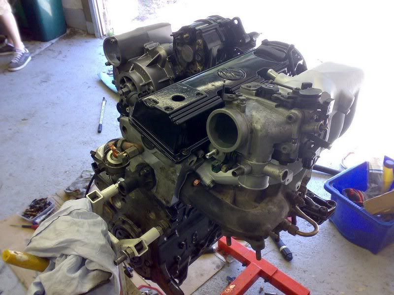

throttle body on
new water flanges and some old hoses (my new ones aren't here yet :(
Olly and Al playing russian rulet with the charger belt tensioner (it has to be compressed to get it on)
Tensioner and isv on

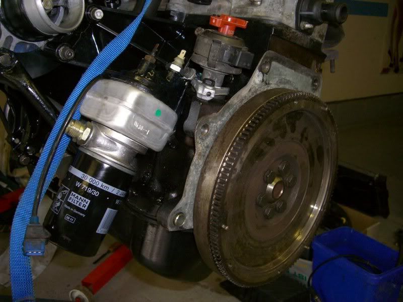

oil filter and cooler sandwich plate on
And thats how we left it, everything on and ready to go in :D

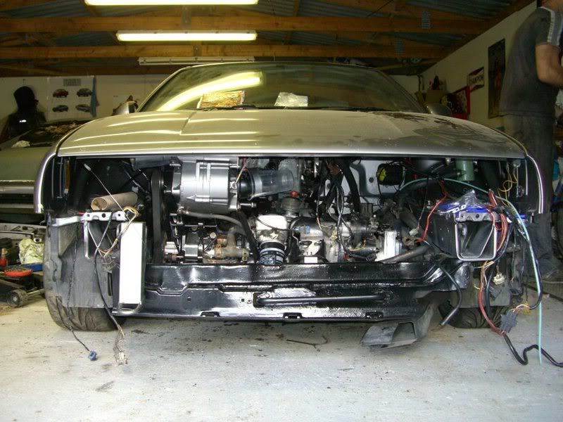

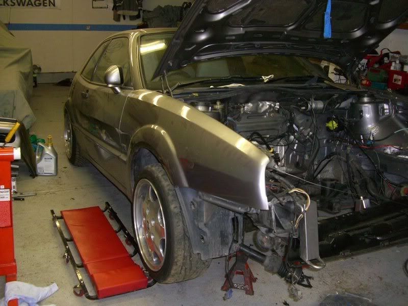

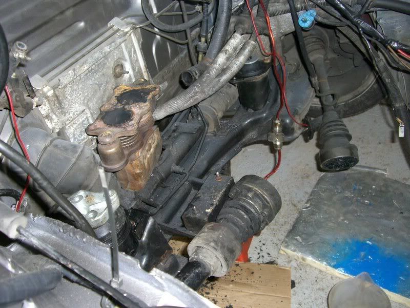

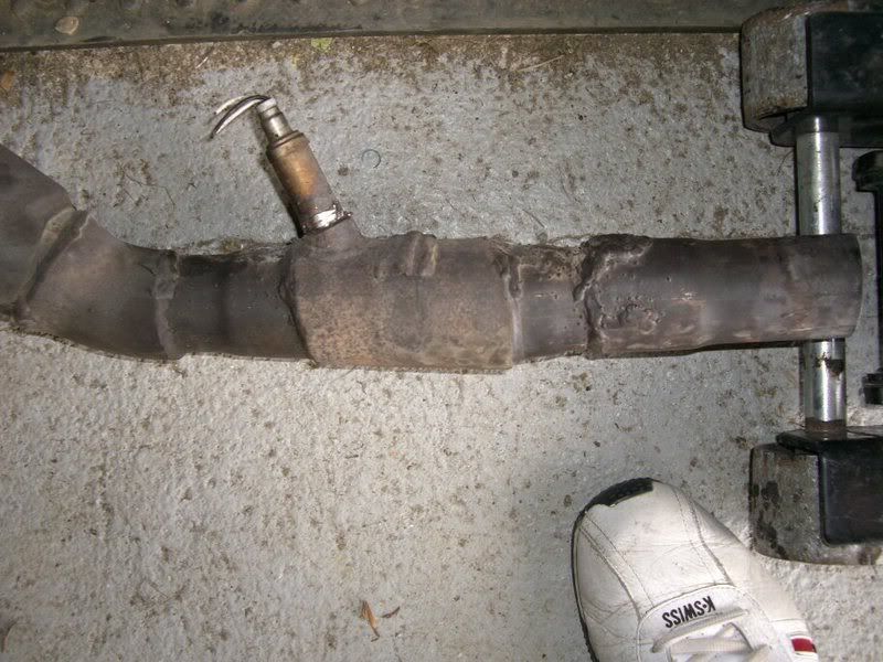

First of all we moved the car out and jacked it right up so Oliver could have a good look at the exhaust, and what needed to be done,
after a little bit of hammering and wiggling we got the old down pipe off.
This down pipe has been fully bodged, welded up and messed around with more times the Jordan lol.
quick pic of how the engine was left over night

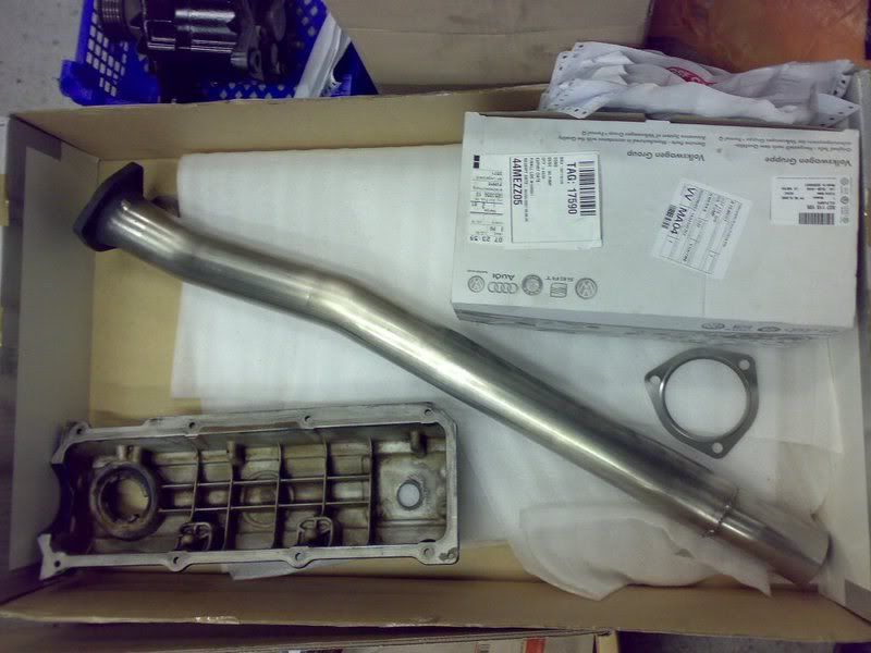

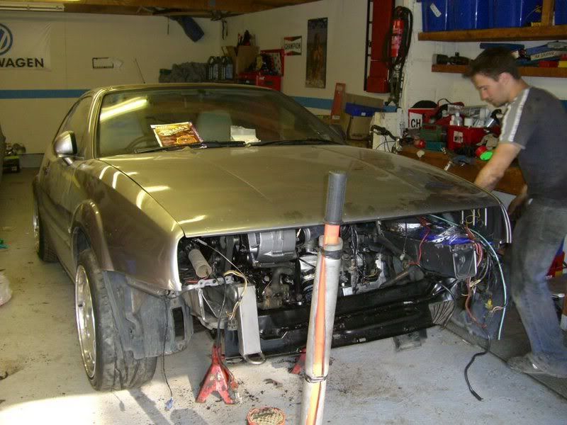

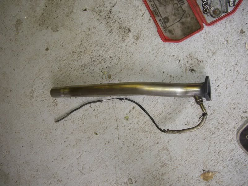

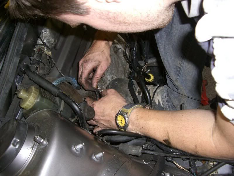

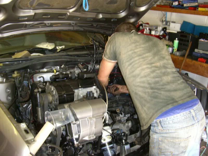

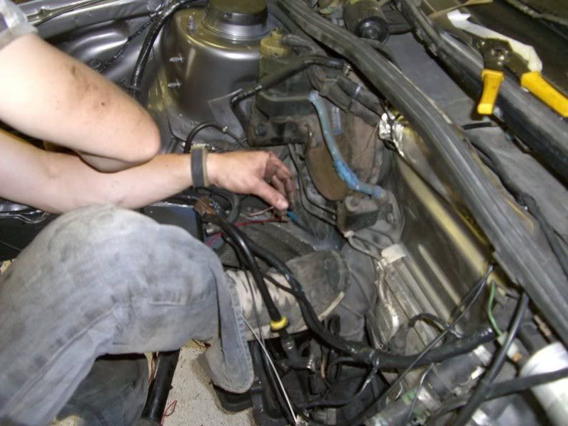

Oliver wasted no time in climbing into the bay to sort out the lamba wiring, i bought a water proof connector block to sort out the stevey wonder wiring, so we wouldn't have to worry about that again.
We whipped the old lamba out of the bodged down pipe and screwed it into the new cat bypass pipe i bought :)

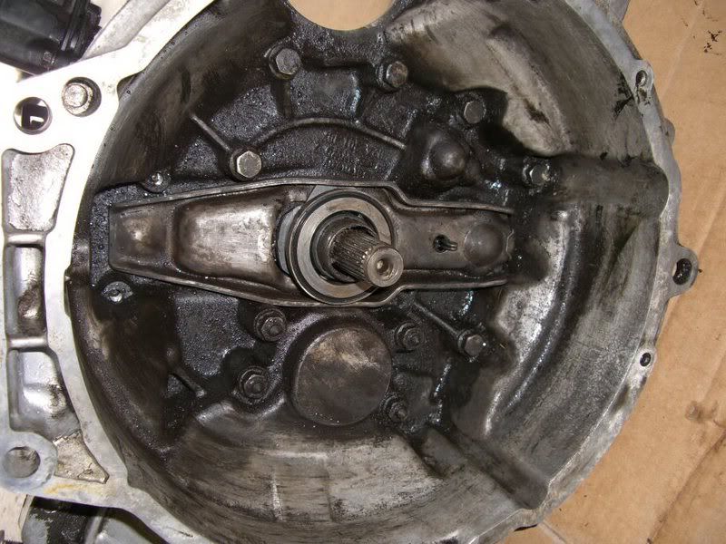

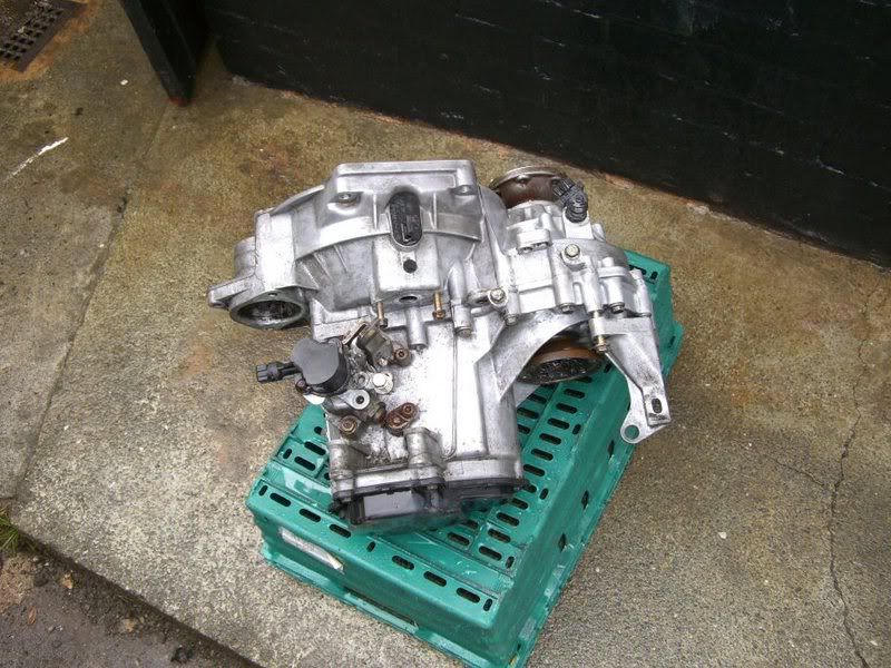

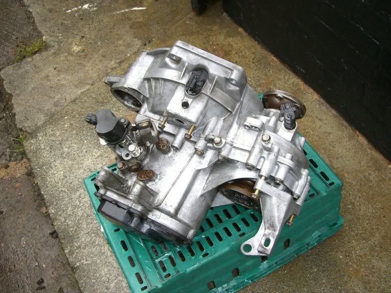

While Oliver was playing with the wiring i went down and finished cleaning the gearbox, it was pretty clean, but i wasn't completely happy with it. so after some Jizzer and a pressure washer the results were

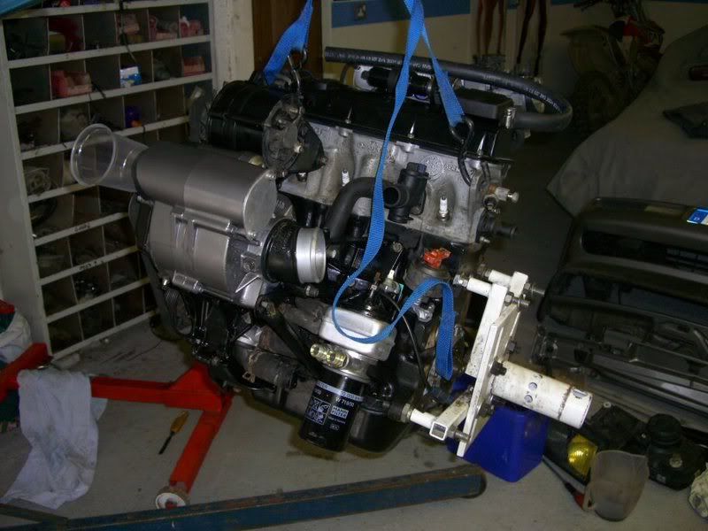

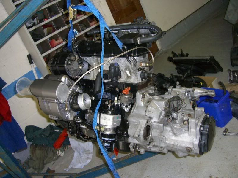

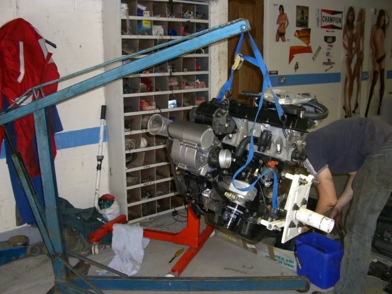

Then we whipped the engine crane out again and tided the engine up and took it off the engine stand so we could get at the gearbox end
Heres Olivers finished wiring job,
clutch bolted on,

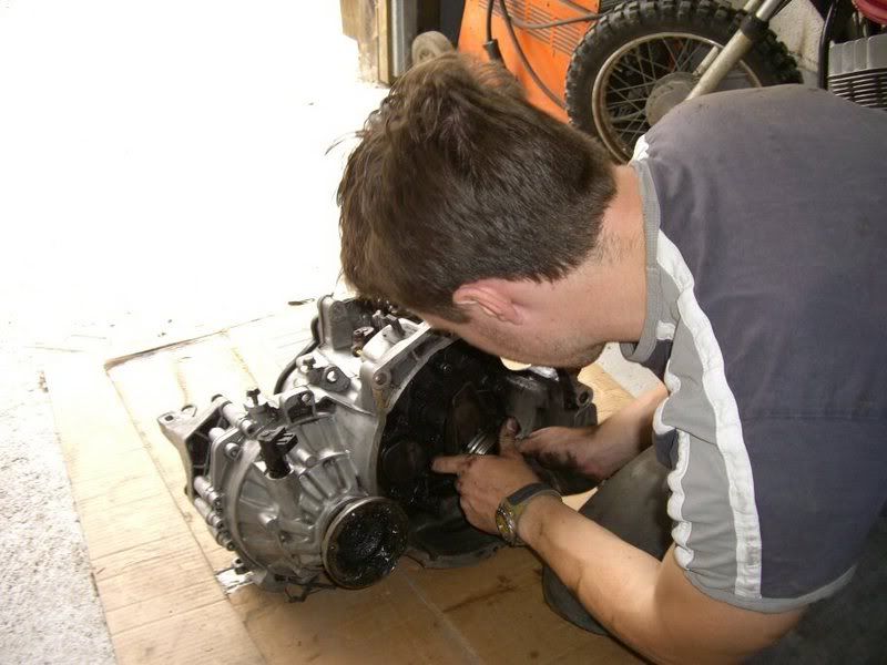

Oliver changing the bearing in the gearbox
Gearbox on

New second hand downpipe in place

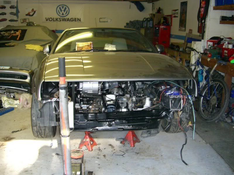

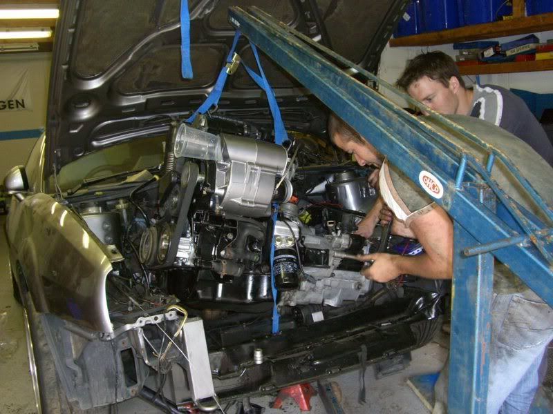

Me and Olly playing around getting the engine in,

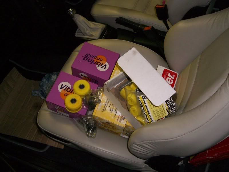

Some goodies that will go on in the near future :)
ass shot
Me sorting out the gearbox mount

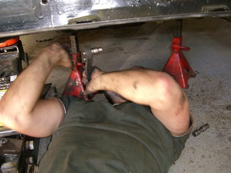

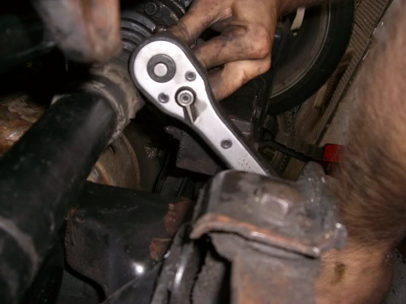

I was then sent under the car to do the dirty job of doing up the drive shaft bolts,
And its all in :D Woo

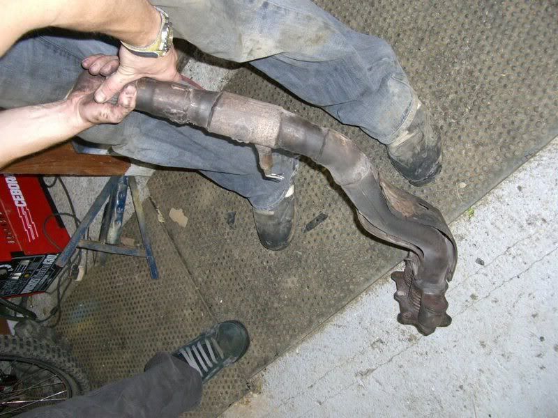

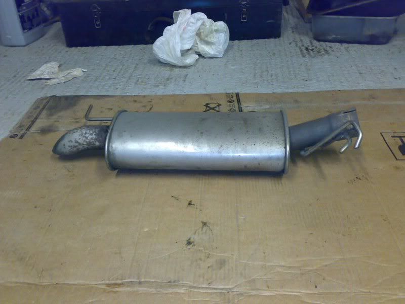

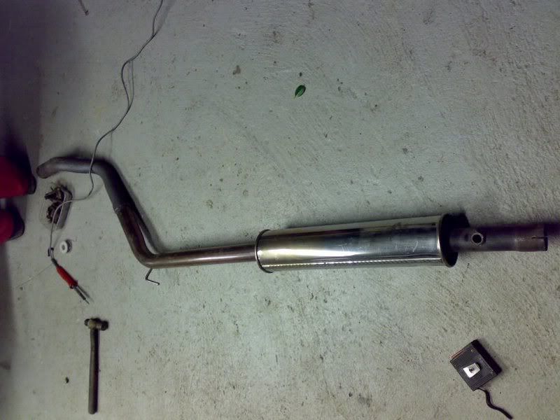

First Olly had a good look at the exhaust to work out what needed to be done to mate the old Powerflow system to the new cat bypass i bought. It turns out that the center section is going to have to be chopped up and the silencer moved back so it all fits together nicely. We're doing this so when i have a few £'s spare i can buy a new back box and centre section and it will fit straight onto the cat bypass.
Heres the exhast after its been taken off.
Centre section,
Derv style back box,

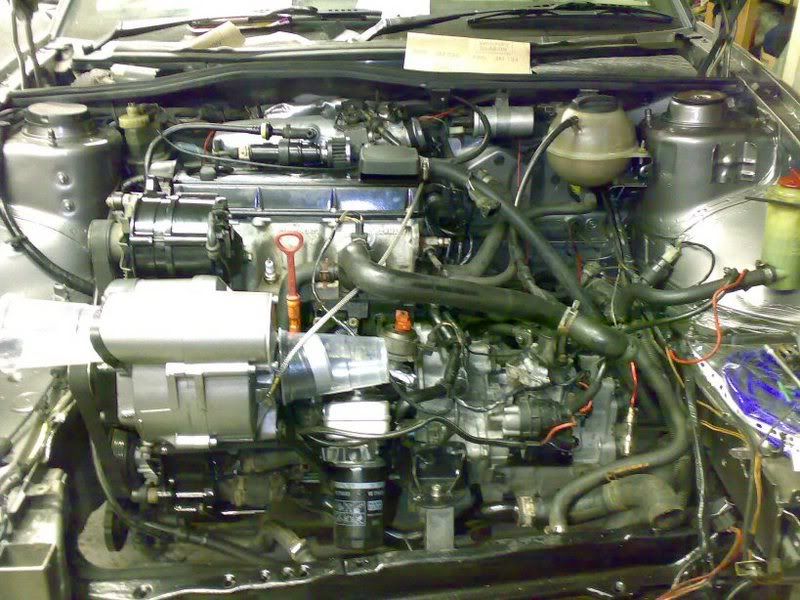

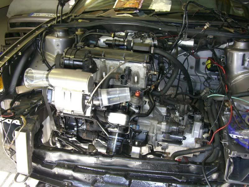

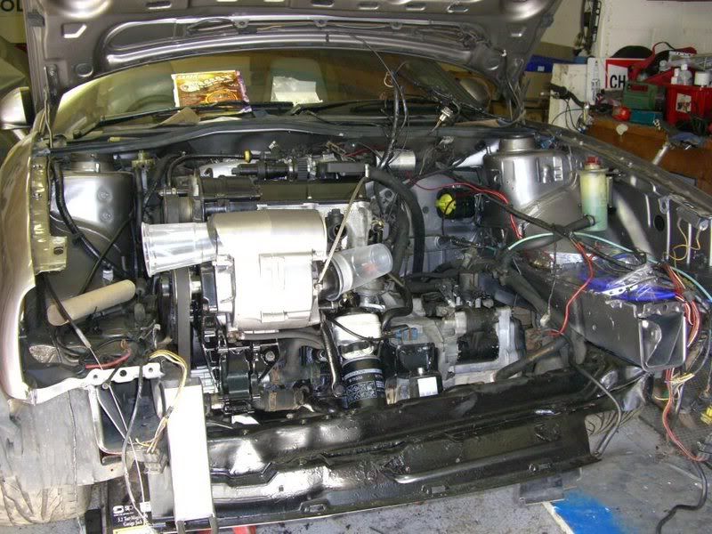

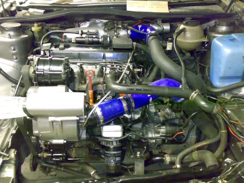

While Oliver was fighting with the exhaust i was attacting all the water pipes to the engine. I have a set of venair hoses on order, but they will go on later, give me a perfect excuse to flush the water system at the same time.

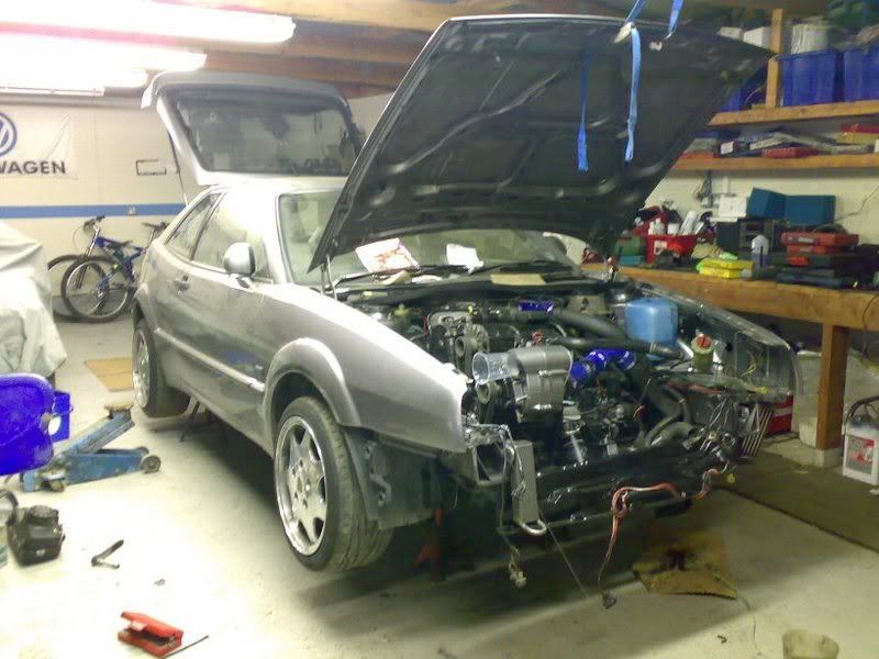

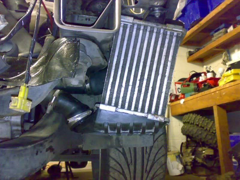

Then Olly joined in adn we reconnected all the wiring loom to the engine :) . Then i bolted up the IC and boost pipes :)
Standard IC
A couple with all the boost hoses connected
One last one of the car flying :) and thats how it stayed until next time :) lol.
