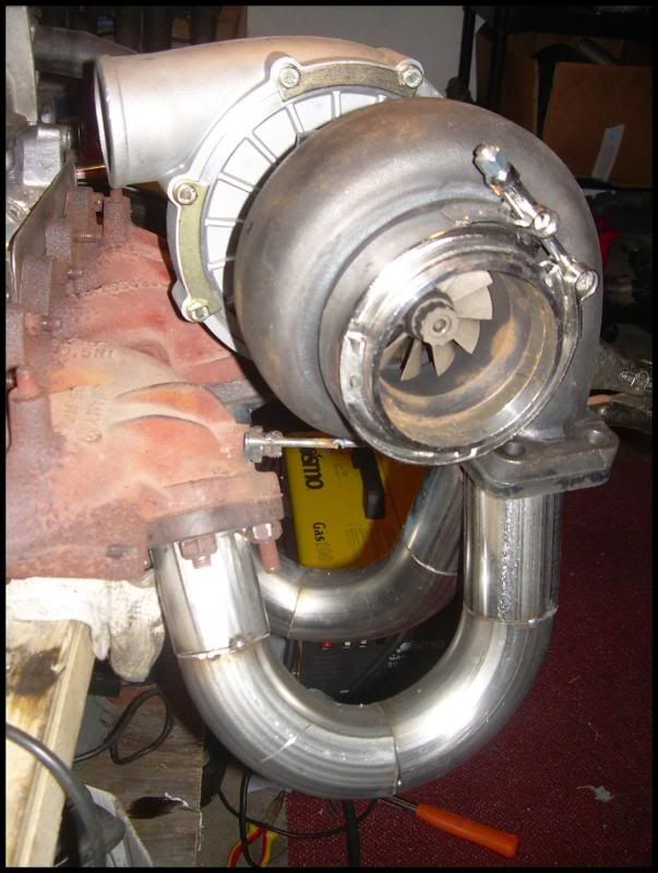

Thats a big old turbo James!
Bit snug ain't it? Guess if you make your own you can point the turbo inlet forward a bit to clear the servo and twist it down a bit to make the exhaust sit a little bit better and avoid the gear cables.
I quite like the standard cast headers and a tubular turbo header would allow the positioning you need. Should work out OK.

Cheers Dave,hows your crazybox getting on? I also like the idea of using the oem cast manifolds ect to mount it like i want.. 8)

The last one i used and what many like Kev use on here is an SPA manifold,its a brazilian manifold and there casts are crap!
Indeed they are. I had to get a second one modified at huge expense.....but it has been perfect ever since to be fair.
I have a friend in the far east who is getting some tubular ones made....for RHD applications. Not far off getting a sample actually..... they will be pretty cheap.
I was also looking into getting some made up or make my own but I like cast manifolds for strength as they are heavy turbos to be sitting on stainless tubes,even with bracing and thick wall 304 it wont be as strong as the cast,so im trying to get this one to work! and it fits and has much better clearance than the old SPA one and the exhaust will be a doddle to make up its just the intake thats a pain!

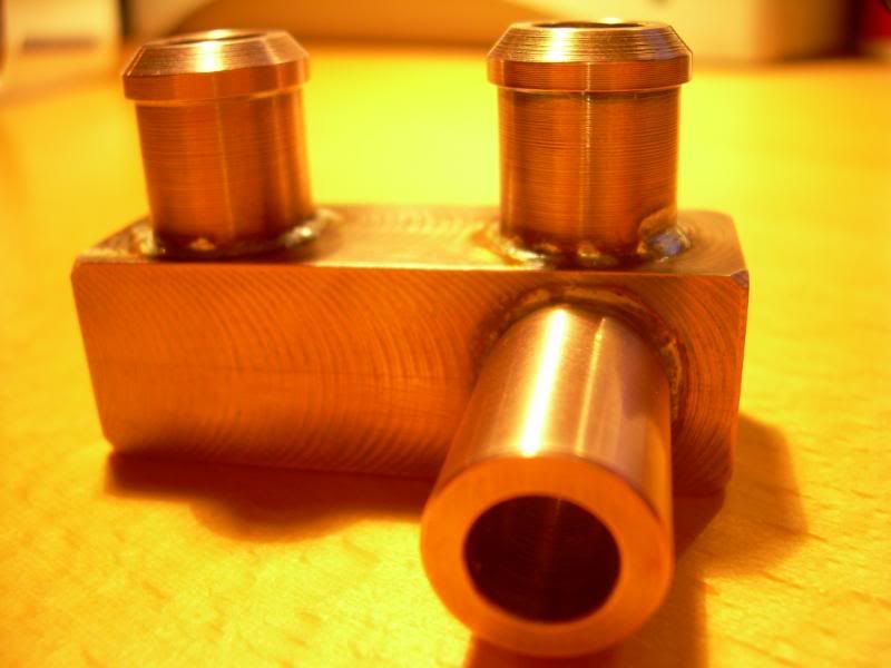

So ive made up the remote block for the master cylinder and this will allow me to fit a single reservoir out the way,same with the ABS as that will also get its own separate reservoir 8)
I want to overhaul my manifold and exhaust arrangements with something better, so I'll be keeping an eye on how yours works out 8)
The ones my mate is getting made are being done by a professional racing exhaust company. 304 for the flanges and 321 for the tubes. I enquired about bracing straps as I had the same doubts as you and the engineer said it won't be necessary :-)
It's basically going to match the layout of the XXX manifold, so existing XXX users won't need a new down pipe and the 321 stainless runners will be equal length to pulse the turbo more efficiently 8)

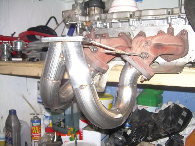

I like the idea of that tubular manifold you have Kev but hate the position of it,there is so much wasted space higher up and loads more clearance.so im busy making my own using the stock header and going to do a U-turn upto the T3 flange and the turbo can be placed how i want with no clearance issues.
Once im happy with it and when funds allow i will have it copied and made up like your tubular one. 8)

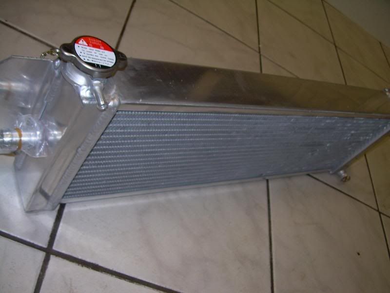

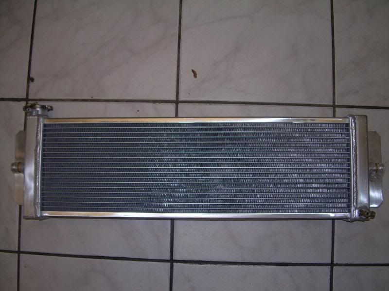

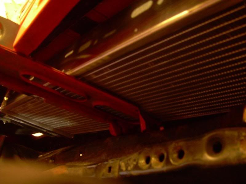

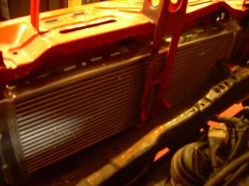

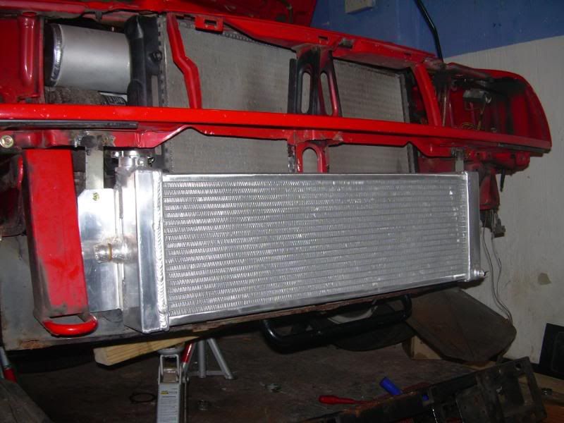

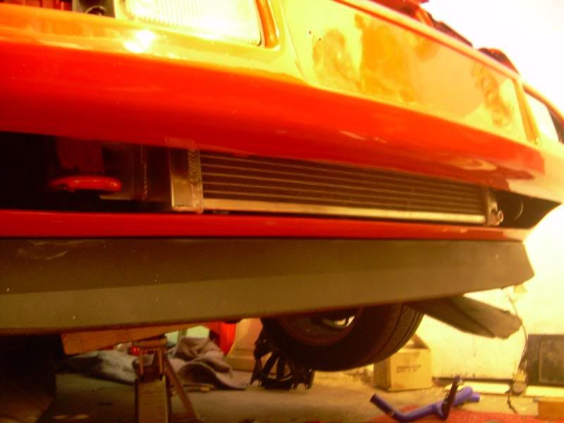

Few updates making progress with the chargecooler rad,its the size of an intercooler but very light! and its taken some fitting but its in now just some grill to trim and its done.

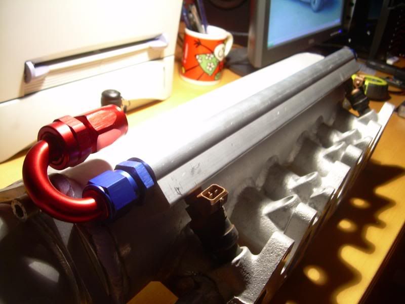

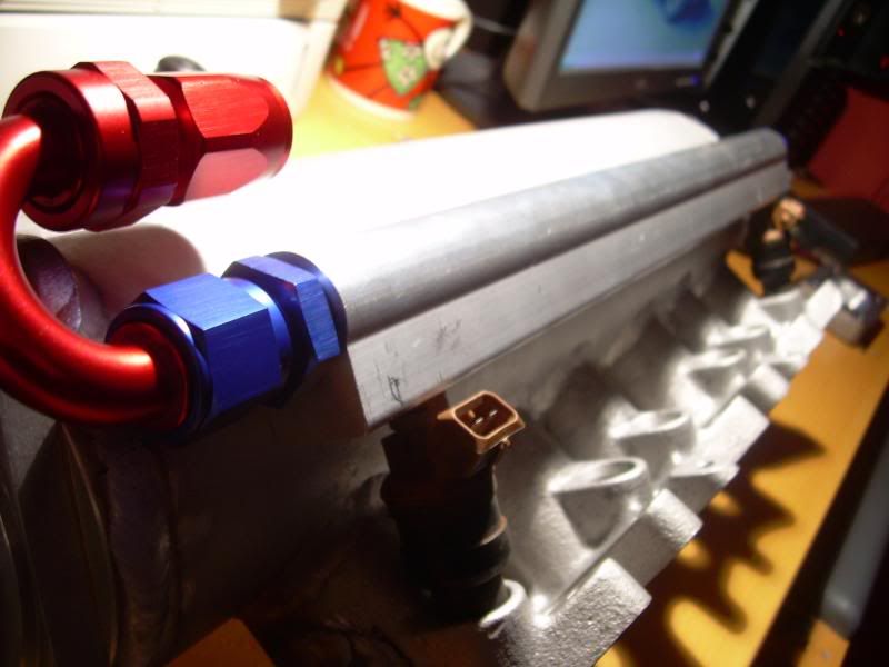

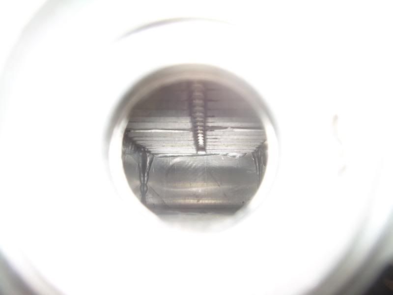

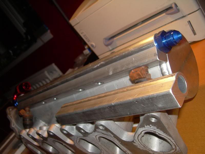

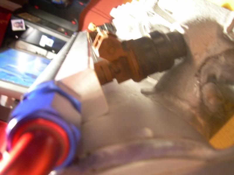

Also got my blank 8 bore fuel rail from the states 2ft long delivered for £39 and have had the injector holes and threads taped into the ends for £10..not bad me thinks :D its a bit overkill for fuel delivery but hey..future upgrades?! :lol:
Whats left of the rail..
Nice work, that rad fits in there well 8)
Where did you get your fuel rail fittings from dude?
Awesome stuff James!
I like the rad, nice and snug 8) Looks like a decent capacity. Is it a custom rad or off something specific? Did you have to hack much out of the front, if anything?
Got the fittings off fleabay,but had hassle from seller and have had wrong or incorrect fitting so i wont recommend them,i buy most stuff from the states,punctual,friendly cheap and ship fast...wish i could say the same for UK suppliers :?
Cheers Dave,the rad was a universal one that i just thought ...I could make that fit and for 130 delivered from the states its a bargain! its a good size as well as adding a tank to rear in the futre this should have plenty capacity for cooling! not fussed what peep say about weight of charge cooler as ive lost more than ive put back on 8) :lol:

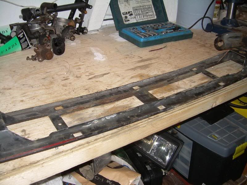

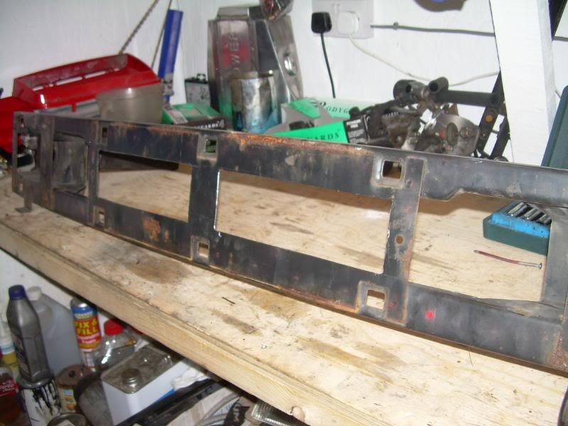

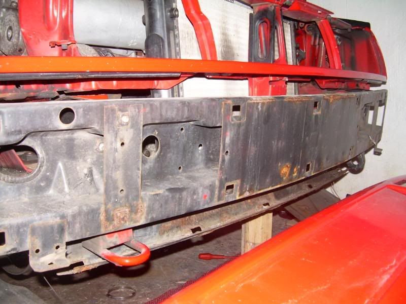

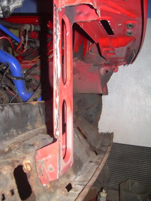

As for fitting...did i hack much out...lol....not as much as the intercooler! i will let the pics do the talking!
Before
After
Had to move the power steering pipe "cooler" lower down for space
Snug.... :lol:
Loving how this is coming on 8)
If i remember rightly you started this to be a cheap homemade, yet powerful VRT?
Now i see the prices you pay for stuff are cheap but is it working out to plan cost wise, basically is it still a budget conversion, i know its going to be a shed load cheaper than what most cost so thats all good still.
Ah.... now I can see what you've been up to :)
It's been a while since I had the bumper off and couldn't remember just how much is behind it :? or isn't now!
I just love the way you've hacked all that metal out but made it look really neat and tidy :notworthy: brilliant job!

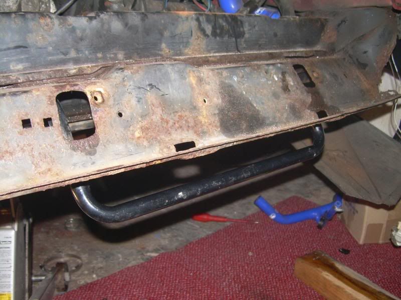

Top work on the placement of that cooler, theres just no space down there...
its a shame that turbo manifold didn't work out as smoothly, but that is a Huge Turbo...
It is big,but even with a smaller turbo the clearance is crap!

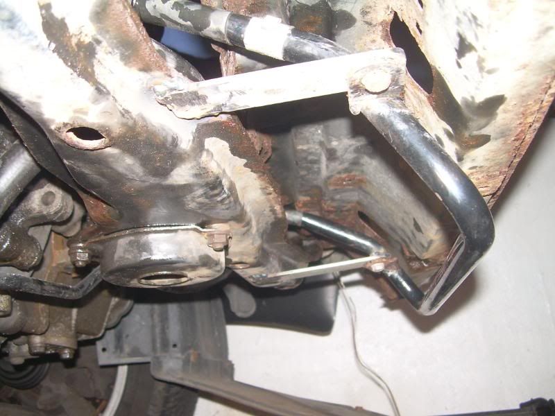

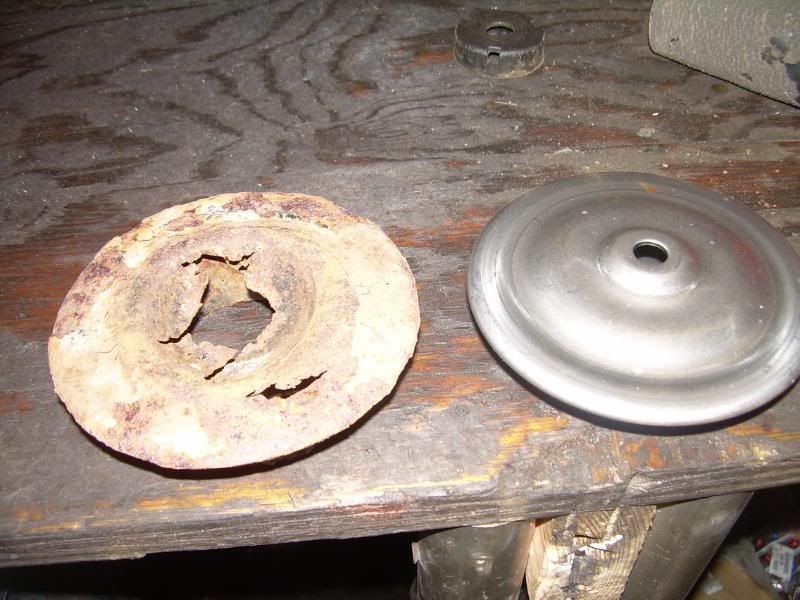

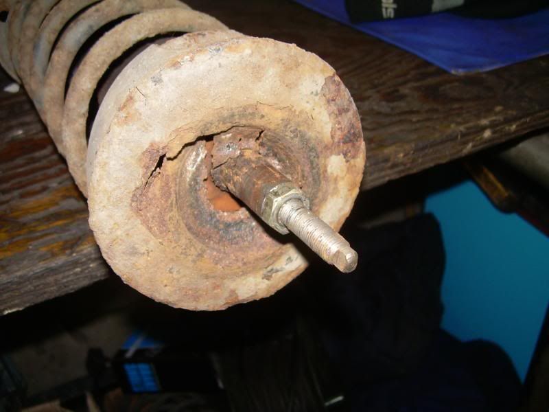

Got some lowering springs off reubenwilliams off here for a song! fitted them and was horrified on how bad the rear spring cups had rusted away!! they had been sitting on the body!
New ones ordered ASAP and now it sits well and handles soooooooooooooo much better 8)
Eeeek!
Think I should listen to my valvers creaks and groans a bit more in furture (not just turn the radio on!). Which reminds me, I must look at all the front bushes, somethings floating around a bit.

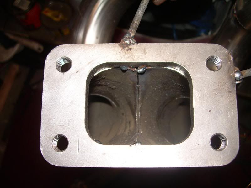

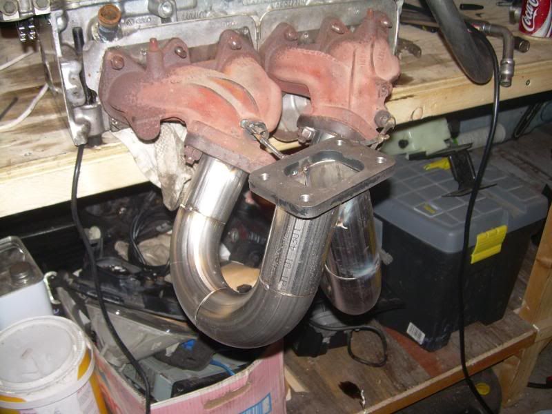

Just did this tonight,going to do the wastegate tomorrow then will get it tig welded,was going to use my mig but its well.....crap :lol:

The angle of the exhaust outlet looks ideal. Looks like it'll drop down the back and under the car pretty easy.
Sure you've thought of this, but are you making a nice strong bracket from the cast manifolds to the charger flange, cos you know how hot those headers are going to get and they might get a bit soft and start cracking with all the exhaust hung on it?

More enough equal length to the flange, the wastegate should be interesting.
Have you trial fitting it to your car? just to make sure the bonnet shuts, looks to be ok thou.
What grade material are you using?
Cheers for the replys,the stainless is 304 and the flanges are mild steel,going to get the tig welded by a pro and fit support braces to help out and the bonnet shuts fine and loads to play with 8)
Doing the wastegate tonight,got the head back on for fitting and there is room and no fouling at all!
Dont know how long it will last but its not a daily car and if it does crack i will give the lot to a company to fab one the same using 341 stainless,but time will tell.
