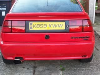

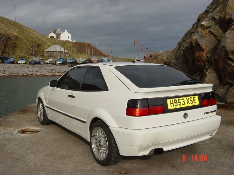

BigTartanJudge 0 Posted November 20, 2007 http://www.corrado-club.ca/ Check here out as well for a really good tinting uide in the technical section. I used this guide to do my last white rado's tailights and they turned out really good. Unfortunately, they got sold with the car. See here: This website also has a lot of other great info on other DIY projects. I have a spare set of crystal In-Pro's that I am going to fit the set of red empire grafix overlays to create an all-red crystal set of In-Pro's. I also have another set of standard rado rear tailights that I am going to top-tint as per the corrado club of Canada guide, like on my last rado. And I also have another set of Smoked In-Pro's currently on the car, so I will have the full set if I fancy a change ! (although reckon these may be up for sale soon, 3 good sets is just greedy ! ;-)) Quote Share this post Link to post Share on other sites
