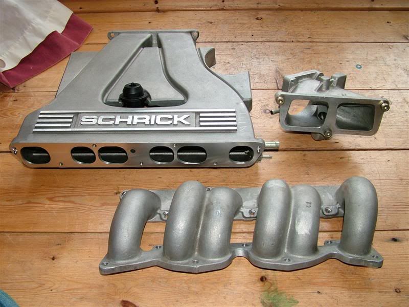

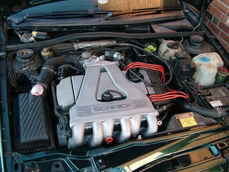

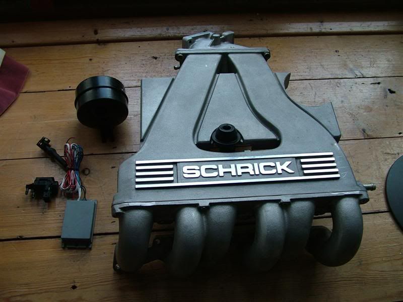

jedi-knight83 0 Posted September 5, 2004 a HUGE thanks to Kevhaywire!!! Really Really appreciate your help today!!! here are the pics Car felt so quick on the way home!! big difference as i expected so im well happy :lol: Thanks again Kev!!! Quote Share this post Link to post Share on other sites

Supercharged 2 Posted September 5, 2004 Jedi - what the hell are you doing in my parking space? :lol: Looks almost as new as Kev's - very nice :wink: What state were the chains / tensioners in Kev?? Quote Share this post Link to post Share on other sites
jedi-knight83 0 Posted September 5, 2004 kev said they were ok actually. chains were tight and tensioner was pretty un worn. Quote Share this post Link to post Share on other sites
corradovr6sc 0 Posted September 5, 2004 Schrick looks great and that rubber elbow from the actuator is very neat. Quote Share this post Link to post Share on other sites
Kevin Bacon 5 Posted September 6, 2004 That is a good solid engine and runs very healthily indeed. Chains and top tensioner are fine but budgeting for a chain overhaul within the next 20-25K would be a good idea. The 90 degree elbow on the Shrick actuator is from a MK3 Golf...... The part number is in the Schrick dismantling and how to guide. Any more signs of bonnet clouting Nathan? Quote Share this post Link to post Share on other sites
jedi-knight83 0 Posted September 6, 2004 That is a good solid engine and runs very healthily indeed. thanks...although i still hear noises :x Any more signs of bonnet clouting Nathan? no, all looks ok but i'll get the mount done asap! and the gasket is holding up by the looks of things. going down to ford today to get that brake breather valve thingey...although good job with the superglue!! its all still together :mrgreen: Quote Share this post Link to post Share on other sites
Kevin Bacon 5 Posted September 6, 2004 Can't beat superglue :wink: One thing that surprised me with the two installs I've done for people so far, is the complete calmness they displayed as I hacked their bonnets up with a dremel! LOL! It's the best way to do it though. I've seen a few Corrados have the Schrick clearancing done with a hammer and it looks a complete b@stard! Quote Share this post Link to post Share on other sites
dinkus 10 Posted September 6, 2004 Can't beat superglue :wink: One thing that surprised me with the two installs I've done for people so far, is the complete calmness they displayed as I hacked their bonnets up with a dremel! LOL! It's the best way to do it though. I've seen a few Corrados have the Schrick clearancing done with a hammer and it looks a complete b@stard! Hammer!??!?! Now that would make me nervous. Pecision Dremel work is nothing compared to that :) Quote Share this post Link to post Share on other sites
jedi-knight83 0 Posted September 6, 2004 Pecision Dremel work is nothing compared to that ha, what Kev failed to mention was the 2 dremel blades he snapped and the 'metal fatigue' method he them employed with his pliers!! :shock: its ok though, it all looks fine now and no knocking even on the standard mount. Quote Share this post Link to post Share on other sites
dinkus 10 Posted September 6, 2004 Pecision Dremel work is nothing compared to that ha, what Kev failed to mention was the 2 dremel blades he snapped and the 'metal fatigue' method he them employed with his pliers!! :shock: its ok though, it all looks fine now and no knocking even on the standard mount. :lol: You need to get some pics of that up... I bet you have half the bonnet removed to fit it under there on a standard mount? Quote Share this post Link to post Share on other sites
Kevin Bacon 5 Posted September 6, 2004 LOL.... Metal fatigue - the non-technical term for bending the metal back and forth till is snaps :lol: Once your paint man touches it up, it will look pretty good. I'm going to look at a way of lining the cutout with some thin rubber U shaped trim to make it look less 'hacked', LOL. Quote Share this post Link to post Share on other sites

Kevin Bacon 5 Posted September 7, 2004 Nope.... the heat of the engine keeps corrosion at bay. It will be painted long before rust gets a chance to set in. Quote Share this post Link to post Share on other sites
jedi-knight83 0 Posted September 7, 2004 I bet you have half the bonnet removed to fit it under there on a standard mount? actually there isnt much more cut away than kevs and he has the VT mount ?? different engines just sit slightly different i guess? oh and its all getting painted on monday anyway so the bonnet will get done then...onlty a week..that wont cause any damage will it? Quote Share this post Link to post Share on other sites

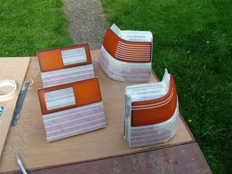

jedi-knight83 0 Posted September 7, 2004 just thought i'd give you a sneaky peek at my lights aswell.. all rubbed down with 600 grade wet and dry and all masked up ready for painting. there actually sprayed now but still need a bit of work before i lacquer them.. anyway here they are...they'll be all done and fitted by the time i get the car back from the body shop next wednesday Quote Share this post Link to post Share on other sites
