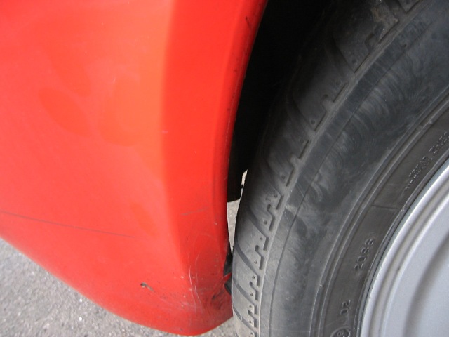

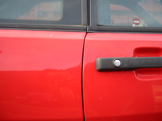

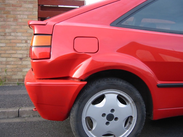

Anyone have any opinion about whether replacement of the quarter panel and straightening of the inner quarter and rear panel will be the end of the story, or is there likely to be more serious damage? For instance, as you can see, the door gap has been greatly reduced. When I look at the quarter panel, because the impact was very low down on the rear bumper, the quarter panel has been kind of pushed fowards, and kind of twisted anti-clockwise, if that makes sense. So I am hoping that this is all just distortion of the quarter panel and rear panel, and that nothing has happened to the chassis leg itself.

from a stresses point of view, if you can see that the panel gap between door and shell has been reduced this isn't a good sign. :(
Sounds like the bumper would have transmitted the force through it's arms into the chassis legs and also some axial / rotary forces which have buckled the rear panel slightly. Was the impact at an acute angle perhaps?

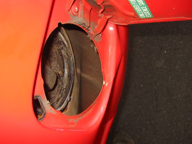

Do you have any pictures of the floorpan or even the boot floor? My thinking is that if there was enough force for shockwaves to deform the bodywork up by the doors, then the whole rear end may be out of alignment a little :( :(

Agree with Boost Monkey!!!! If the boot floor is bent or any kinks in the roof It's Scrap I'm affraid! I wouldn't be happy about fixing it though with the panel gaps in the door so badly distorted......
