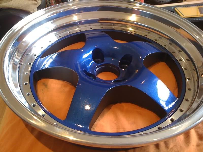

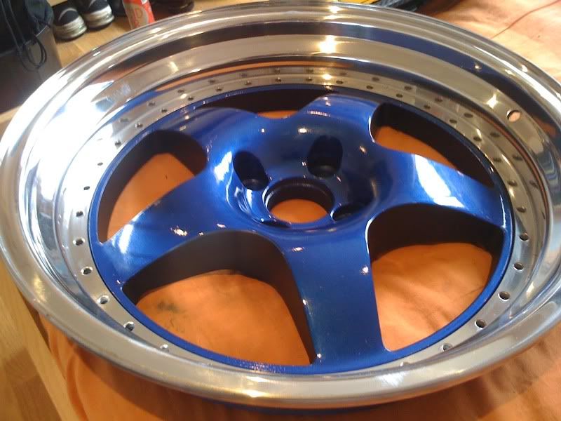

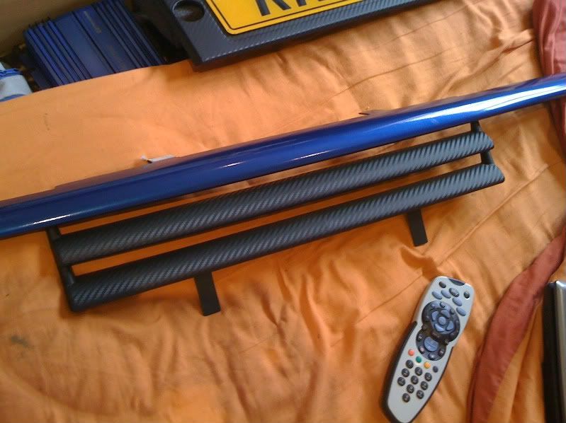

waynos 0 Posted August 21, 2010 more little bits doing whilst the car is away had a little bit of the carbon stuff left over so i did the grill too. The piece i had wasnt quite long enough so i had to join two pieces together at the middle. you can really notice it though as for the wheels ive started to paint inbetween the spokes matt black. I think it looks better plus a bonus as the brake dust wont show up as much lol Quote Share this post Link to post Share on other sites

waynos 0 Posted September 13, 2010 got the rims on at last but need to lower it down on the coilovers now Quote Share this post Link to post Share on other sites

dan 0 Posted September 14, 2010 Car is looking stunning now Wayne, are those the Lupo or TT wipers you have? Any pics of the Carbon Fibre? Quote Share this post Link to post Share on other sites
waynos 0 Posted September 14, 2010 Im going to be using mk4 golf washer jets that mount under the bonnet edge. Dan the wipers are from a lupo. Need to change the blades but havent got round to it. Ill try to get some pics of the wrapped bits. The grille still looks cool but the number plate holder is lifting where it has the recessed part. Its like its too taught and the glue couldnt hold it. Ill have to save up for some and give it another go Quote Share this post Link to post Share on other sites
dan 0 Posted September 14, 2010 waynos said: The grille still looks cool but the number plate holder is lifting where it has the recessed part. Its like its too taught and the glue couldnt hold it. Ill have to save up for some and give it another go That's a pity although I thought that might happen. That particular vinyl is realistic looking but not very conformable, it's designed for flat applications, that's why it's ok on the grill. You can get more conformable CF look vinyl but it's not as realistic looking. The ony things you can do now with it is heat it again & rub it back into place & using a sharp knife cut along the recess where it was lifting. It should lay flat again but you may see a fine line of the plinth showing through where the cut line is. Quote Share this post Link to post Share on other sites
waynos 0 Posted September 14, 2010 Yea i was gunna do that. It really doesnt look that bad but i will fiddle until its right Quote Share this post Link to post Share on other sites

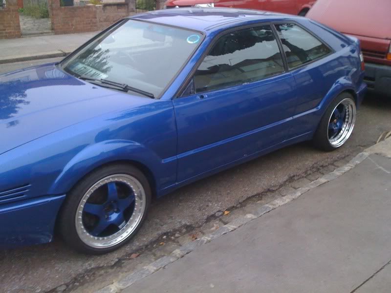

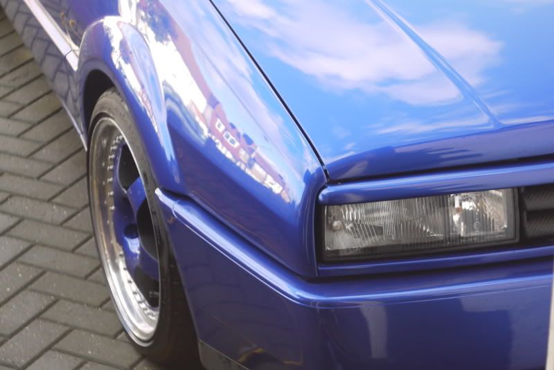

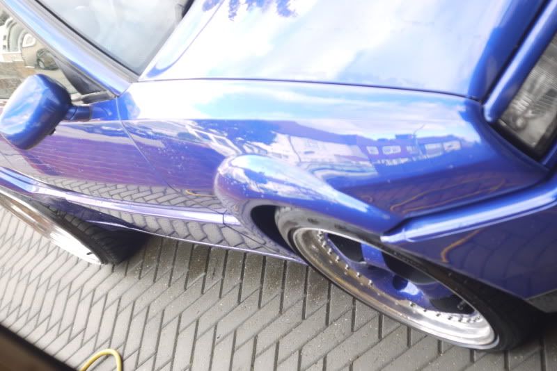

waynos 0 Posted October 26, 2010 right bout time i put some pics up of it now its back on the road.Im not overly happy about the paint work but thats cos im anal when it comes to that. Its way better than before but not quite my standard so i shall be redoing it myself next year :D putting the door card back on trying to get that fiddly door pin through the card! Quote Share this post Link to post Share on other sites
aide 0 Posted October 26, 2010 paint and wheels looks pretty damn good on the pics 8) nice touch on the rear plate surround, is that CF wrap? Quote Share this post Link to post Share on other sites
Kempy 0 Posted October 26, 2010 when you lowering it :) Quote Share this post Link to post Share on other sites
waynos 0 Posted October 26, 2010 yea the rear number plate is covered in 3m carbon wrap, need to do it again though. kempy it was lower but i thought id raise it up for the winter. But saying that i think i will drop it back down if there is a nice day for it on a weekend Quote Share this post Link to post Share on other sites
Rams 0 Posted October 27, 2010 The car is looking smart, although I spotted some residual polish on the drivers door edge! :lol: From what I can see the paint looks excellent. Very nice. you must feel proud of what you've achieved! Quote Share this post Link to post Share on other sites
