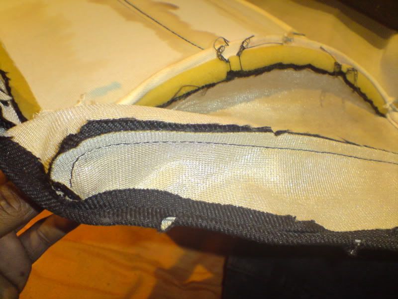

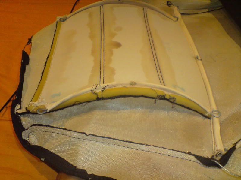

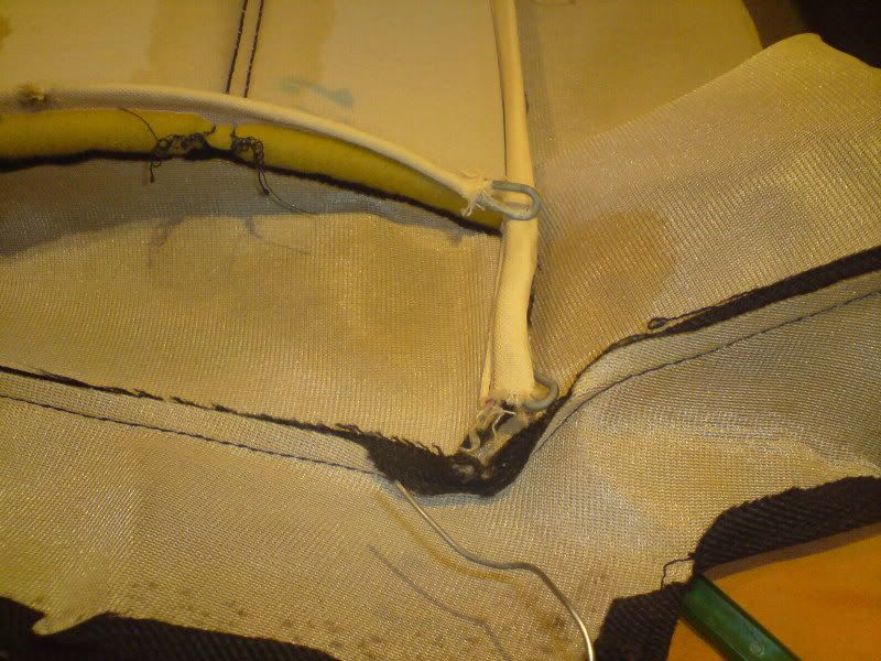

now then now then, ive made a start on the interior. took a part of the rear seat out of my old valver and proceeded to unclip the material off it.heres some shots of it off the seat

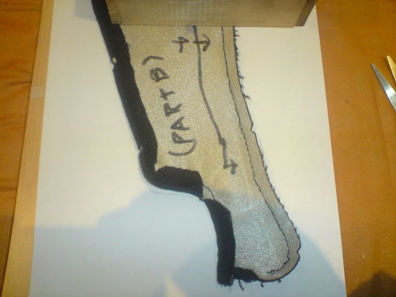

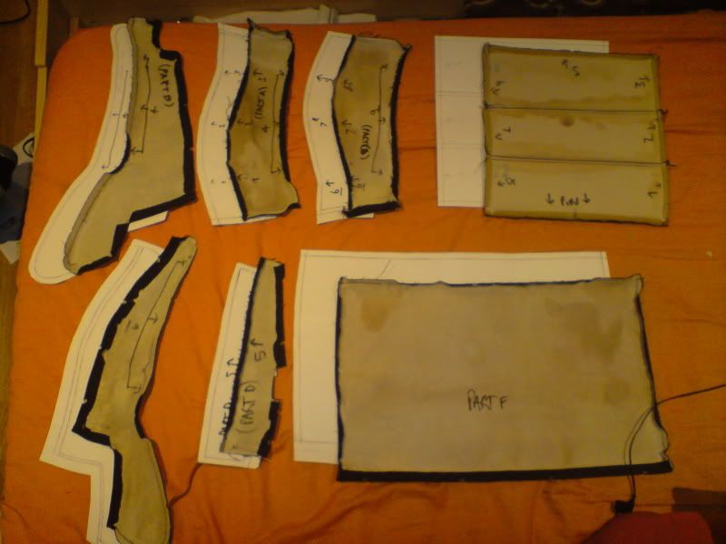

i then unpicked each section and made template patterns of them (ignore the writing its for my reference)
heres a pic of all the pieces with the templates underneath

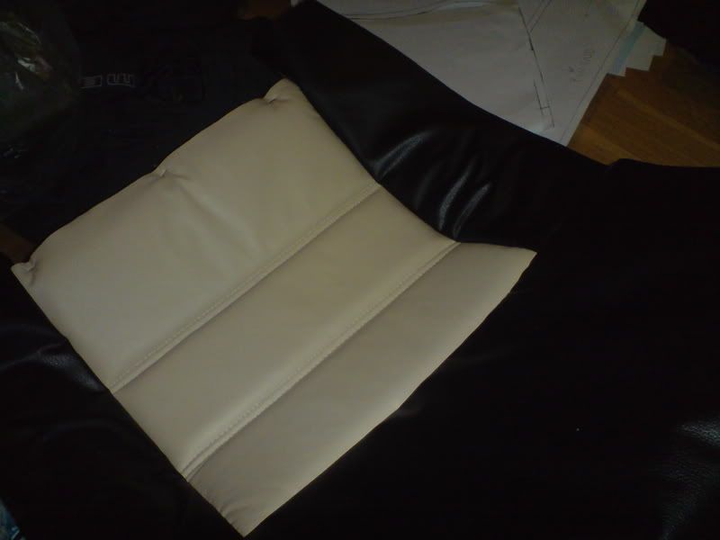

Ive now transfered and cut all the pieces out of the new material and im gunna attempt to sew them later (wish me luck)

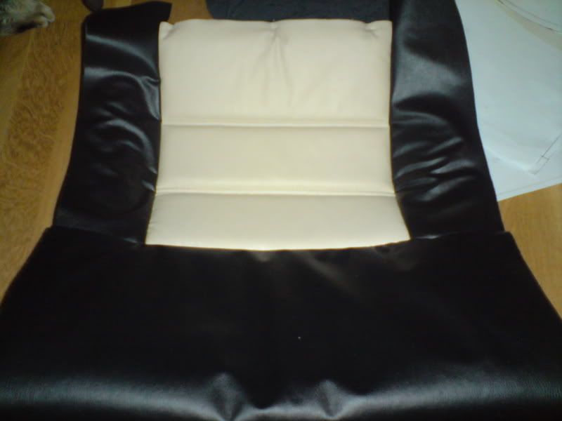

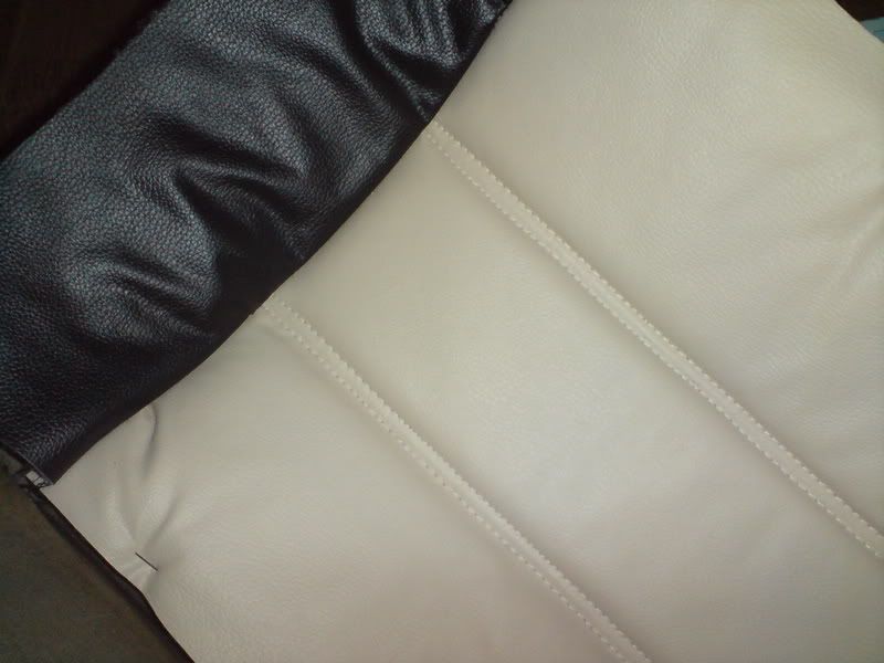

i wasnt happy about the way the leather creases up but its because its curved and it shouldnt be as bad once its all pulled back onto the seat mould.

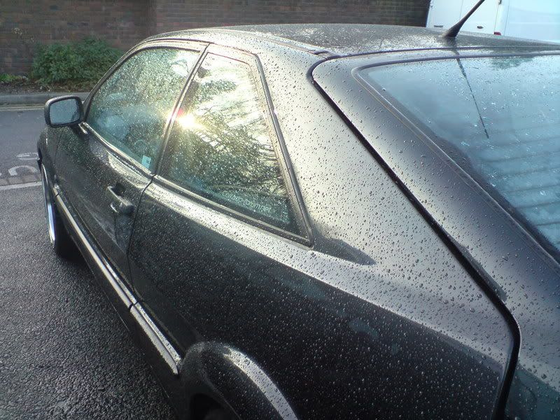

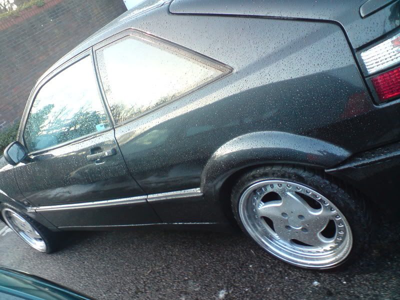

heres a few random shots of the car

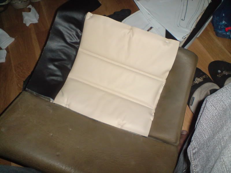

got two more panels sewed up onto the seat, this is the state of play at the moment. Its really hard using a normal sewing machine but if your patient it will be ok

yea i cant wait til its done. Im 25 today wooooohoooo. Totally random but heres a pic of the rado in the cold monday mornin

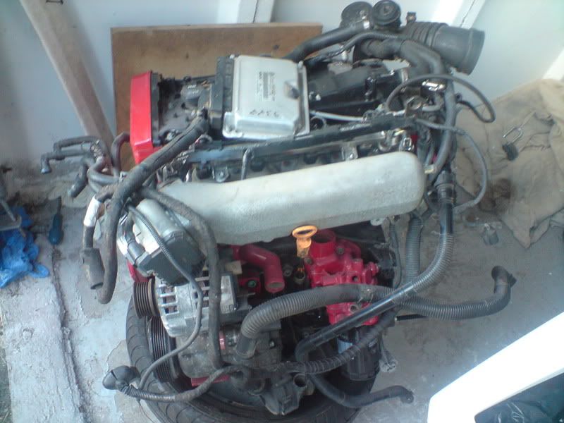

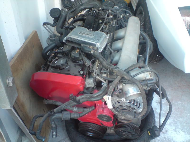

Managed to get me a 1.8t engine from a seat cupra s, so im pretty chuffed just need to source a few other bits before that can go in.

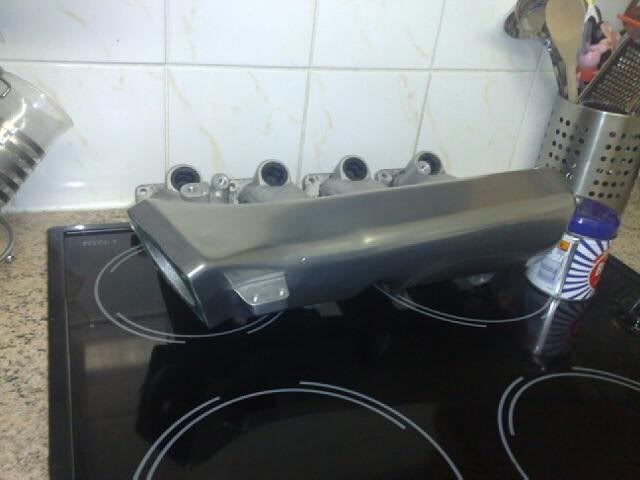

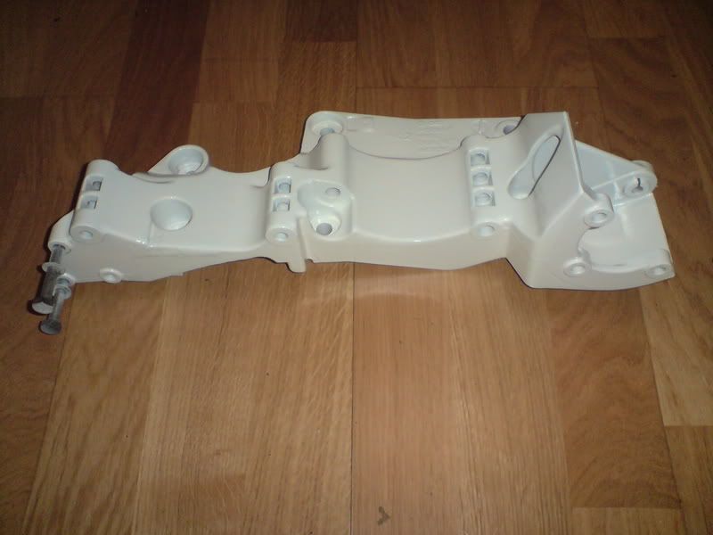

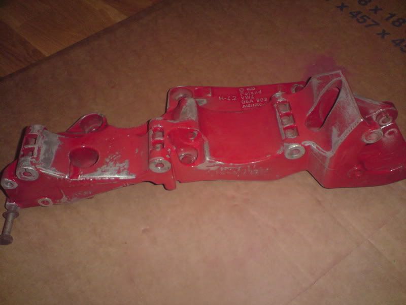

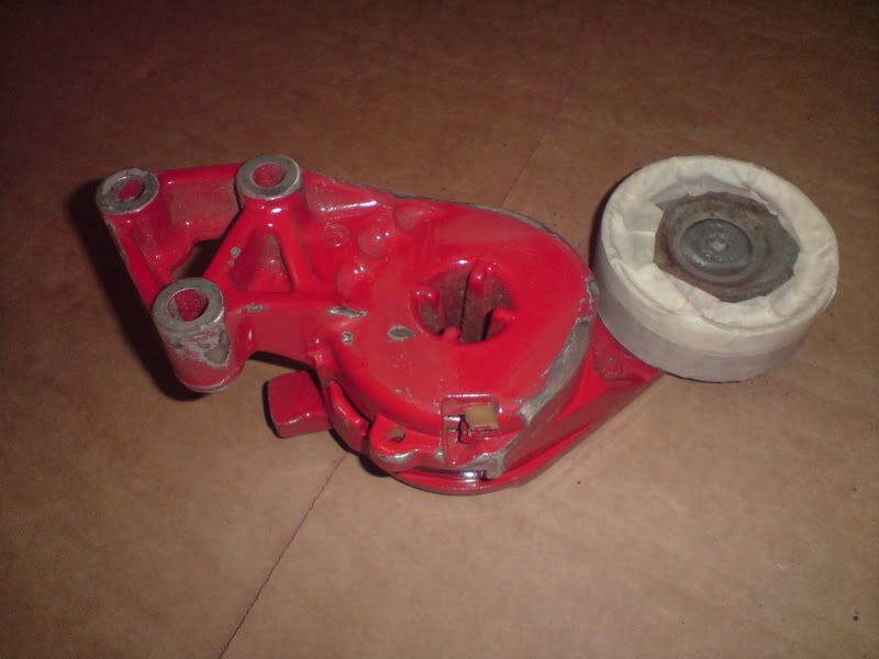

took the alternator/power steering bracket off, a pulley, the inlet manifold an the cam cover off.here they are
spent ages sanding down the brackets and they were degreased and etch primed

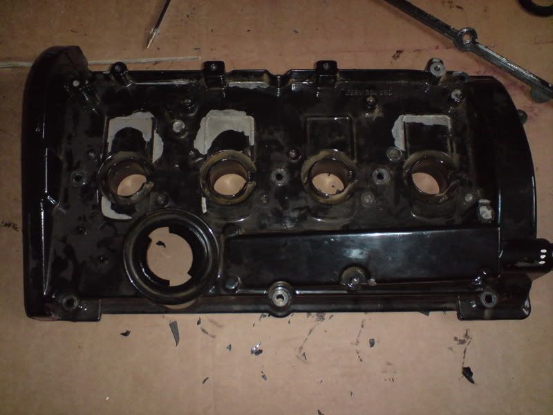

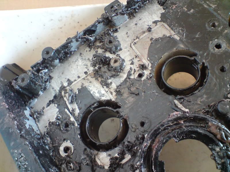

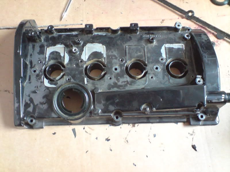

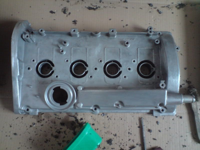

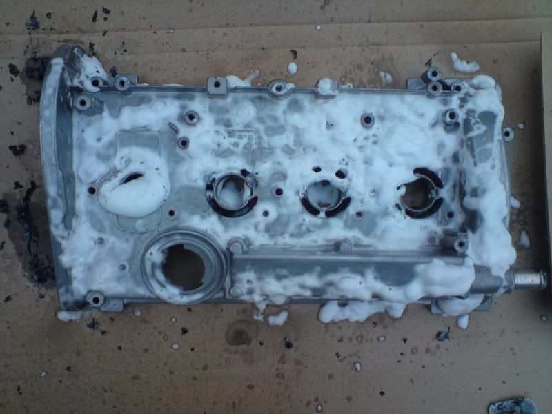

used paint stripper on the cam cover, really wierd watching the paint bubble up :D
one of it degreased

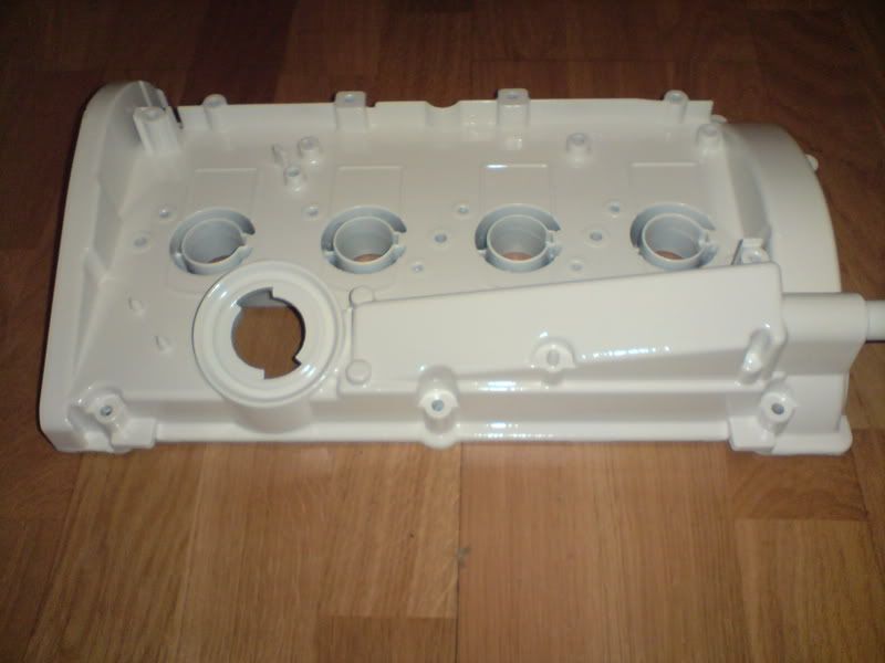

And ready for paint!
Painted!
I know white isnt the most engine bay friendly colour but i love it so ner :lol:

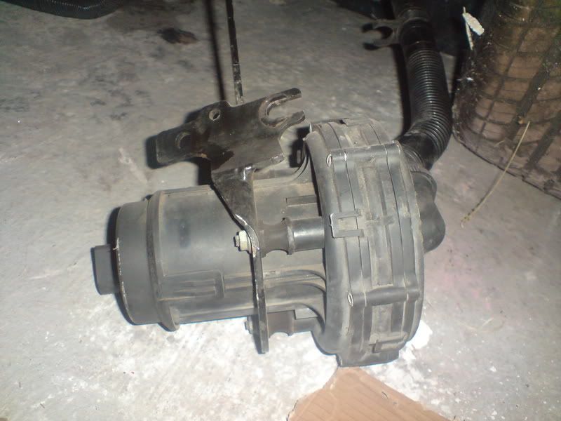

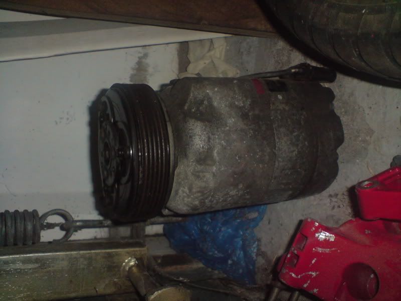

Also took the air con pump and secondary air blower thing off as i wont be using them (for sale if anyone needs)
looking good what paint did you use?
and if your using qpeng you will need a bracket on the inlet manifold for the cable!

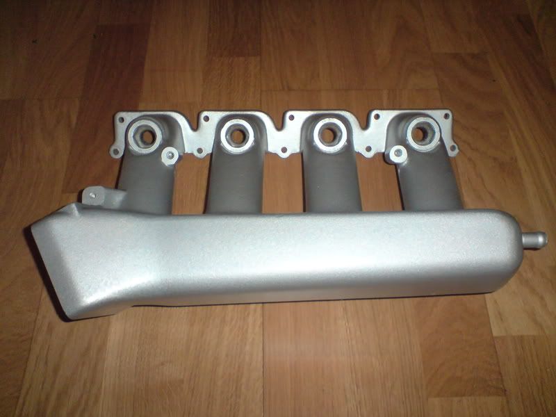

cheers for the comments! do you have a pic of the bracket? i use acid 8 etch primer on all the metal parts then smooth hammerite silver on the inlet and plasticote on the white parts
my agu inlet has this bulge on the side an an l shaped bracket bolts to it.,
will also neen mk3 gti or agu cable thottle.,
I have noticed that your rear lights are painted black round the edges, is this over the top or somehow underneath? I am trying to de-green mould my rear lights as it looks a bit pants and scruffy, and that just doesn' cut it. Lovin' those wheels too, i nearly got some of those but plumped for Keskins instead.
yea i masked and painted the lights, the crappy chrome finish wasnt doing it for me! with the black it makes it look a bit more factory!
cheers for that pic 20vtvw i dont have the buldge you have on your inlet but underneath there are two holes that i can bolt a bracket up to.

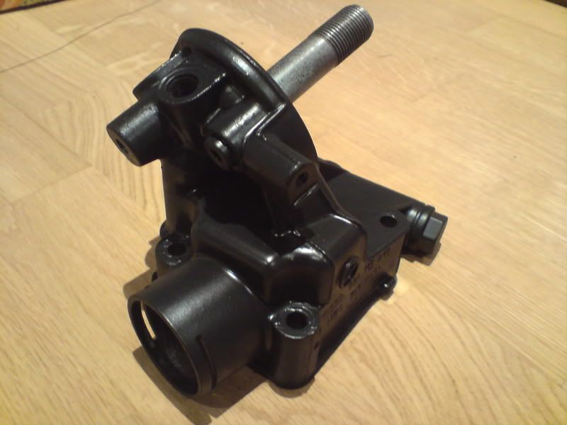

oil filter housing

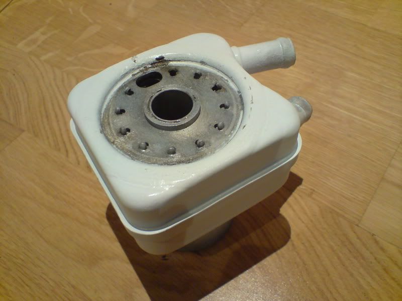

oil cooler

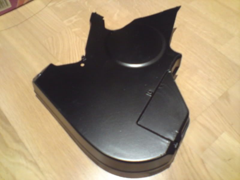

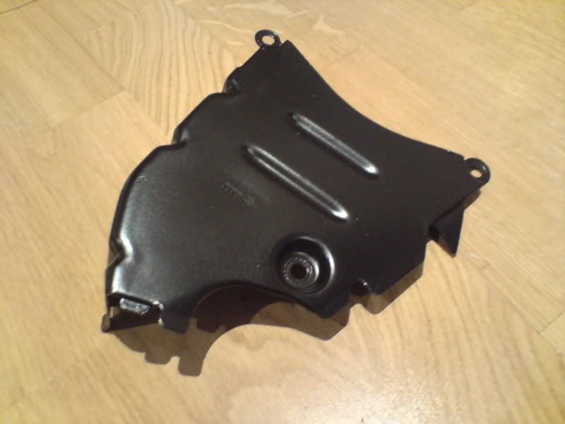

lower cambelt cover
upper cambelt cover
these were all in red originally but this is not the colour scheme i want

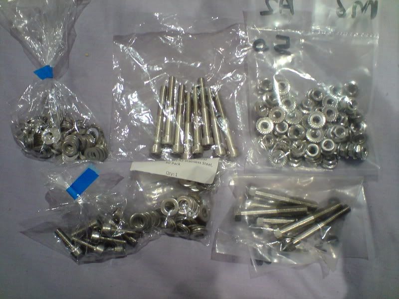

Got a nice selection of stainless nuts, bolts and washers to replace the old toot

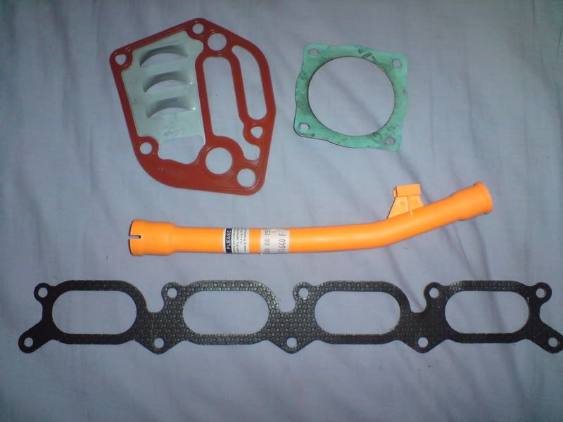

New inlet,throttle body and oil filter housing gaskets and dipstick tube

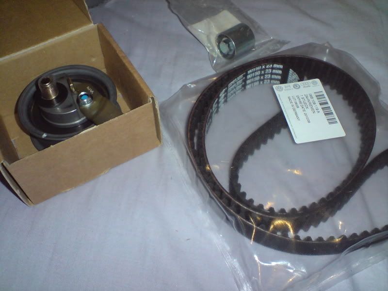

Genuine timing belt kit

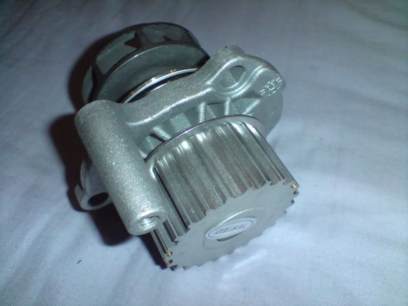

new water pump, (doesnt look it but the impellor is metal - Thanks to reuben at tuning works for sourcing that!)

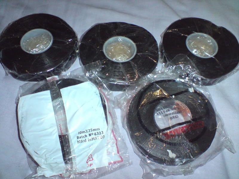

5 rolls of self amalgamating tape to sort my entire car loom out ( in good time!)

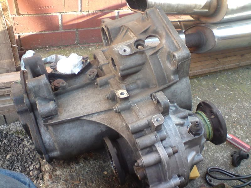

Right got the gearbox its an o2j (enj) so i think thats a golf mk4 gti box, been slowly cleaning that

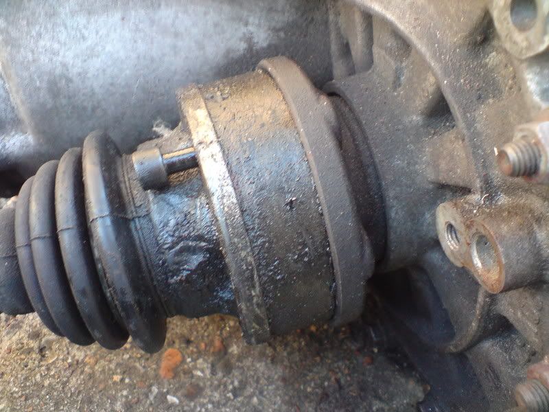

Ive also been dismantling my red corrado ready for the engine to be sold tommorow so i had the driveshafts out back with the gearbox.Ive heard that most of the o2j boxes have 108mm driveshaft flanges so i was worried id have to source a set of 100mm flanges to match my shafts, however i took the driveshaft i got off the 16v and it fitted perfect to the o2j gearbox.... what a touch! im happy.
heres a pic
