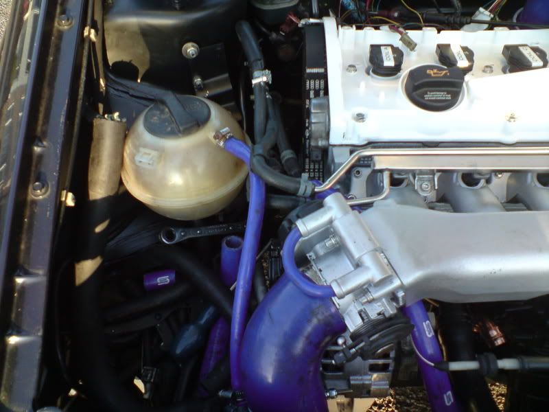

waynos 0 Posted August 1, 2009 lil update, got the resistor fitted and all is ok.re routed some of the pipework from the expansion tank an proceeded to bleed the air out of the cooling system.Had a big airlock in the heater matrix but its gone now. still need to sort a few little bits out but everything is cool at the moment. short vid Quote Share this post Link to post Share on other sites

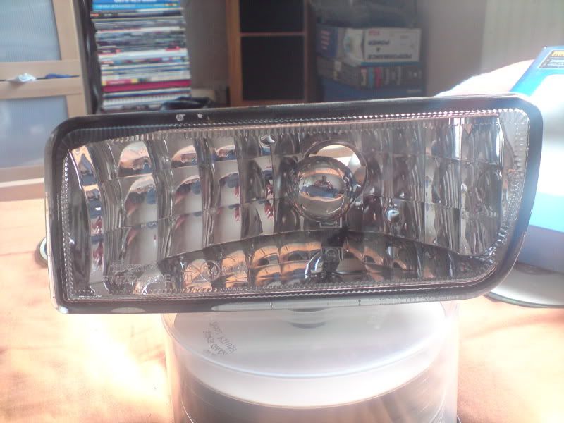

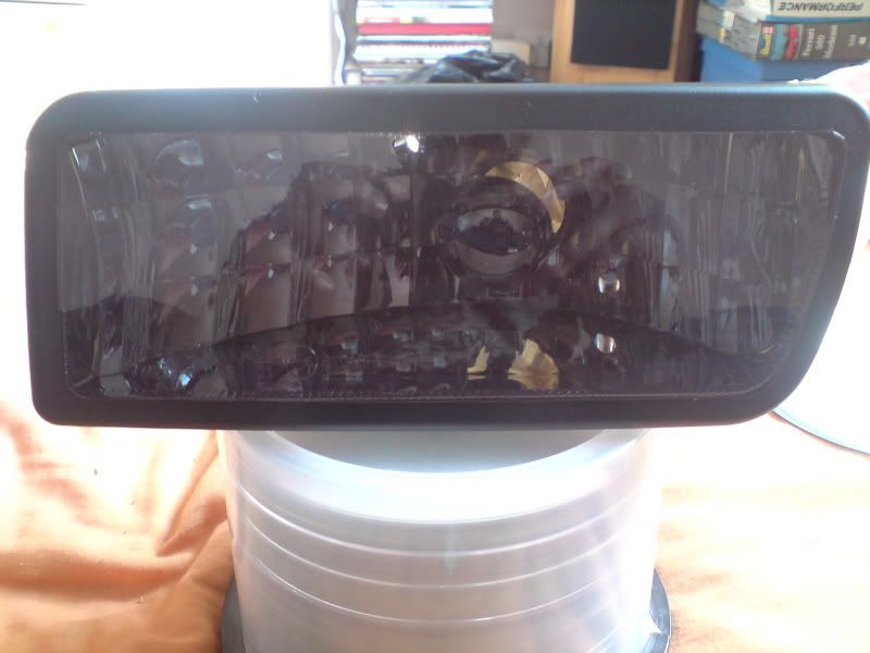

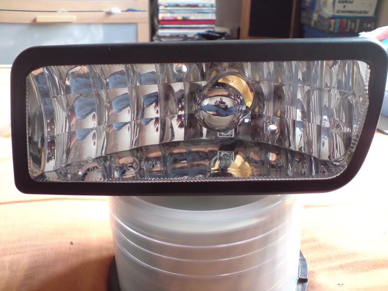

waynos 0 Posted September 5, 2009 update :) the car is running well, need a new dump valve as the one ive got is too weak - leaking boost. The exhaust rattles slightly when the car is first started.Need a new throttle body also. Im loving it though! I Tinted my front lights - heres a few pics from that wanted to add a border to hide the glue that holds the lens together (same as ive done on the rear lights) un masked now for some tint film front fog and indicator (headlights have been done too but havent got any pics of that few pics a mate took in my work car park Quote Share this post Link to post Share on other sites
BigTartanJudge 0 Posted September 5, 2009 looks really good mate, can the In-pro indicators / fogs be separated i.e. housing from glass ? Quote Share this post Link to post Share on other sites
waynos 0 Posted September 5, 2009 ii think they could but it would be really difficult as it seems like they are glued together Quote Share this post Link to post Share on other sites

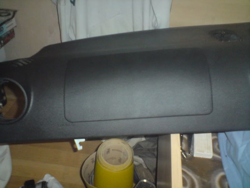

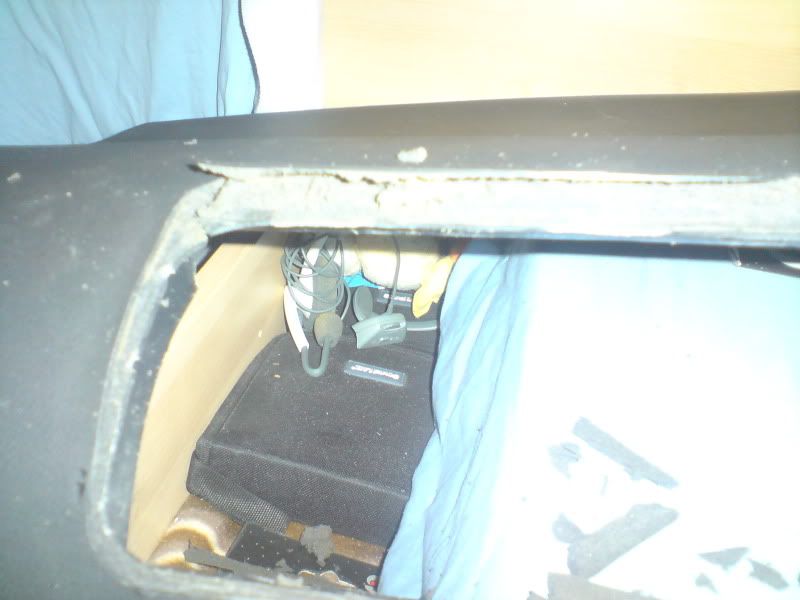

waynos 0 Posted November 23, 2009 not mch of an update, managed to pick up the top half of a tt dash.im in no rush to get this in as i need to source a glove box and panel that goes above your feet.ill be doing a custom centre console as im not feeling the tt one. The dash i got unfortunatly had the air bag go off which tore a section out. i was thinking about recovering it myself but there are quite a few curves to get around. Then i thought about filling the hole and getting it flocked but i thought the finish would be poop around the repair. heres what i ended up doing.... heres the dash as i got it i cut the whole part out where the airbag blew and took some of the foam away from the edges as the material was lifting there i then glued the material down at the edges so that it wouldnt sit proud. The part i cut out was fibreglassed back in flush also Made a panel to cover up the hole out of fibreglass then gave that a quick skim of filler to make it smooth trimmed it in some leftover vinyl i had from doing my door pods glued this piece to the dash over the hole and let it dry over night wont be to everyones taste but it was a hell of a lot cheaper than paying someone to retrim it! Quote Share this post Link to post Share on other sites
