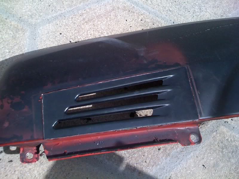

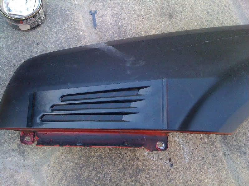

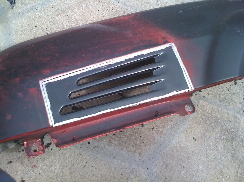

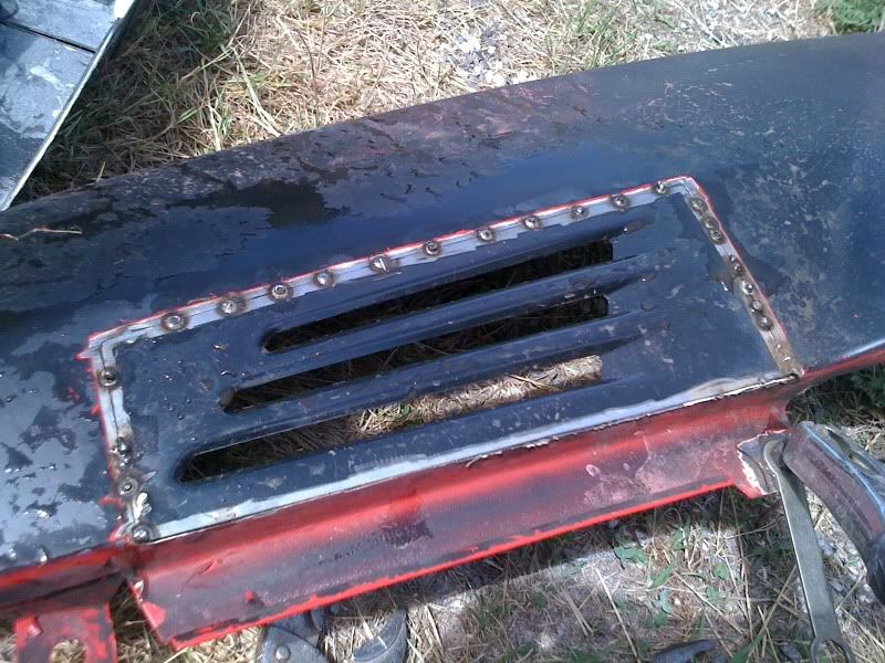

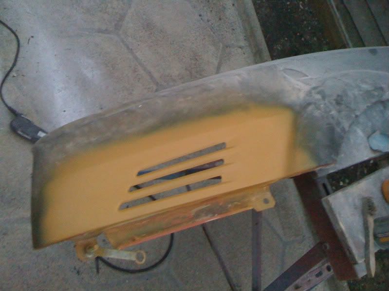

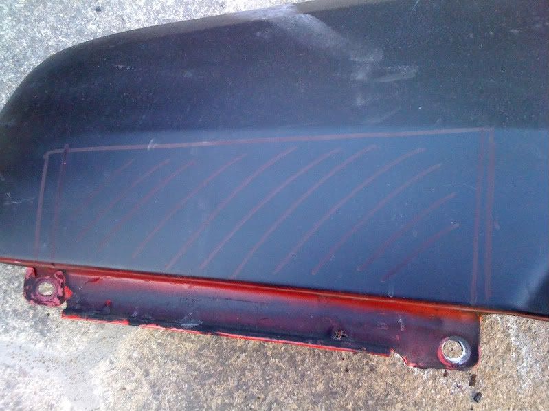

waynos 0 Posted July 19, 2010 right got the wing vent in today took the wing off and layed the vent on top, i drew around that in permanent marker heres what needed to be cut out hole cut and vent sat flush with wing prepped the edges for welding Tacked in. Then spend ages welding the whole thing up then finally filled and primed, still have loads more to do on it , ut its taking shape! Quote Share this post Link to post Share on other sites
Rams 0 Posted July 19, 2010 Looks very good mate, how did you settle on location to wing before cutting? I'm keen to see what you do to the inner wing, keep us posted! Are you using etch primer? Quote Share this post Link to post Share on other sites
waynos 0 Posted July 19, 2010 haha cheers kempy i try my best! rams i just had the vent in different places until i saw the position i liked. Also had a butchers on the vortex forums and they have a few different placements. I was going to have it so the middle vent was on the body line but something didnt look right. So glad i got a sprinter vent over the transporter vent! ive used etch primer on all the bare metal parts then went over the top with filler primer Quote Share this post Link to post Share on other sites

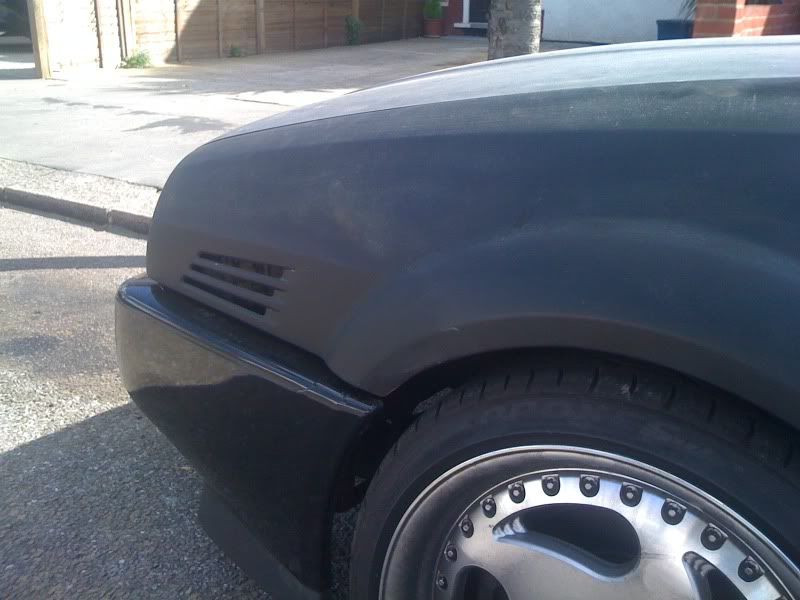

waynos 0 Posted July 20, 2010 well got the wing pretty much done, indicator smoothed off too.There were a few bits of rust that need grinding out but its all sorted! The heat hit me today, just wasnt comfortable working lol. tommorow i want to refit that wing, take the other off for smoothing and maye get the drivers door smoothed too. Hows yours coming along rams? Quote Share this post Link to post Share on other sites

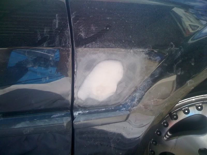

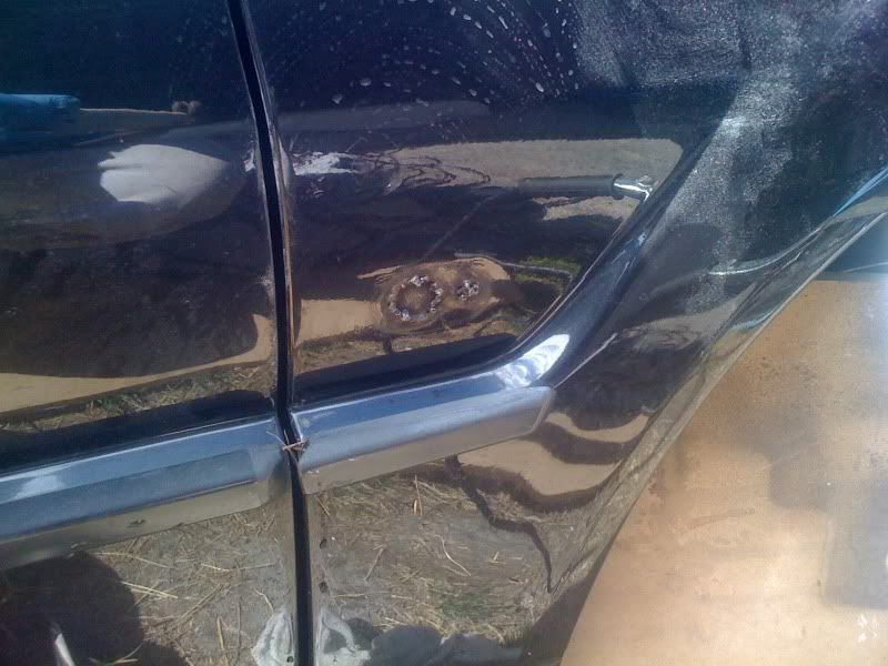

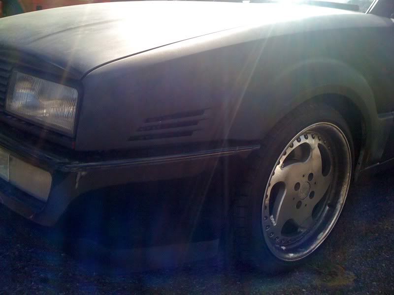

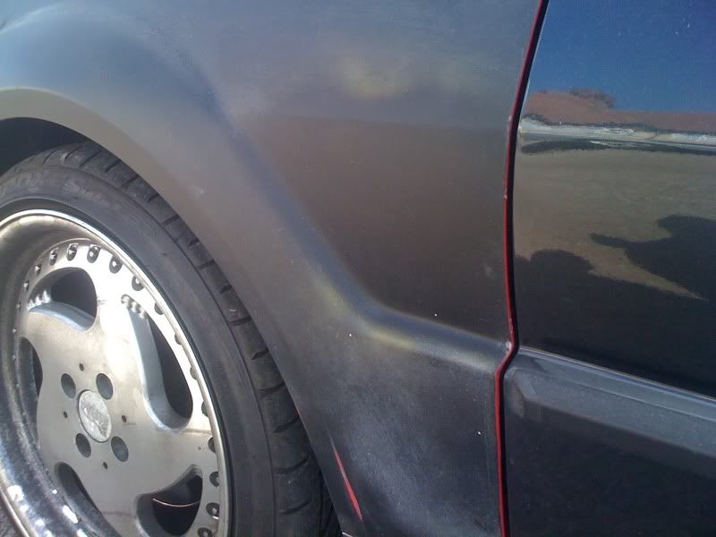

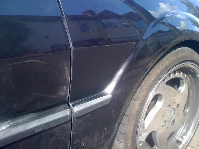

waynos 0 Posted July 21, 2010 finally it feels like im getting somewhere! welded up drivers side side repeater filled primed and guide coat flattened and painted bumper tow eye shaved! and painted heres the badgeless, seamless and smooth bumper in one shot vw badge ... bye bye other corner passenger side repeater gone and finally a couple of the wing vent Quote Share this post Link to post Share on other sites
