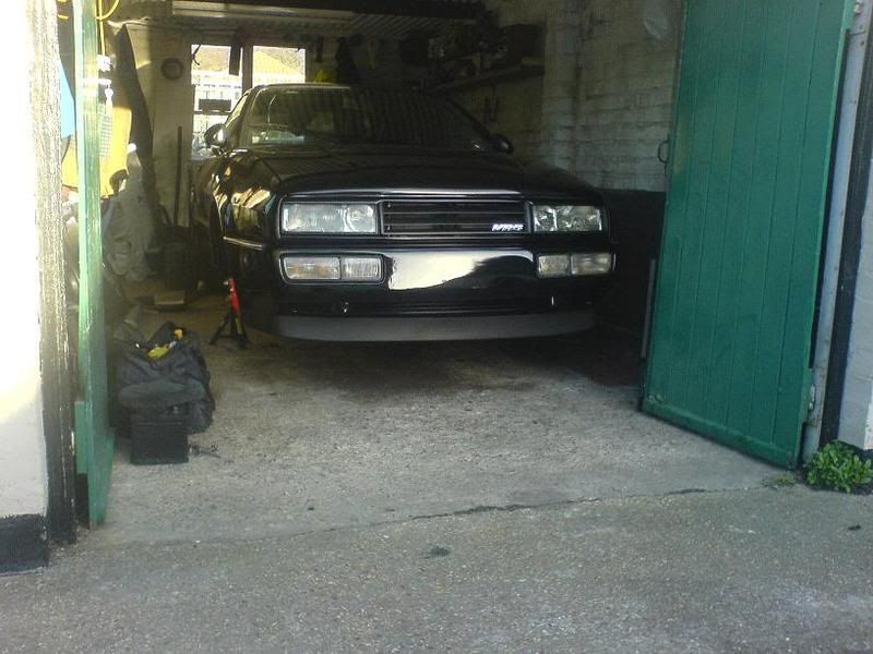

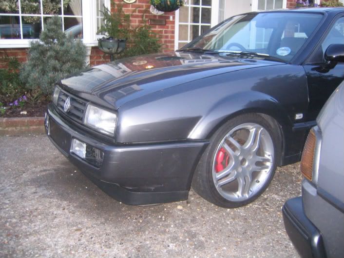

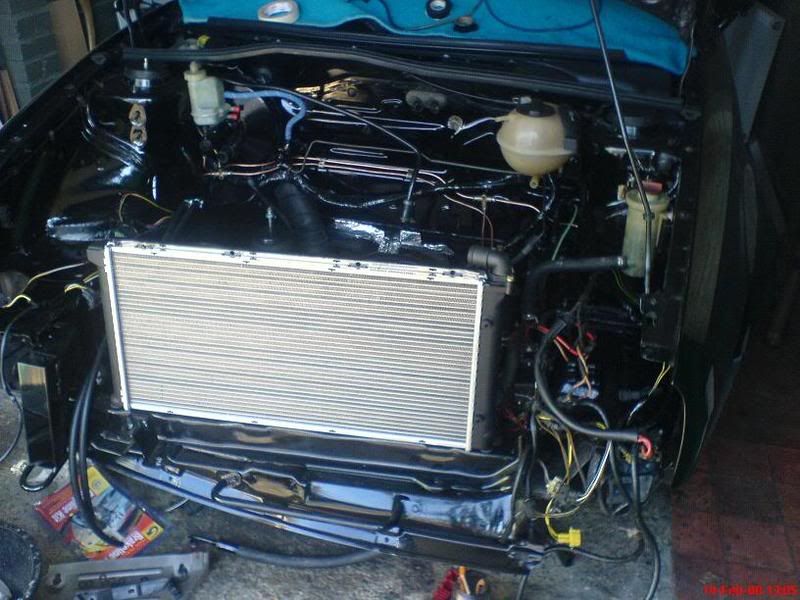

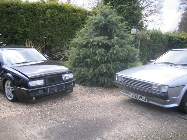

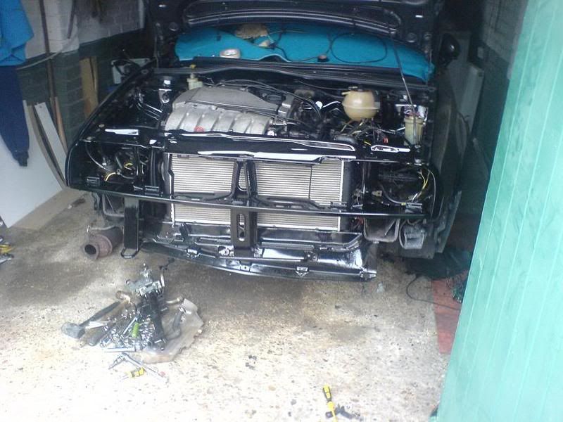

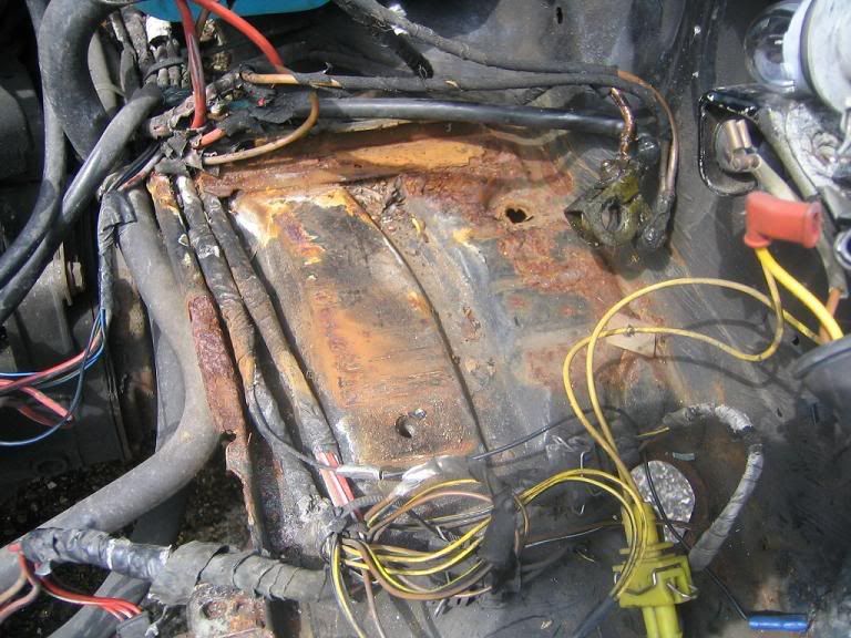

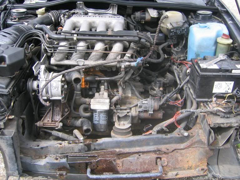

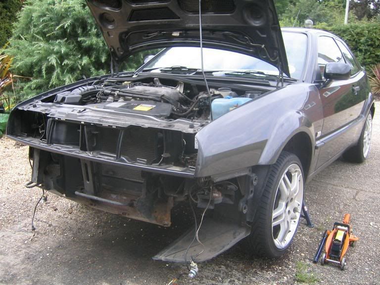

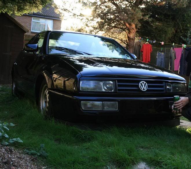

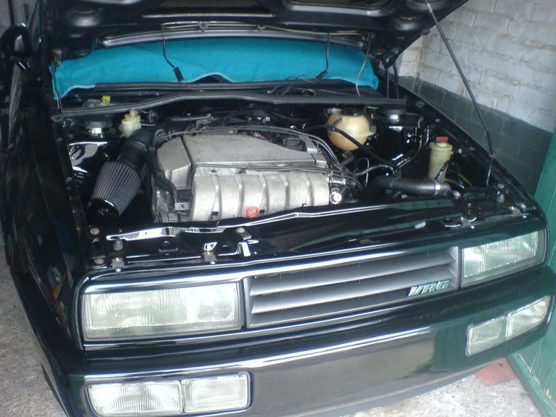

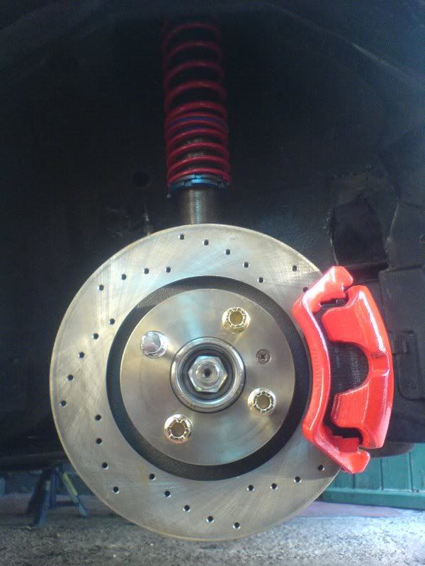

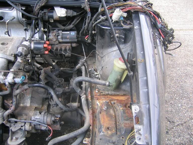

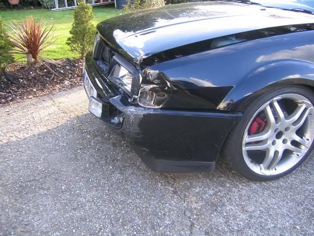

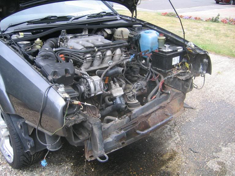

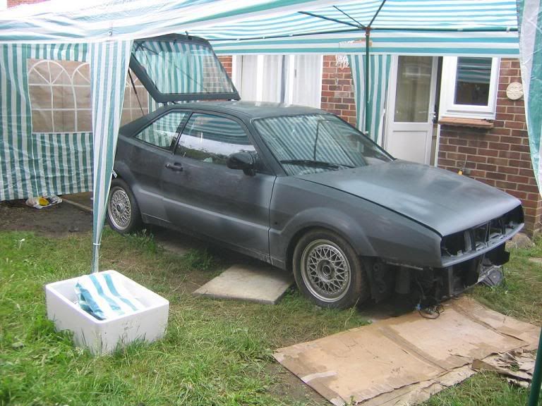

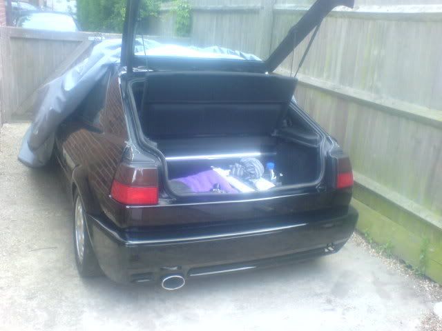

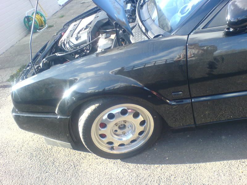

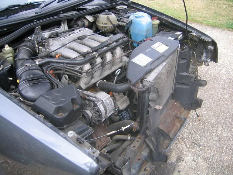

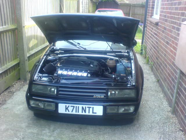

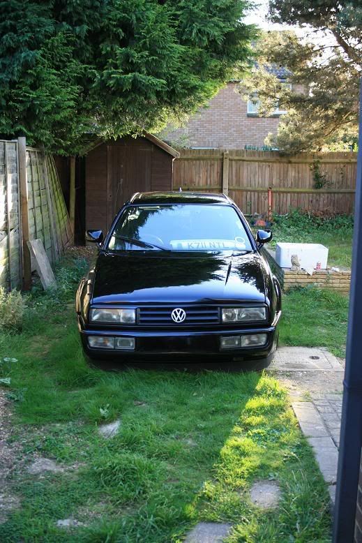

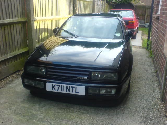

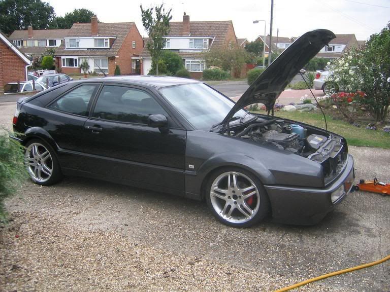

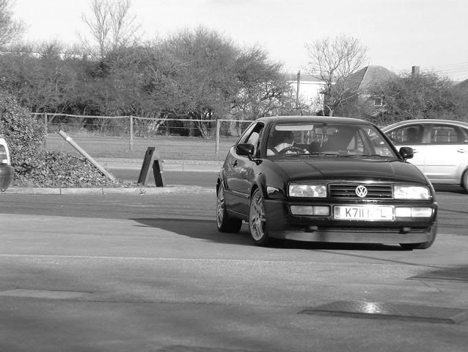

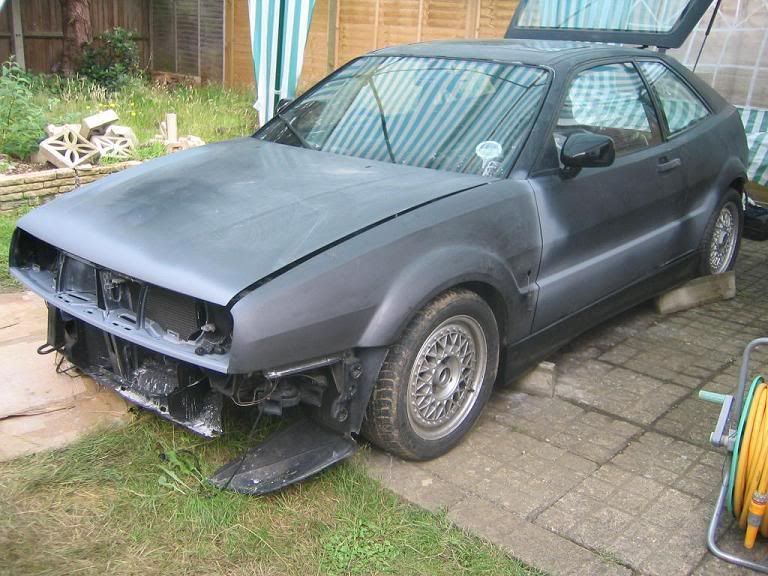

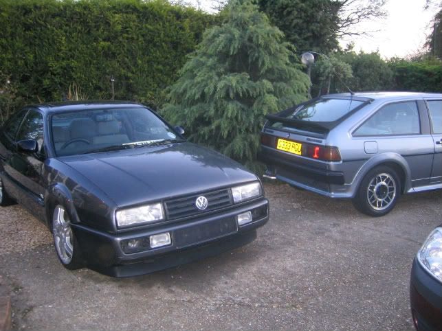

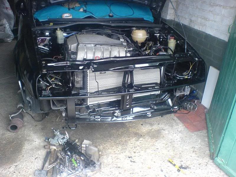

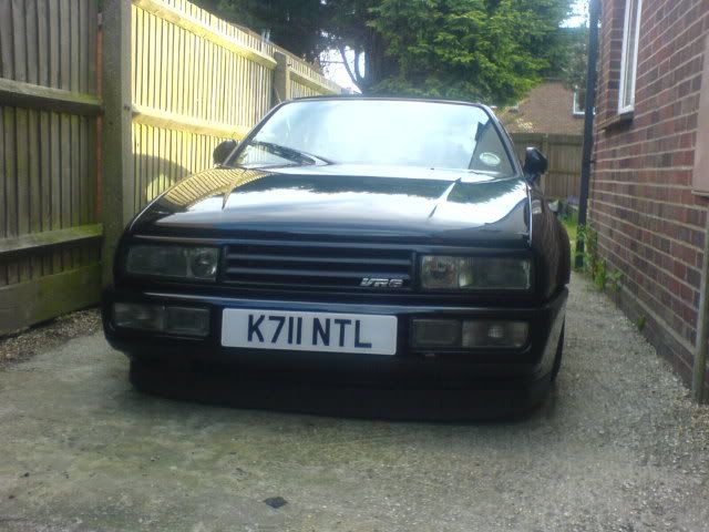

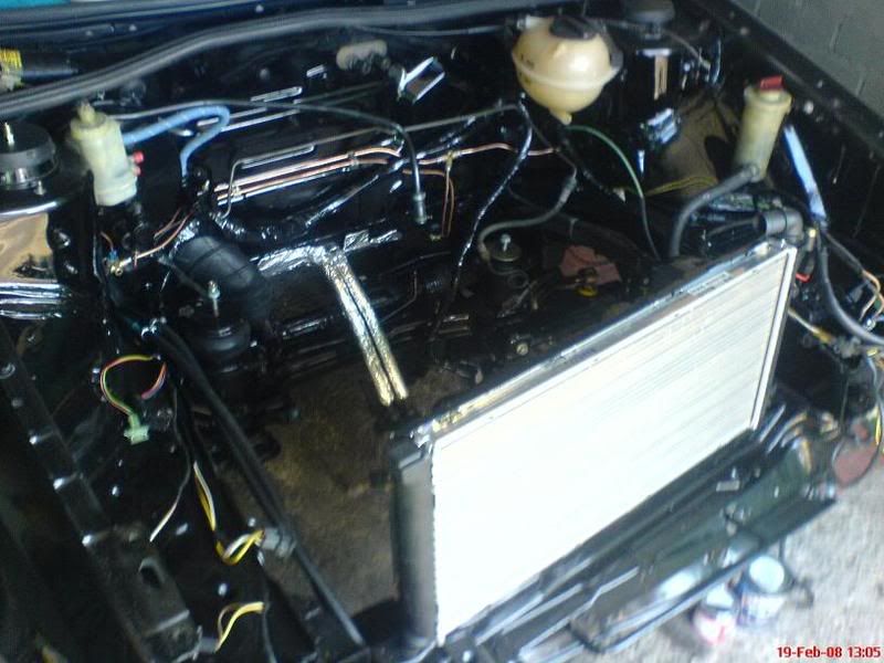

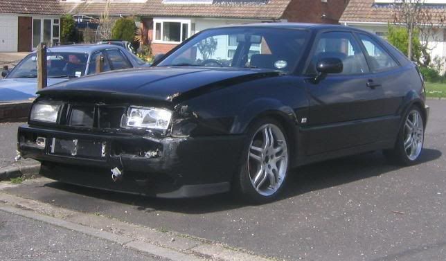

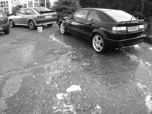

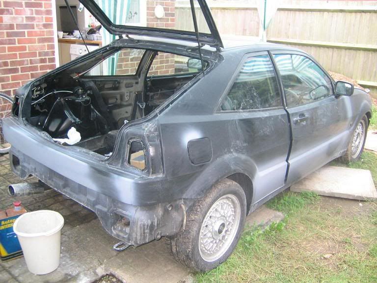

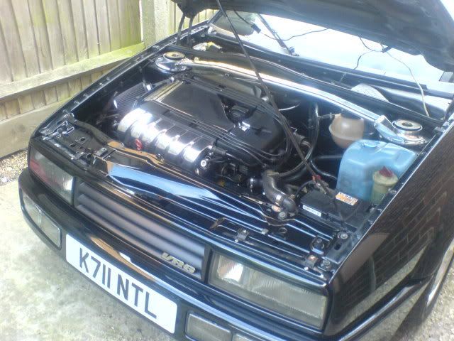

Chris 0 Posted June 6, 2008 so ive been on here for awhile and i havent really posted any photos of my corrado. thought it was about time i uploaded some :) this is a progessive gallery, please bear with it, the first photos are crap but had to get the whole story across. i bought it afew years ago after deciding i'd had enough of my scirocco, got it cheap from a friend knowing that it was very reliable. heres some of the first pictures (sorry there in black and white) the paintwork was ok but not like it is now. a brand new bmw then decided to clip me on a blind corner awhile back (i was pulling out, he was doing more than the speed limit) i was gutted! my first accident in the only car ive ever really wanted (apart from a mk1 scirocco :D ) the damage.......i was very lucky really, only body panels needed replacing, nothing else moved, oh and of course myself and the c*@t bmw drive werent hurt at all then had to decide should i lose it or restore it. i decided to restore it, a decision i regreted untill my respray was finished (that paid me back in full!) the rebuild.... did the clutch, headgasket etc etc after that. the bay was a state!!! also put a pretty much perfect condition full late black interior in at this point didnt take any photos of it though :cuckoo: then came the prep work for my respray, had a big tent up for the car n everything, did it all myself to save the pennies after the respray.... :D the vr conversion, lost the 2l 16v and completely re-did the engine bay (sorry about the poor quality photos, i had the use my phone camera for these as my proper camera broke) near everything has now been replaced for new or completely reconditioned and recoated to keep my 4 stud bbs rm's ive used 2l 16v hubs, hub carriers, arb, cv's and drive shafts on a vr sub frame. vr brakes all round, i kept 16v rear axel too. its being run on the 16v fuel pump aswell. replaced every bushing for polybushes, deleted the abs and replace all the brake lines + all round braided lines. coilovers, top mounts, 6-2-1 s/s manifold + exhaust system, s/s decat etc etc..... these are the buget coilovers which have swamped the market recently, worth every penny! my mate has fk coilovers(high sports i think) you dont notice the difference, plus you cant complain when they come with a 2 year warranty aswell after sorting out the 5 clogged up injectors i got it running, i was so happy, the fact the engine had been sat for about 3 years and still sounded new was amazing, no funny noises at all! running smooth aswell! my lucky day! sporting my mates polished audi wheels as the bbs's still arent finished yet (not really my cup of tea these arent) after putting the rear audi wheels on it went for its first vr mot, flew through, didnt have any worries really, everything was new. this is how it stands today, bbs's still not done but will be in a few weeks. ive poured my soul into this car since the crash with a very tight buget, and its almost there :D im no expert when it comes to cars but having done pretty much everything myself apart from the final coat of paint, polishing the rocker + manifod and pressing the polybushes i dont think its come out too bad at all. you could say, another corrado saved looking back at the first photos low enough for you!? this may have to change :) wana say a big thank you to everyone who has either given me advice, sold me a part or bought a part off me to aid funding this obsession, you know who you are. youve helped put a big smile back on my face :D :notworthy: again sorry about the photo quality they really dont do it justice Share this post Link to post Share on other sites

Chris 0 Posted June 7, 2008 cheers for your comments guys. hopefully ill be making it to some meets this year. very very nice mate, how long has it taken you and who did the spraying for you. looks a mint job :D well it was crashed into last year, prepped and resprayed last august, then my 2l 16v ecu decided to cook (it had an aftermarket chip in it) the circuit board was proper black! so then it sat in my back garden till i decided to go the vr route. the engine conversion itself didnt take too long, 3 months of weekends whilst i was sourcing parts aswell. the car was sprayed at causeway repair center, totton, hampshire. i knew the main guys son so he did me a great deal. cheapest ive ever seen a full spray job go for. and they have done a spot on job! id highly recommend them Share this post Link to post Share on other sites

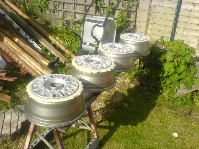

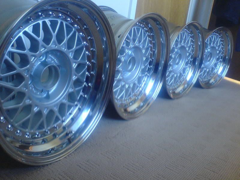

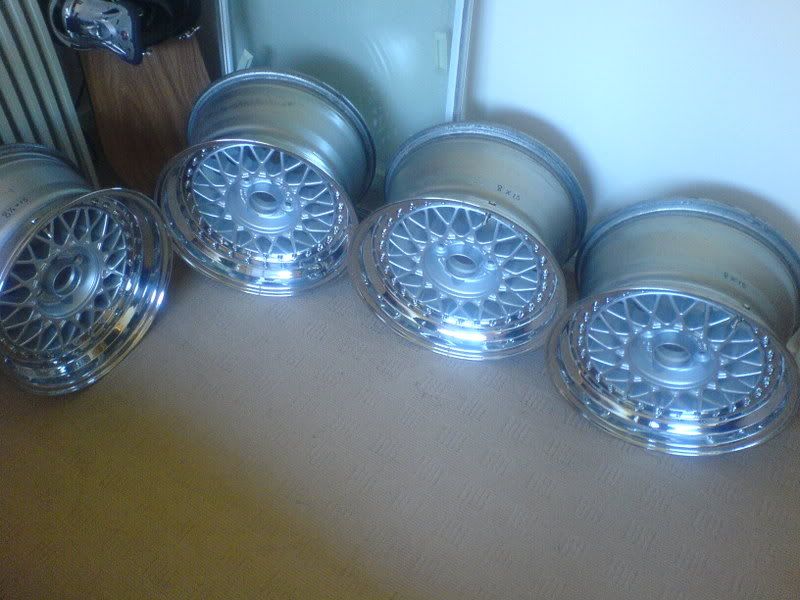

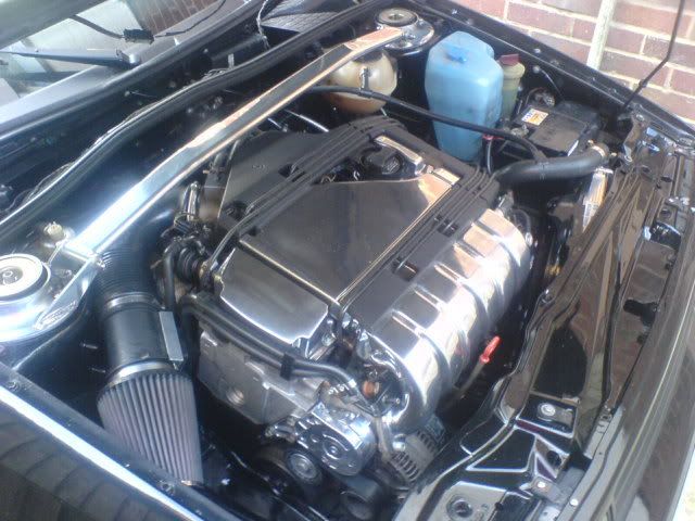

Chris 0 Posted July 14, 2008 finished the barrels again, and fitted the new stainless lips. buying a decent camera is currently on my shopping list coz my phone camera is :censored: Share this post Link to post Share on other sites
VAG-hag 0 Posted July 14, 2008 Very nice looking C & the wheels look V tasty too 8) Good work mate :notworthy: Share this post Link to post Share on other sites

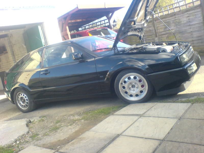

Chris 0 Posted July 27, 2008 finally bought a proper camera :D Share this post Link to post Share on other sites
BILLCOR 1 Posted July 28, 2008 Looking good Chris, the RM's will look great against the dark paintwork 8) Share this post Link to post Share on other sites

jack 0 Posted July 28, 2008 Hi mate that looks very nice and tidy. where did you get the engine cover from (the top part) I've been looking for one for ages Share this post Link to post Share on other sites
