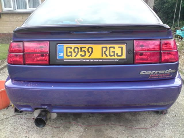

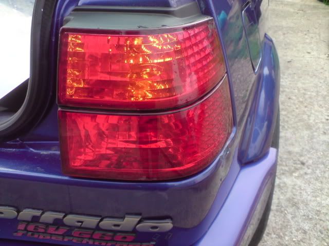

flusted 0 Posted July 18, 2008 Done my crystal m3s with foliatec paint yesturday Quote Share this post Link to post Share on other sites
vwdeviant 0 Posted July 18, 2008 Looks good, how's the match in real-terms to the red lower part though? Needs a stripe of Satin black between the lenses and the uppers surfaces spraying satin too IMHO. Quote Share this post Link to post Share on other sites
flusted 0 Posted July 19, 2008 Camera doesnt do it justice, its a perfect match. Agreed on the black aswell Quote Share this post Link to post Share on other sites
