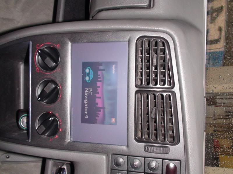

ive downloaded navigator 9 and use that with a usb gps reciever.... i have just seen today tom tom 5 works with windows and you need to run it on an emulator.....il p[robably get round to doing this sometime soon.....
i fitted a screen with ease into the centre console id just go with the flow you can always pic up another console if it goes tits up......
i have on the other hand thought about turning mine back to standard so may even sell the console as a job lot.....

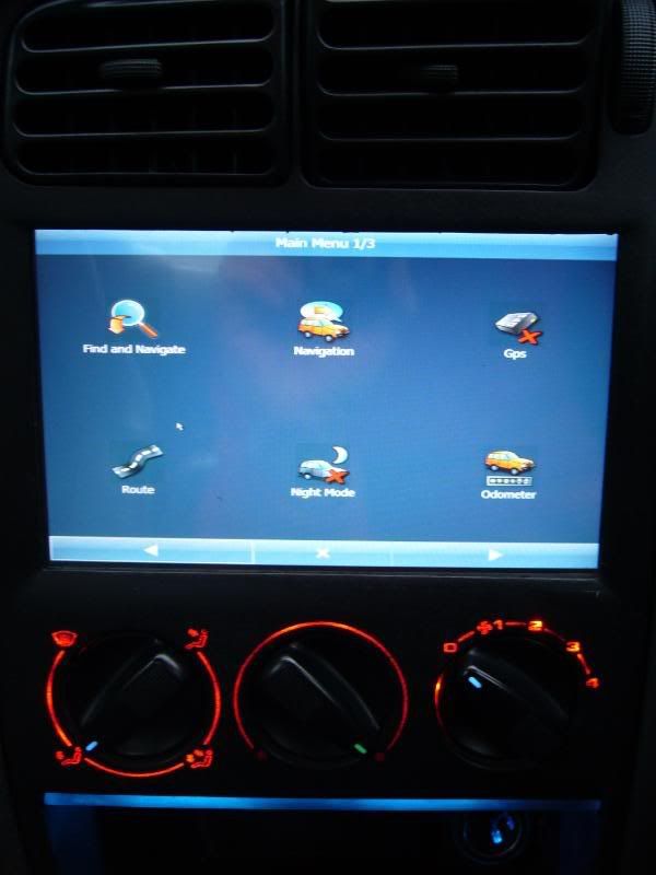

ive got a 8" moniter system in my dash atm
got a rear view cam
it can run off a sat nav through moniter and mp3, pretty much anything can go into it
i imagine it will be loads of hassle though with moulding it into place.

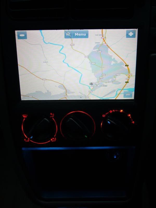

heres mine took about 45 mins to do it 6cd changer included i now hate using tom tom in the work vehicles
11.jpg[/attachment:3f0ehz5p]
looks really great mort, but surely it took longer to relocate the heater controls too? The only issue i have is the updates etc and functionality. I do like that in the tomtom plus the fact that its portable.
Looks so good Mort, as much as OEM as one can get. Would love one of these in the future.
Got any more details on your setup? Cheers mate.
