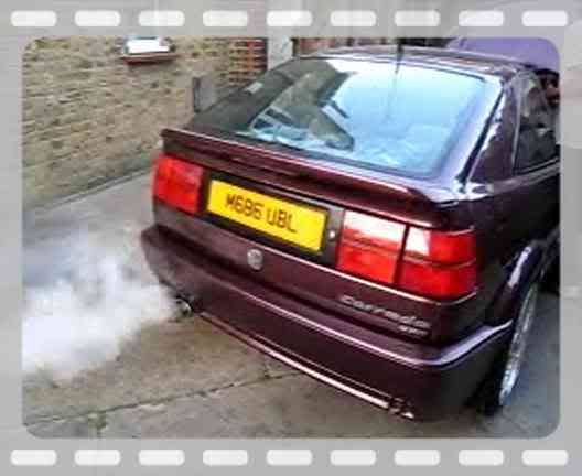

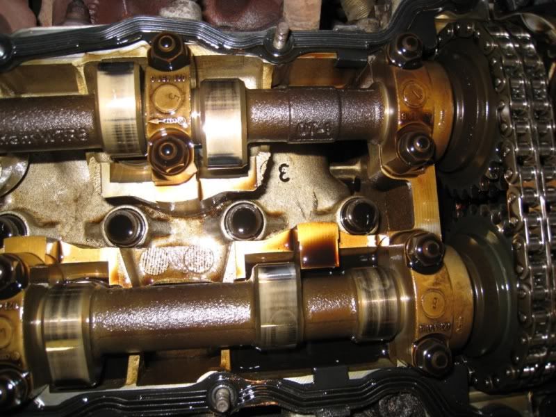

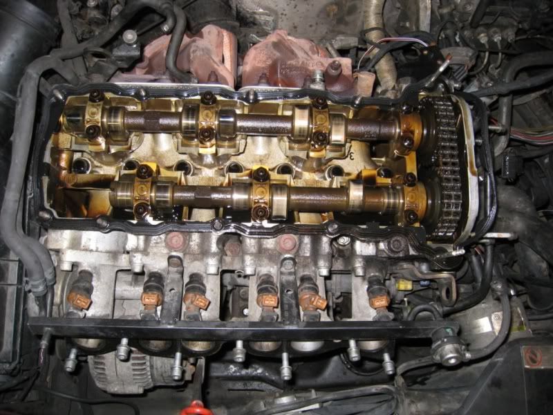

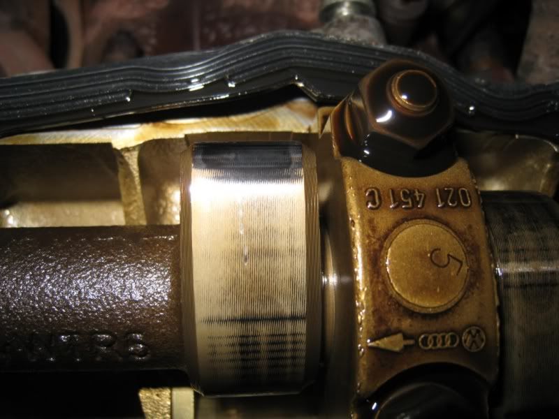

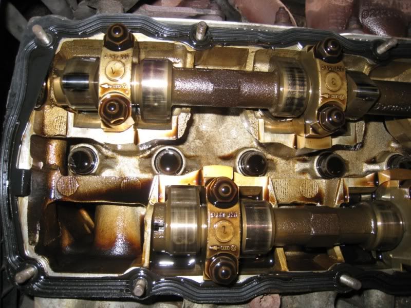

zak 0 Posted July 23, 2008 i took the car for a quick drive up my road and it left a huge smoke screen behind me :eek: So back to base and heres a vid of the smoke. Decided to take the head of, this is where its as now, Theres a mark on the cam lobe, anything to worry about? Quote Share this post Link to post Share on other sites

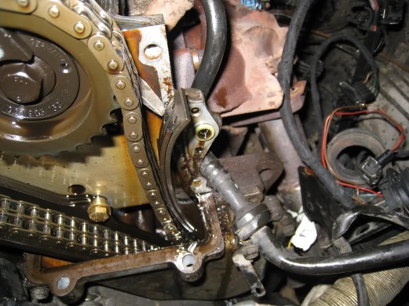

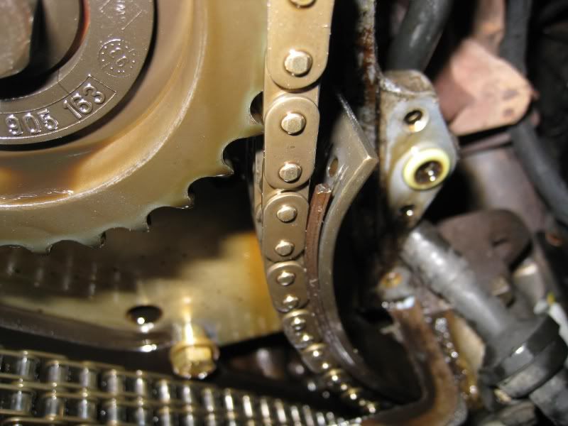

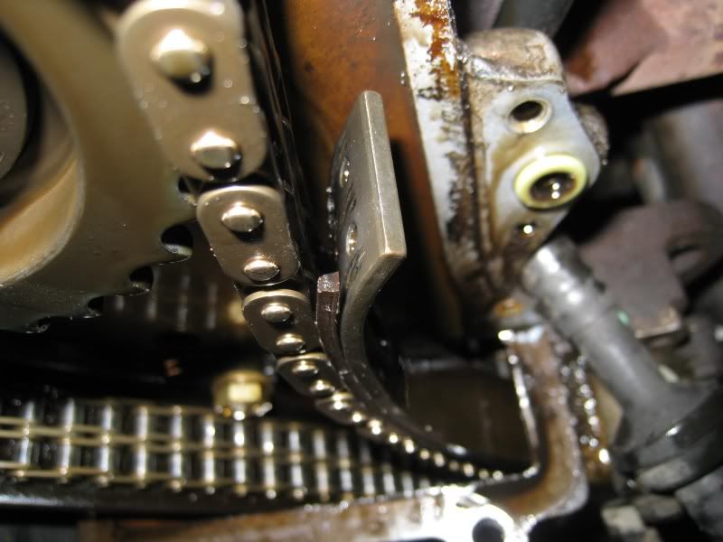

zak 0 Posted July 24, 2008 After a further strip down i was greeted by this Looks like i will be doing the chains and tensioners this weekend too :lol: I couldnt get the head of the block, i removed all the head bolts, one of which snapped and still resides in the block. I removed the tensioner on the left hand side on the head. I removed the upper chain tensioner along the upper chain cover, i have removed the cams. The exhaust manifold is disconnected. I also undid the dipstick guide from the lower inlet. The head will still not lift off. I have left the lower inlet on,do i need to remove this too? Is there anything i have missed? Quote Share this post Link to post Share on other sites
fla 9 Posted July 24, 2008 To remove the head, once all the bolts are off tap it either side with a heavy rubber mallet, in fact tap all four sides. As its rubber you can whack it quite hard. Basially the head is 'glued' on with the head gasket and hundreds and thousnads of miles of setting hard. As my head was being replaced, i used a soft wide screwdriver under one edge as as a wedge to separate the head from the block. There are also some collet guides which help keep the head gasket in place which sit in the block. Tap across and upwards, sort of diagonally upwards. It will take some time but it will come off. Glad to hear the ecu helped. I'm out most of this weekend otherwise i would have come over, but if you haven't finished it by next weekend give me a shout. Quote Share this post Link to post Share on other sites

pete_griff 0 Posted July 24, 2008 definitely agree it's worth getting it skimmed don't forget to retrieve the little white sealing o-ring on the side of the head that provides the seal for the oil to go to the tensioner bolt - mine stayed on the side of the head in exactly the same way when i did it (as shown in your pics). after that i purposefully left it where i would notice it so i didn't forget to put it back in on reassembly! good luck sorting it all out matey. one of my bolts snapped when i took mine off as well - not funny! - you will have some fun getting that off :? my upper tensioner wasn't quite that bad, but mine was missing one of the rivets, the other one was still there. i just left mine and pretended i didn't see it as the engine wasn't required to live that long anyway. i'm really miffed now as to what my problem could be as yours seems exactly the same as mine, but i've done my head gasket and i'm fairly confident it's sealed as it should - i haven't done a compression test since, maybe i should... really hope it all works out for you anyway buddy :) Quote Share this post Link to post Share on other sites

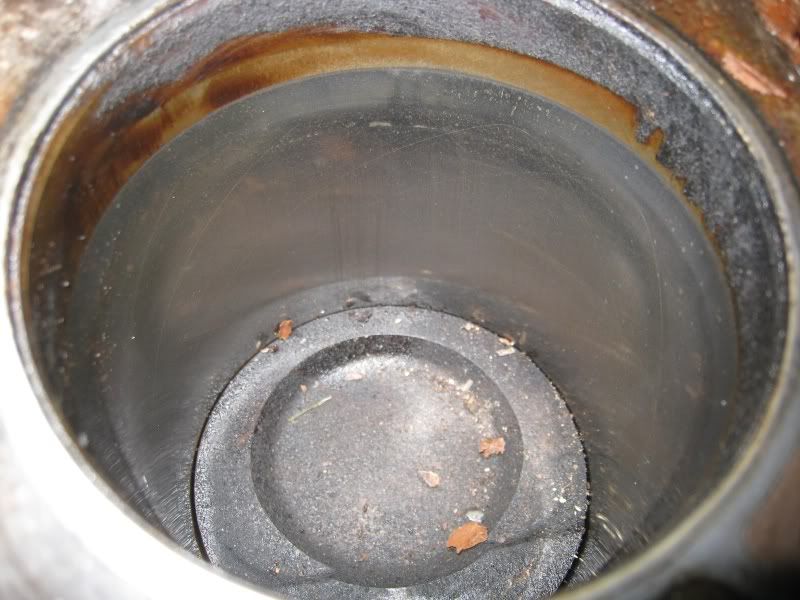

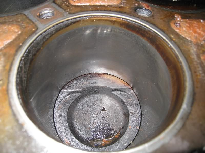

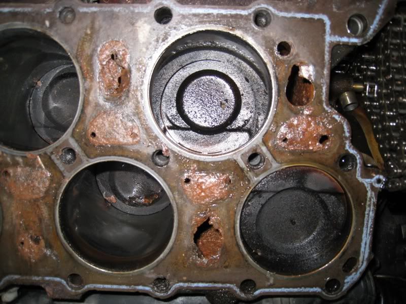

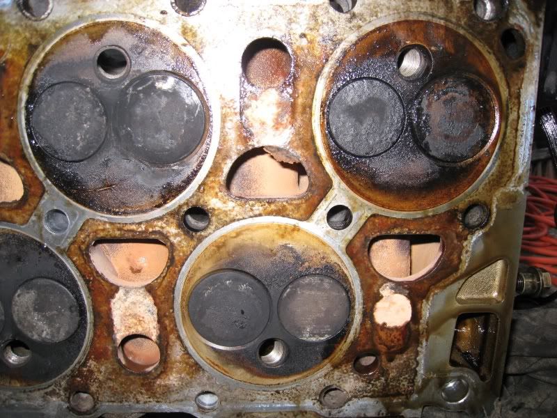

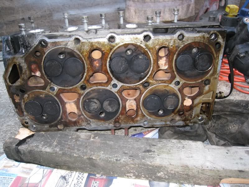

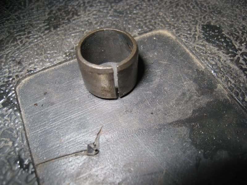

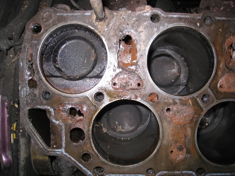

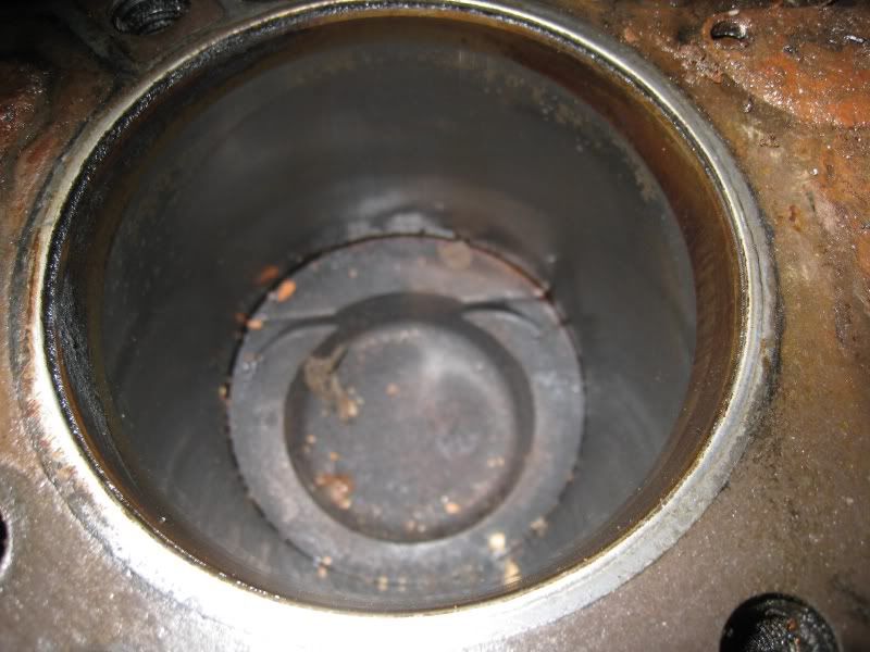

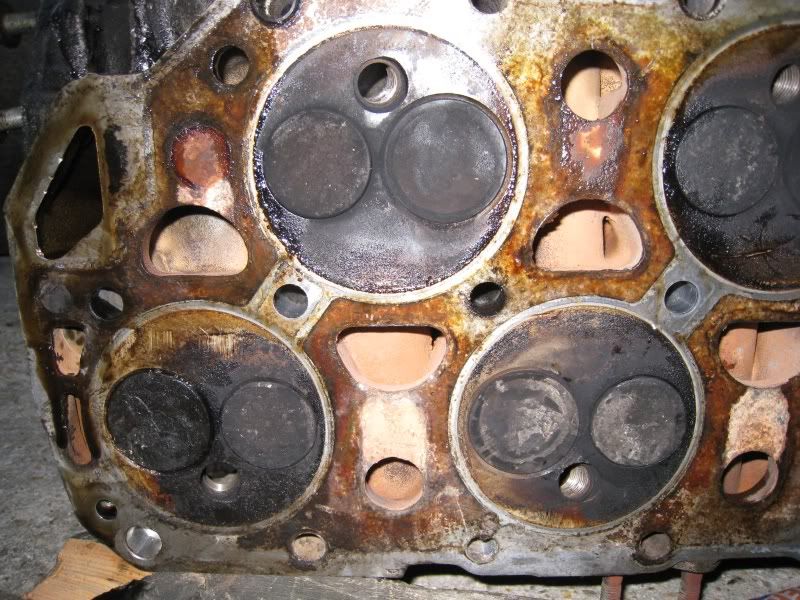

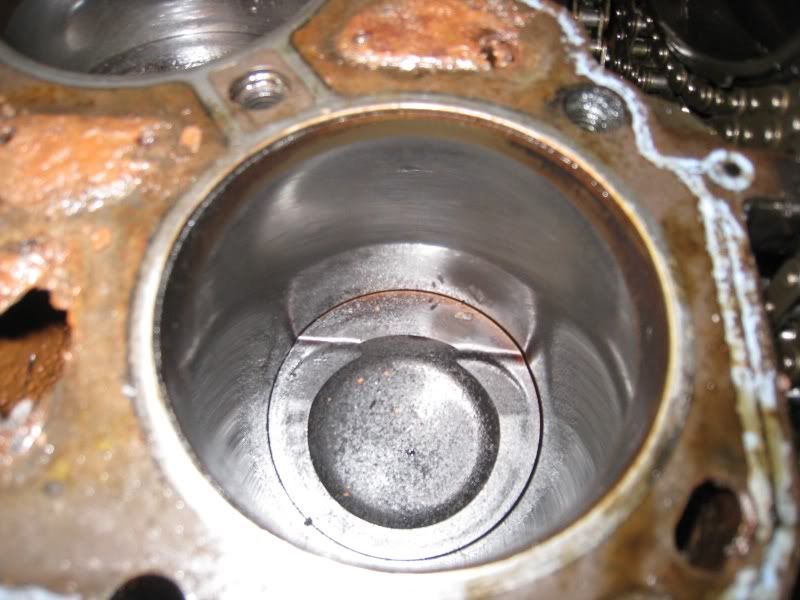

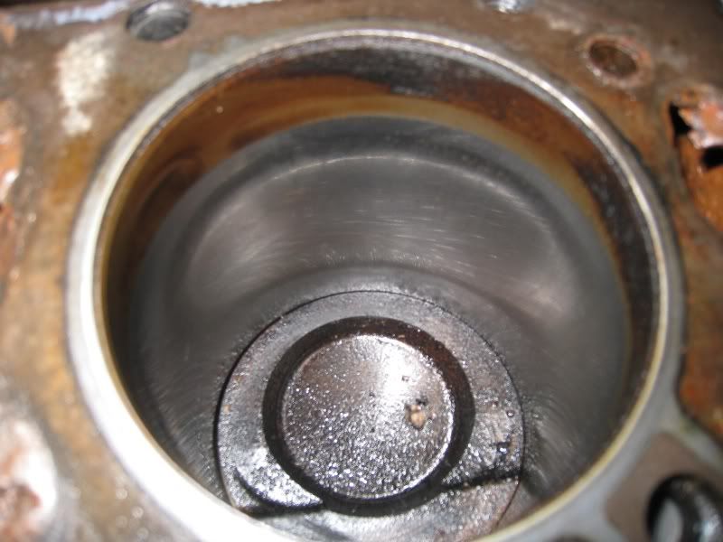

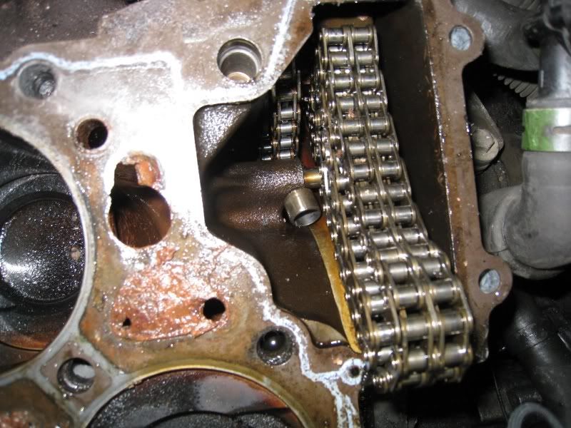

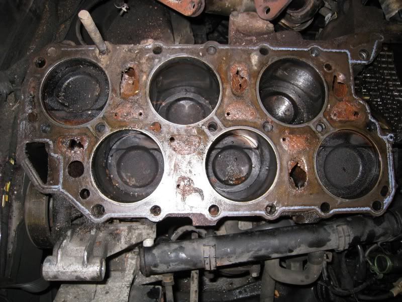

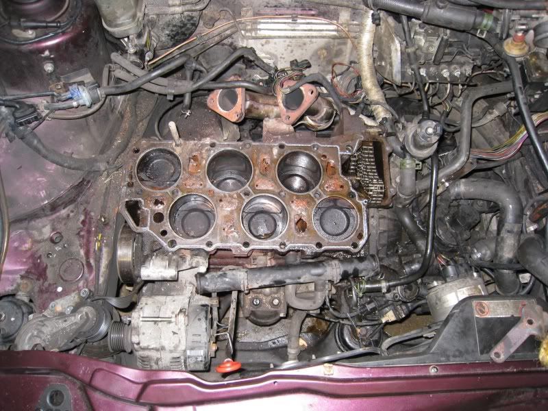

zak 0 Posted July 24, 2008 The head is off but i can't seem to see a break in the gasket... Heres the pics Also whats this? looks suspiciously like the starter motor bush but it has a slit in it Heres some pics of the bores Cylinder 1 Cylinder 2 Cylinder 3 Cylinder 4 Cylinder 5 Cylinder 6 Heres some pics of the underside of the head Does everything look as it should? If there is no break in the head gasket what could have caused the problem? Quote Share this post Link to post Share on other sites
CorradoVR6-Turbo 0 Posted July 24, 2008 there are a few marks on the head which look suspect,but NO5 is defo gone,you dont need to see a obvious break in the geasket for failure,weeping coolant in under presure is more likley.The dowl sitting on the chains is just cos you lifted the head off. Im positive when you get the head back on and skimmed it will be sorted :D Quote Share this post Link to post Share on other sites
nemesis360 0 Posted July 24, 2008 The little ring is one of the locators that clip in the head to locate it when you put it back on , if you look youll notice 2 of the head bolt holes are slightly bigger...it clips in there. There wont be a big break in the head gasket it only has to be a small leak to make alot of smoke, running problems etc. There doesnt look to much wrong with the cylinders either. Quote Share this post Link to post Share on other sites
