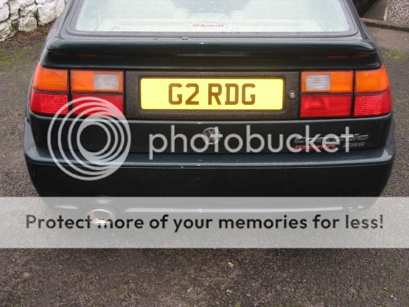

Also got my 2 box Jetex fitted. Really pleased with it. Looks lovely and shiney and doesn't sound chavvy in the slightest. The garage commented that they thought it was very good quality too which is always reassuring.

I wondered the very same thing before I got mine. One is a 2 box, the other a 3 box. From what I can work out, the 3 box is a little more restrictive and a little quieter. However, I went for the 2 box and it's not too loud for me. Shall have pics in the morning but I think it looks pretty good!
So yours is the second one in the list??
Yeah. Click on the pictures and you'll see that one has a straight through pipe (on the right of the pic) and the other has a silencer unit. Don't think it'll make too much difference to be honest which is kind of the reason I went for the cheaper 2 box version.
I'll get pics up tomorrow and if I'm feeling techie, maybe a vid!
Cheers fella new exhaust for me soon between magnex and jetex now after you commenting on good fitment and not too boomy!!

This is a pic of the Jetex. It was shiny until I started running up and down the motorway - all cacked up already now!! It's settling in well, even feels a bit more responsive but I may be dreaming on this note!!
