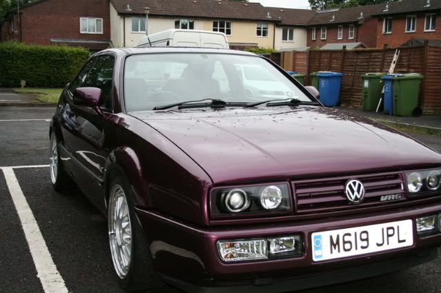

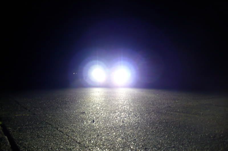

paul20v 0 Posted February 8, 2009 Hi i bought my inpros for the light output and also with a 4500k hid kit installed there fantastic , quality is as good as oem and it uses the same adjuster , and there a piece of cake to change from lhd to rhd. i personally have no down side , there either a love em or hate them light also some may say you have lost the originality but you loose that when you bolt a set of non oem rims on or lower the car etc i will leave a pic mine also have lens protectors on just in case you thought they looked different. Quote Share this post Link to post Share on other sites

Critical_Mass 10 Posted March 8, 2009 Das the lights dont sit flush with the grille, they sit about 2cm further in on later models. Though looking at the first pic, its a little confusing as going by the badge on the grille its a VR and it can only be a K reg earliest, i had these on my VR and its a K reg but the lights still werent flush with the grille :shrug: Quote Share this post Link to post Share on other sites

paul20v 0 Posted March 11, 2009 what do you mean they sit further back than the normal headlight?? have you any pics side on??. look at my pics on the first page they sit level when you use the headlight protectors which i was happy about as it was some protection too. Quote Share this post Link to post Share on other sites

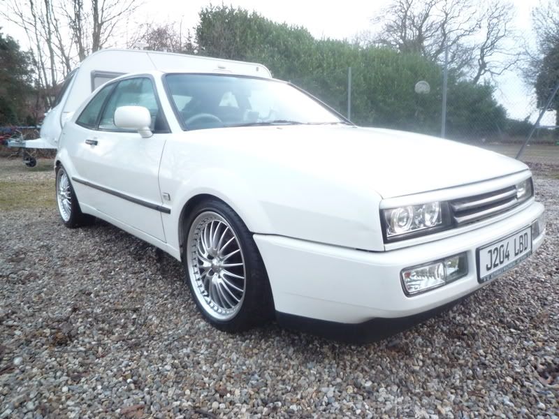

tonedef 9 Posted March 12, 2009 what do you mean they sit further back than the normal headlight?? have you any pics side on?? stupids question... why did you not just by the black ones to begin with or were they not available at the time... im asking all this as i am about to go this route myself with the head and fog lights.. i prefer the black they look awesome imo gives a real mean look to the front of the car... This photo shows how they don't quite line up with the grill, can't get any more right now cos I'm a few thousand miles away from my C in Saudi. I bought the chrome ones from somebody on here, and I don't think the black ones were available then anyway. I just need the fogs now and then find a way to tone those down a bit too Quote Share this post Link to post Share on other sites

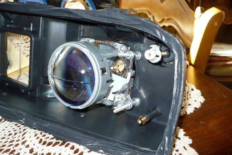

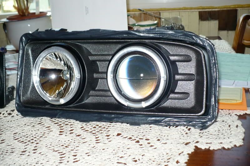

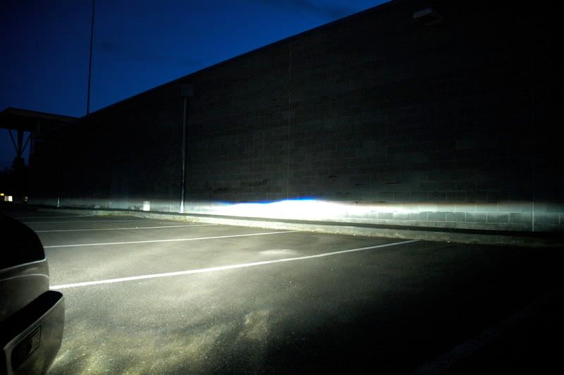

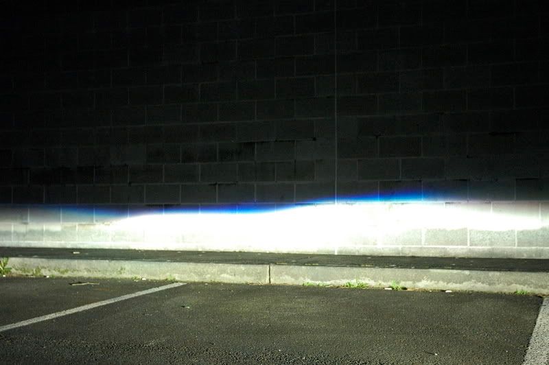

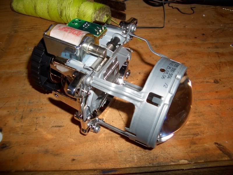

bunnytruck 0 Posted March 14, 2009 I don't care for the inpros much.. So I bought some off of ebay that are very similar to the inpro's but I like the design better and they are only $150 instead of $400. They also have plastic lenses that won't break when a rock hits them like the glass inpro's will.. I put my money into the hid.. I fitted BMW E36 Hi/low beam hid projectors into the housings.. And I upgraded the lenses on those to ZKW aftermarket lenses.. They are designed to upgrade these projectors making them even brighter, sharper and more colorful. So it is true hid headlight now.. Stay away from hid kits.. They suck because the projectors in a halogen headlight like the inpros are designed to reflect the the halogen bulb. But halogens and hids disperse light totally different so it is like putting a florescent tube in a fixture made for a standard bulb... The light won't reflect the same.. Make sense? I have yet to ever use the hi-beams. It is like daylight for 200 feet in front of the car and about 100 feet wide... But if i wish I can turn the hi-beams on and the cutoff shields flip down and then you get some hight out of them too... Inpros with and hid kit are bright but not like these... I have compared them side by side.. The cut off line flicker of color is way better too. Do whatever you want.. That's what I did.. Anyway... Here are some pics for you.. Oh. And the cops have never even mentioned them... That says it all! :salute: Quote Share this post Link to post Share on other sites
C488ADO 0 Posted March 14, 2009 that is cool......... ok so the pic of the naked light/lens.. what is that is that the bmw 36 projector? or is it the uprated lens?? how much are the lens's??? and how much would you expect to pay for the bmw lights?? i guess they are only fitted to the m3 e36's??? this is interesting stuff thank you Quote Share this post Link to post Share on other sites
