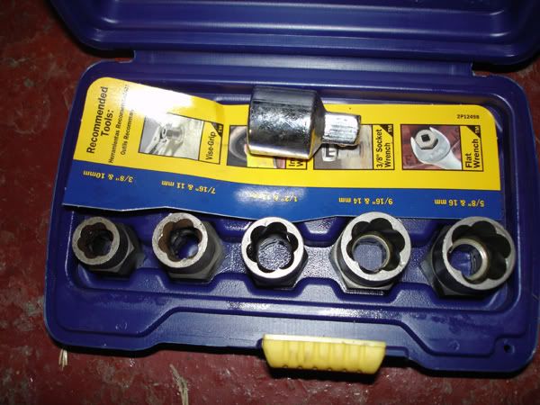

Possibly able to use?

dont think the irwins will touch it, its litterally just a screw head, so theres nothing to bite onto. it'll be a b*tch of a job if you round that head off! when i had the same problem as you, i ended up just pulling the plastic bracket apart, using brute force screwdriver etc, to remove the headlight then fabricated a bracket and put it all back fitting an upright bolt through the headlight bracket and fixed it onto the metal bracket on the car with a nut, until i could get a decent headlight.
The irwins should scare a screw head, they remove allen head bolts! 8) Id definately advise replacing the screws with stainless once you get em out etc.
