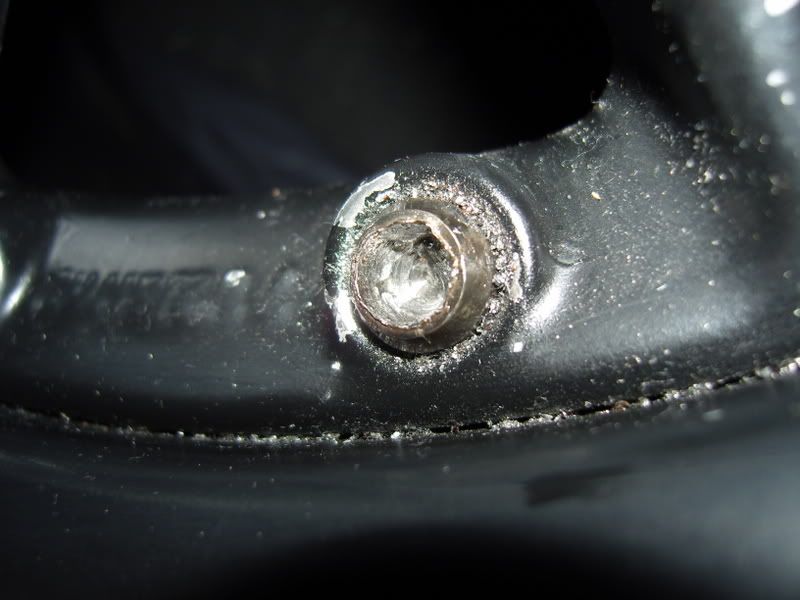

KADVR6 0 Posted February 28, 2009 done 3 of the alloys and i'm well happy with them :D but why is it on the last alloy one of the bolts has just rounded out :censored: all the other 79 have come out with no problems at all :) so how would you suggest i get the last one out?? so far i have use a stud extractor to try and get the whole bolt out in one piece, this did not work and its just f****d up the stud extractor, then thought drill out the top of the bolt get the centre off, and then tackle the remaining bit of bolt, so far i have got through 2 drill bits, even an expensive solid carbide drill :shock: what the hell are these bolts made off?? anyone got any clues what to do next?? (should have left them black) karl Quote Share this post Link to post Share on other sites

KADVR6 0 Posted February 28, 2009 i havent got any irwins, but theres not enough head on them when new to actually get anything round the head as they sit in the actual centre of the alloy :( but cheers for the thought Stu. Quote Share this post Link to post Share on other sites
KADVR6 0 Posted February 28, 2009 heres a pic of the offending bolt and heres a pic of one of the alloys i have done minus the polished bolts/stainless steel valve and new centre cap. Quote Share this post Link to post Share on other sites
Leonard 0 Posted February 28, 2009 Now that is annoying! I was gona say hammer an old torx head into it. But I dont think you have enough metal now. I reckon you could maybe grind/cut a slot in it and then tap it round with a large screwdriver til its loose. Failin that someit like this maybe? http://www.screwfix.com/prods/20084/Van ... %208%20Pc# Matt Quote Share this post Link to post Share on other sites
KADVR6 0 Posted February 28, 2009 i have tried hammering torx heads and spline bits mate, and it just wont budge :( i thought about getting the angle grinder out, but just dont trust myself to not slip and do some damge to the centre, i also tried a stud extractor with no luck either. what about these?? http://cgi.ebay.co.uk/IRWIN-TOOLS-5p-BO ... 240%3A1318 karl Quote Share this post Link to post Share on other sites
pyro3911 0 Posted February 28, 2009 Bummer mate. I don't know if there is any room to weld on a bolt. Then just use a normal wrench. An inch of weld is supposed to take a ton in weight. Hope this is a viable option Ian Quote Share this post Link to post Share on other sites
Leonard 0 Posted February 28, 2009 Hmmm not sure those extractors will do the trick. Have you not got a dremel you can put a notch in the bolt with? If its a steel bolt and you have the room then welding could do the trick! Quote Share this post Link to post Share on other sites
Leonard 0 Posted February 28, 2009 Lookin at it again is there any room to put a chisel on it and just TWAT the bolt head off with a big lump hammer? :grin: Quote Share this post Link to post Share on other sites
Critical_Mass 10 Posted February 28, 2009 As Leonard said Karl, if you've got a dremel with a metal cutting disc. It should be able to cut a slot in it for a screwdriver. It should do the trick. Quote Share this post Link to post Share on other sites
vwdeviant 0 Posted March 1, 2009 Karl, I know he's a bit of an Ar$e but try PMing Mike the Polisher on ED sure he'll have a solution? Have a feeling I rad somewhere the bolts are Titanium on those? But could be wrong and are "just" hi-tensile stainless. Do these BBS bolts need a specific tool like the othrs? :scratch: Wheels looking good though! Quote Share this post Link to post Share on other sites

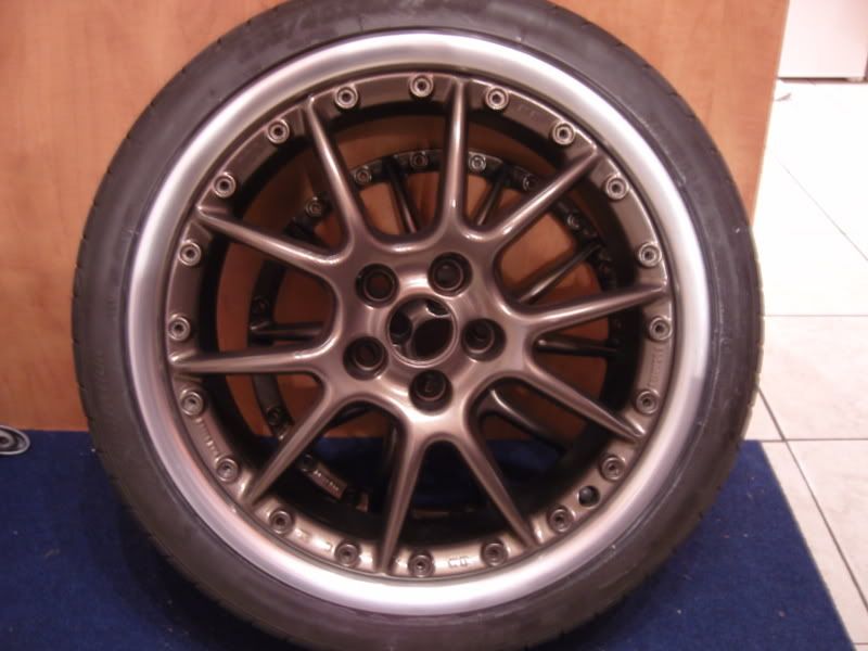

KADVR6 0 Posted March 20, 2009 well they are all polished and painted, i'm happy with my polishing results also :) i haven't fitted the stainless valves as they will be gettig used on my "new" BBS's i bought last week?? yeh i have bought another set of alloys :lol: what do you think then?? Quote Share this post Link to post Share on other sites
