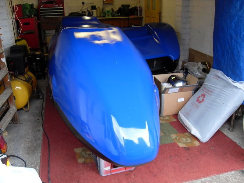

well finally managed to finish spraying the sidecar fairing, although it still needs cutting back and polishing but will get that done when i come back from cornwall before our 1st race of the season :

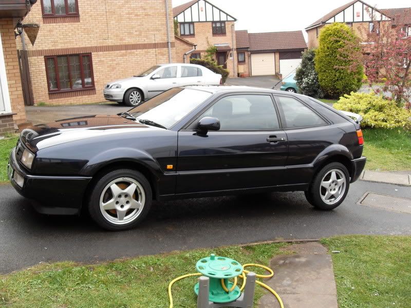

Which meant i could finally change me oil and give the C a quick wash to see what state the paintwork was actually in.

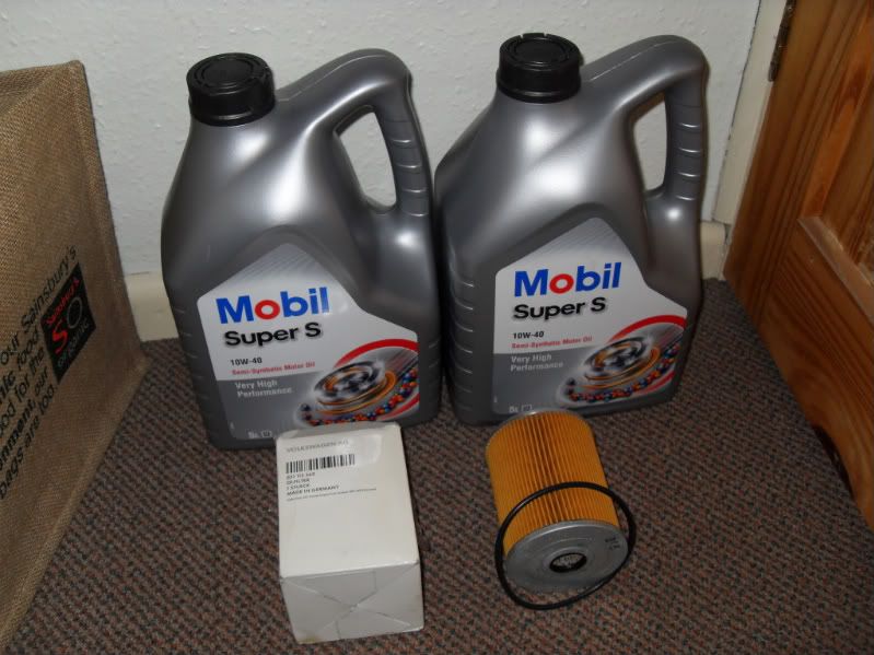

Some nice new golden engine juice and Vw oil filter
Nice and clean .....

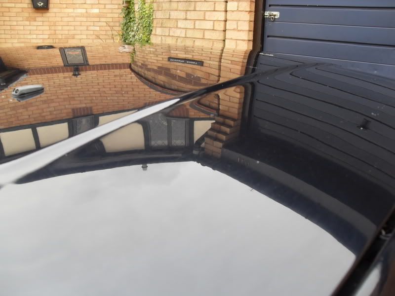

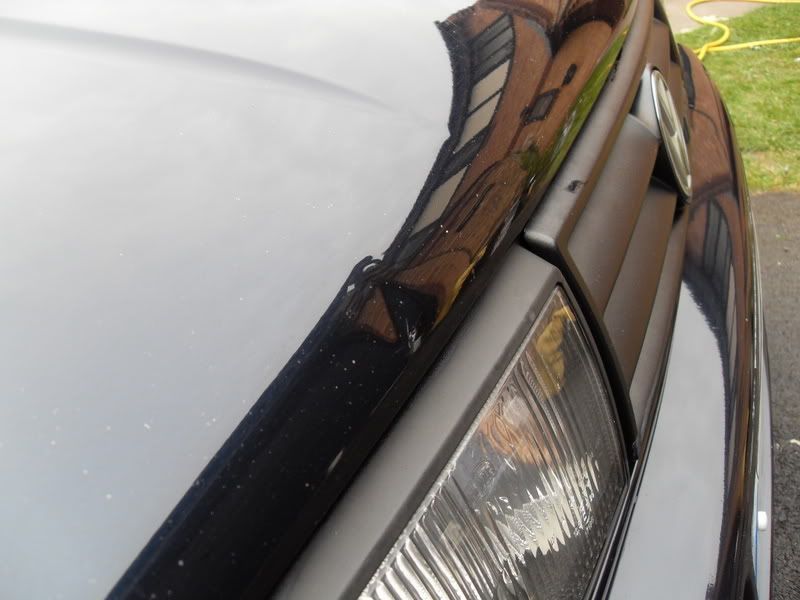

....though paintwork is full of swirls and stone chips with a fair few random scratches, so full machine polish and detail will be happenin once me polisher turns up :grin:

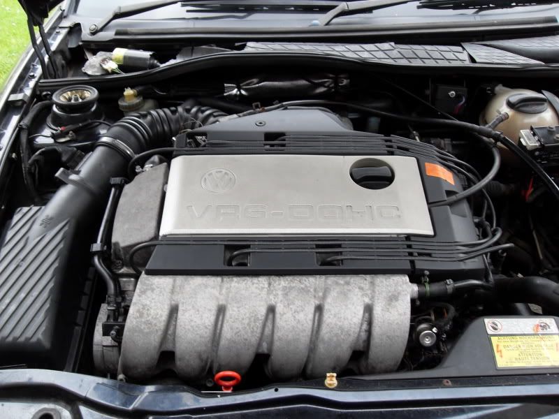

blimey over a month since i last updated my thread :eek: Have managed a couple of things but nothing major:

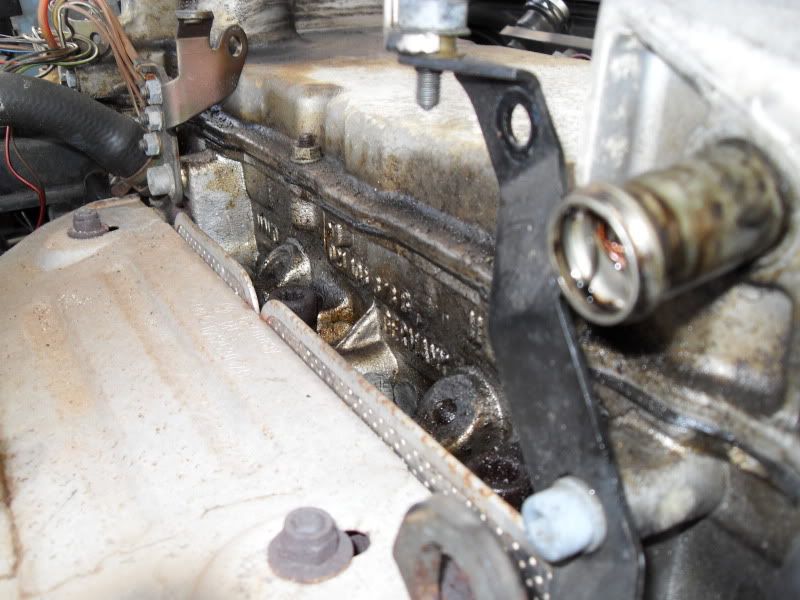

have been busy sorted a few dents and rust patches on me bro's T4 and kinda waiting to move into my house next week and sorted out before i can really get stuck into her. But have changed the camshaft sensor and fitted a new cam cover gasket, was a nice oily mess under the intake mani and all over the head from the gasket leaking and oil being spilt when topping up so clean all that up while i was at it. Car feels much better with a new sensor, more power and tourque and much more lively to drive now :D Also fitted some new front tyres Avon ZV3's, not my ideal choice but were goin at a good price and i've had em before and rate them as being pretty good for the money.
Noticed fine coating of oil in inlet manifold on cylinder 2 and 4 the odd bit of smoke sometimes on hard acceleration and on overrun, plus also reverse, thinkin its prob the valve seals any other/better ideas? Also a slight knockin noise when turning left, c'v joints possibly? had a quick look, boots look ok but will have a proper investigate once i'v moved.

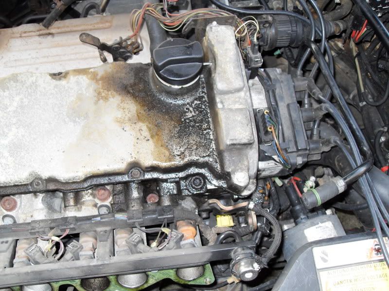

here are a few pics that i was tryin to put up last night :

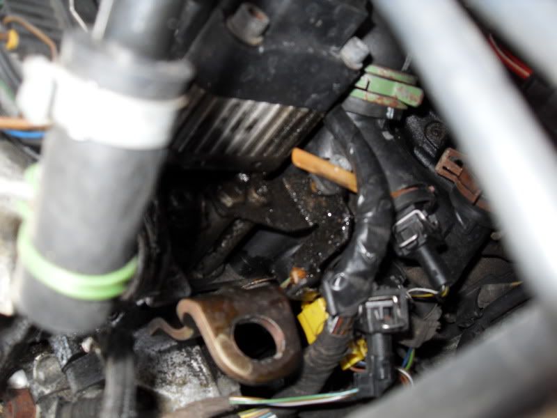

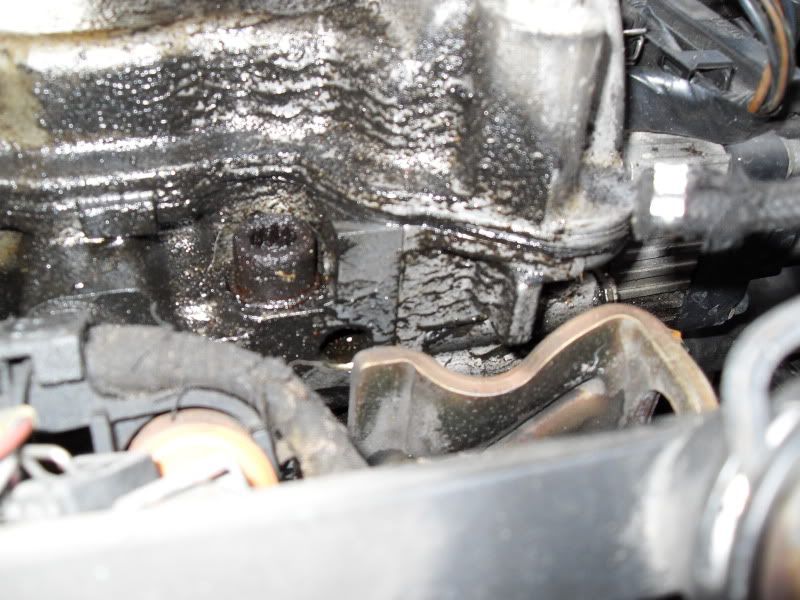

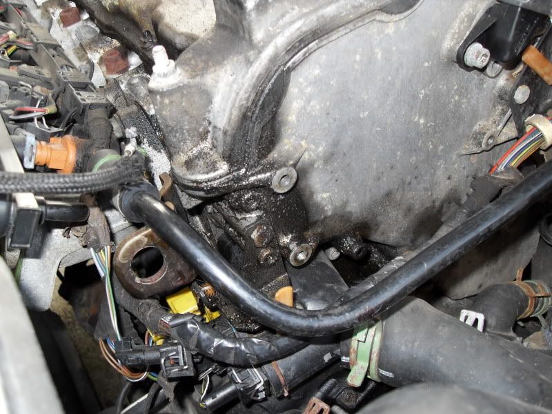

Filthy mess i was greeted by after takin the manifold n that off :(

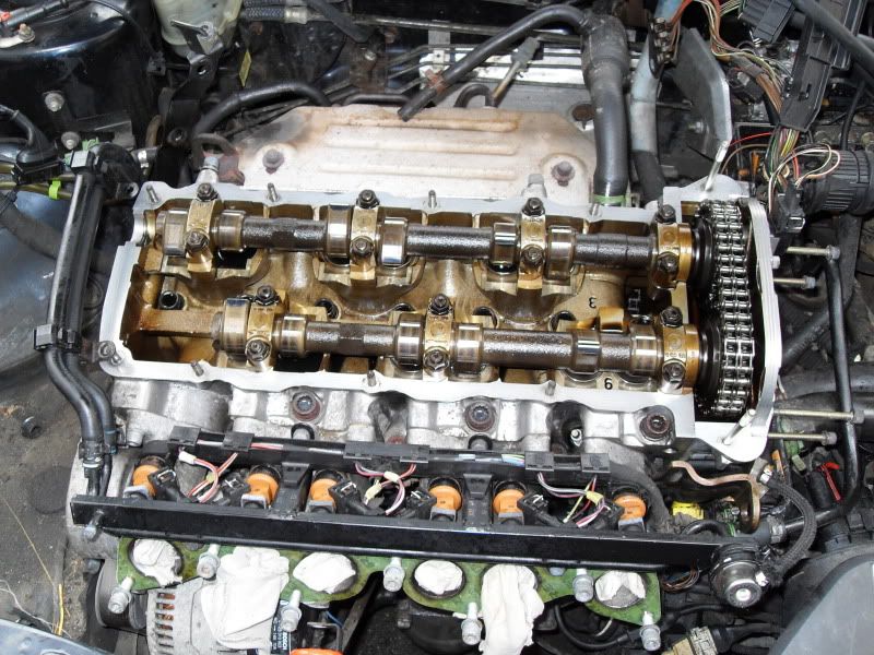

Yep even the coil pack came off so as i could clean up behind it :cuckoo:

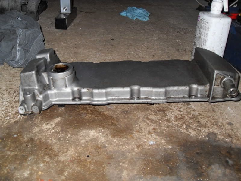

Filthy cam cover :bad-words:
Nice and clean cam cover :clap: Will get polished soon :lol:
Old gasket residue cleaned off and waiting for a new one
Time to put it all back together now, looking much better :D
And the last few bits and done
