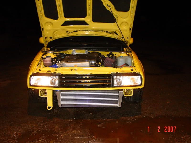

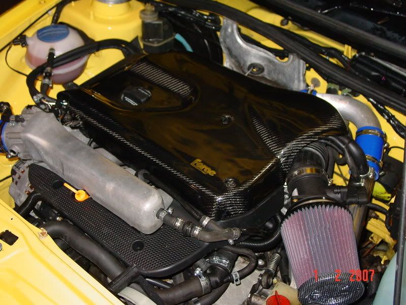

marcocorrado 0 Posted March 29, 2009 Ok well i cant remember where we got the intercooler from right now but ill get on the case to let you know. 2.8l 24v Climatronic system.pdfIntercooler.jpg[/attachment:17ft9a4d] Intercooler2.jpg[/attachment:17ft9a4d] Hopefully you can see the picture ive tried to upload above. Thats where we mounted the intercooler using some home made brackets. Seems to fit in there nicely and its a decent size. Boost pipework is a bit of a squeeze but you cant see it from the front which is what we wanted. The standard 2.0 16v radiator fits behind the intercooler after cuttung off the radiator scoop bolt lugs but will probably need changing for a bigger one in the near future. If your running an IHI with 300 ish hp then you will deffinately need a larger one. There is plenty of room for a longer one with the same depth. As for the fan. We got a slim line fan because the standard one is so big. Ill find out exactly where we got all our stuff from and let you know. Im sure you will have many questions for the forum once you get started. Are you using standard management? We may have a loom and ecu thats been unlocked from the clocks at home too if your were interested. Ill pm you once i get some more details. Good luck Quote Share this post Link to post Share on other sites

marcocorrado 0 Posted March 29, 2009 The standard valver gearbox and drive shafts. All fits in nicely then. Quote Share this post Link to post Share on other sites
