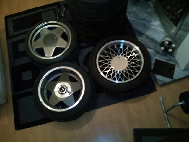

vardo 0 Posted November 3, 2009 another wheel shot lol,borbets are finished Quote Share this post Link to post Share on other sites

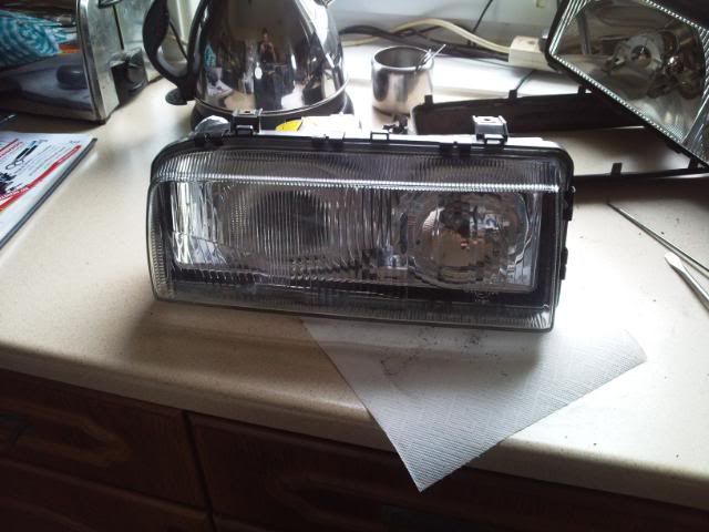

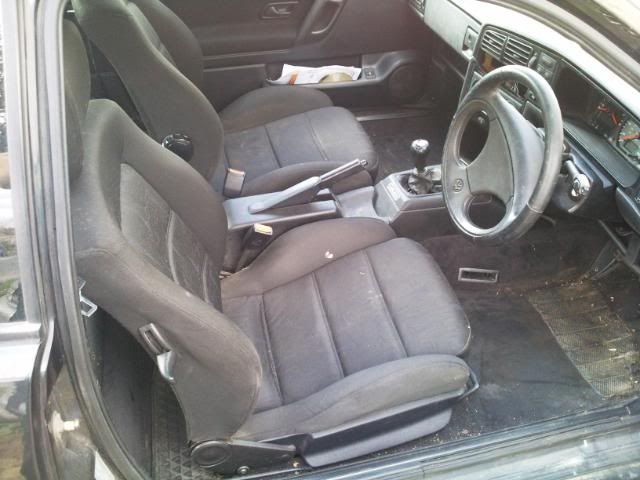

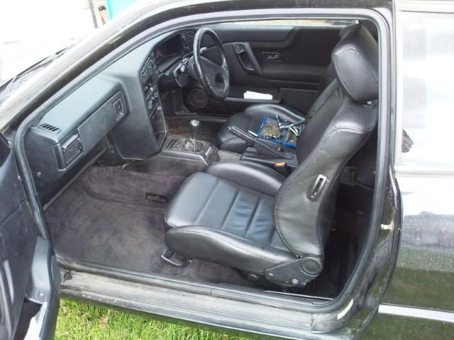

vardo 0 Posted April 20, 2010 ok ive been busy today,nothing booked work wise so decided to get as much done as i could on the car,ill let the pics do the talking... old seats out leather in lights before dont like the clear lens,on the black car so replaced it with standard lens,for more OEM look after fitted with the tinted indis and foggies,also trial fitted the new grill(need fiddled with to fit right) then fitted the borbet As Quote Share this post Link to post Share on other sites
CorradoVR6-Turbo 0 Posted April 20, 2010 Nice! not to sure if you will have a decent light image pattern as the inpro lights are designed to project the correct pattern from the lens in the dome,now you sre adding a second lens over that..... :scratch: Quote Share this post Link to post Share on other sites
Critical_Mass 10 Posted April 20, 2010 I didnt realise standard lenses fitted the impros casing. I tried and it didnt quite work. Would be interested to see the light pattern too. Quote Share this post Link to post Share on other sites
vardo 0 Posted April 20, 2010 yeah wasnt sure about that myself,i will get it checked out when it goes for mot,which is sooon,5 minute job to change back so not a problem Quote Share this post Link to post Share on other sites

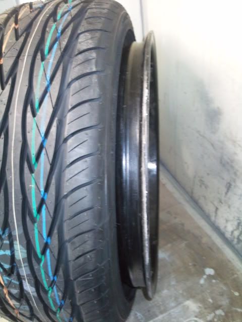

vardo 0 Posted April 21, 2010 yeah why not,ive organised to get them drilled to 5x100,cant wait 8.5x17,1954017 toyos ordered and et13 :shock: thoughts? with the flat caps Quote Share this post Link to post Share on other sites

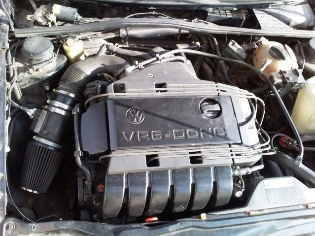

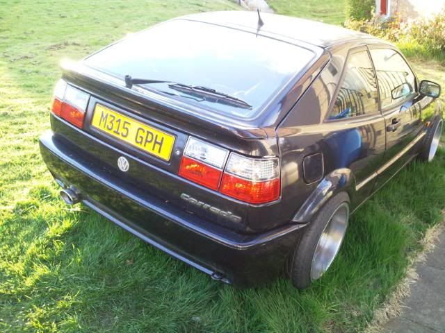

vardo 0 Posted May 14, 2010 just been bolting on parts these last few weeks,need to get it washed and polished,as its not been washed since i got it over a year ago,also ordered an arch roller as needed it for this and some of the other dubs,so should be worth it. couple of pics,door handle repaired,cheerz dave wheel in smoked rears,painted no plate plinth and new plates black leads and k&n Quote Share this post Link to post Share on other sites

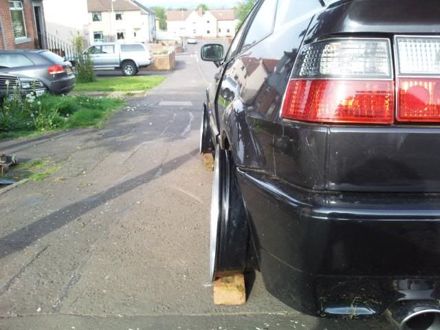

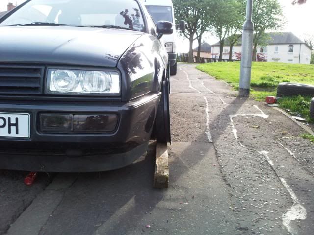

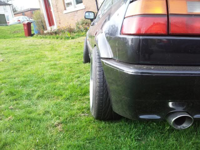

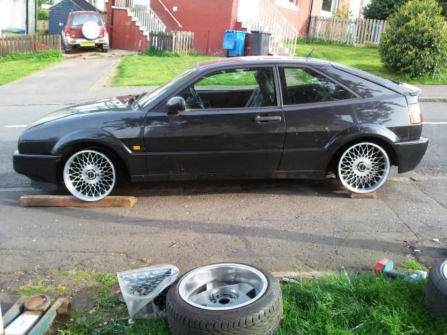

vardo 0 Posted May 21, 2010 well tonight i trial fitted the 17" Bs to see if i could use adaptors,instead of getting them redrilled,and had a go at rolling the front arch(but ive wrecked it :( ,also the car is too low for the roller at the rear,will need to loosen the suspension for it to fit. fronts with 20mm adaptors,pushing offset to -7 :D rears 10mm spacers offset et3 and side shot needless to say im just gonna get them drilled,the wheels will fit fine as they are as long as i fit the 312mm front brakes as the small 280mm caliper sticks out far too much Quote Share this post Link to post Share on other sites

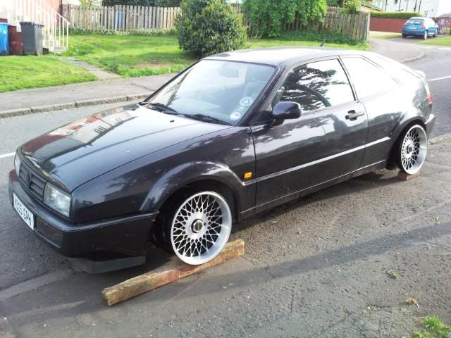

vardo 0 Posted July 19, 2010 cheerz.i love these wheels soo much. finally got them redrilled to 5x100 and got the tyres on but having major probs trying to seat the 195 tyres on the beads,it will happen ,gonna buy a cheetah tyre inflator :D Quote Share this post Link to post Share on other sites
