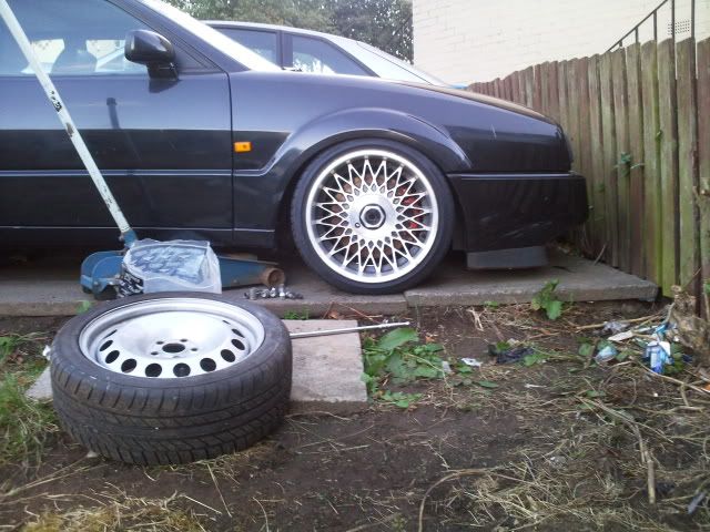

ok,had a few problems trying to get this on the road,still not quite there,fitted the 312mm brakes up front with goodridge hoses(wrong banjo bolts were supplied,but was sorted after a phone call),the borbets i had redrilled to 5x100(holes were not big enuff for the m14 bolts)i got a 16mm drill bit and rectified it myself,so trial fitted tonight only to find im still fouling the new calipers,so 10mm spacers and a little bit of grinding to the caliper and we finally have it on.arch work is defo required but nearly there!

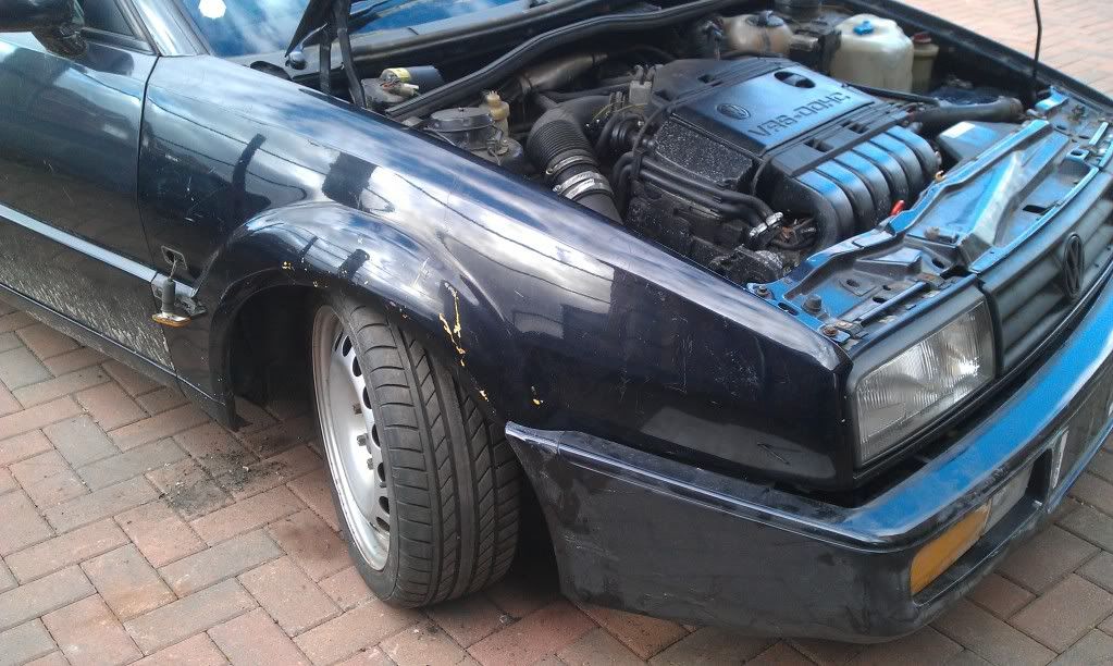

new wings(i butchered them trying to make the 17"borbet bs fit)

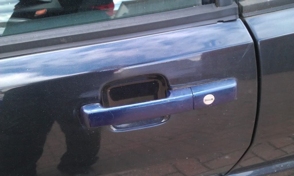

door handles( "")
outer door scrapers (same as above and what a nightmare to get a hold of)

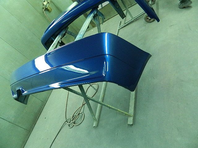

rear bumper(cheerz easypops)

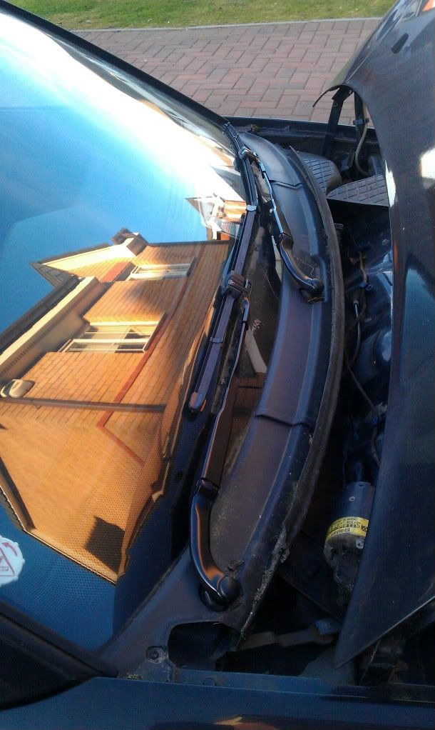

bonnet cable ,boot struts and other odds and sods

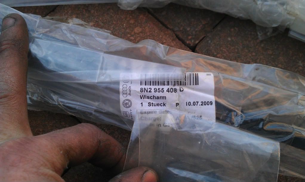

TT wipers

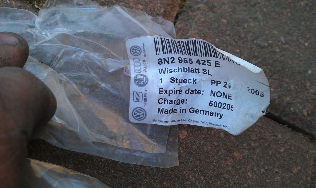

and part nos for anyone wanting to know
blades
arms

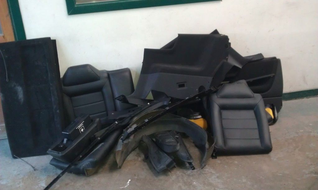

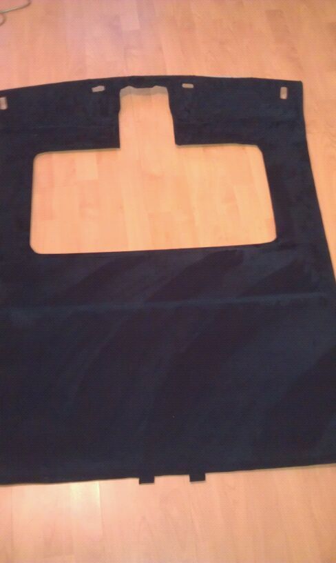

interior out to get scrubbed and alcantara stuff fitted

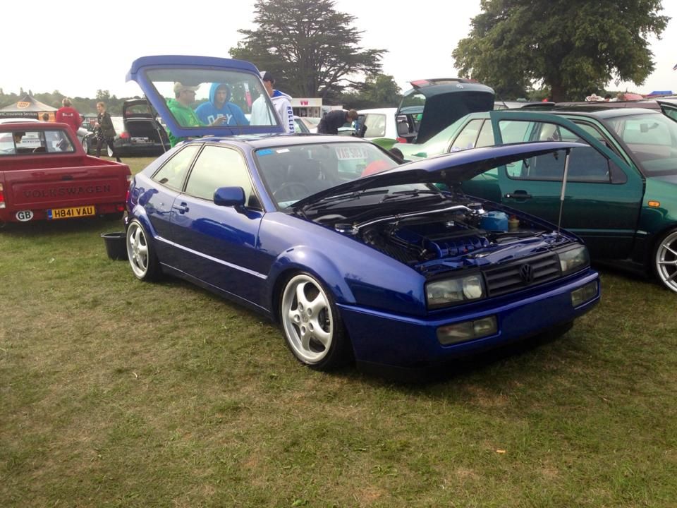

after all the work i got the mot and it was all go to get the car ready for gti international 2012

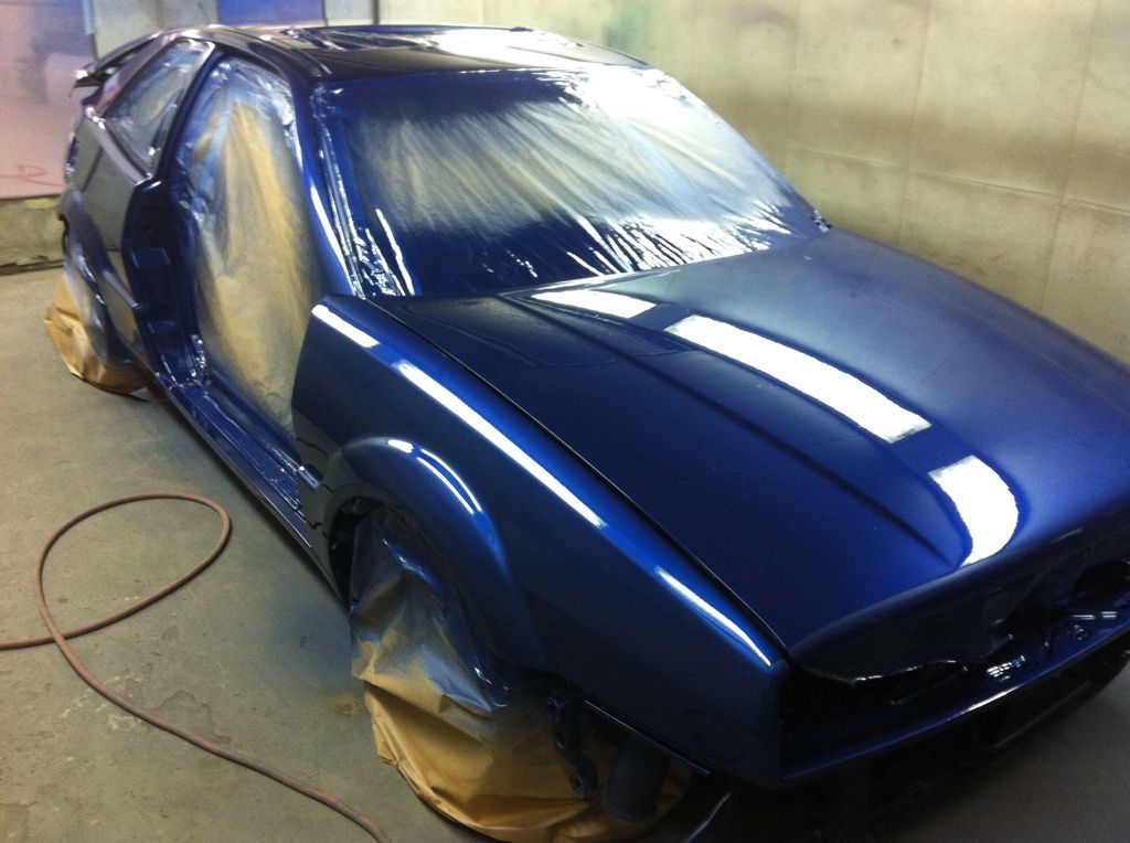

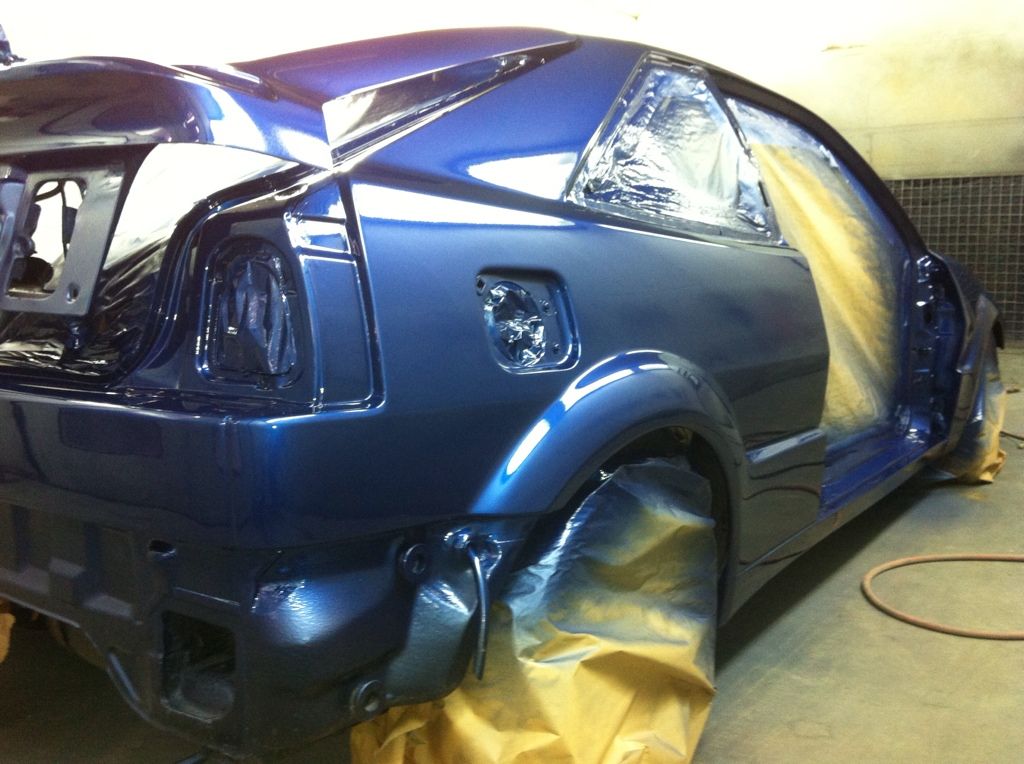

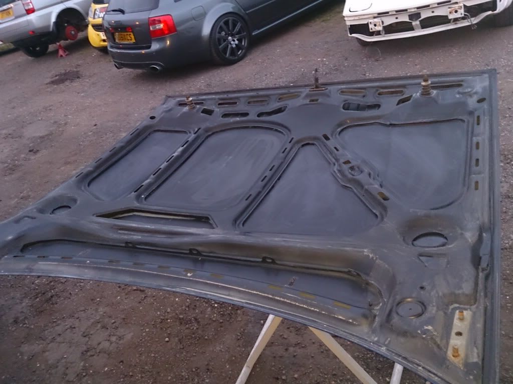

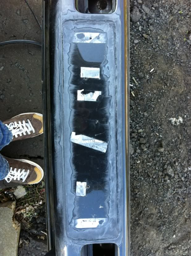

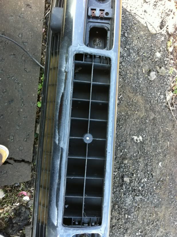

my front bumper getting smoothed

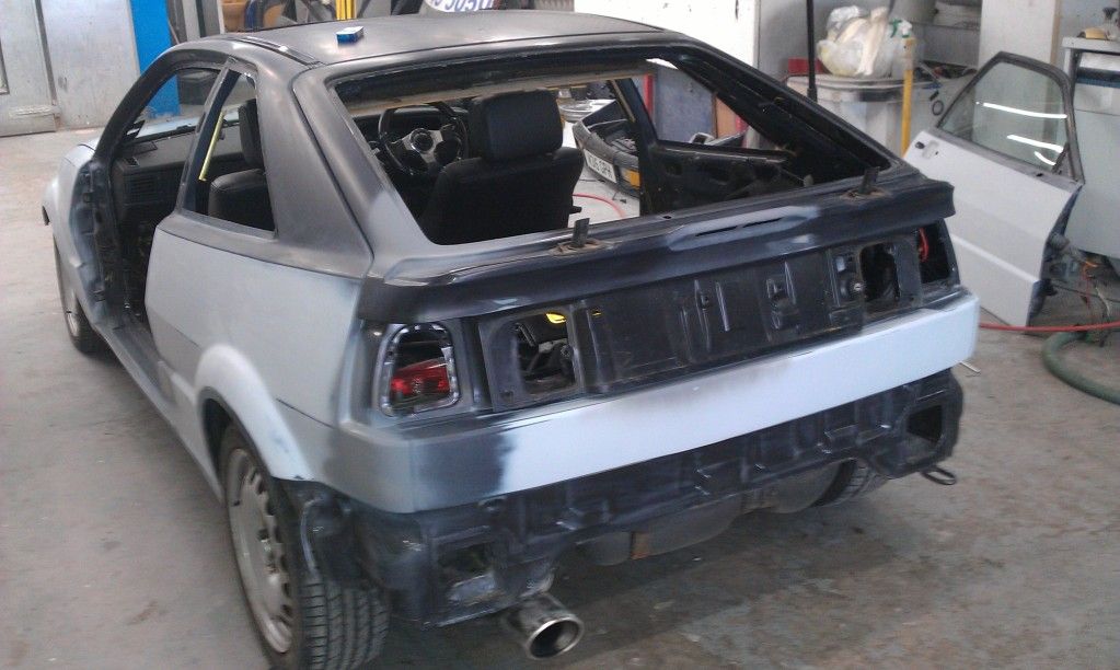

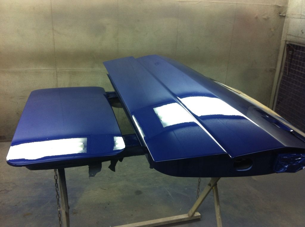

and the stripdown commenced all repairs done

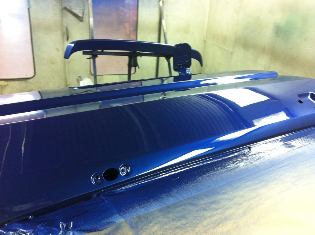

rear vw badge welded and smoothed
rear script badge holes welded and smoothed
repair to tailgate round window seal

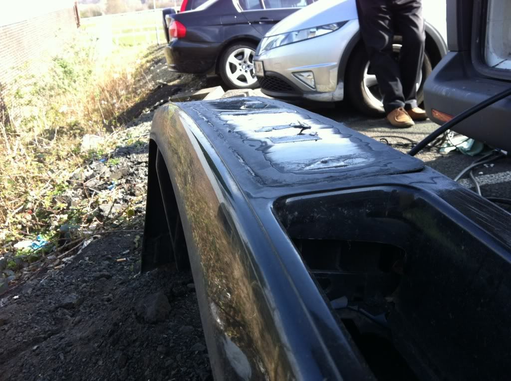

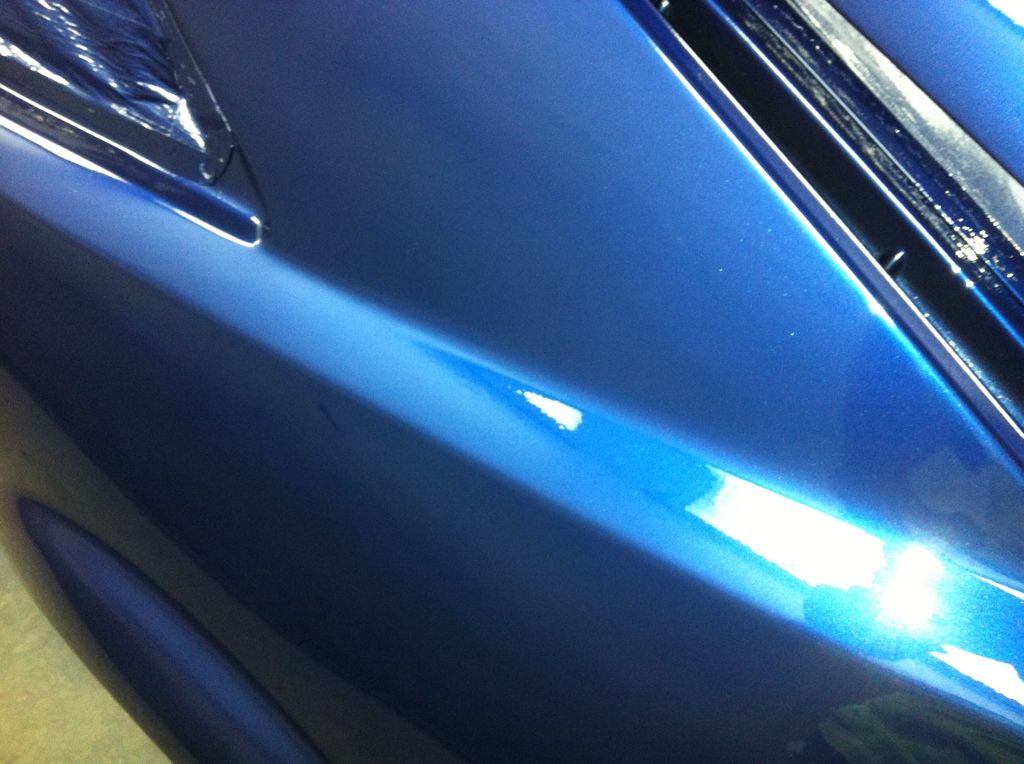

front wing repeater holes welded and smoothed

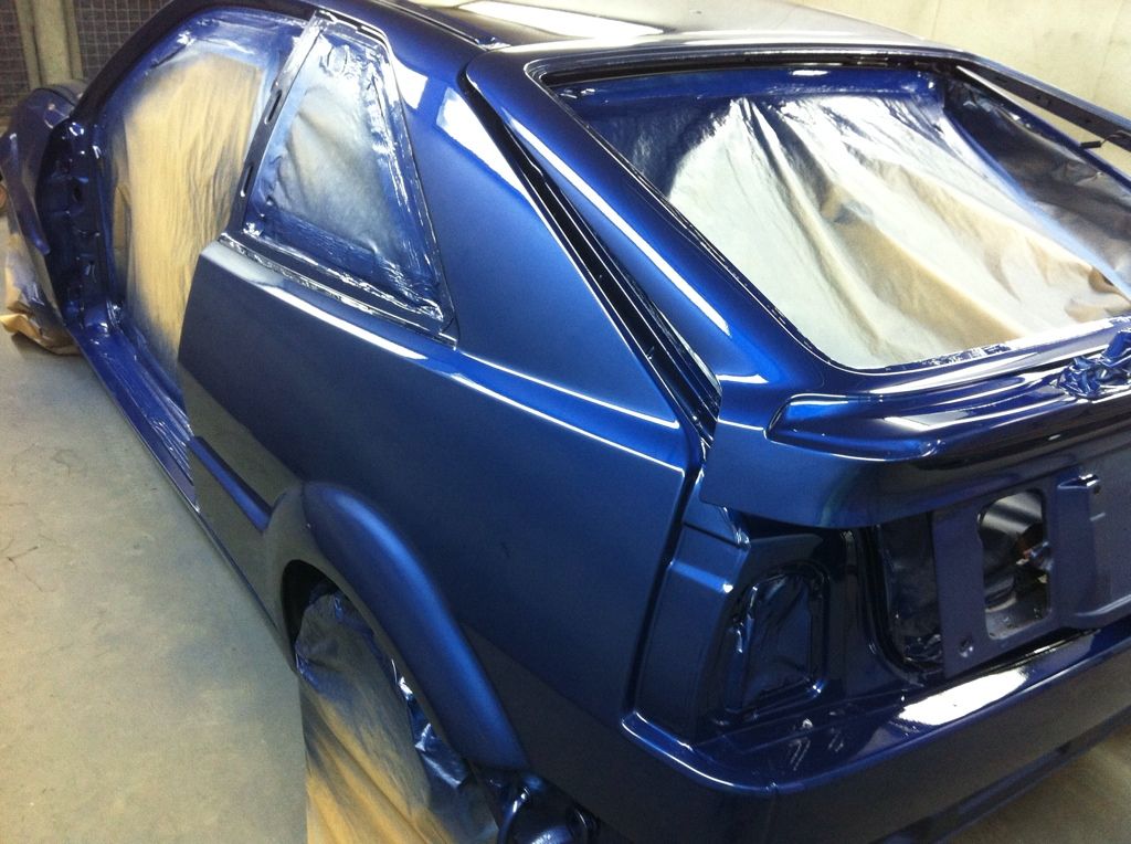

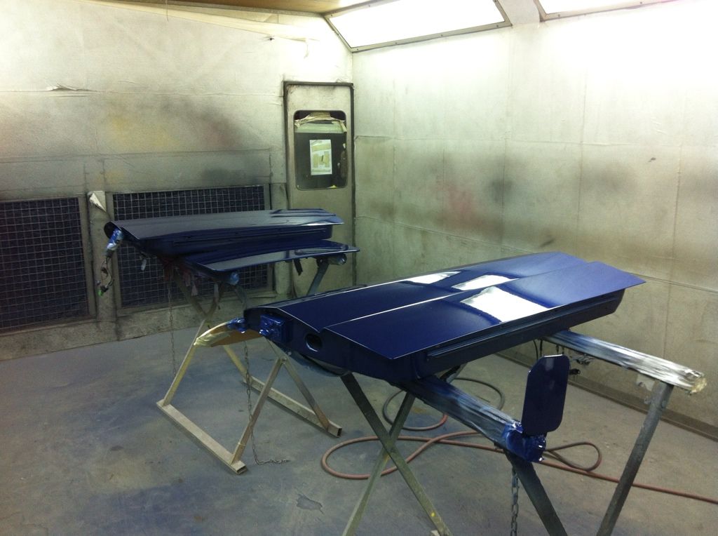

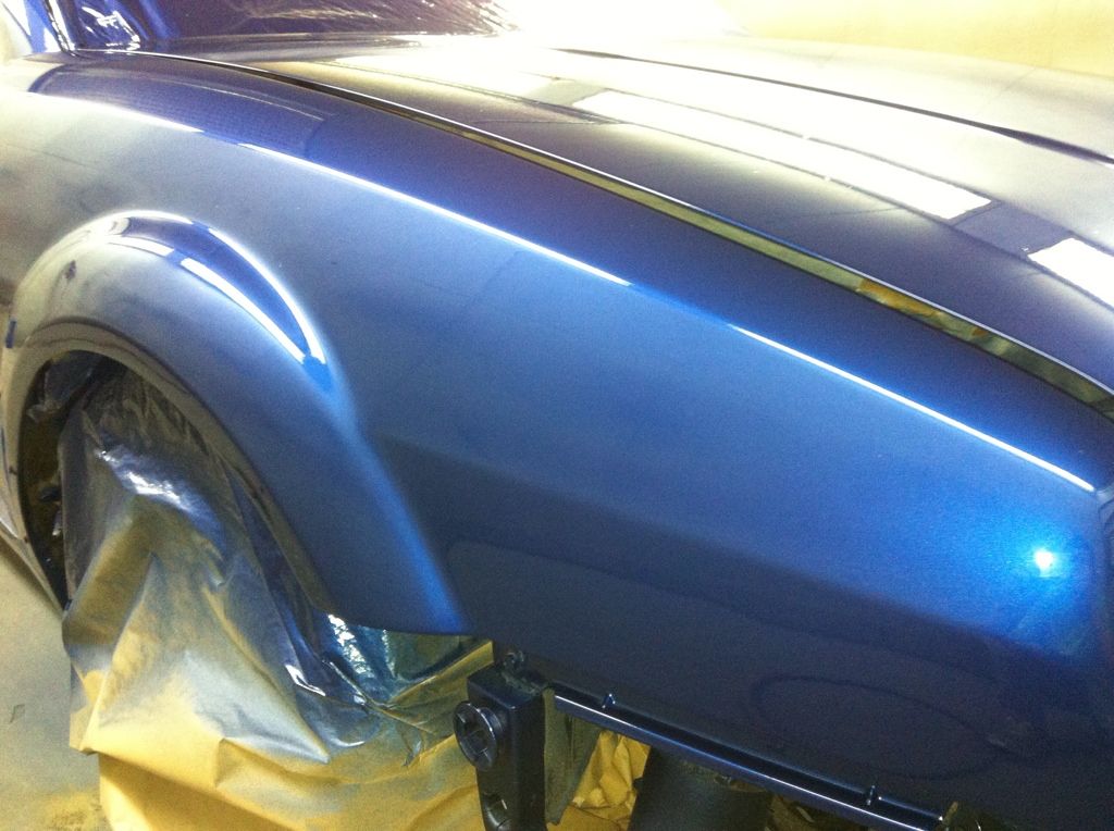

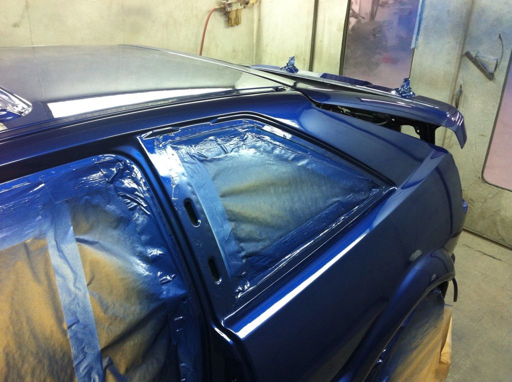

both full sides repaired of dings and smoothed

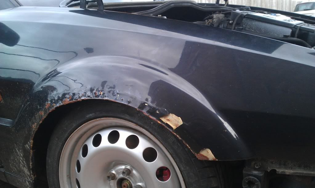

all arches cut and repaired
both sills smoothed
tow eye delete
huge thanks to my mate Stu for an awesome job ,cheerz mate :thumbup:

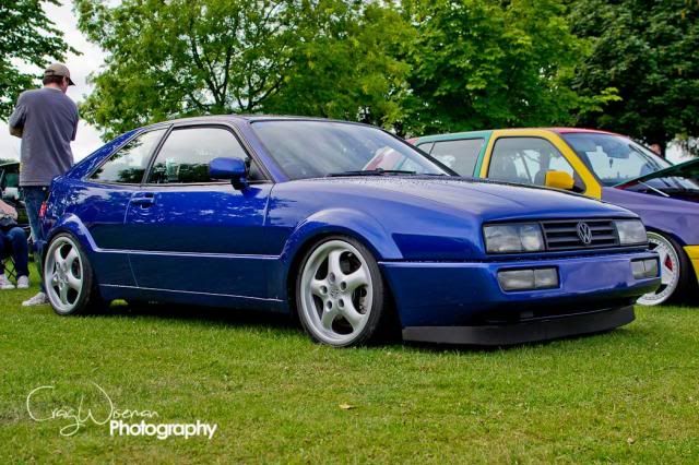

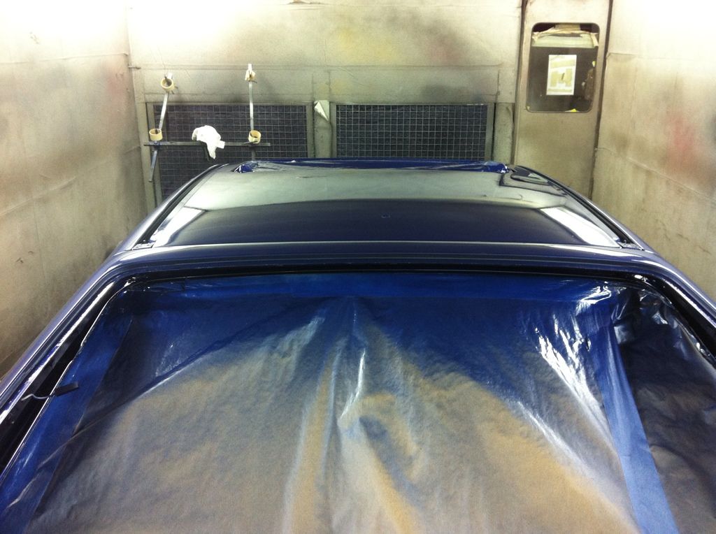

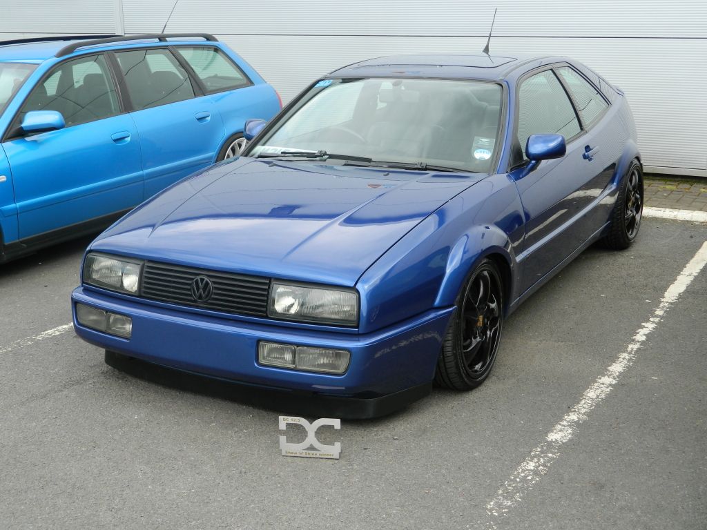

colour is Bentley Moroccan blue and this was my inspiration for it

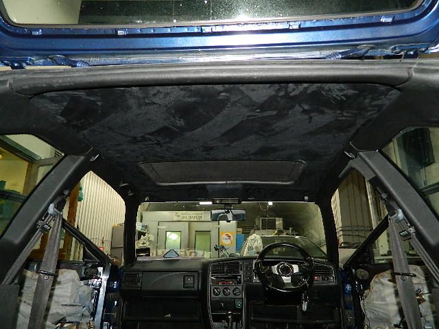

built it back up glass back in

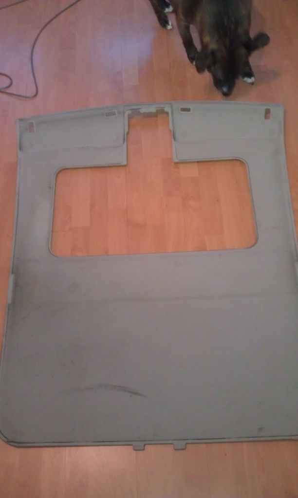

headliner in

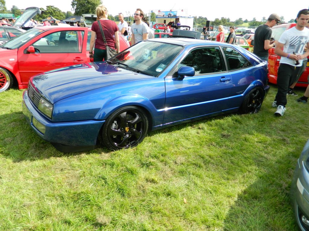

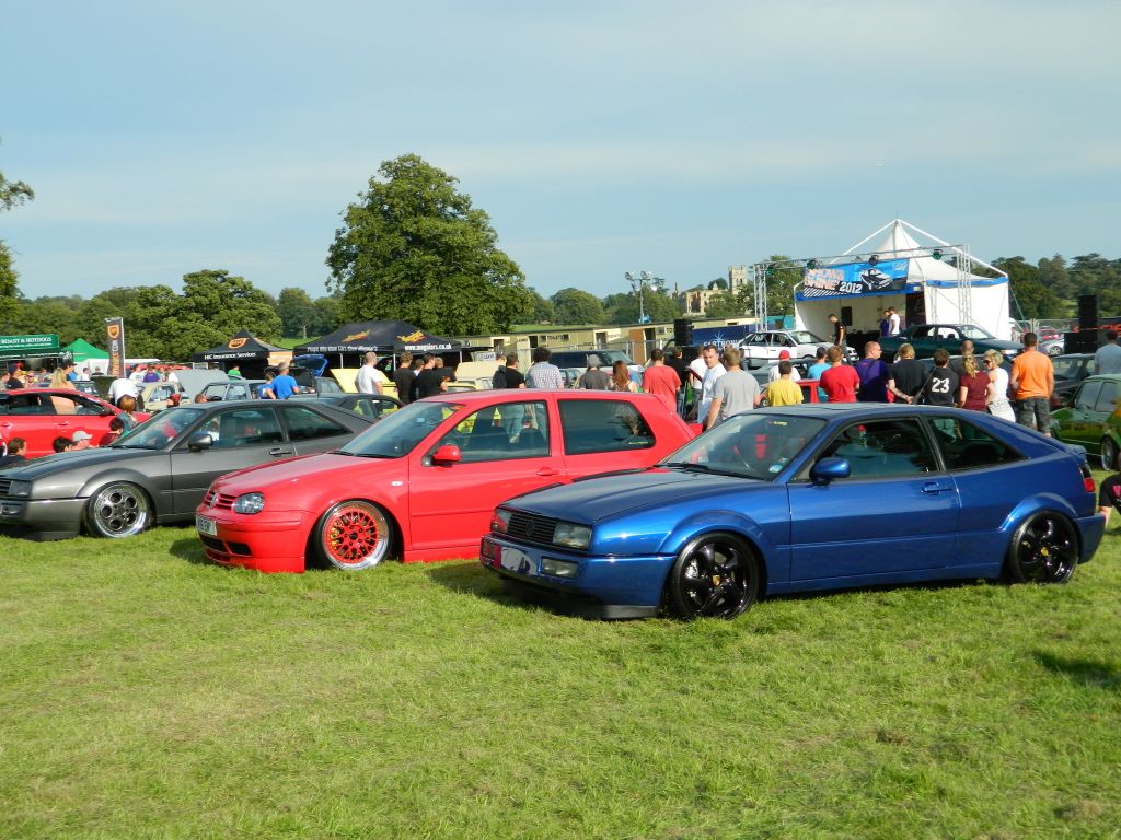

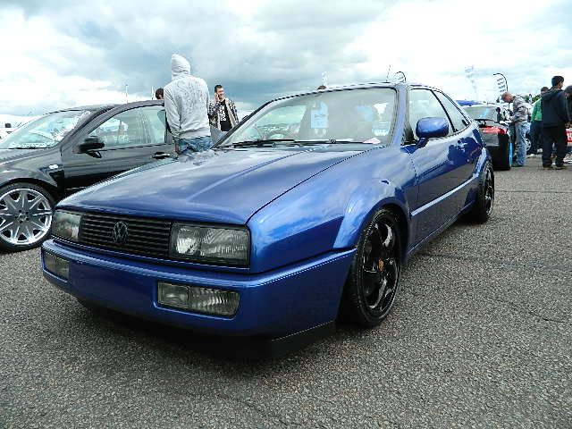

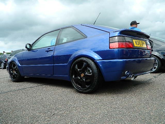

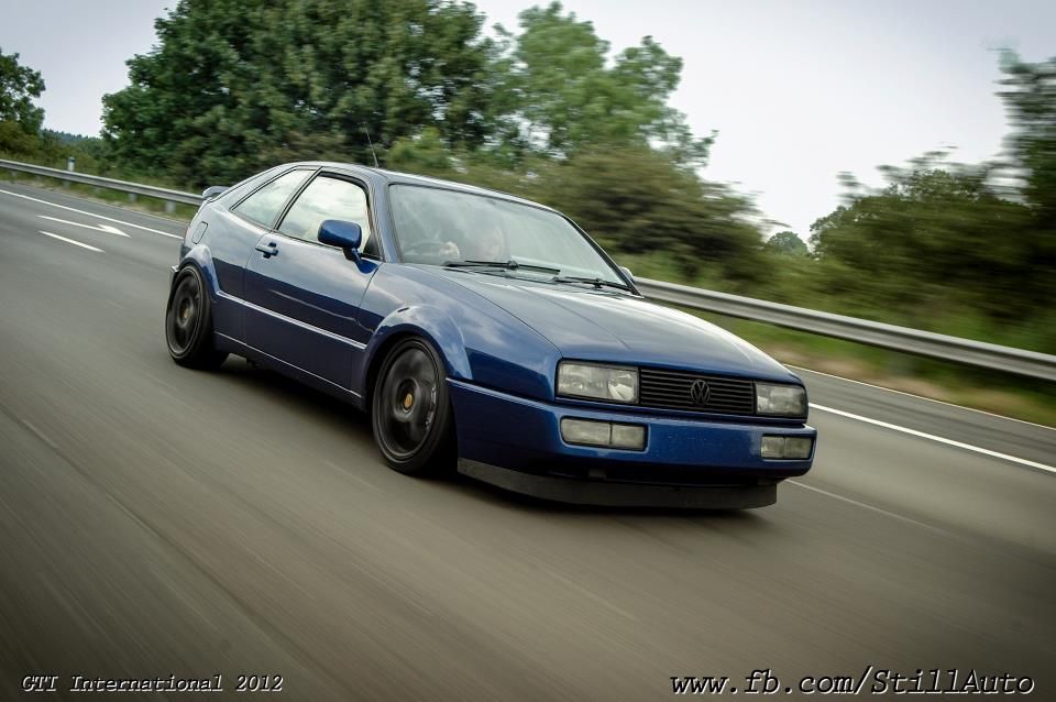

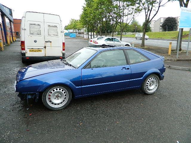

new wheels fitted and made it to inters 2012 in the nick of time
managed to get a runner up rado prize on the sunday which i was over the moon with

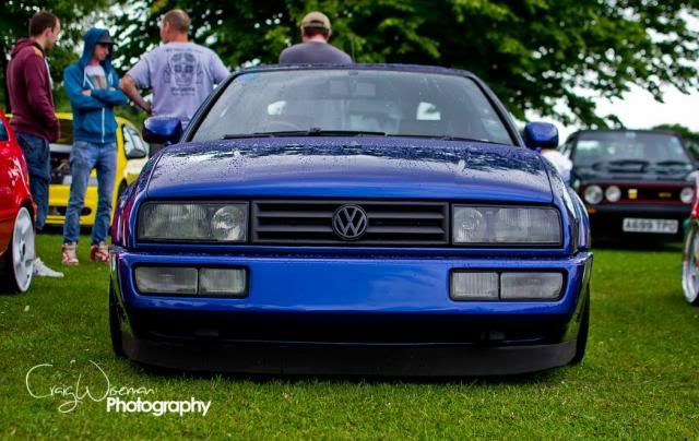

^^^^^^^^^^^This ^^^^^^^ don't know how you thought that colour would work on a corrado but mate you are a Genius Stunner.
BILLCOR,too hot,easypops,Harrier and clumpy1 Thank you very much for the comments.
too hot that was 2012 and it was a lucky grill from my mates old rado and id not seen an early grill on a late car so wanted to try it.
ill update now this year it took me ages to update that last night lol

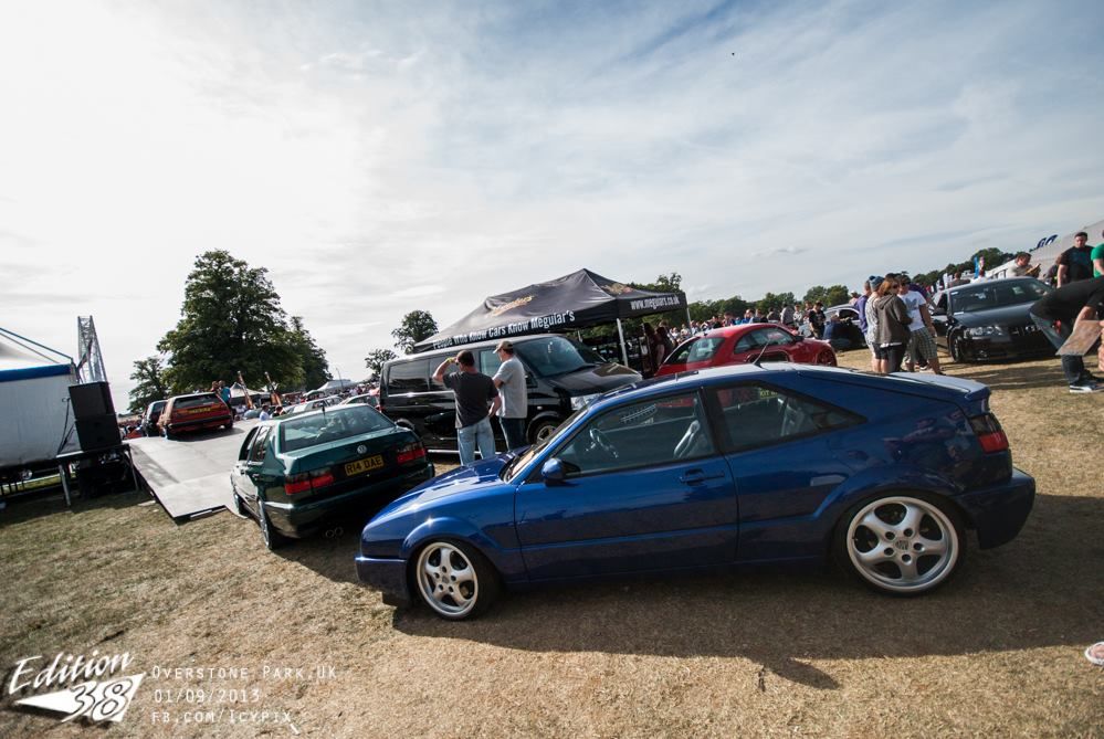

2013

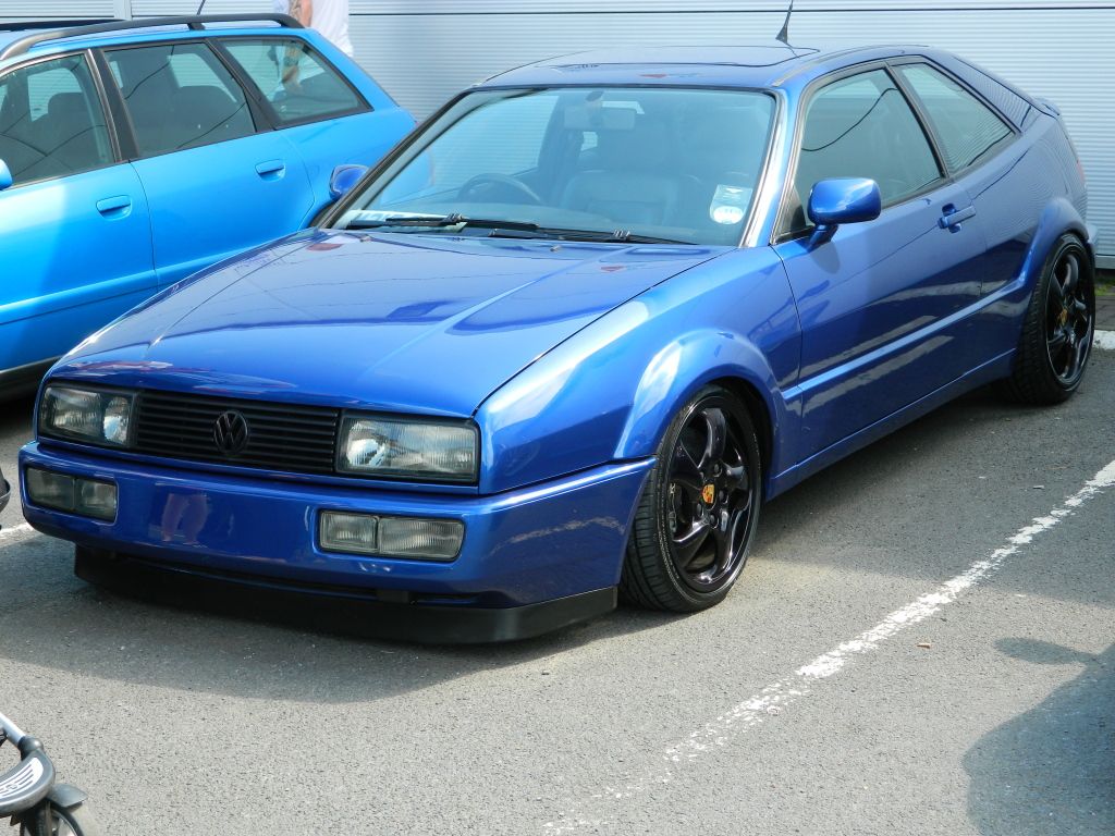

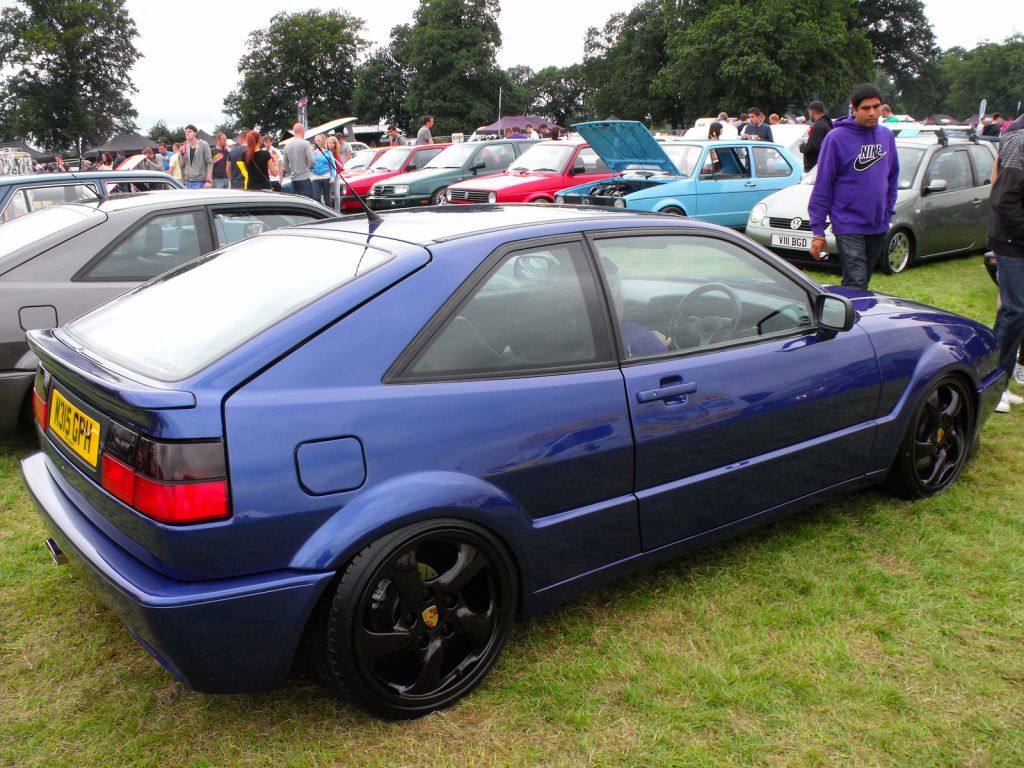

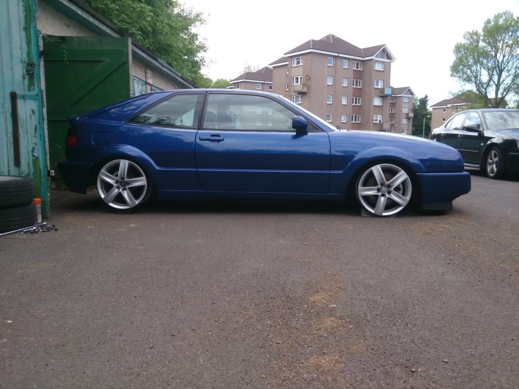

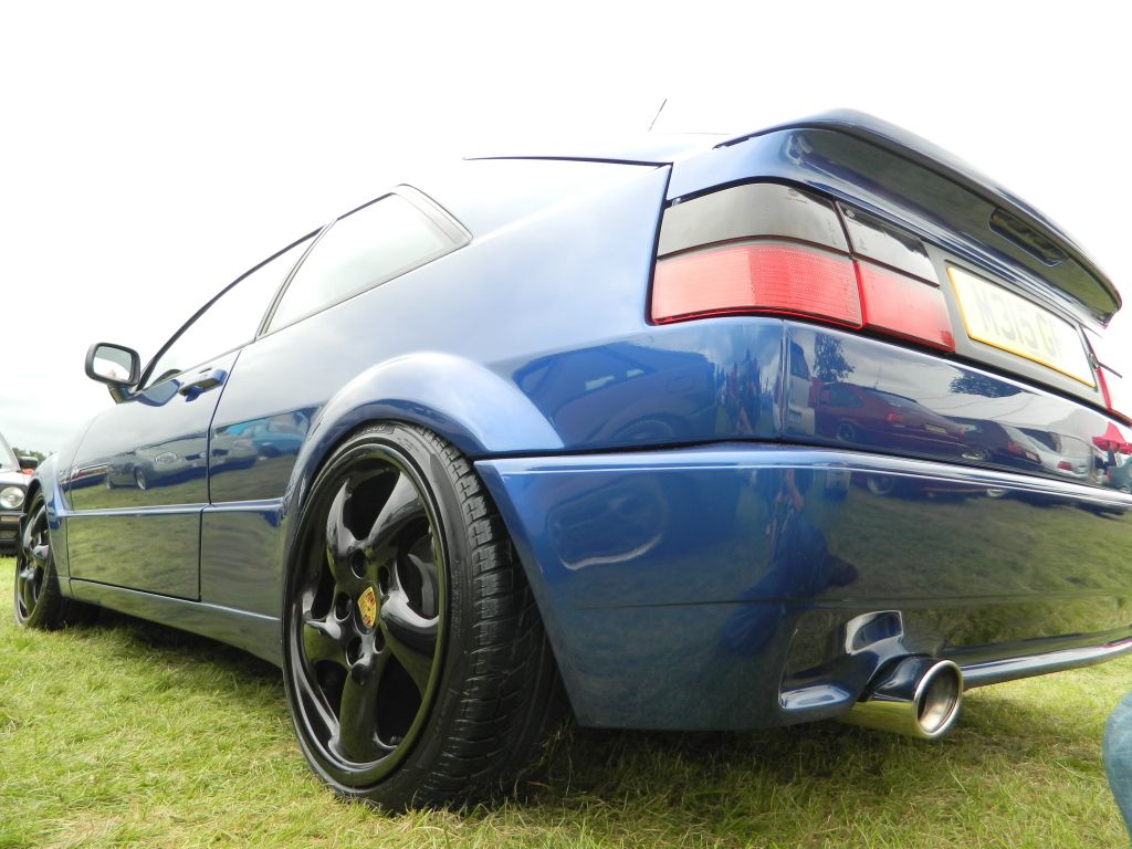

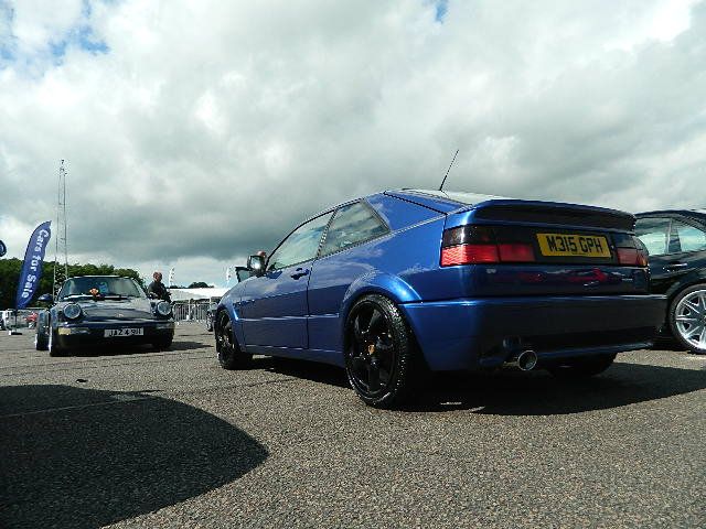

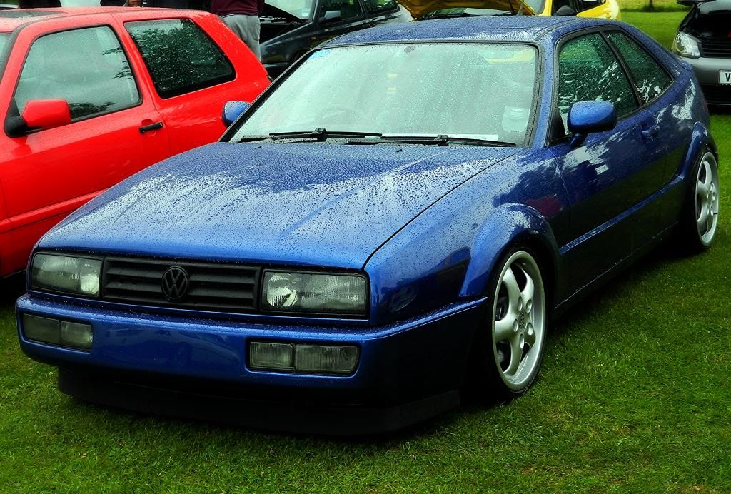

trialled many sets of wheels as the ruby black boxsters were sold on, i nearly went with these seat wheels
before going for the trusty porsche wheels this time: cup2 7 and 9 x 17 (pics from Scottishvag13)
and refitted the proper grill

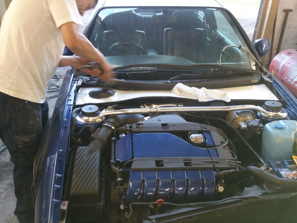

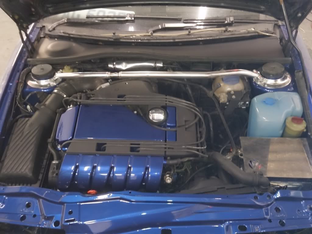

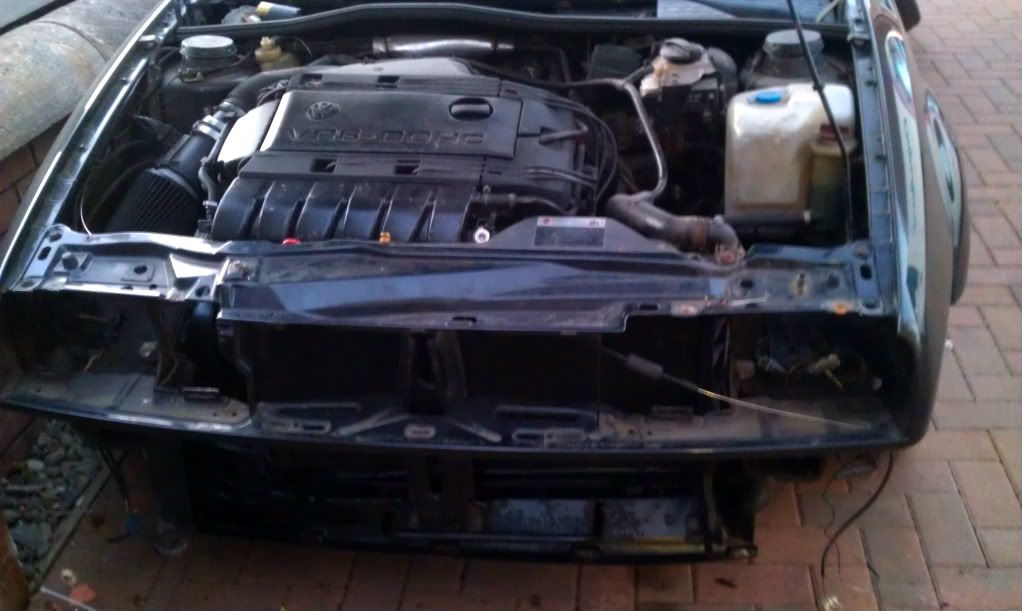

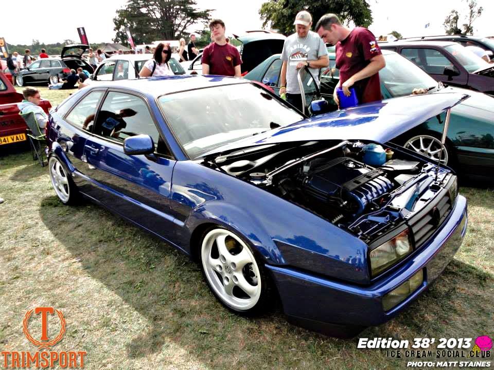

It was time for edition 38 and 1 week before my mate Stu and i decide to get the engine bay done.

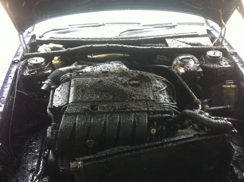

we had left it out in the respray and it was letting the car down big time sooo...
started stripping it down

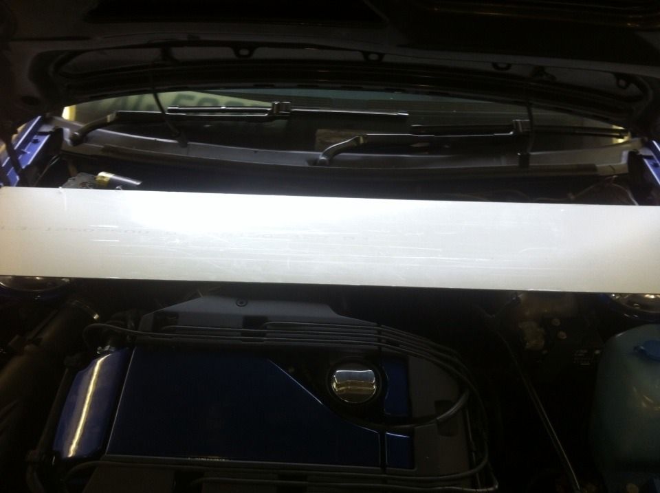

scrubbed,replaced bits and bobs,moved stuff,rewrapped wires,colour coded inlet/rocker and of course got the bay painted,also made a scuttle cover from scratch

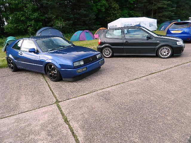

we got finished 4 am the night before travelling the 300 odd miles to edition
and ended up with a runners up rado prize which to this day im still so overjoyed about
