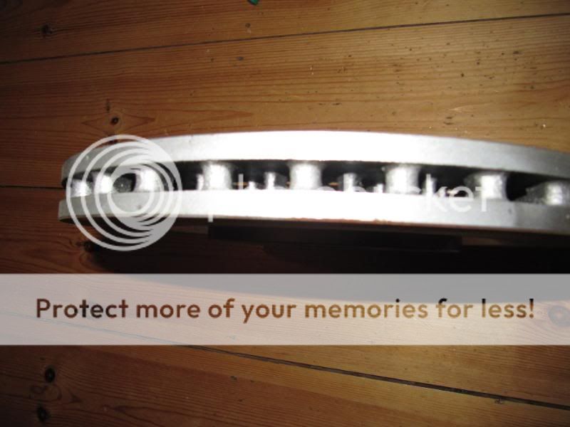

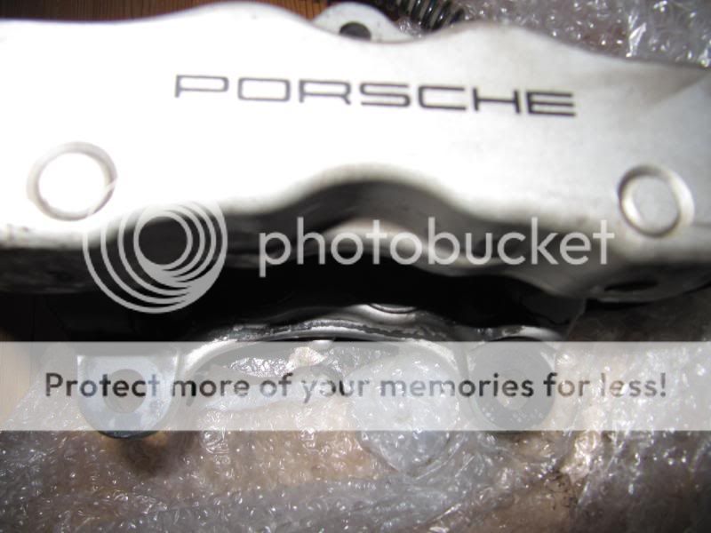

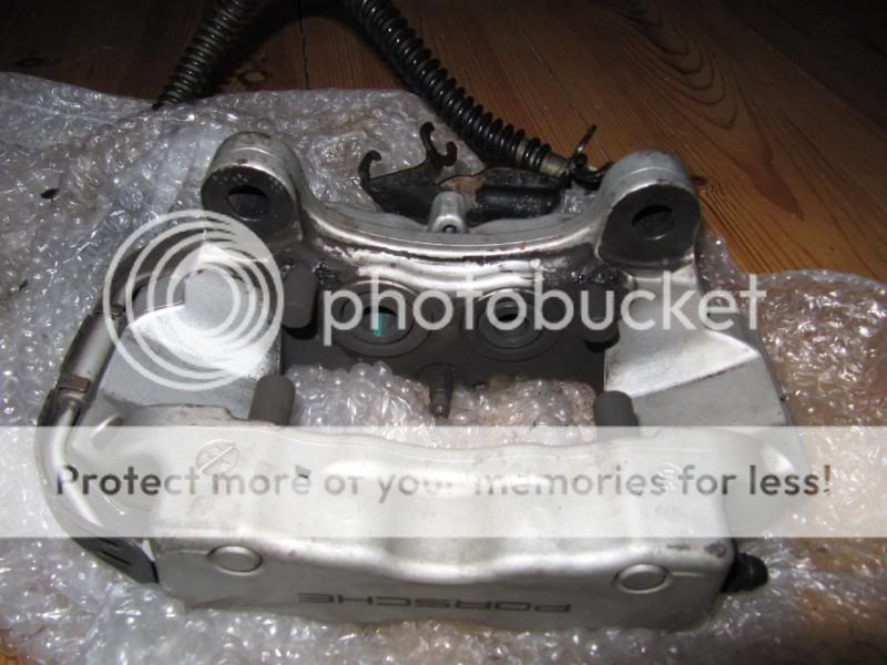

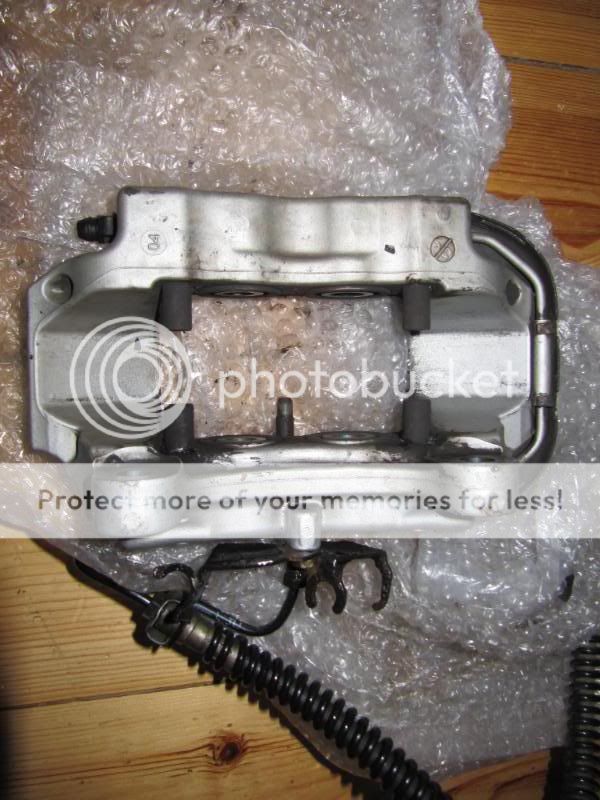

Bought a pair of Porsche Cayenne rear Brembo calipers, was very lucky with these. Came with pads, pad locators and brake lines still attached. Have now bought new pads as well. -

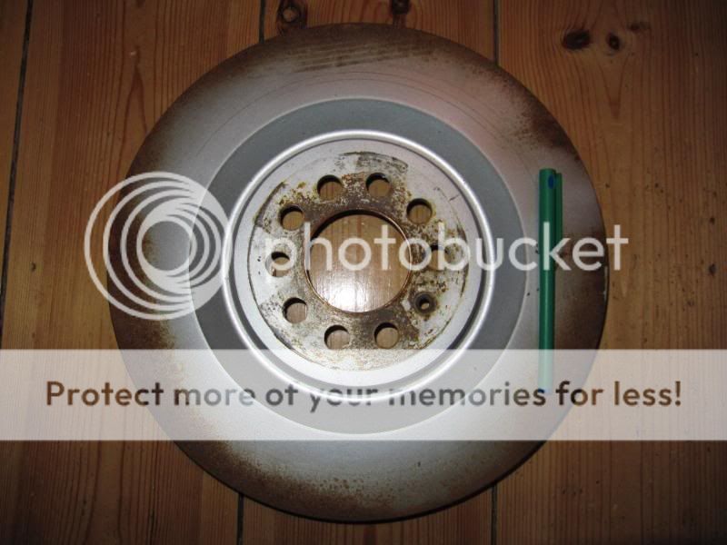

Next came nice shiny new 323mm Cupra R discs from KipVR (thankyou so much mate), bloody huuuge-

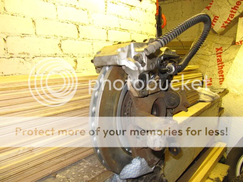

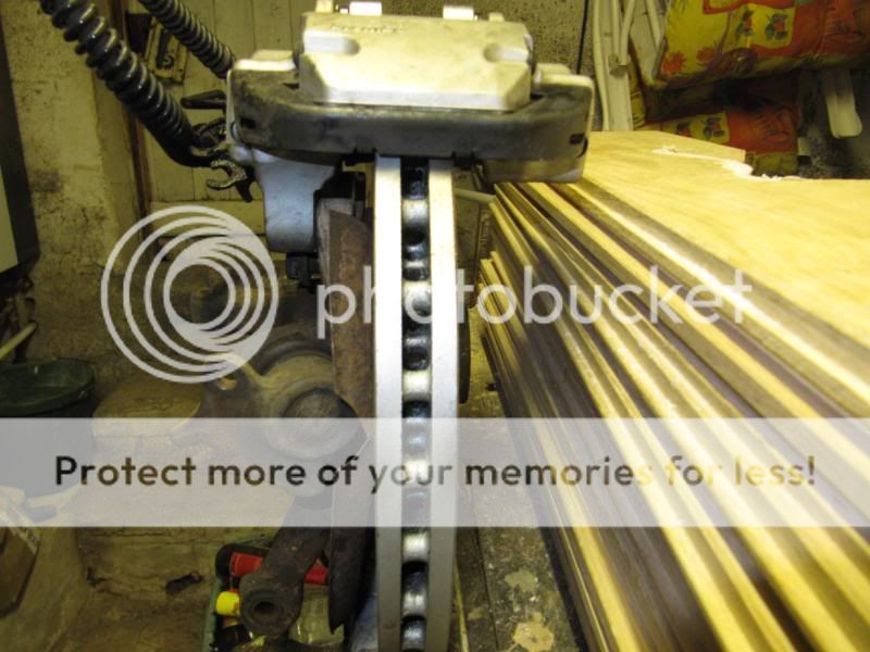

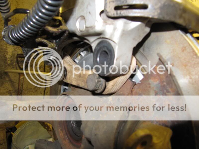

Had a very clever mate do some computer designs for me for the brackets, I've now made one in oak and have been playing about with fitting positions of the holes. Very nearly there, just a small bit tweaking and I'm sure it will be spot on-
So all I need to get is the final metal versions of the brackets, and 5.1 brake fluid. My brother will make sure I don't go too far wrong with fitment as he's a mechcanic by trade.

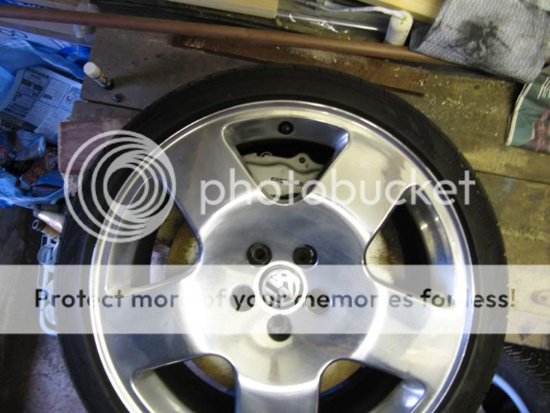

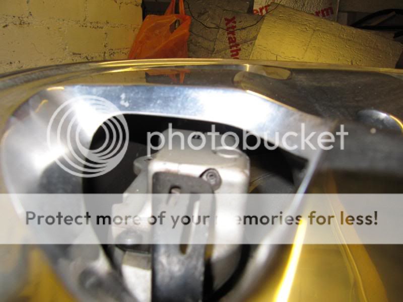

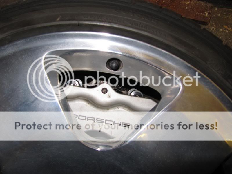

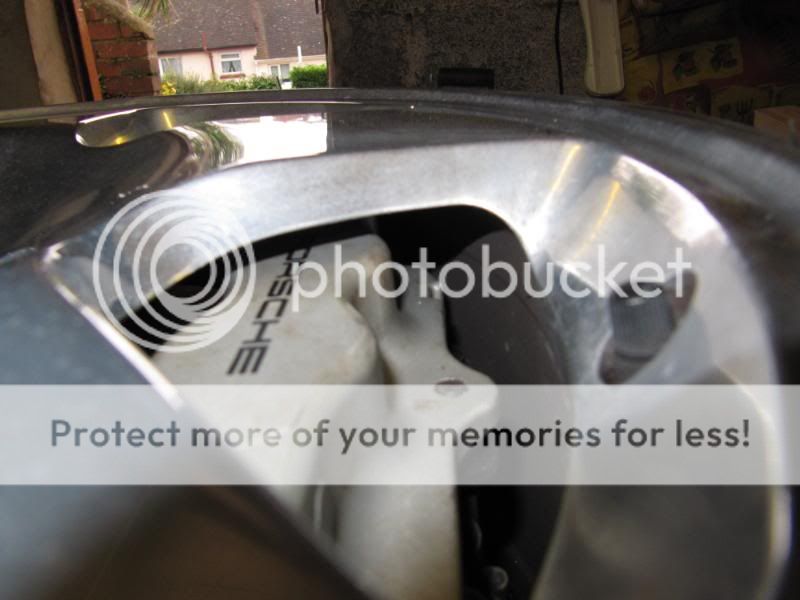

they are very wide callipers! are the wheel going to fit over them?
I was all happy about my measurements and positions of everything until your post made me question myself and start to get a little worried :pale: . As I hadn't been in a position to physically put the wheel over the disc and caliper, I thought it was best to double check it all!
Lucky the TT Comps have a big area behind the face to house the caliper, be interesting to see what other wheel choices I will have (prob not many!)
Well good news, the wheel spins freely :nuts: It is quite close though but not down to a few mm though.
Lets hope its not totally different on the car and causing loads of headaches :gag:
christ on a bike that close mate. you are lucky they have that bit extra space lol, really liking the look of em tho! :D

You have struck it lucky on the clearance, what's the offset of the wheels?
I had to run 12mm spacers on mine.

Struck it lucky on the clearance? Pah, had it all worked out :norty: Phew!

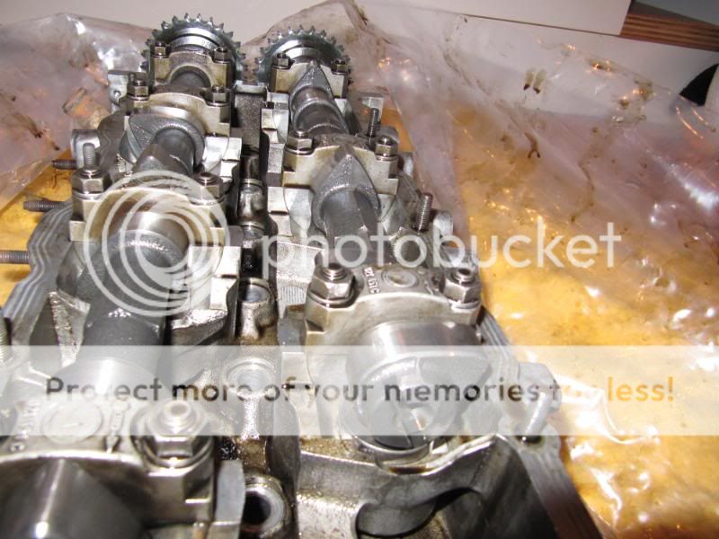

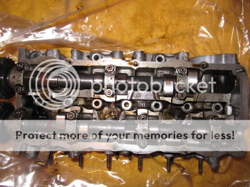

Firstly a new head, well not brand new but fitted with parts that have done around 5k miles. Here's a breakdown of what has been done to the head-
Head including -
New SP 263 cams
New Light weight lifters
New Autotech HD Springs
New Genuine spec Valve Guides
New-ish Genuine retainers and valve keepers
New GSF stem seals
Work carried out:
Head given a cleaning skim
3 angle inlet valves and single angle exhaust valve (all re-machined in this way, a lot better than standard air flow wise)
valves re-seated.
Thanks for the purchase Chris, very nice man :wave: Also picked up a set of ARP head bolts for the head fitment and new timing chains and tensioners (128k and not sure if they have been done :shrug: ). Hoping to get this little lot fitted with LOTS of help from a friendly mechanical genius :nuts: around Easter time if poss.
