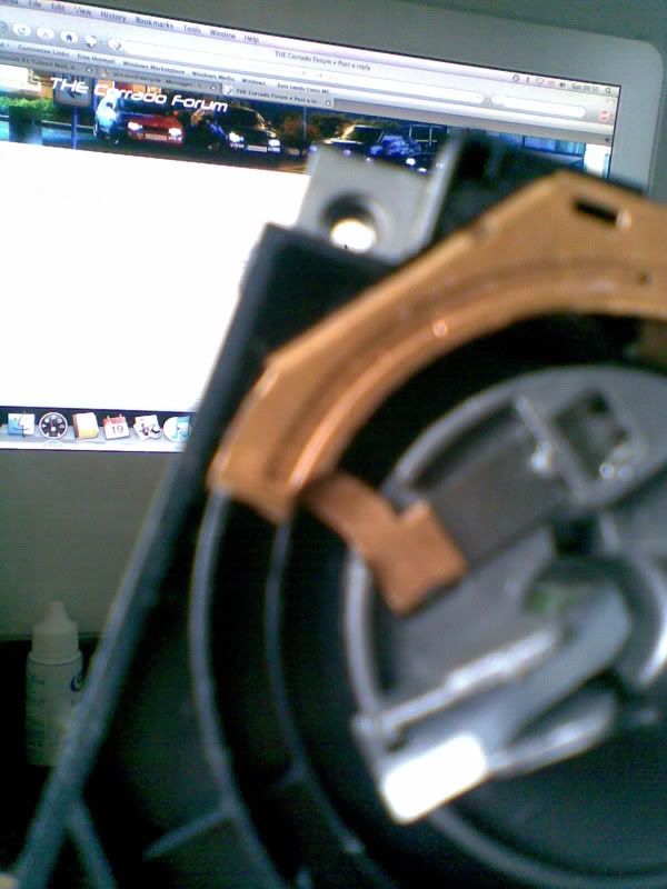

still no heater....can anybody tell me if my copper is right on the pics?
Dunno if you've sorted this yet, but...
If you mean is the copper right in your pic above, then no it's totally mashed.

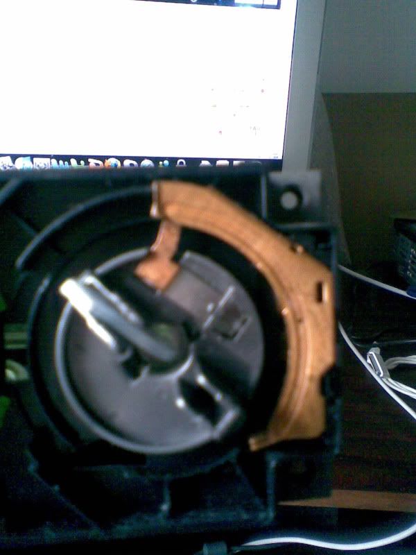

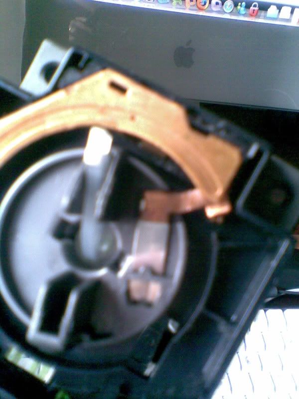

Some pics below of a spare I have knocking around, sorry for crap quality, my camera bust so used phone.
Dial set to position 0
close up at position 0
Dial at position 4

right so my coppper is on the wrong side on should go underneath for a start, I think I tried that and it got stuck, I will have a look again today
looks like I made some progress just now. It works on settings 2 and 4. I cant find the clips for the metal wired bits for the dials...whoops. Looks like the copper contact was the problem
