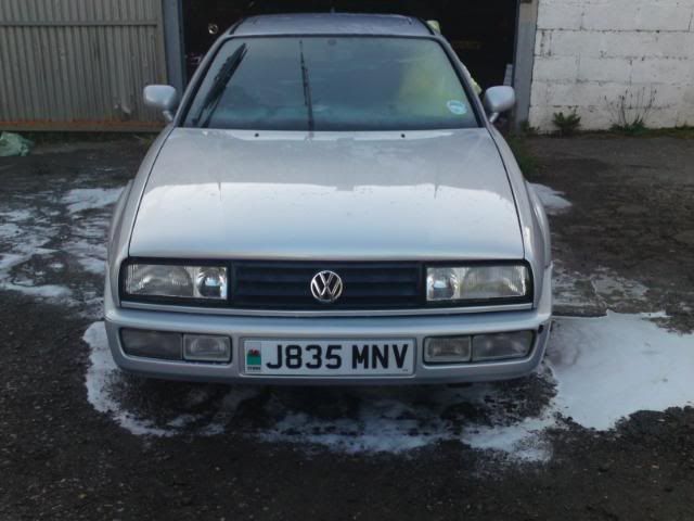

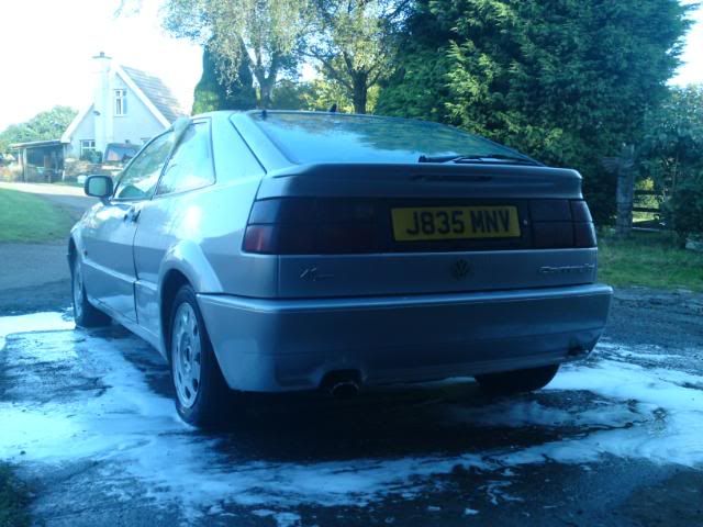

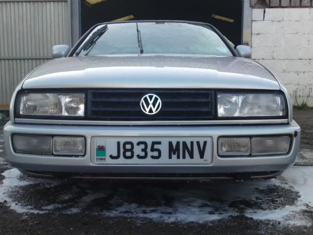

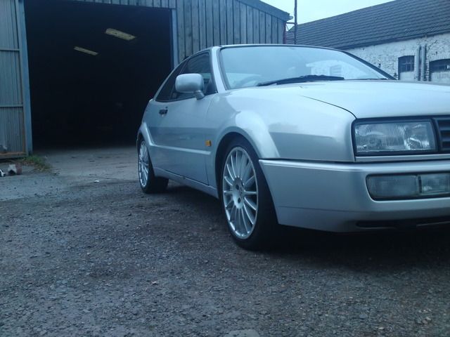

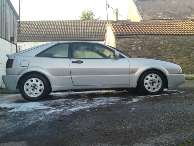

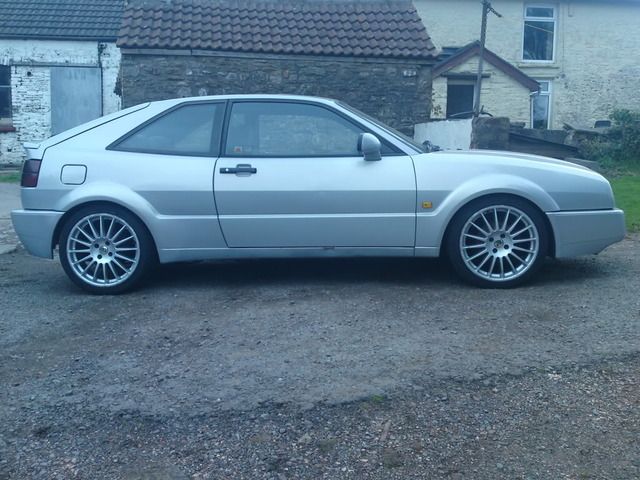

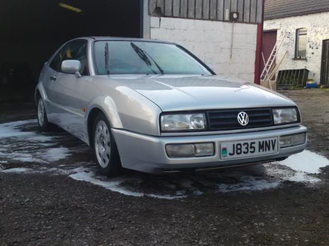

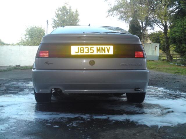

Kempy 0 Posted August 24, 2009 (edited) Ive had my satin valver for going on three years and im getting in the mood to get it back to condition it deserves. Its never really been how I wanted...I got up to see it every couple of weeks. My mate and I went up today, cleaned the interior and the outside, its only cloth but its in really good nick. Sitting in it today, made me think how much nicer the black interior is :D seems to make it feel more modern some how, I much prefer it to my grey cloth. I also absolutely love the Satin Silver still, I will get it back on the road on enjoy it again...I have bought a KR head for it as one was availiable on here, the garage I had it most recently think it could have a crack in the original head, hopefully once fitted I'll get more inspired to carry on repairing it.. I took some pics to...for your enjoyment...Its nothing special....but Ive not broke it for parts, Ive kept it for the day I got more monies to spend on the beast Edited September 12, 2011 by Kempy Quote Share this post Link to post Share on other sites
davidwort 0 Posted August 24, 2009 been a long time since I saw a set of those mk2 alloys :) great you haven't taken it to bits for parts :salute: there's something special about a silver Corrado. Quote Share this post Link to post Share on other sites
nmahi 0 Posted August 24, 2009 bring it back to life.........u know i love silver rads...... :clap: :notworthy: Quote Share this post Link to post Share on other sites
