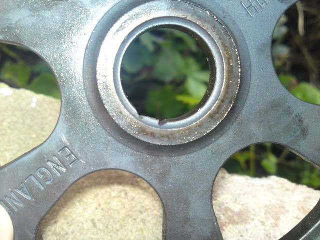

Kempy 0 Posted October 13, 2009 this looks to be a cause maybe for poor timing performance?? the keyway looks broken/damaged on the timing wheel, Ive got the head off but I cant tell if anythings damaged Quote Share this post Link to post Share on other sites
dirtytorque 0 Posted October 13, 2009 yes it is broken. I think i have a sprocket somewhere.. Quote Share this post Link to post Share on other sites
Kempy 0 Posted October 13, 2009 so woodruff key is built into the pulley? Cause on Etka the woodruff is loose? Quote Share this post Link to post Share on other sites
aide 0 Posted October 13, 2009 only the cam gears have woodruff keys, the belt pulley should have a notch on the inner side Quote Share this post Link to post Share on other sites
Kempy 0 Posted October 13, 2009 Ive swapped over the chain sprockets from the 9a cams to the KRs. Then removed the pulley and noticed it moved freely on the cam :nono: . Could the bad timing caused this or just old age :lol: Quote Share this post Link to post Share on other sites
aide 0 Posted October 13, 2009 old age caused it to shear, and yeh bad timing cos of it :D Quote Share this post Link to post Share on other sites
Kempy 0 Posted October 13, 2009 would it cause overheating/ over pressurising? Quote Share this post Link to post Share on other sites
aide 0 Posted October 13, 2009 will cause flat out poor running & low performance, as incorrect intake, compression and exhaust valve timing in relation to piston cycle - overheating not sure, normally that's more a fuel issue Quote Share this post Link to post Share on other sites
