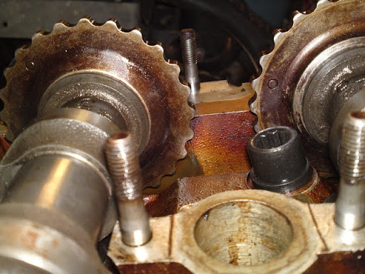

mrbeige 0 Posted April 6, 2010 I replaced a 9A inlet cam with a KR inlet cam and everything lined up fine. The cam sprockets will only go one one way as they are keyed. It might be worth checking the key-way isn't funked on the exhaust cam? Quote Share this post Link to post Share on other sites
mrbeige 0 Posted April 6, 2010 Can you get a piccie of where the exhaust cam sprocket timing mark is? I can't see it in that piccie you posted earlier.. Quote Share this post Link to post Share on other sites
Kempy 0 Posted April 6, 2010 looks like the sproket is on the wrong way, gonna sort that tonight Quote Share this post Link to post Share on other sites

mrbeige 0 Posted April 7, 2010 Kempy said: Fair play, that's fecking miles out. Your inlet cam looks to be about a tooth out too. Quote Share this post Link to post Share on other sites
Kempy 0 Posted April 7, 2010 when i swapped the sprockets from my 9a cams i put the one on the exhaust the wrong way round :camp: Quote Share this post Link to post Share on other sites

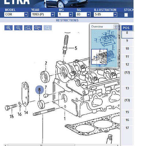

Kempy 0 Posted April 20, 2010 hello my cars coming together now but I have bits left lol whats this number 14, its not been fitted :confused4: Quote Share this post Link to post Share on other sites
aide 0 Posted April 20, 2010 i think its a bracket for a sender of some sort, could even be a temp sender? :D Quote Share this post Link to post Share on other sites
Kempy 0 Posted April 20, 2010 OK, Ive got all the belts timed now :mad2: , I cant tell from the pic where it goes, any ideas? Quote Share this post Link to post Share on other sites
mrbeige 0 Posted April 20, 2010 Kempy said: hello my cars coming together now but I have bits left lol whats this number 14, its not been fitted :confused4: That's just a hook for lifting the engine on. don't worry about it. Quote Share this post Link to post Share on other sites
