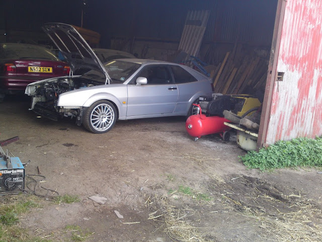

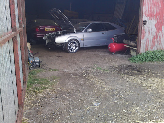

Kempy 0 Posted April 26, 2010 My satin valver has been moved into a different shed whilst the other gets a clean for the farmers cousins wedding :lol: anyway, it got moved and its nice and snug in its new home, plus I got all my stuff tidied without lifting a finger ( there was a lot of crap) Im gonna spend all day on it tomorrow I would love to have it running :wave: Quote Share this post Link to post Share on other sites

culshaw 1 Posted May 18, 2010 more pics needed, i like farm barns but... that mondeois hurting my eyes Quote Share this post Link to post Share on other sites
Kempy 0 Posted May 18, 2010 2 flood damaged mondeos unfortunately. More pics soon. Im not enjoying that barn tbh, I want it out sharpish. Its an incentive to get it finished Quote Share this post Link to post Share on other sites

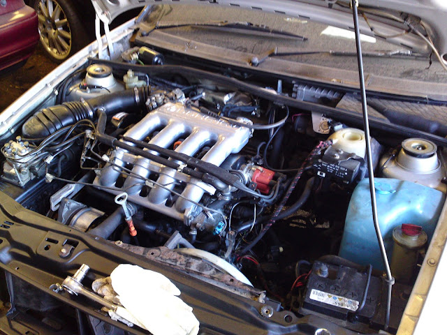

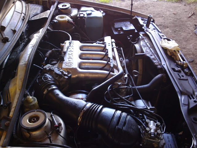

Kempy 0 Posted May 21, 2010 went to finish off what I had left to do on the car, first i had to pick up the temp senders. They only got me 1 :censored: . Anyway I went up to the barn to finish what I could. So I ended up doing everything :clap: only have the temp sender to fit when It arrives and add the coolant. Sunday I hope :D Then i can start the beast up I hope TBH Im a little worried about the fuel injectors, How can I make sure they are fitted securely?? also had a fail with the bonnet catch, but thats sorted, I do need the horny/trumpety bit for the release cable, anyone?!? :shrug: Quote Share this post Link to post Share on other sites
Kempy 0 Posted May 23, 2010 Ive also spotted whilst working on the engine that the charcoal filter doesnt seem to be used?, The hose that should be going into the TH is cut off and has a bolt in it? Is this some kind of mod? ta. Gonna start her up today :eek: Quote Share this post Link to post Share on other sites

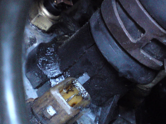

Kempy 0 Posted May 23, 2010 Quite gutted i couldnt get it started today, when i added coolant the flange into the head was cracked and water poured out :censored: this is how it looks anyway Quote Share this post Link to post Share on other sites
