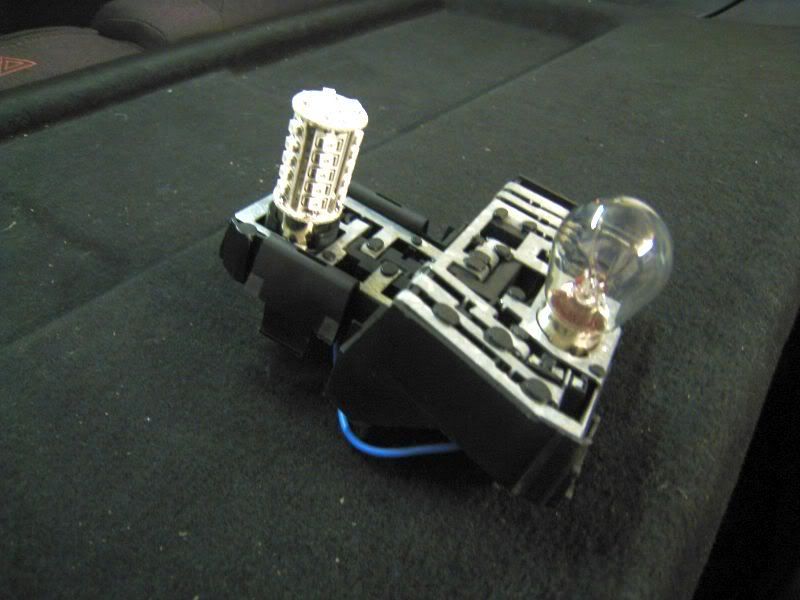

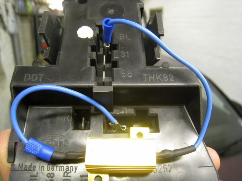

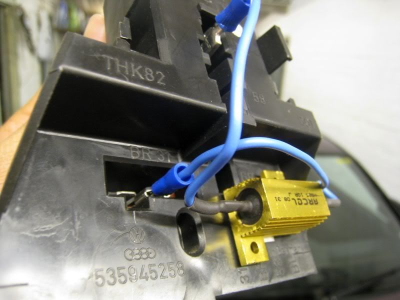

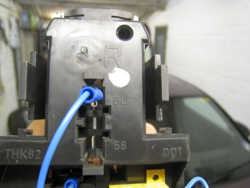

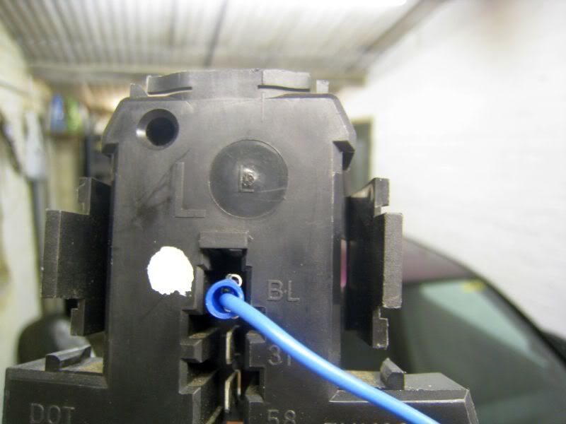

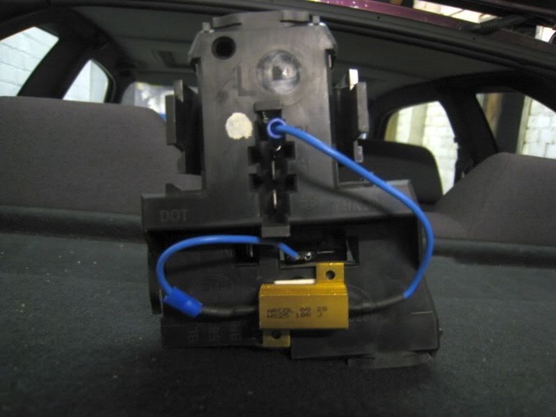

zak 0 Posted October 22, 2009 Heres a picture of my light panel with the led bulb fitted on the front and the resistor on the back Heres the terminals i connected the resistor to on the passenger side tail light Heres the terminals i connected the resistor to on the drivers side tail light heres a video of my indicators flashing Hope that clears up the wiring :) Quote Share this post Link to post Share on other sites

deanjames 0 Posted October 23, 2009 deffo be changing it to your way i did mine like this and the result The led i currently have are 24 led but have just ordered some 36 led ones Quote Share this post Link to post Share on other sites

fla 9 Posted December 7, 2009 Heres a picture of my light panel with the led bulb fitted on the front and the resistor on the back Heres the terminals i connected the resistor to on the passenger side tail light Heres the terminals i connected the resistor to on the drivers side tail light heres a video of my indicators flashing Hope that clears up the wiring :) Looks like i'm doing something wrong - i've just wired mine up like yours Zak and they both flash too fast, ie though there's no resistor in there. Does anything need to be disconnected before wiring in the resistor? Quote Share this post Link to post Share on other sites
zak 0 Posted December 7, 2009 thats strange, the wiring is exactly as above. There is nothing else you need to do. Quote Share this post Link to post Share on other sites
pumbaa 0 Posted December 7, 2009 Does it matter which way round the terminals of the resistors are go? E.g. diodes only work one way round. Quote Share this post Link to post Share on other sites
fla 9 Posted December 7, 2009 Shouldnt do Pumbaa. Anyway, here are some pics i just took of mine. I bought the resistors off here i guess they should be the right resistance. I've actually just swopped the spade for the left connector to the position next to the other one, although it wont make any difference. I also tried turning the bulbs around but also no effect. :? Quote Share this post Link to post Share on other sites

fla 9 Posted December 8, 2009 The measured resistance of the resistors is in fact 22 ohms. So assuming this to be higher than the others i have, the current draw will be lower, so theoretically there should be a sufficient load for them to flash properly, no? (from V=IR) Or is it the other way around, in that the resistance is too high hence considered an open circuit? I'll try it without the resistors and see. Quote Share this post Link to post Share on other sites
fla 9 Posted December 9, 2009 turns out the resistors were mullered. I've fitted the new ones and its all fine now. Thanks for the input chaps. Quote Share this post Link to post Share on other sites
