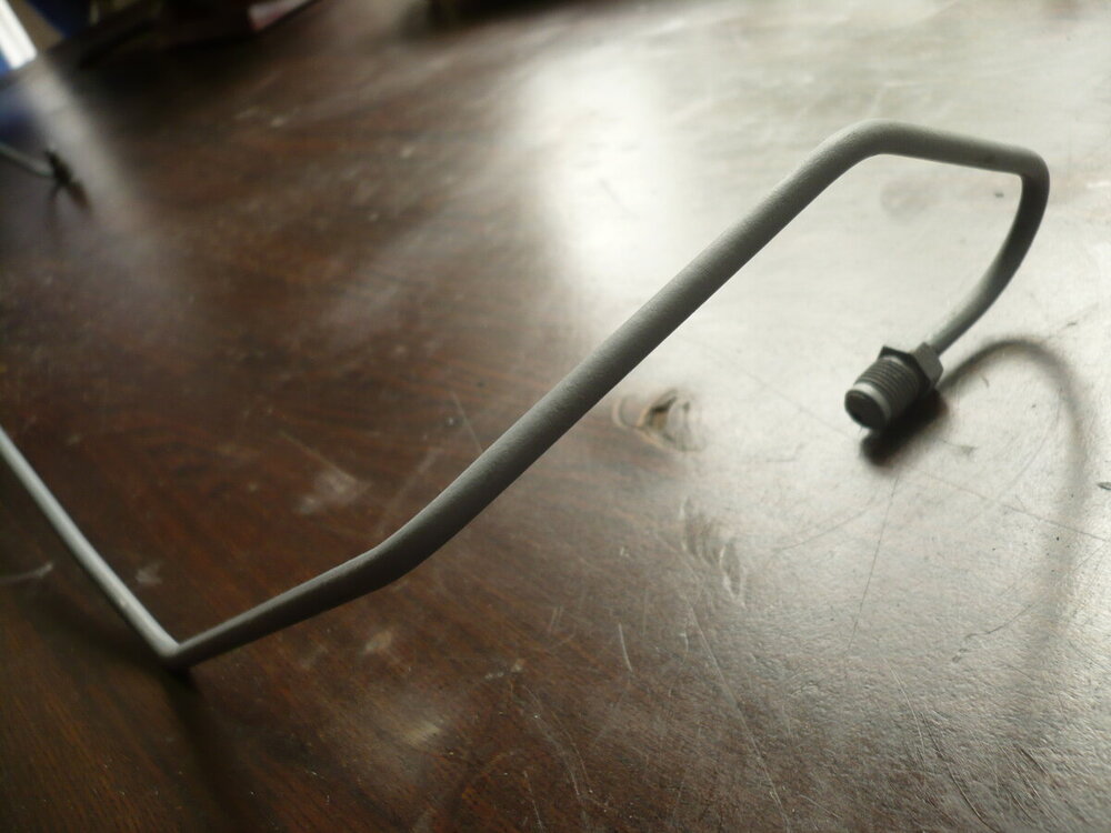

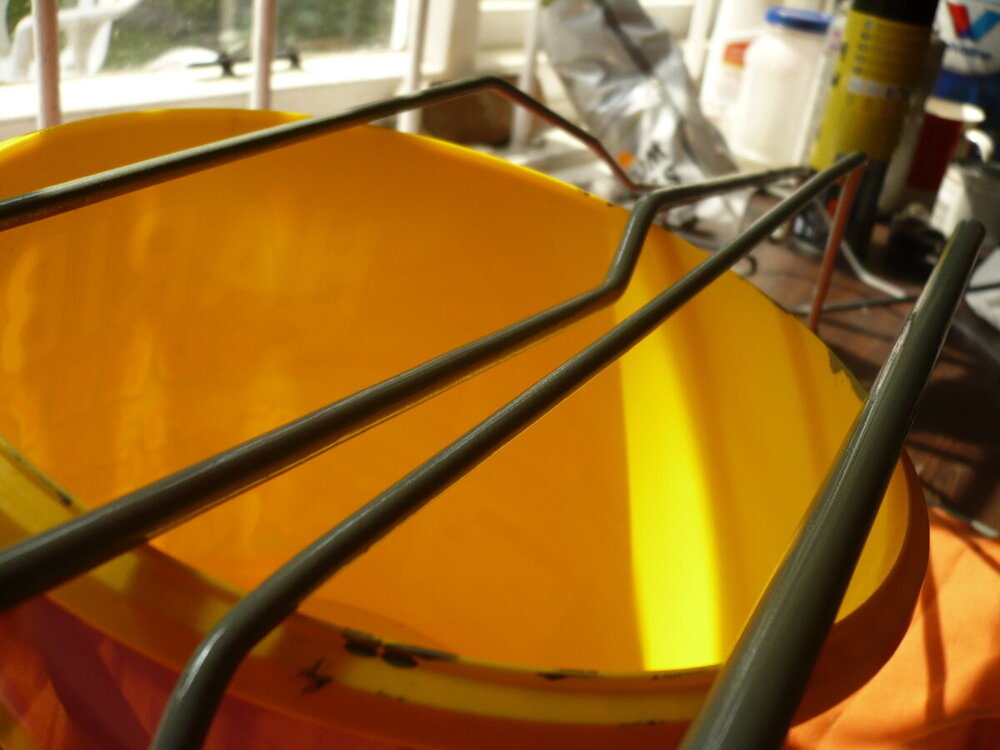

James. 7 Posted August 11, 2012 (edited) Thanks paul, I'll give it a try. Couple of spare hours today. After seeing the prices VW wanted for the heat shields, I thought "Best try to clean them up a bit". Went to work degreasing with a stiff brush. Then jumped inside and hit them with WD40 and a wire wheel on the drill. I'll have another go next week and if all else fails I could always break out the very high temp alu paint. Had a go at the brake lines as well. They were looking a little past their best so why not give them a clean up and see if we can't bring them back. Small rub with wire wool, prime and Hammerite (Wild Thyme for those interested). The colour isn't exact, but it is now consistent and free from scabs. Couple of shots to mark where we're up to: Edited July 25, 2023 by James. Quote Share this post Link to post Share on other sites

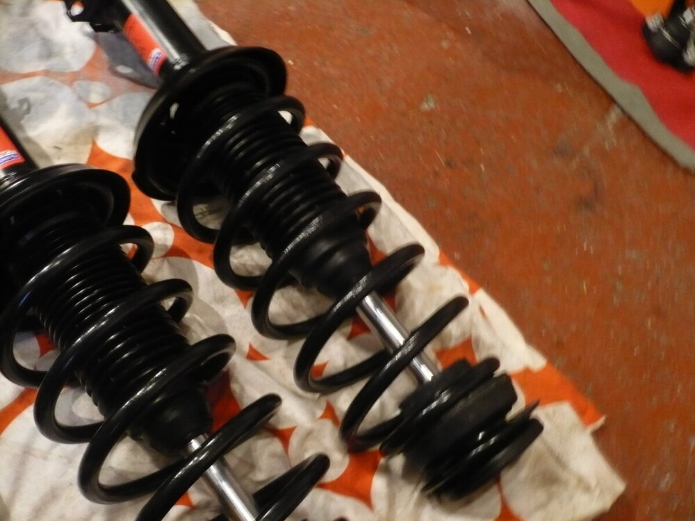

James. 7 Posted August 24, 2012 (edited) Following on from the last post, progress has been slow. I've spent most of the week off the road with a virus. Nipping into the garage in short bursts to get a bit of fresh air. Cleaning a bit here, fitting the odd bush there. I've got pretty much all the bolts and clips for the front and rear subframe from VW (with a couple of exceptions) and am due to start bolting it all up in the very near future. Front and rear shocks are built up. Wishbones built up with ball joints, bushes and drop links. Ready to install the heatshields and brake/fuel lines next, along with building up the rest of the engine support/subframe. Here's an odd one. Whilst refurbing the parts I took off I noticed that the shock top mounts were black. It looks like someone from the factory had been extending the cars black roof lining theme onto other parts. The door/boot locks and bonnet catches had received the same treatment. As a result they've had their original coatings brought up to date. Edited July 25, 2023 by James. Quote Share this post Link to post Share on other sites

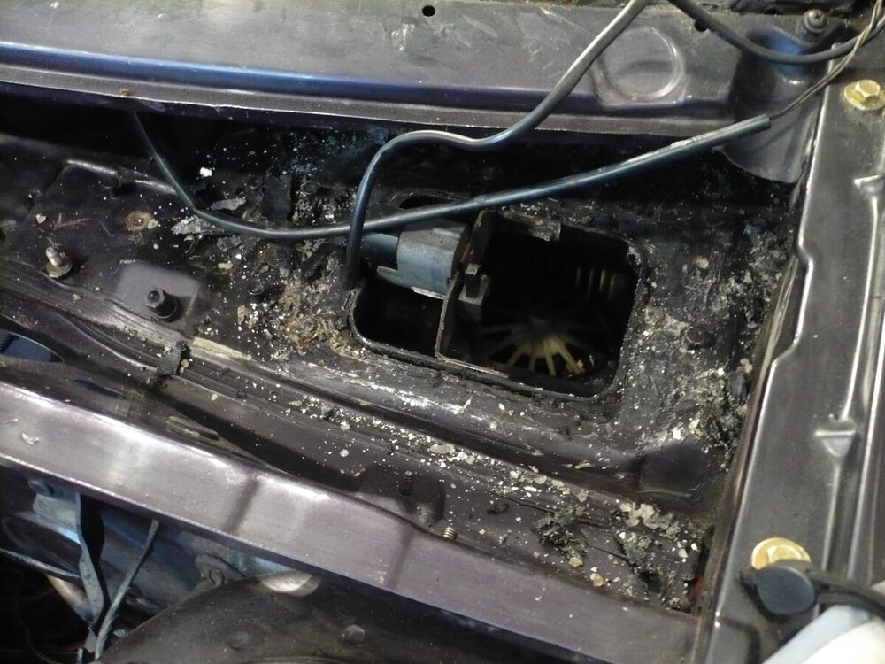

James. 7 Posted December 2, 2012 (edited) What with the 8valve having a couple of mechanical corrections remedied this weekend, I felt it prudent to share some mechanical love with the other Corrado in my life. So today (somewhere around lunch time), Oscar and his mum tootled off to his Nans. Allowing dad the rest of the afternoon to spend in a freezing garage, with just automotive beauty, a couple of brews and Radio 2 for company. First off was plugging the heater in. Once I got the feeling back in my fingers I proceeded to degrease the engine bay and arches, scotchpad it all down and then give it a wipe over with pre-paint. Much to my fingertips disappointment, I opened up the doors and started to spray on the primer. Nipped back inside for another brew and to see who we had in the next round of the FA cup (Would have liked an away day at Aldershot, Harrogate or Crawley. But ended up with AFC Bournemouth at home if you're interested). Not much to elaborate on after that. Just a couple of snaps for the family album. Need a bit of warmth for the basecoat though. Edited July 25, 2023 by James. Quote Share this post Link to post Share on other sites

James. 7 Posted December 6, 2012 Rattle cans Kip. I know the purists will bang on about quality blah de blah, but to be purfectly honest, there's so many seams and underseal to distract the viewers eye from any small blemishes that after seeing how the rear lower apron arches came out, I'm confident of achieving a similar result. And let's be honest, how much of the bay paintwork can you see when the VR6 lump is dropped back in ? Not much at all. Looks like I'll have to get the heat up in the garage before I paint it though. Last thing I want is a milky bay ! Sunday we paint ! Quote Share this post Link to post Share on other sites
KIPVW 0 Posted December 6, 2012 Fair doo's Good luck with it chap ;) It's actually possible to get a reasonable finish as I have done the very same thing to a section of external panel on the VR, Spot it if you can ;) Quote Share this post Link to post Share on other sites
