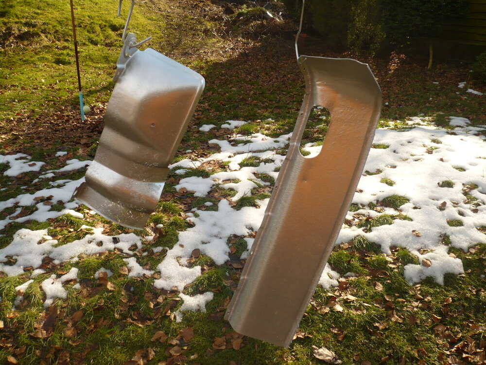

James. 7 Posted April 1, 2013 Great work James, looks brill under there. Have you got your heat shield clips on correctly? Daft things to spot but its a place I'm used to being at the moment!! Thanks Chris. I'm really happy with how it looks underneath. It's such a joy to be working with clean parts for a change. I wondered how long it would be before the eagle eyed spotted the upside down shield clips though ! The mounting points have corroded through, so I put them on a couple of turns whilst I fabricate some bigger alu discs to sit between the clips and shields. After much frustration I managed to install the front arb bushes and droplinks. What a swine they were. Then we moved to the back end, and again after much jostling got the rear beam bolted in place. Finished the day by bolting the steering rack in place. Rack brace and rubber mount are obsolete in the UK so I broke out the refurb A game. After what feels like many a false start, I feel progress is finally being made. The fact I've nearly emptied my cache of VW bolts is proof of that. Quote Share this post Link to post Share on other sites

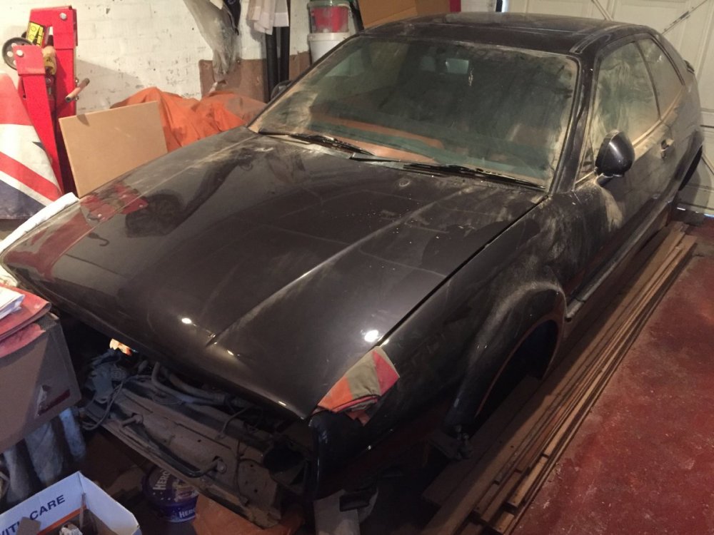

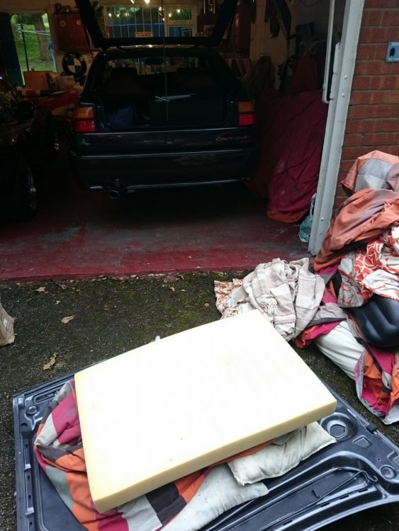

James. 7 Posted July 31, 2016 (edited) I've lots of new pictures since my last post ( days at the beach, record collecting, etc etc ). Sadly none of them are Corrado related ! Your post ( and I thank you for it ) has reminded me that I have unfinished business. So last week, I decided to peel the clammy bedsheets from the fuel cell. From whence it was set aloft the dear old girl. Drop some restored energy in to old parts, to peruse Vagcat for new trinkets. And see where it takes us. I've been away from the old girl for far too long. And I miss her. Viva le VR6. Edited May 8, 2020 by James. Quote Share this post Link to post Share on other sites
