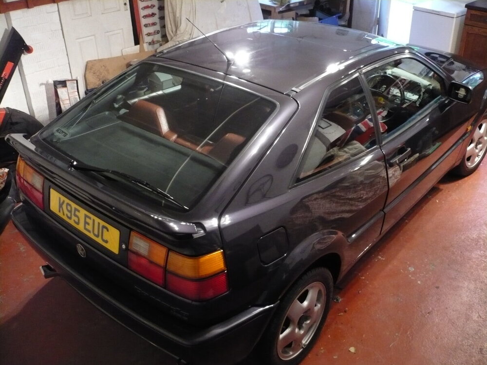

James. 9 Posted May 22, 2010 (edited) I've put the effort in over the past few days and got most of the trim fitted and the interior back in. Edited July 24, 2023 by James. Quote Share this post Link to post Share on other sites

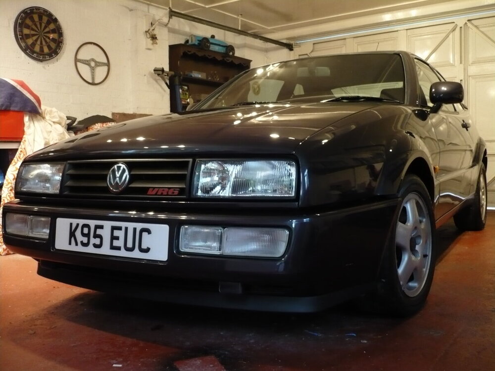

James. 9 Posted May 25, 2010 (edited) Couple of final shots before she's whisked off for the MOT. Edited July 24, 2023 by James. Quote Share this post Link to post Share on other sites
stevej 0 Posted May 26, 2010 looks real nice. Good luck with the MOT Quote Share this post Link to post Share on other sites
