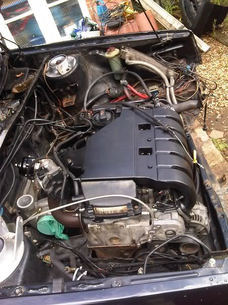

GVK 0 Posted August 8, 2010 Fitz nice'n'tight - heat sheilding needed for column gaiter/clutch m/c and pipes! Precision wastegate, Seimens 630cc injectors Quote Share this post Link to post Share on other sites
coullstar 0 Posted August 8, 2010 What size wastgate are you using? It is a tight fit. Quote Share this post Link to post Share on other sites
GVK 0 Posted August 8, 2010 It's a 38mm from Precision, the turbo is a tighter fit than the WG :lol: Quote Share this post Link to post Share on other sites

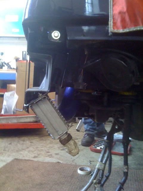

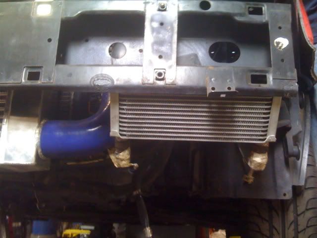

GVK 0 Posted August 10, 2010 I'm undecided about oil cooler location as will have intercooler in front of rad where i used to have the oil cooler, thought about fitting it in old battery location and then add some holes in the bonnet to vent the heat from it ( the bonnet is dented etc so it wouldn't hurt to experiment) Quote Share this post Link to post Share on other sites

jamminvr6storm 0 Posted August 10, 2010 GVK said: I'm undecided about oil cooler location as will have intercooler in front of rad where i used to have the oil cooler..... I had the same on mine, once the rad and front mount intercooler were in place there wasnt much space for an oil cooler (plus it wouldnt have been very effective) so I relocated mine here: Mock up pics Not sure its the same on the mk2.... Welded small strips onto the bumper iron and mounted it at an angle, this has been very effective and it sits neatly behind the lower grill on the Corrado OE bumper. Quote Share this post Link to post Share on other sites

GVK 0 Posted August 10, 2010 Thanks for the pics of oil cooler - I'm being tight and don't want to buy new hoses so I'll just see where it fits and mount it where ever :lol: If I have to cut the bumper its no big deal as it's only the outer skin anyway. All the irons have been removed just left a bit each side to locate the bumper. Quote Share this post Link to post Share on other sites
