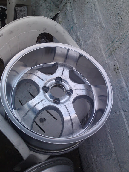

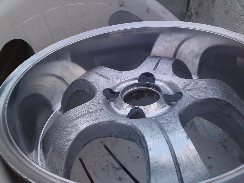

Kempy 0 Posted February 14, 2010 nitromors the laquer so it went back to bare metal and got polishin Quote Share this post Link to post Share on other sites
eugopnosaj 0 Posted February 15, 2010 What were you using to polish the wheels with out of curiousity? Quote Share this post Link to post Share on other sites
timthetinyhorse 0 Posted February 15, 2010 looks like they have been polished with a full polishing kit if im not mistaken Quote Share this post Link to post Share on other sites
eugopnosaj 0 Posted February 15, 2010 Hmm might have to invest in one of those....the wheels ive got already arent the right design/shape to add a different colour and would probably benefit from being polished properly, although they are a matt(ish) silver colour so could repaint and lacquer them i guess as they need sanding down and using some filler primer... heres my attempt too takes time though Noticed that you used 'red metal flake' this looks interesting, where did you get this from and how did you add it? So out of curiousity how easy do you think it would be to DIY refurb something like this: http://cgi.ebay.co.uk/4x-17-Wolfrace-4x100-4x108-ford-vw-clio-corsa-alloys_W0QQitemZ110461404287QQcmdZViewItemQQptZUK_CarParts_Acc_Wheels_tyres_Rims_Car_Wheels_ET?hash=item19b803447f I would probably paint the inner section black (or colour code pearl green) and probably silver around the edge or http://cgi.ebay.co.uk/4x-17-Team-dianamics-4x100-4x108-ford-vw-vauxhall-mx5_W0QQitemZ110493308740QQcmdZViewItemQQptZUK_CarParts_Acc_Wheels_tyres_Rims_Car_Wheels_ET?hash=item19b9ea1744 again probably paint the inner section black (or colour code pearl green) and probably silver around the edge Quote Share this post Link to post Share on other sites
Kempy 0 Posted February 15, 2010 The lips I used sand paper from 80 up to 800 and 1000 etc, but once smooth I used http://cgi.ebay.co.uk/15-Piece-Frame-Sw ... 51907d0fe1 kinda deal but the dished bits I just nitromoorsed to remove the clear coat and then Belgum Metal polish, almost mirror finish :norty: Quote Share this post Link to post Share on other sites

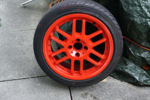

jaded2882 0 Posted February 17, 2010 my first refurb completed with tyres on :-) Colour match yo Just remember, take time masking, plenty prep work, good coats of primer, plenty paint, plenty laquer, taking your time is the key :-) good luck if you want any advice give me a shout That looks great, you've got the same colour as me and I'm thinking of doing my stroseks colour matched like that :) I also have a hammered set of 17" multispoke TSWs. They are nice wheels but all kerbed, buckled and generally f****ed. Hoping to get some quotes for sorting them out as it's way beyond my skills Quote Share this post Link to post Share on other sites

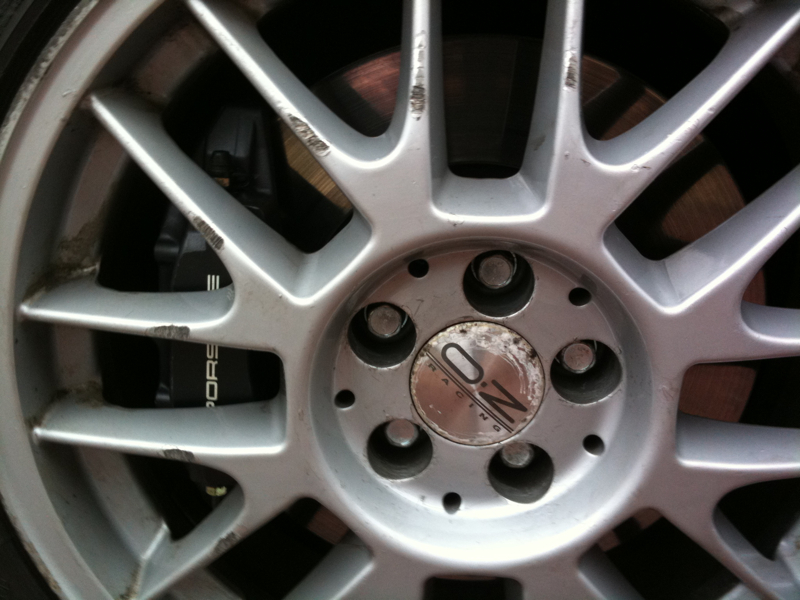

poll250 0 Posted February 17, 2010 How would I go about fixing this myself? Is it sandpaper or wet and dry you use? Quote Share this post Link to post Share on other sites
Critical_Mass 10 Posted February 17, 2010 How would I go about fixing this myself? Is it sandpaper or wet and dry you use? Depends how deep they are tbh mate, you may have to sand them right back fill and repaint. But if its light - wet and dry the scuffs. Quote Share this post Link to post Share on other sites
Kempy 0 Posted February 17, 2010 you might have to use something like 80 grit there, maybe a little metal filler/bondo. maybe. they can be sorted I bet EDIt I use a mousey sanding tool, much quicker Quote Share this post Link to post Share on other sites
Critical_Mass 10 Posted February 17, 2010 Yeah can definately be sorted, my speedlines had similar gouges out of them. but i sanded them back with a bosch sander and filled them and sanded it down flat. Sprayed up not bad. Just make sure you sand with a fine grit between paint coat and laquer as they'll come out rough... like mine did :oops: Quote Share this post Link to post Share on other sites
poll250 0 Posted February 17, 2010 Cheers for the suggestions guys, will take a look into it :D Quote Share this post Link to post Share on other sites
