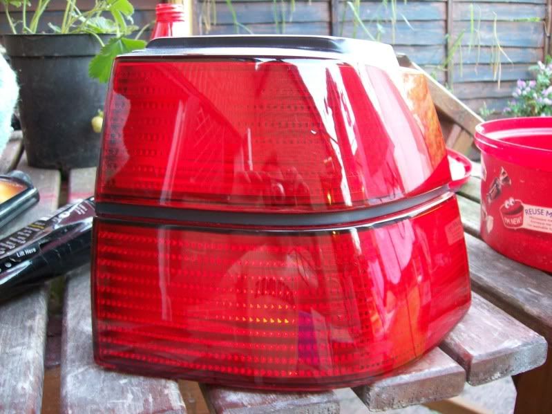

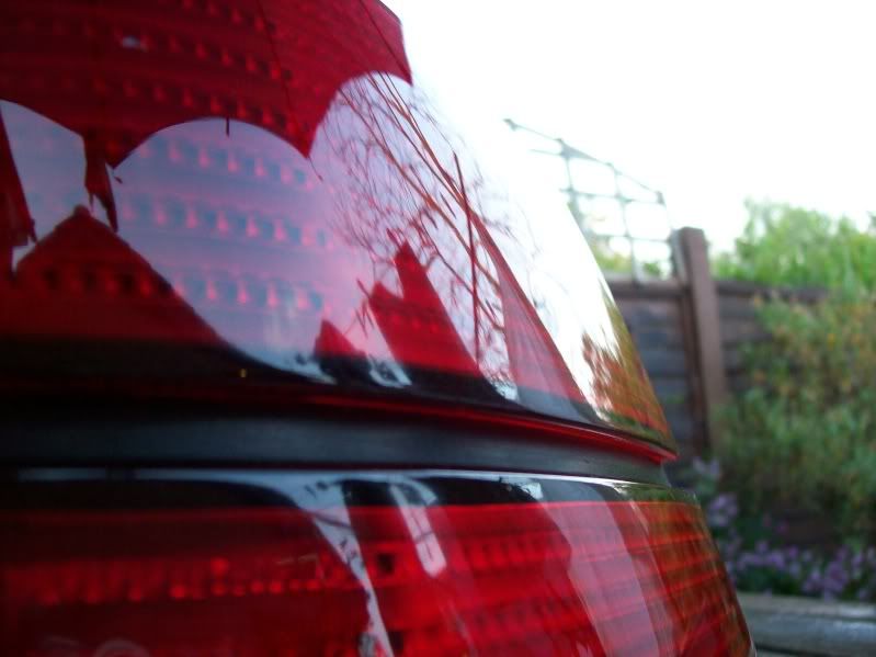

borarob 0 Posted April 14, 2010 like others I used the savage spray plus some halfords clear lacquer over the top. put lots of red tint on and lots of lacquer. i didn't put enough in and think its likely I'll have to redo as the tops are going a bit orange. the more paint you put on the more you can afford to polish them up to a real nice shine. here's what mine look like: Quote Share this post Link to post Share on other sites

ANDREW 30 0 Posted April 14, 2010 like others I used the savage spray plus some halfords clear lacquer over the top. put lots of red tint on and lots of lacquer. i didn't put enough in and think its likely I'll have to redo as the tops are going a bit orange. the more paint you put on the more you can afford to polish them up to a real nice shine. here's what mine look like: They look great, is 1 can of the red tint enough to do the 4 tail light pieces? Quote Share this post Link to post Share on other sites
Andy665 0 Posted April 14, 2010 It should be enough, personally I believe its the careful application of the lacquer and final polishing that creates a good final finish Quote Share this post Link to post Share on other sites
borarob 0 Posted April 14, 2010 It should be enough, personally I believe its the careful application of the lacquer and final polishing that creates a good final finish absolutely - its all about the lacquer. the more of that you get on (built up with lots of coats). the more polishing you can do to achieve a factory finish. Quote Share this post Link to post Share on other sites
Kempy 0 Posted April 14, 2010 do you paint over the red at the bottom, I did mine a while back and they dont look that lovely Quote Share this post Link to post Share on other sites
borarob 0 Posted April 14, 2010 yup, sanded back and painted and lacquered the whole thing, not just the orange bits... Quote Share this post Link to post Share on other sites
