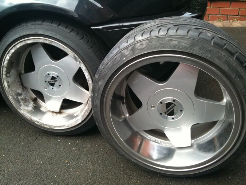

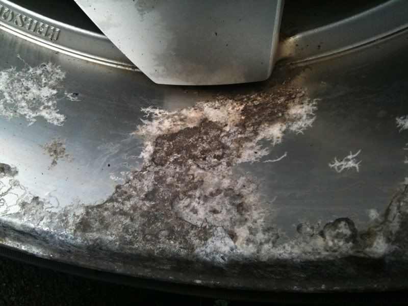

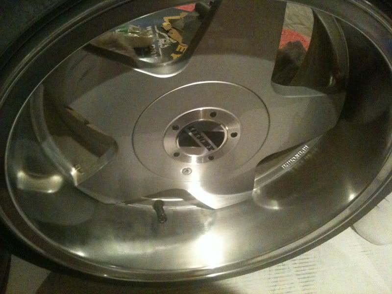

Hi guys,
Thanks for the replys! I've finished refurbishing the wheels and have decided to go with just a wax coating and see what happens. Like you said 'VR6 South', lacquer and polished alloy is not a good combo.
Here are couple of photos of before and after. As you can see, the dishes were originally lacquered and water had got into the cracks. Had to start the sanding stage with 40 grit paper it was that deep!
