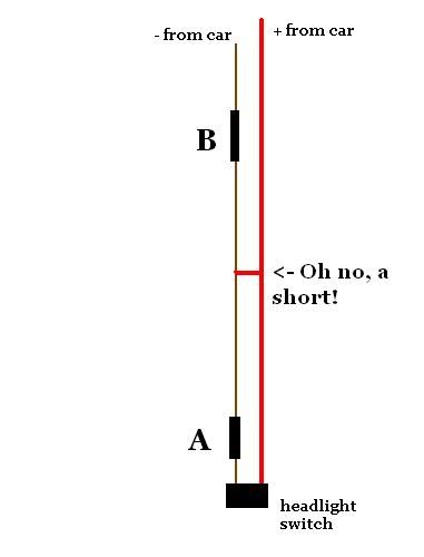

Stromaluski 0 Posted February 12, 2011 I realize I'm kinda new here, but I was about to do this on my car and realized a slight problem with these instructions. It's a brilliant idea, but the fuse is being put in the wrong place. If you put it that close to the switch, it will prevent a fire in the case of a short inside the switch. But, if there is a short inside the wire harness further back inside the car, then the fuse won't blow. I made a quick Microsoft Paint picture showing what I mean. In the picture below, with the short shown, the fuse at A isn't going to blow because the current would have a path that would bypass that fuse. However, a fuse farther up the wire, at B, WOULD blow, preventing a fire. I know the main cause of this problem is a short inside the headlight switch; but if this is something you have been meaning to do, why not put the fuse a little farther up the wire and prevent another possible (however unlikely) cause for a fire? Quote Share this post Link to post Share on other sites
RW1 0 Posted February 12, 2011 Deep inside this thread on page 2, 2nd & 4th posts is hidden this. Note the fuse holder position.http://the-corrado.net/.archive/forum/download/file.php?id=22601&sid=f1ce2755ae86cd41b9a3b89efdd89983&mode=viewBut If you are going to worrying about this, then start worrying about all the unprotected looms prior to the fuse box. The fuses protect control units, etc., not the looms. Quote Share this post Link to post Share on other sites
Stromaluski 0 Posted February 16, 2011 RW1 said: Deep inside this thread on page 2, 2nd & 4th posts is hidden this. Note the fuse holder position.http://the-corrado.net/.archive/forum/download/file.php?id=22601&sid=f1ce2755ae86cd41b9a3b89efdd89983&mode=viewBut If you are going to worrying about this, then start worrying about all the unprotected looms prior to the fuse box. The fuses protect control units, etc., not the looms. I hadn't even noticed the picture while reading through the thread. And it's not so much that I was worried about it, but it's the kind of thing that if you're adding the fuse anyway, why not add it as far up the wire as you can? Quote Share this post Link to post Share on other sites
wazza 0 Posted February 16, 2011 Stromaluski said: I hadn't even noticed the picture while reading through the thread. And it's not so much that I was worried about it, but it's the kind of thing that if you're adding the fuse anyway, why not add it as far up the wire as you can? You don't happen to own shares in a company that manufactures fuses do you... ;-) I keep meaning to do this mod, as mods go it looks quite simple and more importantly beneficial to the longevity of my C! Quote Share this post Link to post Share on other sites
