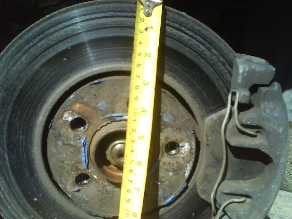

VW_OwneR_85 2 Posted April 6, 2011 hi, not had my corrado vr6 {93} long got around to checking my front disc size today as i had the wheel off and to my surprise it already has bigger front discs! they seem to measure 290mm though?{145mm to center} this right? suerly it must be 288mm? also would mk4 1.8t discs fit ok? there 288mm,http://cgi.ebay.co.uk/GOLF-MK4-1-8-T-AUDI-A3-1-8T-FRONT-BRAKE-DISCS-PADS-C351-/190307092326?pt=UK_CarsParts_Vehicles_CarParts_SM&hash=item2c4f2fc766 Quote Share this post Link to post Share on other sites
beastie4126 0 Posted April 6, 2011 They should be 288mm discs. The MK4 disc's are probably too shallow and will foul the hangers so you will need MK3 VR or late GTi discs. Quote Share this post Link to post Share on other sites
VW_OwneR_85 2 Posted April 6, 2011 yea maybe my tape measures lieing to me? 288's will defo work though so i'll get some anyway, cheers.. Quote Share this post Link to post Share on other sites

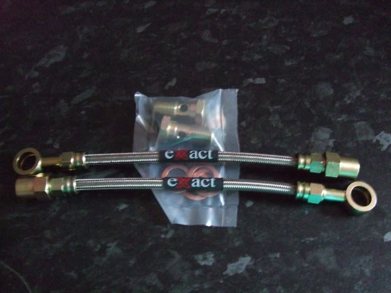

swampy 0 Posted April 16, 2012 (edited) Im looking at doing the mk4 rear conversion some point this year and although you they fit straight on with out the need of calipers and using the original discs. Dont the mk4 rears use 232mm or 256mm discs? and can these be used on the rears as well as the calipers? Also what extra would be needed to make thee fit? is the brake lines you need, custom made and only available from that supplier via me http://www.ebay.co.uk/itm/330717884408?ssPageName=STRK:MESELX:IT&_trksid=p3984.m1558.l2649 ON EBAY Edited April 16, 2012 by swampy Quote Share this post Link to post Share on other sites
Swompy 0 Posted April 17, 2012 Nice one, ill book mark these for when I start collecting my bit. Anything else needed to use the bigger discs on the back? Quote Share this post Link to post Share on other sites
