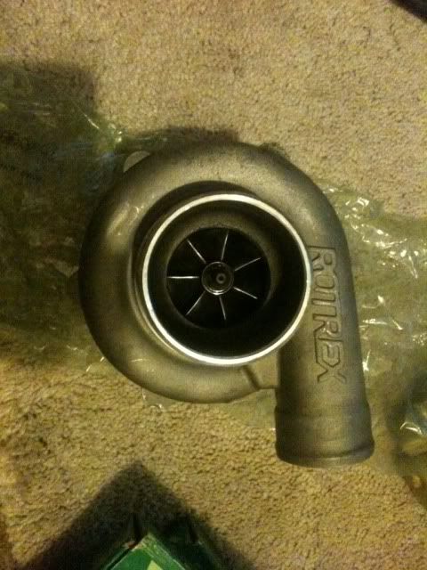

So took delivery the other day of some parts, one of them being my Rotrex charger :)
I need to give it all a good clean and wait for some 312s before i get round to getting it fitted.

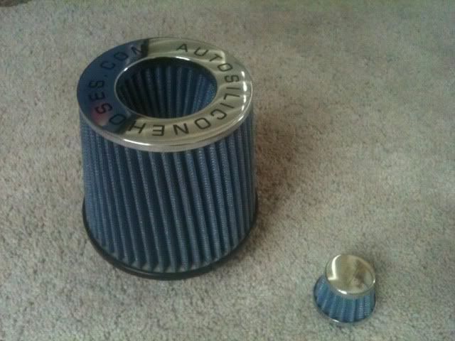

Not sure if i can use my BMC aire filter or not, anony one know the BMC bhp rating?

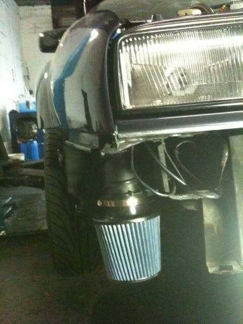

And last q, I will need to have the maf extended so I can fit it in the wing, I presume some wire will just need to be soldered into place :)

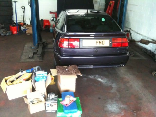

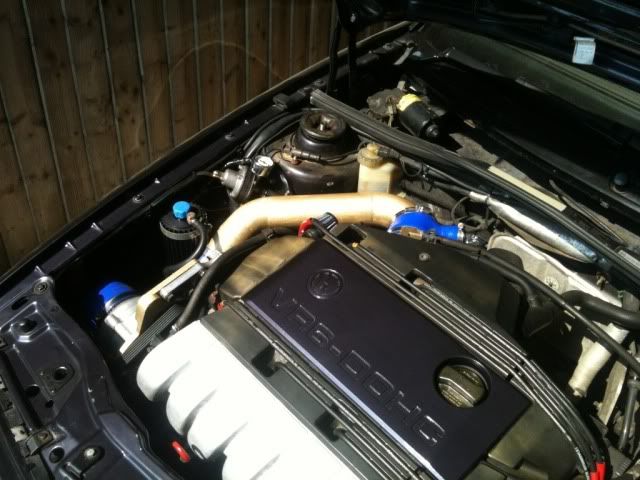

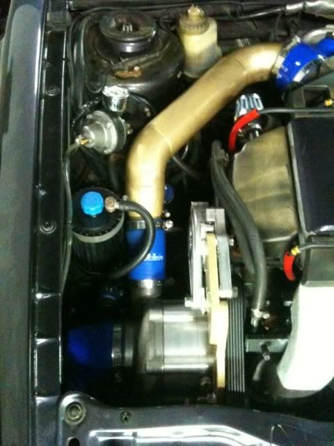

So last few days have been emotional. Being optimistic we started the rotrex install last Friday in a hope to drive down with ramsey on the Sunday but a whole host of issues. Ant it was no where near ready so I was gutted to miss the ccgb national day.
Anyway in short it's alive! Sort of. It's all been a steep learning curve for me but I love to learn about how stuff works
The install was a pain, I had an old bracket I believe thus we had to attach it and take it off numerous time to get all of the pulleys lined up, shave a few mm off of the block as it was fouling the bracket and then one of the threads on the block gave way so we then had to helicoil (sp) in a new thread. In the end after a few late nights its all on.
It's all very tight With the rrfpr, rotrex oil canister and intake pipes. We tried to keep it all as neat as possible and route vacuum lines for the rrfpr and re-circ valve around the engine bay and out of sight :)
The rotrex metal hardpipe has no inlet for the isv pipe, I thought this could be deleted but I was correctly told its needed, so I bought a silicone t-piece and we cut down the isv pipe, connected it back up and then plumbed the isv into the t-piece that was between the tb inlet and intake pipe outlet. The isv hose was smaller than the 25mm t-piece outlet but we fitted a small section of the isv hose around the plastic joiner and this was then a perfect fit and allowed a tight seal.
Initially we tried it with the re-circ venting to atmosphere, do not attempt this. It would not idle, the engine was fuelling for the air metered by the maf, but then most of it was being vented when the tb was closed, so massive over fuelling and no idle.

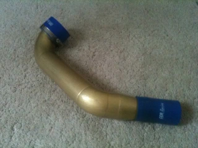

We then used the old intake pipe that came with the kit that had an outlet on the 90 degree elbow. I didn't want to use this as it was old and I had bought a nice shiny t-piece for the re-circ but there is no way enough space to have this and a silicone elbow coming off of the charger. So I cleaned the old pipe, wrapped it in some new silicone tape and plumbed it in.
Now there was another problem, I idled fine but when we drove it it was awful, the re-circ pipe was collapsing as it was only some cheap vacuum pipe. So limped home, replaced the re-circ pipe with a wire reinforced piece and I reset the ecu.
After a drive last night it's certainly got some more power :) but too much I think. I've read that the maf is good for about 280/300bhp and has a 5v resistance for airflow.
When I drive under part throttle its ok, but as soon as I open throttle at about 3.5/4k revs the engine wans to jump out of the bay. I suspect the maf is peaking at its 5v limit and shutting down the injectors. Am I correct?
The car is very drivable up until I open full throttle, I think the charger is maxing the maf airflow so my question now is how do I resolve this?
I've read a few bis on maf clamps, but then any air above the 5v limit is not accounted for? Is this sensible?
I've heard c2 mentioned but I'm not sure what that is?
Or do I need a full remap and new injectors?
Or can a 4" maf be used but then I'll need new software to match I'm led to believe?
As always help is much alpreciated on getting it to run perfect :)

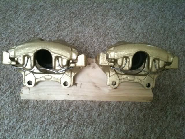

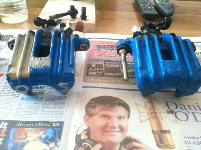

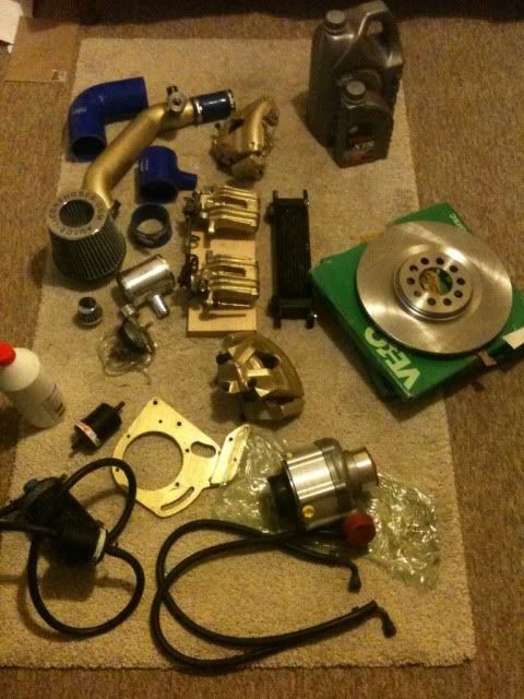

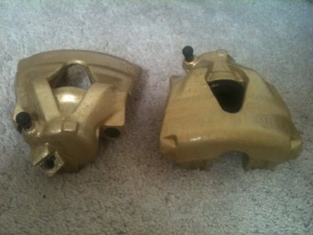

Here's the pics so far, we ran out of time to fit the 312s so hoping this will be done sometime next week :)

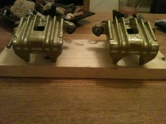

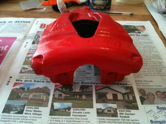

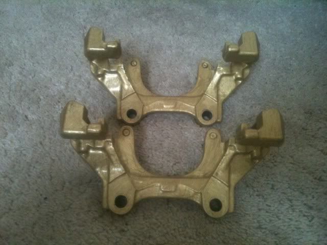

312s were already in very good condition, just not keen on red calipers
Smooth gold :)
mk4 rears painted blue
Lick of gold, not a perfect finish but happy enough
Bundle of items
Rotrex c30-84

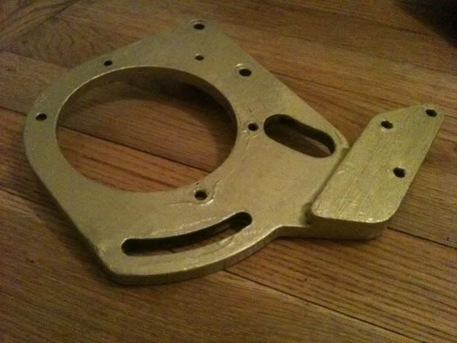

Gold bracket
Metal ccr intake pipe
Thought I'd buy a new filter for piece of mind

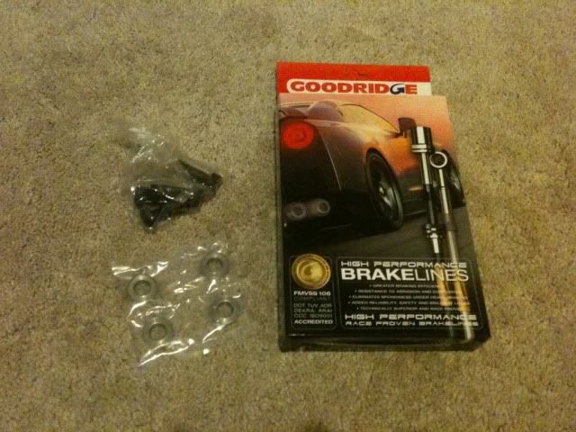

Braided hoses, cnc spacers and high tensile bolts
Ready to start

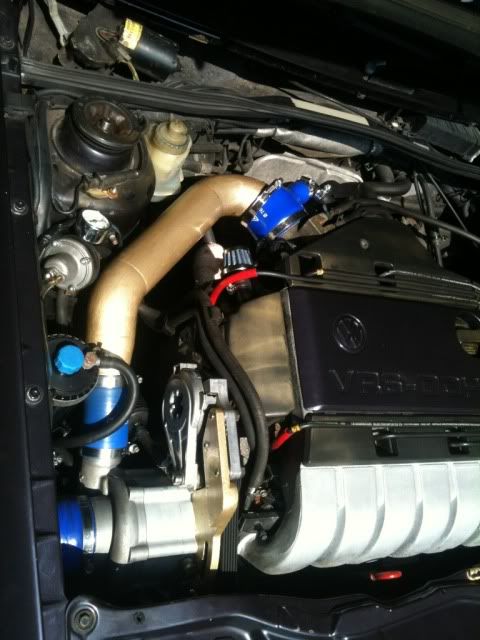

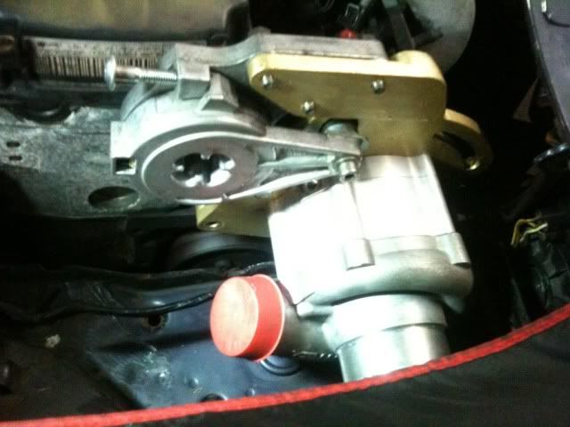

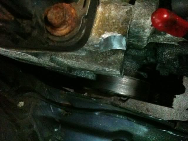

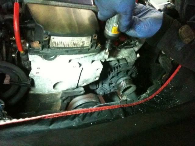

So first problem, having to grind a few mm off the block as I seem to have the old style bracket thats not quite a direct fit
Trial fitting

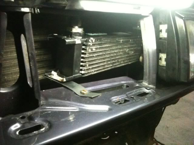

Oil cooler plumbed in
Air filter in the wing
Installed
That install looks very clean.

you always have to grind a bit of the head to get them fitted mate, and sounds like it just needs a remap. Also are you using the standard injectors or have you installed some greens??
