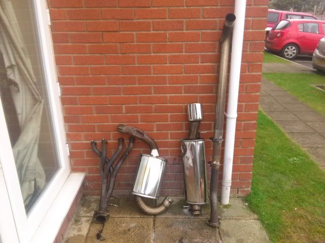

I also got myself a Ray Metallfabrik full exhaust system including decat and a 4 branch manifold, yes I wanted to keep the car mostly original but my god once its been polished it is a sexy bit of metal work and with a 4.5inch x 3.5inch oval end piece it is factory "look" and fits the gap in the rear bumper perfectly.

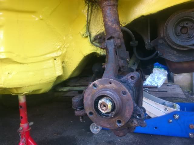

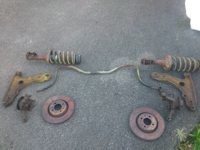

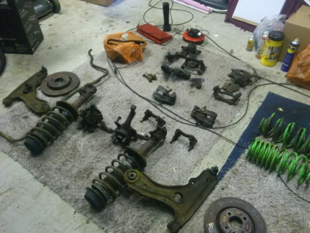

and stripping the old stuff, discs were nasty and the pads were kinda welded to them.
I was really surprised how easy the top mounts came off - a rarity given how many of the buggers i've done. The green springs are Weitec -30mm which will be going on Bilstein sport shocks
apart from the hubs & carriers most of this is scrap now, rest is going to be painted.

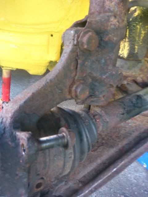

This is what happens to cars that sit around by the seaside - rust rust rust

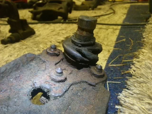

Next on the list im now thinking new CV joints as well.

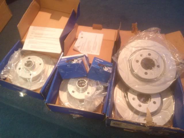

New steel brake flexis are on route from C&R, wheel bearings are ready to.

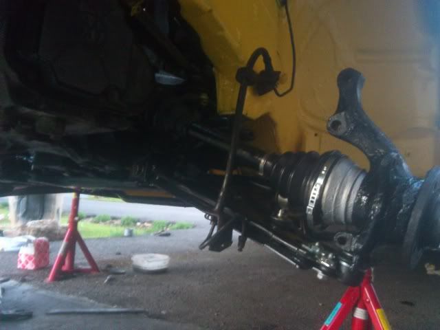

Once we have some more dry weather I will finish spraying all the inner arches and then begin rebuilding the front end.

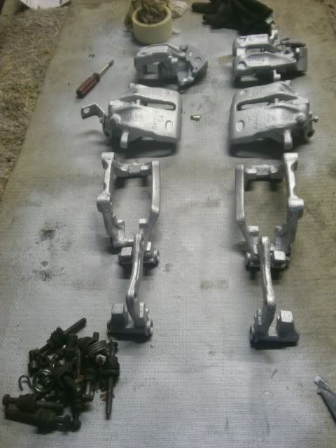

A few more bits nearly ready to go back on.
1) refurbed callipers, new slider pins, new rubber seals and pistons.
2) Goodridge stainless steel hoses all round

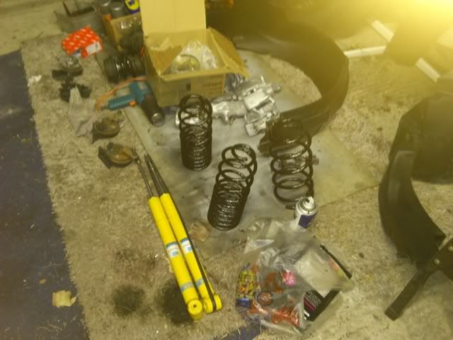

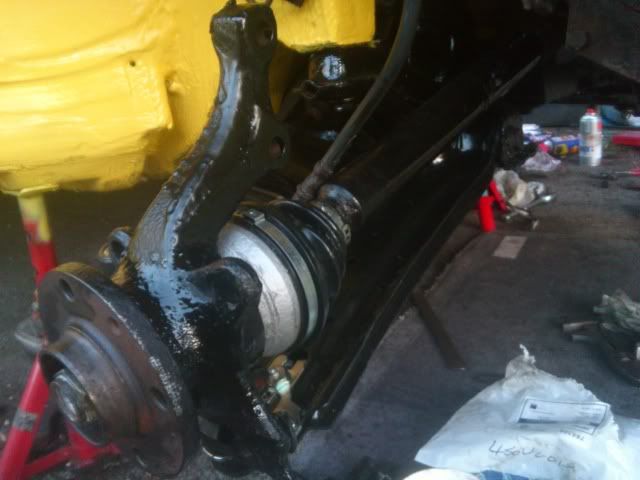

3) put the front suspension, weitec -30mm springs, new top mounts, hubs, new cv, gaitors, ball joints etc on
4) subframe, anti roll bar (standard for now an brush painted as it is getting replaced at a later date with a eibach)

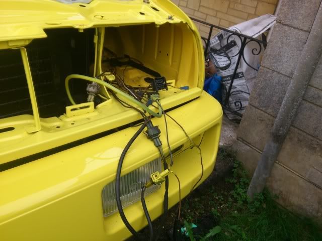

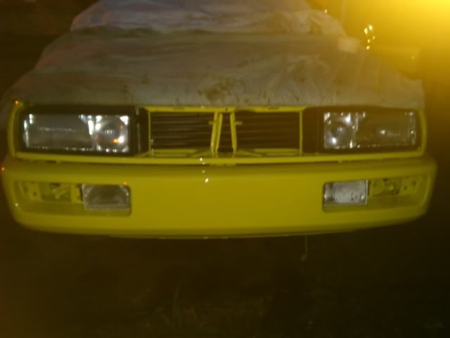

What I have done is find all the parts except for a bonnet cable set up (I think) to complete the front end. New grill, my original G60 badge, a clean set of lights and the entire front end is now held together with polished bolts.

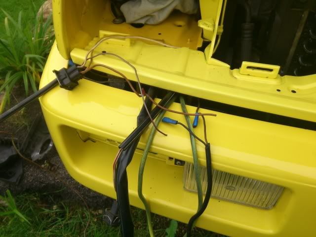

driver's wiring is nearly there, just need to attach new VW connectors
passenger also just needs final connector to do away with those horrible pin connectors

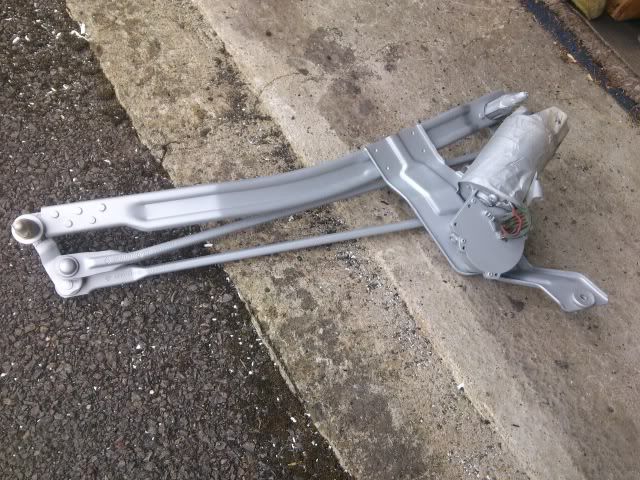

gave the wiper a spruce, most of the engine bay components have been sprayed the same colour/finish
rear suspension and brakes, new Bilstein shocks with weitec springs now black - for subtlety. I'm thinking of applying some kind of black sound deadening material to the inner arches to make them quieter and easier to clean... any suggestions?

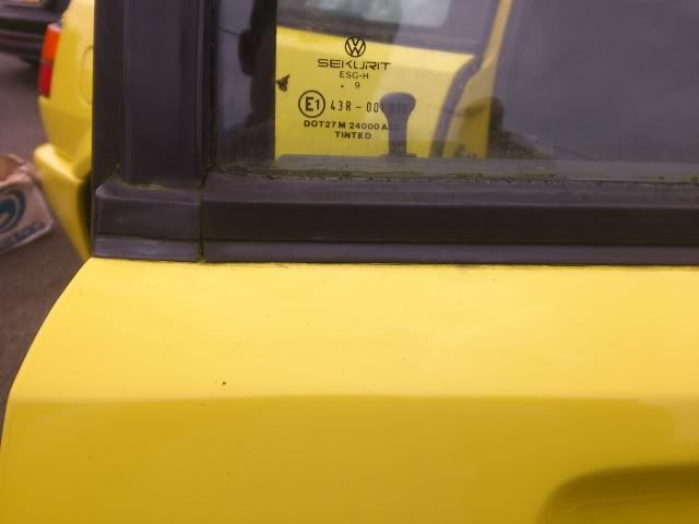

finally, for anyone out there who has a early pre 1990 Corrado, can you check if your window rubbers look like this:

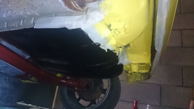

only recent(ish) pictures were halfway through finishing the rear underside
note the back axle is in red oxide and is now gloss black as it's my "test" fit axle. I have a complete built axle which will be swapped at a later date.
inside rear arches painted to.
