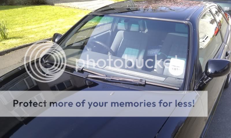

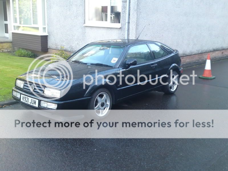

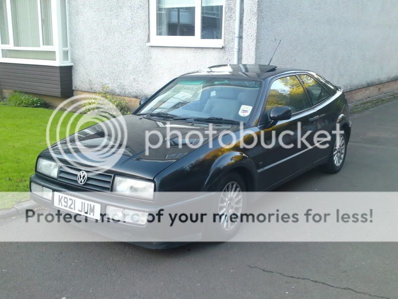

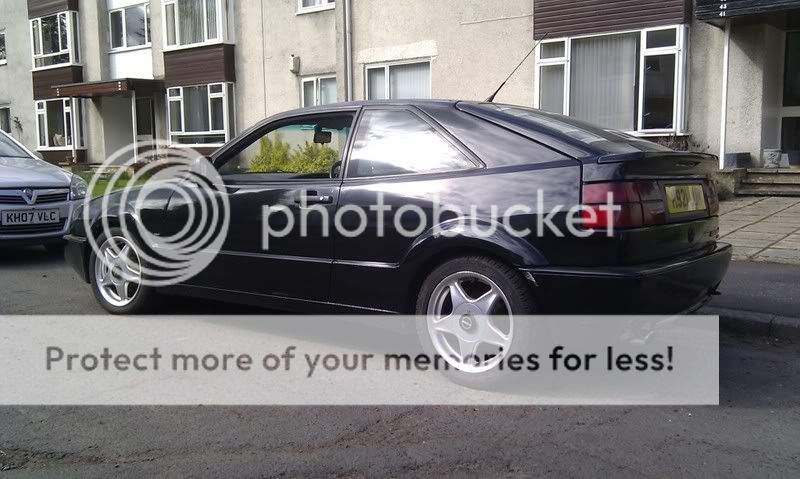

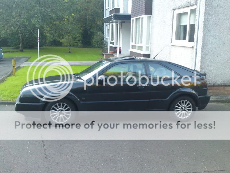

k6kny 1 Posted November 2, 2010 Been on the lookout for a Corrado project car for a while now and had seen one advertised on here that I liked the look of, so while I was down at E38 I went to have a look at it, and after a look at it and taking a test drive I put down a deposit on a Black 1993 2.0L 16v rado, and arranged to pick it up in a few weeks time. Anyway ended up arranging to pick it up at the start of October, so it was an early start to get down to Redditch to pick it up and 303, almost trouble free, miles later it was home in Glasgow :D The car itself has 165k miles and a decent service history, the body work is in good condition with only a couple of small spots of rust that can easily be sorted, paintwork is ropey in some areas but nothing that can't be fixed, also don't think it's seen any polish in a long time :( . The active rear spoiler works automatically and with the button on the dash. It has been lowered 40mm all round on springs, but they will be changed for coilovers. The only other mod that has been done is the sunroof has been changed for a Passat glass roof. The interior is absolutely filthy and looks like it hasn't been cleaned in 10 years so it is going to be a seats out and carpets out job to clean it all up . Anyway here's a few pics taken once I got back up the road. Not a fan of the all black rear clusters so they will be getting changed. The pics don't really show how bad it is in there : I had this sticker lying around and thought it was quite appropriate :lol: Will have more updates soon. Quote Share this post Link to post Share on other sites

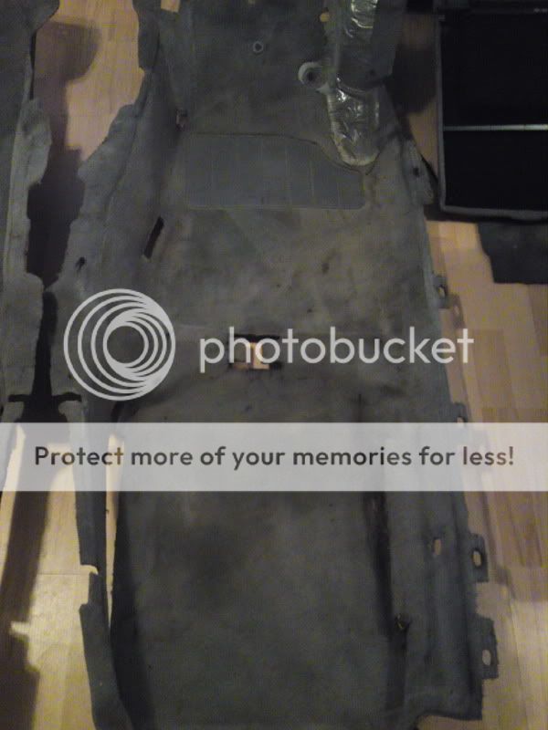

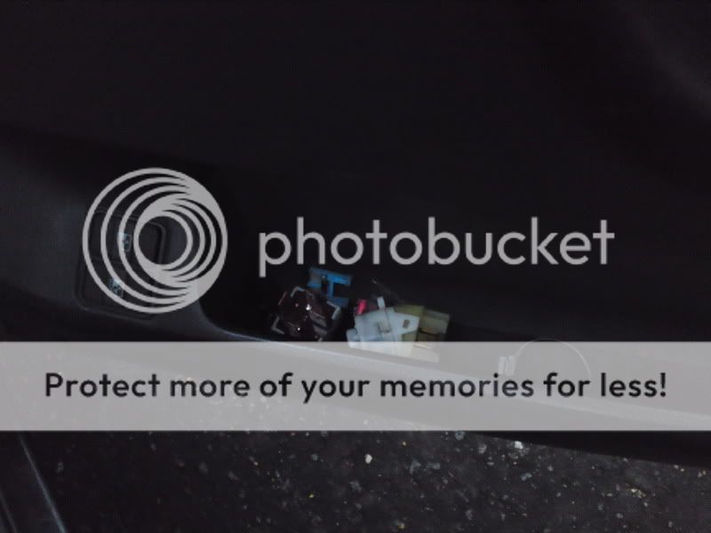

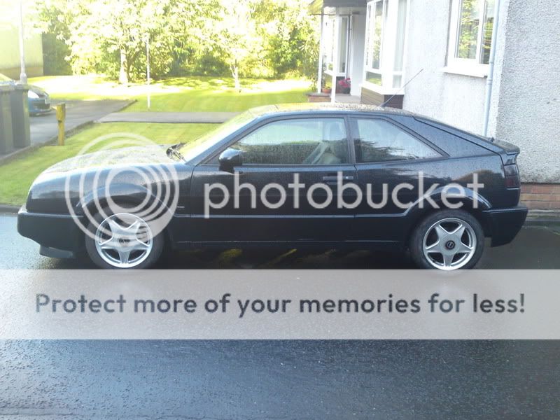

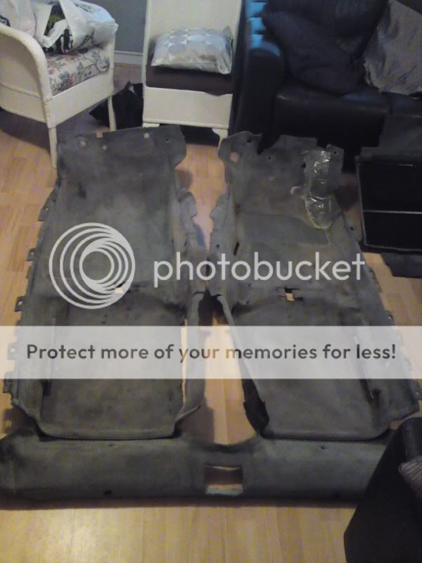

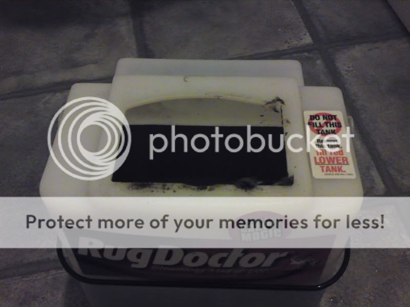

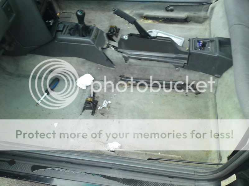

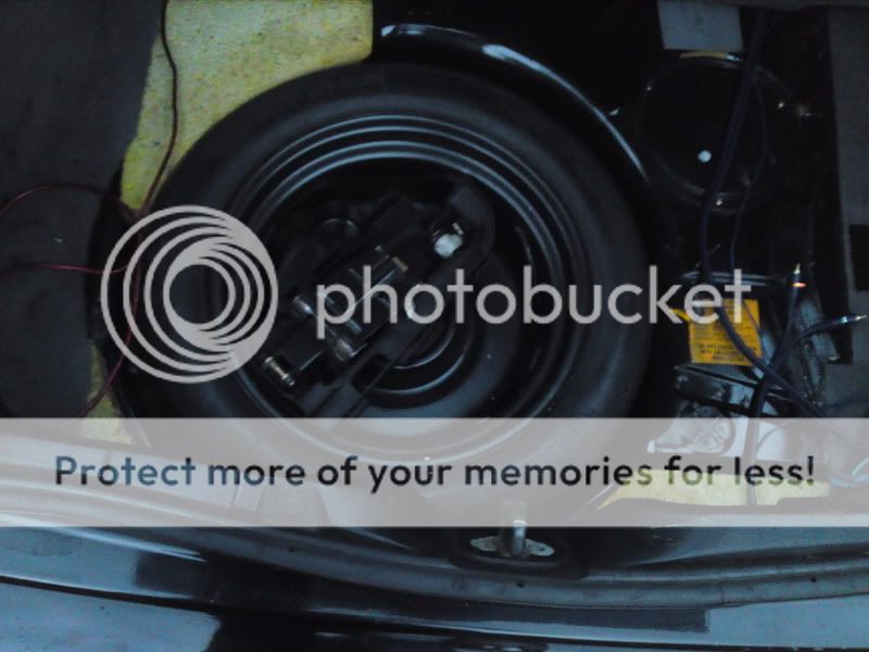

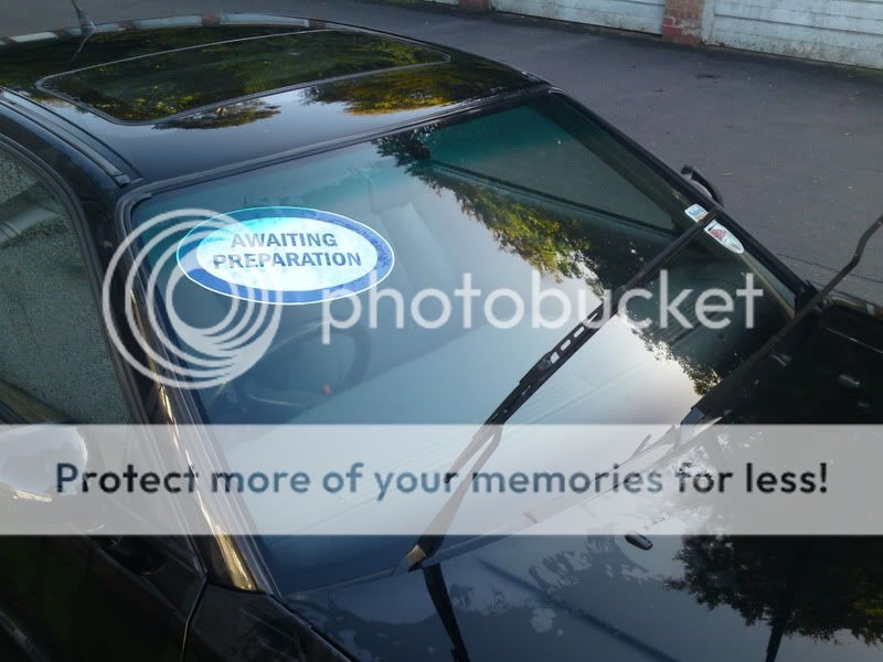

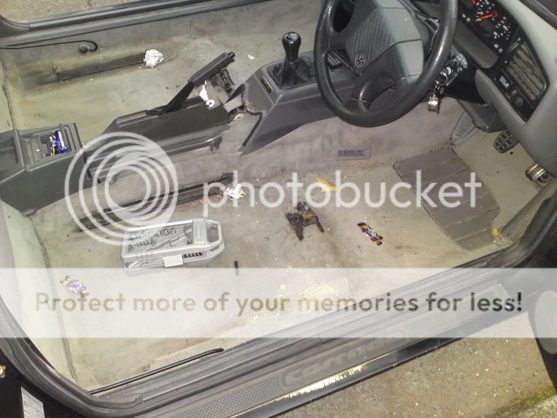

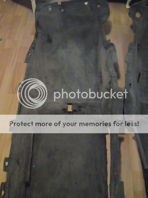

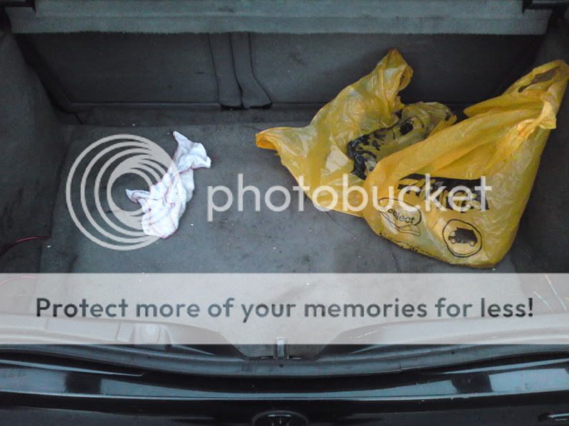

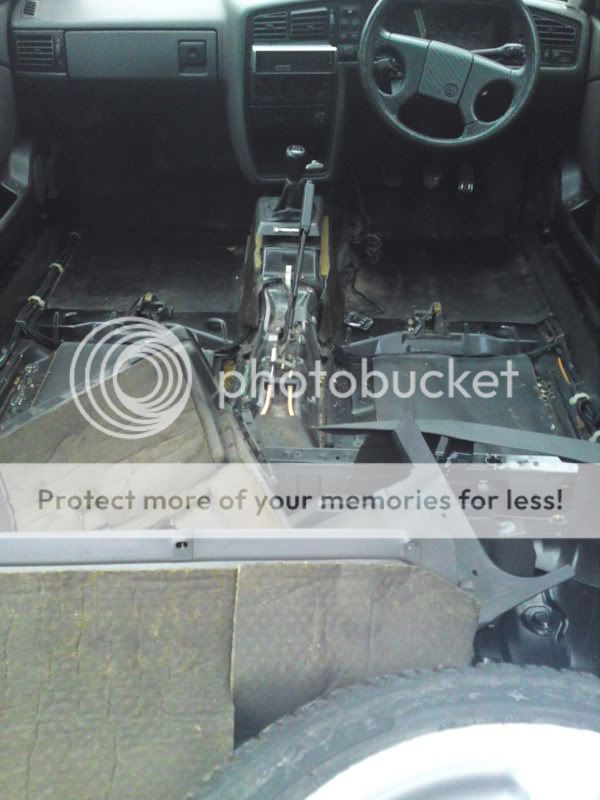

k6kny 1 Posted November 3, 2010 Some updates on what I've been doing since I got the car. I was left a few spare fuses and resistors :lol: The carpets in the boot were very badly stained, but on the plus side the Halfords bags contained a few cans of spray paint and more fuses :? Under the carpet I found the remains of an Ice install. When I ripped out all the wiring I found that all the wires had just been cut at the head unit end and the remainder of the wiring running the length of the car had just been left. Is it just me or is this a very strange sticker to put on your car? I had an old set of Speedline Mistrals that have been sitting in the Garage for years, so I put them on. They're in need of a refurb but it's an improvement on the old wheels and they'll do for now. As I already said the interior was filthy so it was a full strip out for cleaning :eek: Carpets were brought inside to get cleaned with the Rug Doctor And this was the colour of the water that came out of the carpets :shock: More to follow :) Quote Share this post Link to post Share on other sites

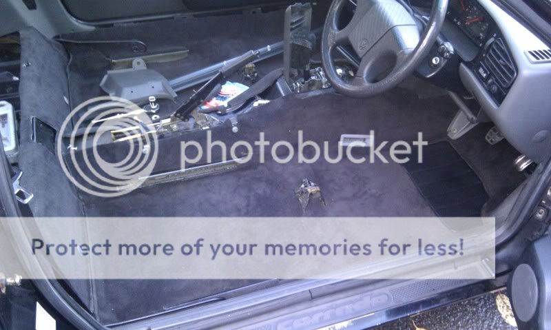

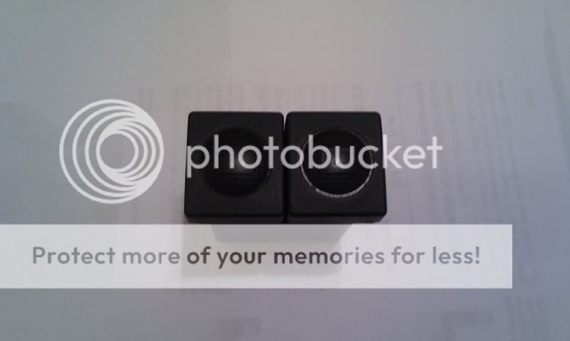

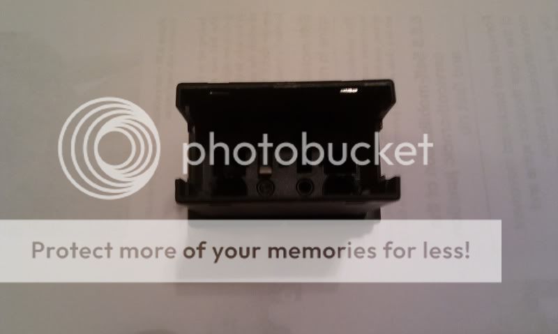

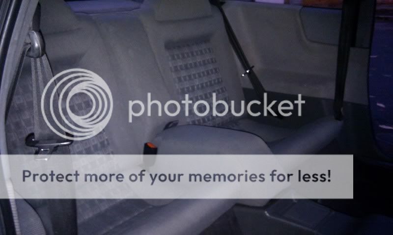

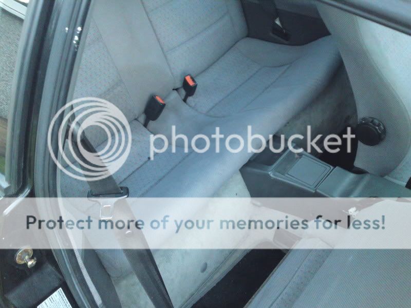

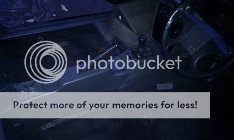

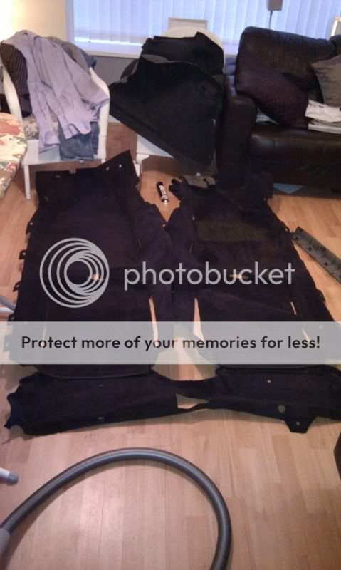

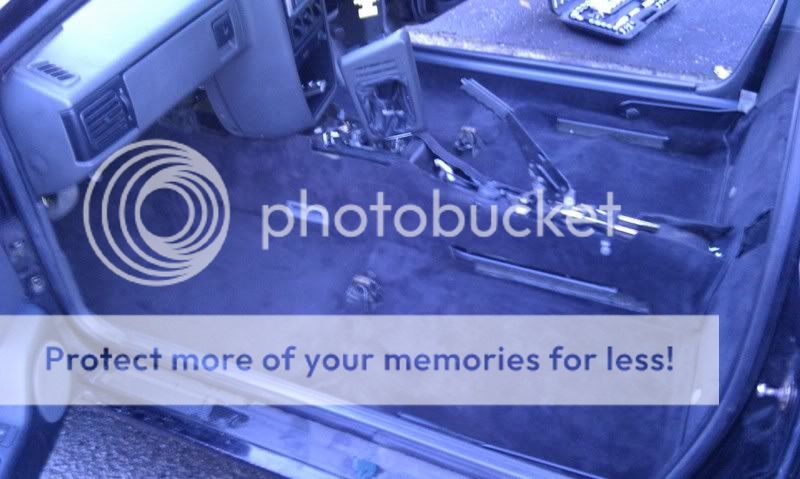

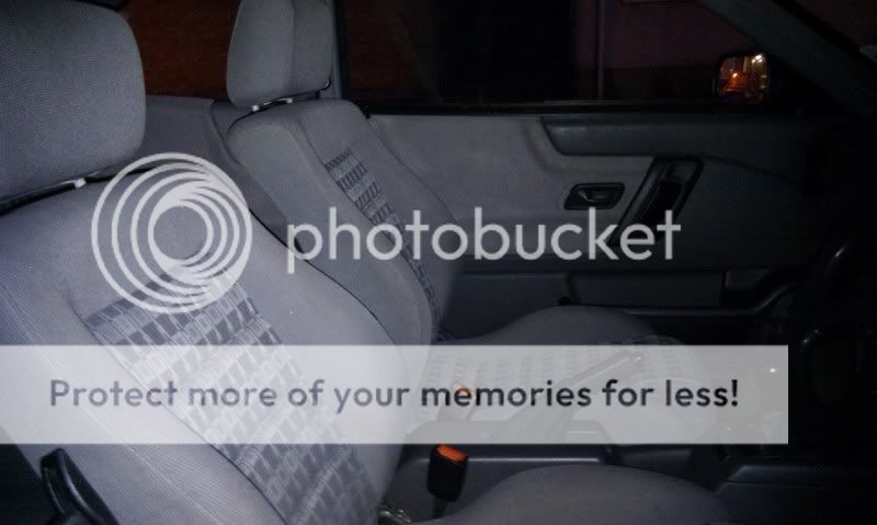

k6kny 1 Posted November 10, 2010 After trying to get the grey carpets to clean up any better using various shampoo's and upholstery cleaners I decided that, despite the massive improvement, I just wasn't going to be happy putting them back into the Corrado :( . So a new set of carpets was needed and I decided if I was changing them I wanted black ones. Luckily ebay turned up a decent set which arrived last week :). After having a good look over them all that was needed was a quick hoover and a bit of upholstery cleaner on a couple of areas and now they're in pretty much perfect condition :D Today at long last I had a day off with a few hours of dry weather so I was able to get the interior back in the rado. First the new black carpets went in. Then the lower dash and centre console. I also put a leather gaitor on the handbrake as the original plastic one was missing from the car. Next was the new rear bench with centre armrest 8) Lastly the front seats. Also sorted my faulty rear heated window switch today. It hasn't worked since I got the car and I assumed it was the switch mechanism that was faulty, however when I took the old switch out to put in the new one I found that all the internals were missing :confused4: So no wonder it never worked. Anyway the new switch went in and hey presto my rear window now demists :D Quote Share this post Link to post Share on other sites
**Ian** 0 Posted November 10, 2010 Strange question for you mate, but what are you doing with the old hollow switch? I am missing a blanking piece and could make use of the switch if your going to bin it :) Quote Share this post Link to post Share on other sites
k6kny 1 Posted November 10, 2010 Strange question for you mate, but what are you doing with the old hollow switch? I am missing a blanking piece and could make use of the switch if your going to bin it :) It's yours if you want it, PM me your details and i'll post it to you :) Quote Share this post Link to post Share on other sites

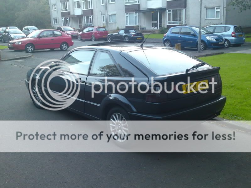

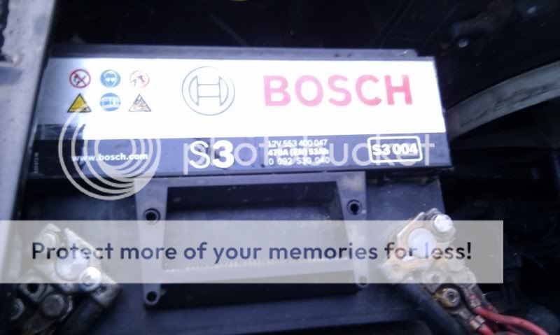

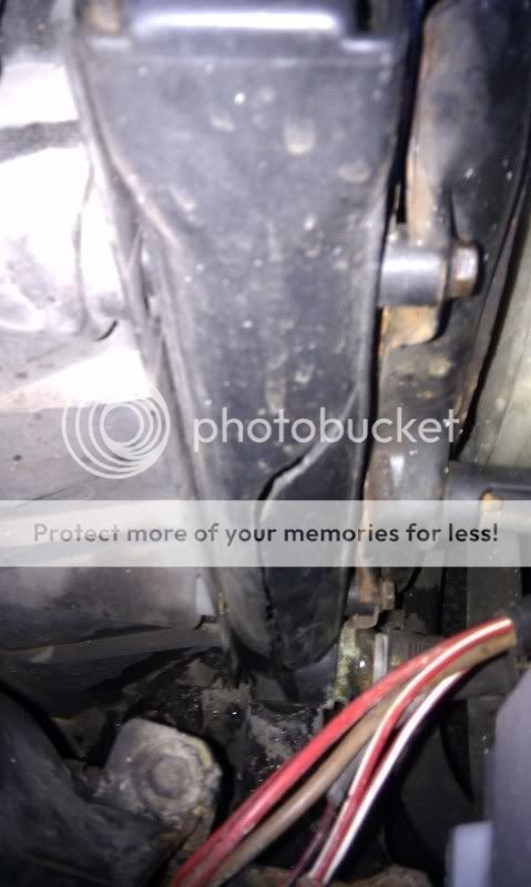

k6kny 1 Posted November 16, 2010 Well it's one step forward and two steps back with the Corrado just now. I've been having problems with the battery in the car since I got it, long story short, it was knackered :( so bought a new Bosch S3 and put it in today, problem solved :) I've also removed my rear wiper. Really cleans up the rear and it's a nice simple mod too. I also have the common fault of my fan heaters only working on number 4, so having checked the contacts on the dials and finding them ok the next thing to replace was the thermal fuse. I soldered in the new fuse, re-installed the fan unit, started the car and found that I had the fans working on 1, 2, 3 and 4 . Only problem is the fan unit itself is making a screeching noise which, I've heard, means the bushes are worn so it looks like I now need a new fan unit . To make matters worse as the engine came up to temperature there was a loud pop and alot of steam from under the bonnet. Opened it up and found this: New radiator required me thinks :( Ah the joys of owning an old VW, is it wrong that I'm loving it? :norty: Quote Share this post Link to post Share on other sites

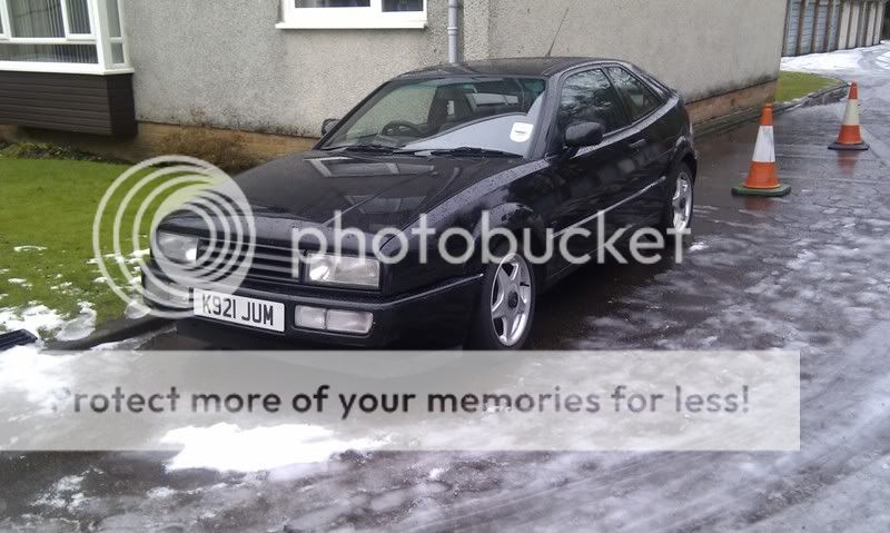

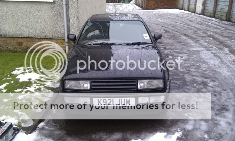

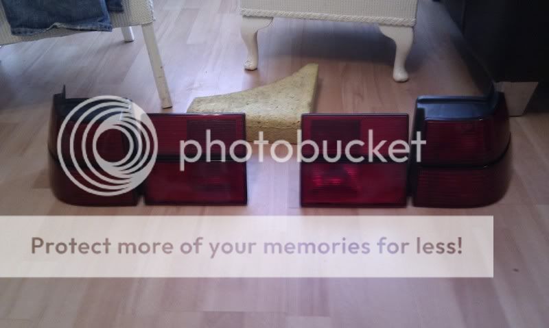

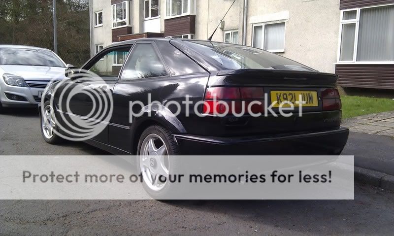

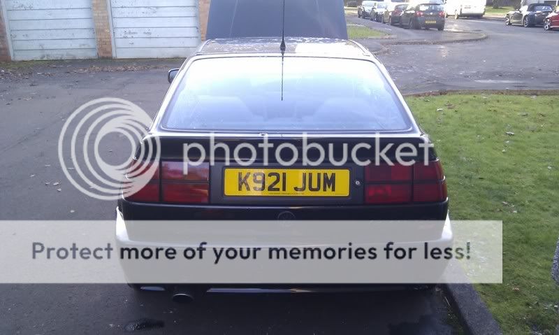

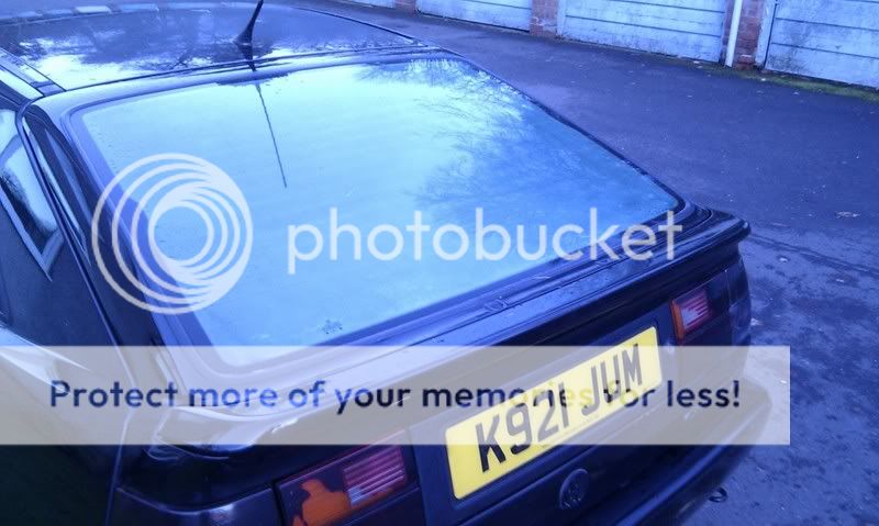

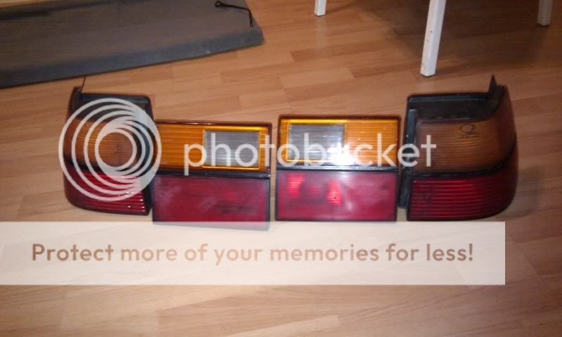

k6kny 1 Posted January 10, 2011 Thought I'd do a quick update, not made very much progress in the last 7 or 8 weeks, but here's what i have managed: Got rid of the all black rear lights, first stripped all the tint off of them and sanded them ready for spraying: Then applied the red tint: Back on the car: Finally got round to putting on the de-badged grill that I got at Christmas :lol: And a quick one of how it's looked for the last 6 weeks: Quote Share this post Link to post Share on other sites

hyland770 0 Posted January 11, 2011 how did you go about the rear de wipering mod, looks so much neater and those rear lights look so much better! good to see progress being made!! Quote Share this post Link to post Share on other sites
k6kny 1 Posted January 12, 2011 how did you go about the rear de wipering mod, looks so much neater and those rear lights look so much better! good to see progress being made!! Here's a link that explains it: http://wiki.the-corrado.net/_wiper_motor_removal.html Although I only found it after I'd spent ages wrestling the wiper motor out :lol: Quote Share this post Link to post Share on other sites

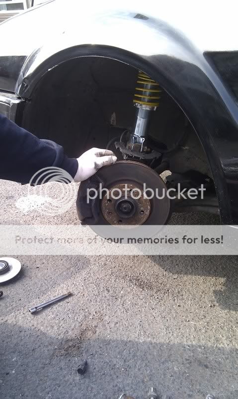

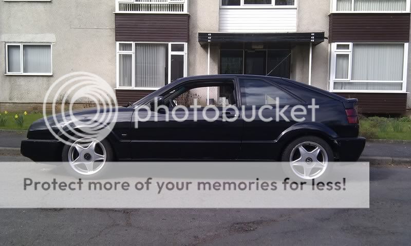

k6kny 1 Posted April 4, 2012 After a year of sitting in my garage with nothing much happening, work has finally started again on the Corrado with the coilovers, I picked up at Edition last year, getting fitted. Not adjusted them yet, leaving that until I've got the new wheels fitted then I'll get it dropped properly 8) Quote Share this post Link to post Share on other sites

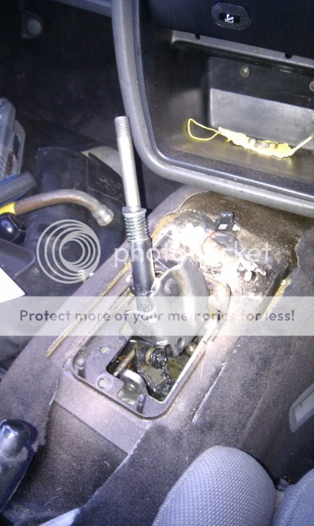

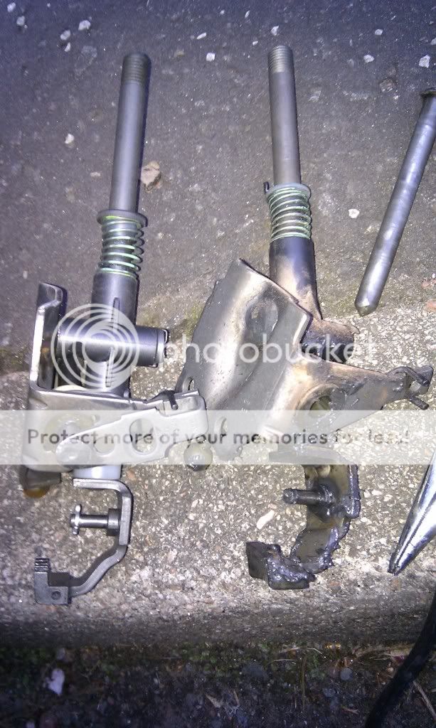

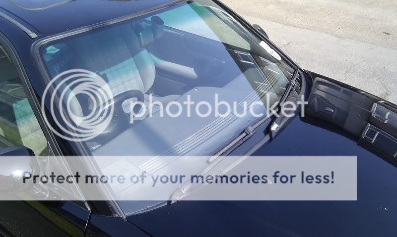

k6kny 1 Posted May 8, 2012 Couple more things done this week: First off fitted a set of Lupo GTi aero wipers Next I replaced the gear shifter mechanism with a short shifter one that I bought from daves16v on here Old and new shifters (new one on the left). If you look closely at the old one the bush at the bottom is pretty mangled which explains why I was having so much trouble selecting first and second gears What a difference with it installed, feels like changing gear in a modern car now. I really can't recommend this kit highly enough, and the detailed instructions make fitting it very easy. Quote Share this post Link to post Share on other sites
