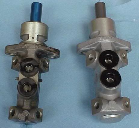

strimmer 0 Posted December 22, 2010 If a larger MC is needed a 25mm version can be fitted. The master cylinder is made by ATE, VW# "441 611 021 a" brake master cylinder for 200 turbo/200 turbo quattro. Couldn't say if this is useful for the upgrade being discussed but useful part no. if anyone wants to increase the MC. Quote Share this post Link to post Share on other sites
Kevin Bacon 5 Posted December 22, 2010 Great info! Unfortunately the corrado MC flange mounts at 45 degrees, so you'd need to change the servo as well. Quote Share this post Link to post Share on other sites
